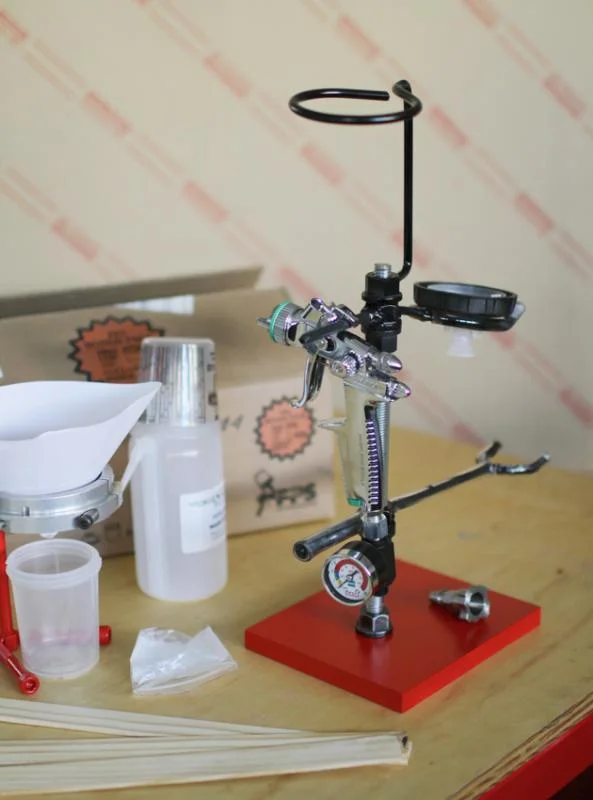

Thanks for the comments thecrazygreek - zero painting experience on my side so help is always appreciated.
I'm a little confused (as usual) :). Are you saying to just flush the gun and don't pull the cap, needle, etc.? In this instance (primer on the FJ40) I'm going to use PPS cups, which saves me the hassle of cleaning the cup.
I thought the general process would be:
1) remove the PPS cup
2) with air connected - flush the gun with the thinner/squirt bottle
3) remove the air hose
4) remove the cap, fluid tip (wrench required) and needle
5) brush/squirt bottle clean all the parts/holes
6) air gun blow dry, few spots of grease and reassemble
Here's an action-packed :grinpimp: video from the Sata website - maybe a bit over the top:
http://www.youtube.com/watch?feature=player_detailpage&v=TpVipYA2bUE
What's the (your) process with the SEM spray can product you posted? Sounds like the same type stuff ravenholm posted about earlier?

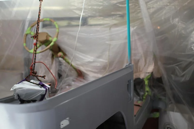

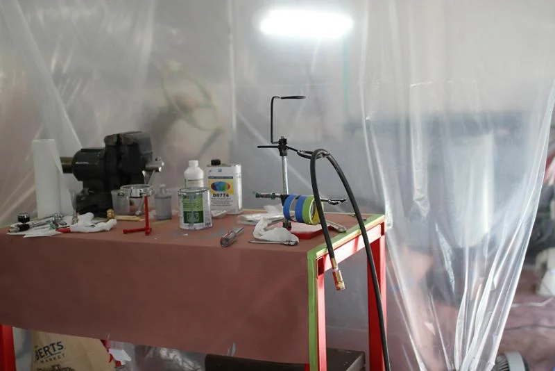

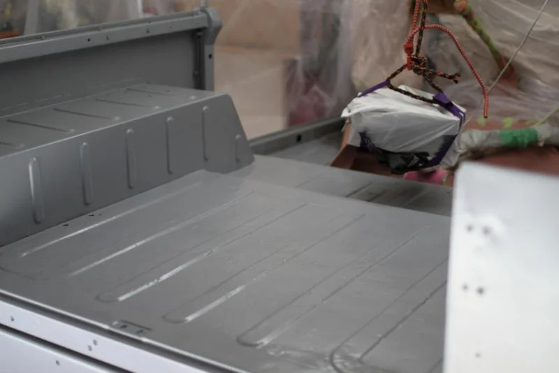

Finally got a chance to try using the gun with epoxy primer.
Only thing I've had experience with is a rattle can - but from what I can tell this Sata is a great little gun. I even got a few spots that look perfect :grinpimp:
Seeing my body work on the quarters under paint is a bit distressing though. I didn't expect the EP to fill sanding marks, etc. but the paint really does show up all the hiccups.
Got a good amount of air moving through the garage. Overspray was not as bad as I thought it might be. Biggest surprise was my little compressor did a great job pushing the gun - it even managed to catch-up while I continued to spray!
Overall a good learning experience and at least now I can spray some primer when I feel the need.
I find spraying everything the same color, even just primer, really makes you feel like you have accomplished something after endless hours of metalwork. :clap:

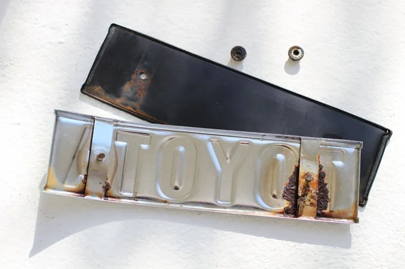

Looks good - I thought this was one part I wouldn't need to replace.
That one side is almost rusted through the support arm. The new one will get a few drain holes with the rubber pad cut away under the holes.
Pads for the door mirrors have little drain cutouts - one of mine plugged up with dirt and caused some rust, the other was fine...

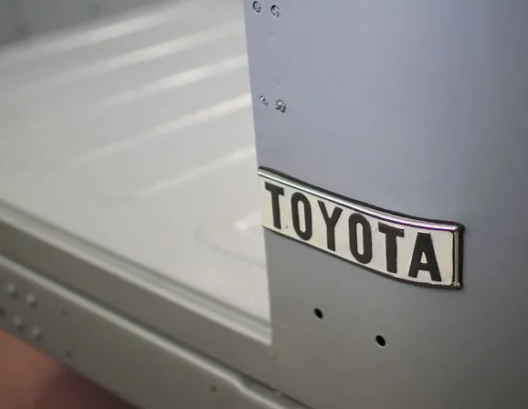

I guess all the TOYOTA rear emblems I've had are from a later model 40 because I remember them being plastic, not metal. Bummer its rusted on the back side, looks great from the front.
Nice work on the painting. Looks great!
Hi Mike,
The emblem/badge below (4 Wheel Drive) is plastic (with the red all faded away). Rusted backside nut/stud cracked the plastic when I removed it - where the stud was pressed in, so I replaced that one OEM (plastic too).
I had liked the nice aged patina on the metal one and wanted to use it - too bad (and more money down the cruiser hole) :)
I'm pumped about the painting - and thanks for all your helpful comments in the past. Had another visit from Canadian Jim a week or so ago and he also offered a few painting pointers. I think I can get better with a little practice. The gun was great adjusting the fan size moving around tight areas inside and the max fan area seems pretty big.
