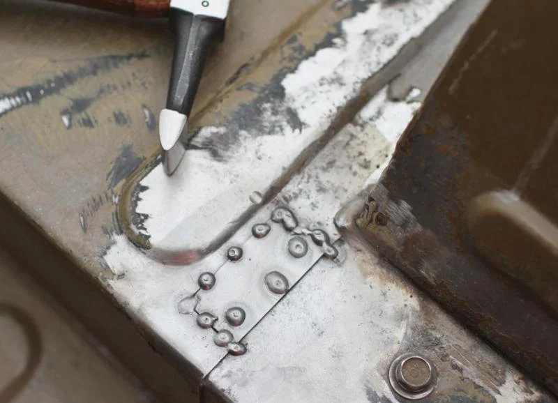

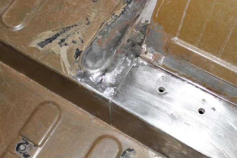

Grinding and some more touch-up welding complete on "floor" patches and ready for the brackets. Note I'm leaving quite a bit of the weld bead where it doesn't interfere with the bracket that lays on top. Can't see grinding that away to thin (weaker?) metal when it get's covered with undercoating, etc. anyway.
Nice work Gus. I agree with leaving the weld where it won't be seen under the finished coatings. I do often grind mine all away but it really wouldn't be seen under a thick rough coating.
Thanks Kevin. :)

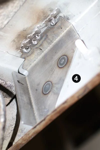

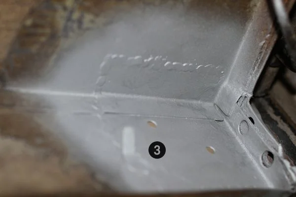

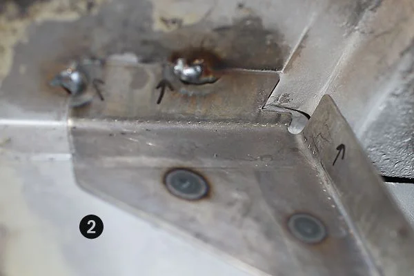

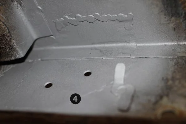

Finally :rolleyes: - tacking the 14 GA brackets in. Made a small clearance cut in (2, 4) that really is not stock, but seemed to help the brackets sit better.

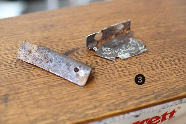

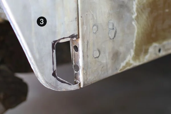

Just when I thought the rockers were almost finished I took a closer look at the little rear vertical sub-bracket and found another problem. This area (front of the passenger side rear fender) on #3 has the small vertical sub bracket stacked where the bolt holds the brackets together. The rust was pushing the small bracket to the inside and was almost rusted through (even though it looked fine on the outside). Made a new small bracket earlier on #1 - I'll try to cleanup and reuse this one in addition to a new 18 GA patch for the outside. :meh:

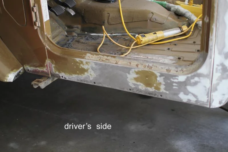

Rockers more or less completed - maybe a little hammer/dolly and some light filler required? Like so many things, finishing seems the toughest part. These panels were already somewhat bent out of shape by the running boards, etc.

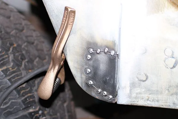

Another bump repair behind the driver in the rear seat mounting area - the top of that big body tube. Looks like driver weight/movement opened up the seam and a good chunk of rust developed over time between 2 spot welds.

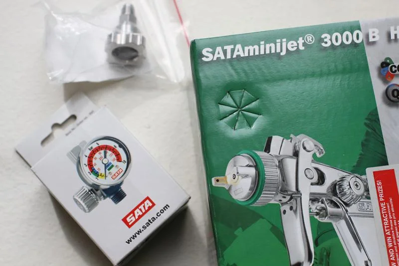

SATA minijet 3000 B HVLP - 1,4 SR

It should go without saying that I don't know anything about painting - but here's my thought process on this gun.
I decided I really can't do any kind of full blown "auto" painting in the garage, and that has sort of put a damper on previous plans to get a larger, 2-stage compressor, hard-lined and set up with filters, etc.
But I still felt like I needed a way (besides a brush) to get some epoxy primer down to protect small repair areas as I drag along with the body work on the cruiser. Started thinking I could get away with a little spot painting here and there if I could find a gun my little Dewalt compressor could push and not choke on the primer in the process. Sort a big airbrush kind of thing (I do some large canvas painting - that's another story). The main question was if a smaller mini/touchup gun would spray epoxy primer - a few knowledgeable paint people said no because of cap size, etc. I thought about a $50 touch-up gun at Sears, etc. but worried about the whole conventional/traditional gun excessive over spray (more pollution to deal with in the garage) thing, etc. And I don't think that gun's cap would have handled the epoxy.
The spec sheet for my epoxy primer calls out a Fluid Tip 1.4 - 1.6 mm ...
Then I looked at the Iwata LPH80 HVLP and almost bought one with the E4 1.2 air cap (largest), a few guys on the Iwata forum said it would work with a bit of extra reducer in the mix. Right before I ordered I looked at the SATA minijet again and they had a "new" 1.4 SR (spot repair) setup available. I thought it would cost too much but it was basically the same price as the Iwata and the guy at TCP also told me he thought it would be better.
Time will tell. I picture mixing up a small amount of paint in a 3M PPS mini cup, spraying a small prepped area for a few minutes and then taking an hour to clean the gun :), not the most productive methodology.

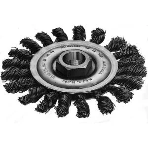

Try this.......its the only thing I use now for removing paint down to the metal..best part is it wont dig into the metal, it rather leaves it clean. This sucker takes it off fast and clean it will also flex into corners. You can also make a homemade mini sandblaster if you have a compressor...? Let me know if you need more specs on the mini blaster.
Milwaukee 4 in. Carbon-Steel Full-Cable Twist Wire Wheel

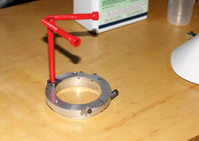

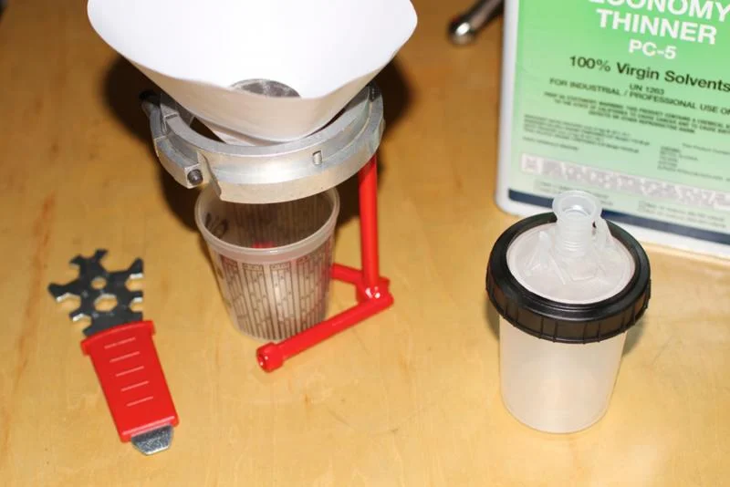

Made a little strainer holder out of some stuff that was laying around. Going to make a holder of some kind for the gun next.
