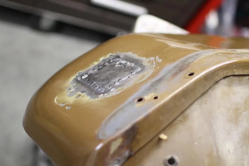

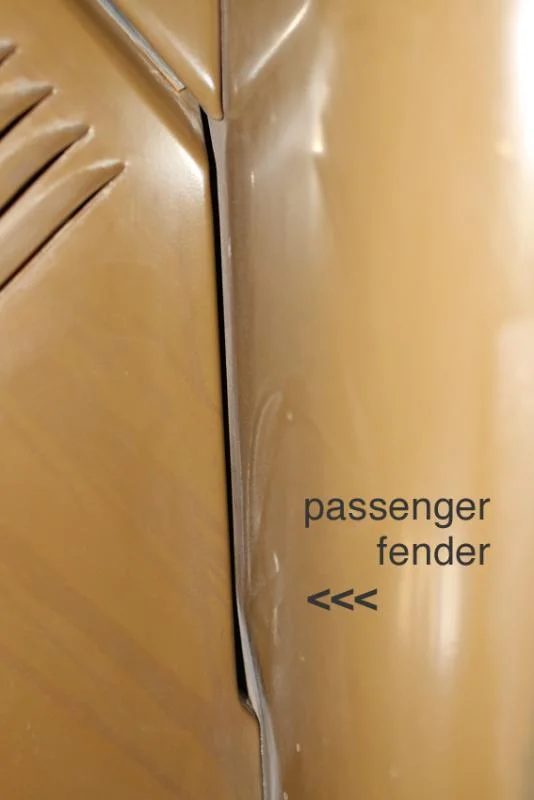

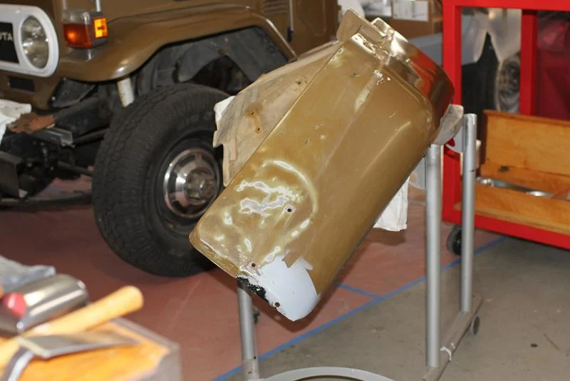

Bolting my running boards back on and noticed my passenger-side front fender had been POed in the past. Funny I never saw it before - something slammed the inside at some point. Note the gap...

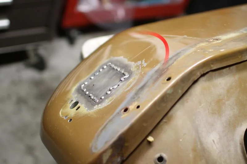

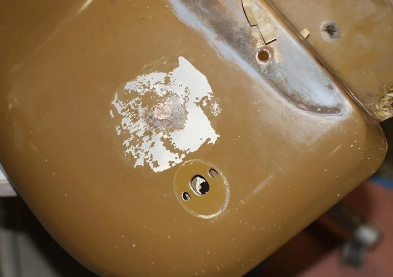

Decided to pull the fender to bang around on it. Might be time to also do those little rust bumps on the turn signal mounting supports.

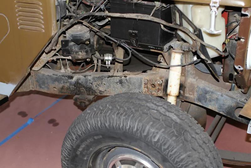

Funny how it always looks a lot better on the surface than what's underneath. :)

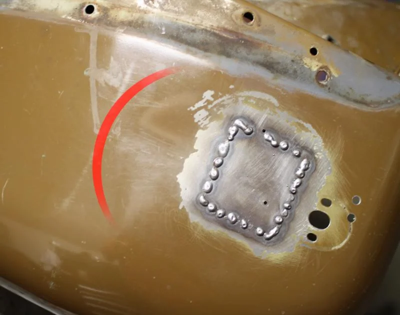

This is a good example of slapping a patch in real quick and the resulting shrinking and deformed fender. Kind of hard to see in the photos but note the big concave area. It's tempting to want to just start pounding it back out but I think grinding down the bead a bit and planishing the welds will make that area pop back in. Had I taken more time it probably would have deformed less.
Used a copper plate clamped on the outside, tacked the inside up and then welded up the outside without any hammer work (at this point) on the welds.
If you hammer and dolly the raised crease then heat it and then cool it down with a cool wet rag, won't it shrink back to original shape?
I'm thinking the shrinking has already happened - from the heat of the weld. There's no "oil canning", etc. at this point. Have'nt had the time but I've ground the weld a little and banged on it a while - and I think the big concave area is coming back - still needs some more. There's a nice curve there that comes down from the top of the fender that I don't want to put a hammer on.
The general idea (from my understanding) is if I continued to bang on the patch (hammer on dolly), the metal will stretch (thin) removing the shrink - too much and it would in turn, oil can. Then heat could be used to shrink it back. Right now there's too much shrinking (from the weld heat) - shrinking IS the problem, and it's warped a larger area away from the patch itself.
The attached photo is not great - but you can kind of see that area coming back in. I haven't banged on that area - just on the patch and weld bead. There's a nice curve there from the top of the fender and I don't want to mess it up. When I finish the welding I'll be putting in more heat, which means that warped/radius area will no doubt start to come back. At this point it's just about gone - I'll try to get a better photo up going forward - if I don't screw everything up :grinpimp:
BTW Longhunter, I don't do the wet rag thing any more when trying to shrink with the torch - just let everything air cool... I've had pretty good success with a small torch and no radical cooling (with potential heat treating, etc.).
Just work the weld bead down and I bet your metal will get straight...
You can also cold pick the outside around the edges from the top. Light taps with a pic hammer and she will pop up.
My dad taught me that trick. Took a dent out from the top side with a dolly on the back. Weird but it worked! He did use some minor heat when done to finish.

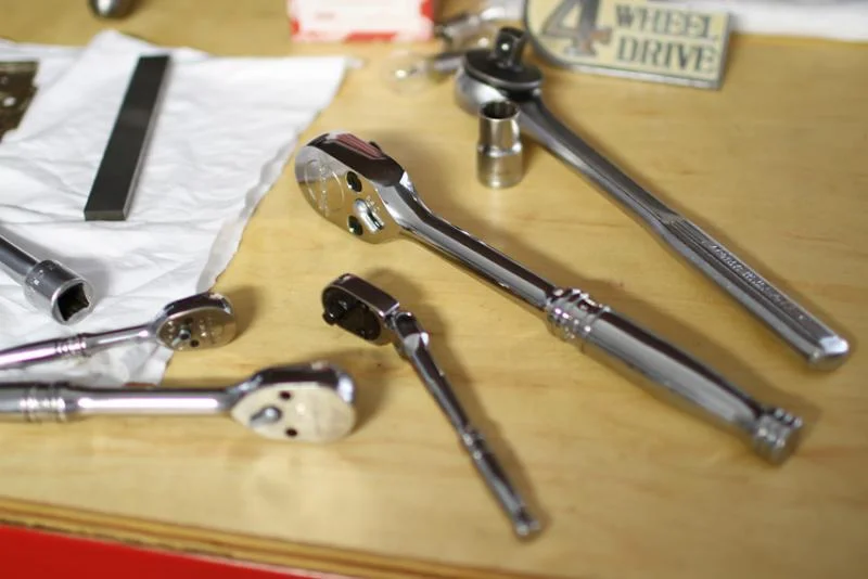

If you've had a chance to use them much, what do you think of the new vs. old craftsman ratchet handles as they feel in your hand?
I have a few of the old style and like them. I also have some kind of knockoff swivel ratchets that looks to have a similar round handle design of the new craftsman you are showing.
The knockoffs I have tend to feel like they are slipping out of my hand all the time, even when they're not.
... you've had a chance to use them much, what do you think of the new vs. old craftsman ratchet handles as they feel in your...
Thanks Mike,
I'm not anywhere close to the mechanic you are but I'm always ready to spout off my opinions on tools. :)
Those are new Snap-on, not Craftsman.
The only tool "sets" I've picked up in the past have always been Craftsman. Then a few years back I began buying a few Snap-on tools, piece here, piece there and only the stuff that was used a lot (10mm, 12mm, 14mm, 17mm, etc) or special in some way (Flare Nut wrench, puller, etc.). I did buy a small 1/4 inch drive complete set from Snap-on at one point (still have my 1/4 in Craftsman set - 30+ years old). If I need say an 18mm deep socket I just fall back on the Craftsman stuff I have - but my tools don't get that much use in general. My much older Craftsman ratchets are kind of worn/loose these days.
I have a few 3/8 ratchets from Craftsman that are somewhat newer and really nice - but what i see at Sears these days I don't like that much (in ratchets anyway). One is a short/chopped flex-head, quick release and the other is a longer, bent QR/flex and they both seem every bit as good as the Snap-on stuff. I think the ratchets at Sears have changed a bit from these 2, even though they're not that old. That 1/2 in in the photo I've had forever.
Those 2 new Snap-ons in the Christmas photo seem smooth and better than the older 3/8 Snap-on I've had a few years. Can't believe the tooth gears - so much nicer I may replace my older 3/8 ratchet at some point.
Can't help it but I like the Snap-on stuff - I know lots of people think it's all branding/hype. :meh: That new little 1/4 in flex ratchet works great... and is like a little piece of fine art :hillbilly:
