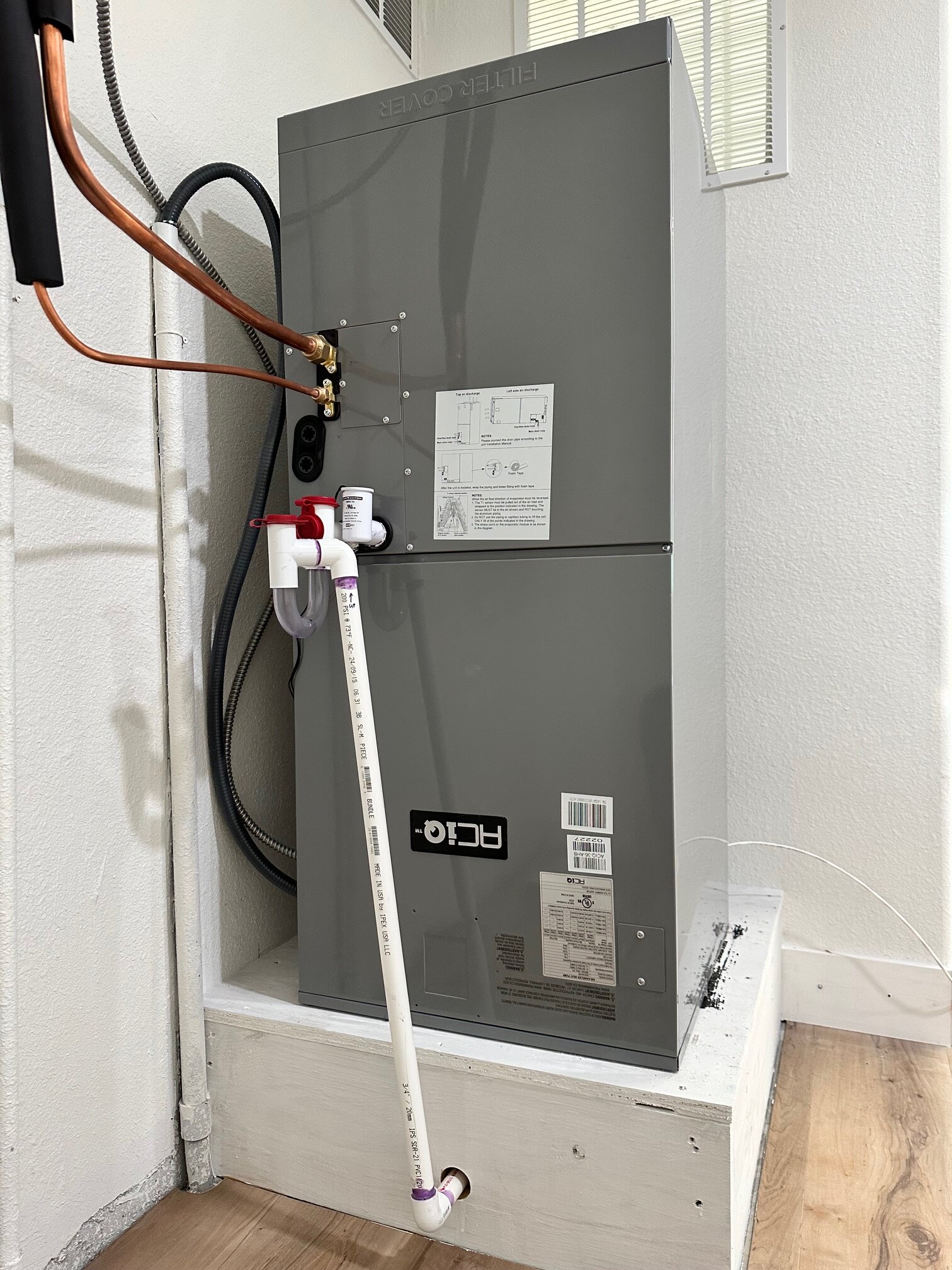

I’ve been methodically working on the central heat pump installation, and it’s all done except for the thermostat. My experience installing the mini-splits gave me the confidence to try the central system also. It was a big job but I broke it down into smaller steps over two plus weeks. The hardest part was running the copper lines through the ceiling/ roof vent stack with its 180-degree bend, and from there through 3” conduit that I then buried. A ton of bending, trial fitting, and etc. Really glad to have that all done now.

Great job! I just hope it’s not upside down….
Great job! I just hope it’s not upside down….View attachment 3902643
It's upside down on purpose; the air handler is modular and made to be convertible to up-draft, down-draft, or horizontal-draft in either direction. The default configuration as delivered is up-draft, but since my ducts are all under the floors, I converted it to down-draft. You take the evaporator coil and attached condensate drain pan out, flip the cabinet upside down, and reinstall the the evaporator coil flipped 180 degrees, so that the drain pan is still on the bottom. The coil is now on top, and the blower motor and squirrel cage is now on the bottom and blowing down. It's even more obvious with the bottom cover on (after finishing the thermostat wiring).

Good eye though!
