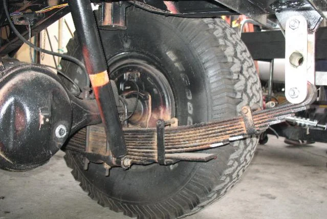

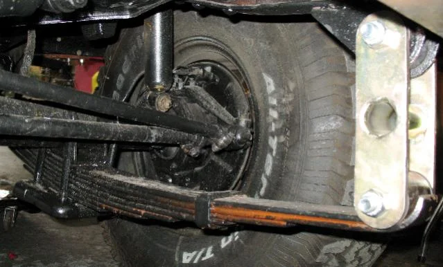

thanks gil and crusher, i will do more research. the other thing i realize from your post is to take a more comprehensive approach in our decision on the suspension. i have a lot of research to do and other opinion from the ih8mud community are welcome. here are some of our current initial thinking.
1. we want to keep our leaf springs, pictured below.
2. widen the tracks with 1.5 negative off set on all four wheels.
3. we have already installed 3" shackles, which solved the steering issue.

you will need some caster shims in the front leaf setup, that thing must be like herding cattle.
after chatting with someone about the airbag idea, he mentioned he got rid of the airbags due to the constant failure, he said proper leafs is the way to go with air bags for temperary over loading. i believe he was from africa...
more on airbags!
On my troopy build up thread Wayne asked why I was going HD leafs if I was running airbags - I answered that IMHO airbags are a palliative measure but are not the 'ideal' solution to a leaf spring that cannot deal with the load. I also mentioned that a lot of our logging trucks ran them and we had so many bursts that we swapped them out for leafs. So I think this is what Wayne is referring to.... However I must stress that I have gone HD leafs AND kept the airbags. On tarmac you can pump up the bags and reduce body roll, you can also 'tune' the spring rate so easily with 'em. I know people go 0000kms with them with no problem, and I like em a lot - but with a heavily laden expo vehicle I prefer knowing the springs I have can deal with the load/road air bag or no airbag! A few other reasons for them:
- If your rig (like mine) is parked up for long stretches with al lot of 'bolt on' weight on the springs you can pump them up to avoid springs 'memorising' i.e. taking a permanent sag from lack of use.
- It is a third point in spreading your load - in theory with the vehicle load over three points there is less likelihood of main leaf failure.
- they are very good for towing as you can easily level off the rear to deal with the hitch load.
In short if your leafs can reasonably deal with the weight then the bags are an extra help, but I would not see them as a cure for springs that are shot or just no where near able to deal with the loads. In the Firestone kit there is a t-piece that would allow both bags (assuming they are both on the rear) to share one line... Now this I would not do! I can easily imagine that in a corner the outside bag would compress and the t-piece would allow air to be pushed to the inner bag thereby making the car lean even more: kind of like the opposite of a sway bar... Not my idea of fun on a laden top heavy vehicle. Bilstein's have a very good rep. Maybe if you speak to a real good shock shop about your vehicle and weight and set up you could get the Bilsteins set up for your vehicle if they are not adjustable on compression/rebound. I believe that for most rebuildable shocks changing valving is not a big deal.
Gil
there you go,
this is the one i was refering to...although my memory is a bit... unreliable since i thought the bags were removed and what you refered to was not relying solely on them.
my bad.
i love real life experience vs an advertisment of how great something is.
I think the airbags work better with coil springs where you cant have an extra load carrying leaf.

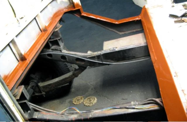

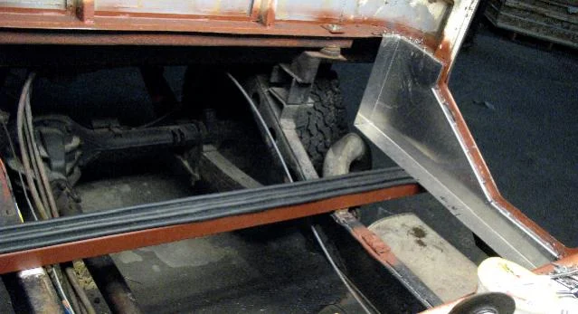

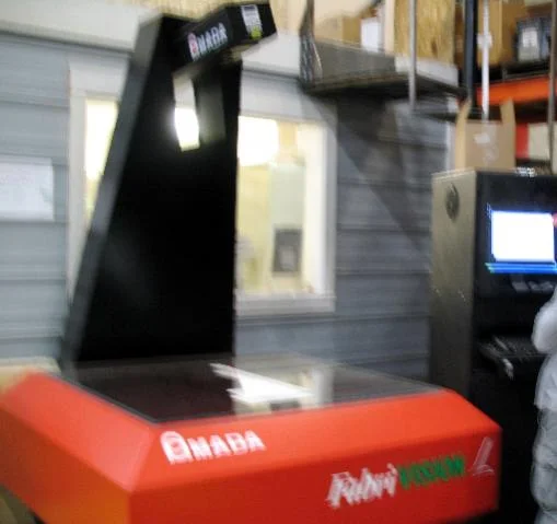

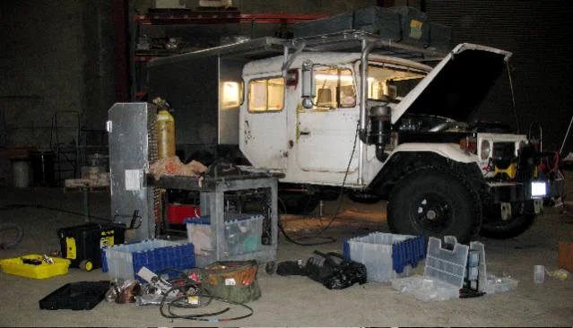

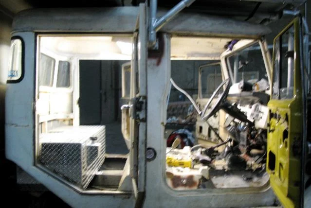

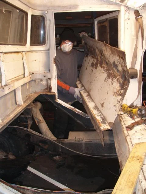

Hey all, here are more pictures. The snow clouds are lifting and we have access to Internet so here are pictures of the last seven days. We always enjoy watching and using the endless number of “toys” they have here at LCNW LCNW - Laser Cutting NW .

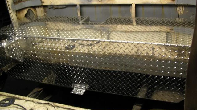

First series of picture shows how the 60-gallon tank is positioned on Nulla’s rear cabin. The tank filler will need to be re-positioned, we will to do this in Los Angeles because time has run out. We have to start the drive to Los Angeles by Monday.

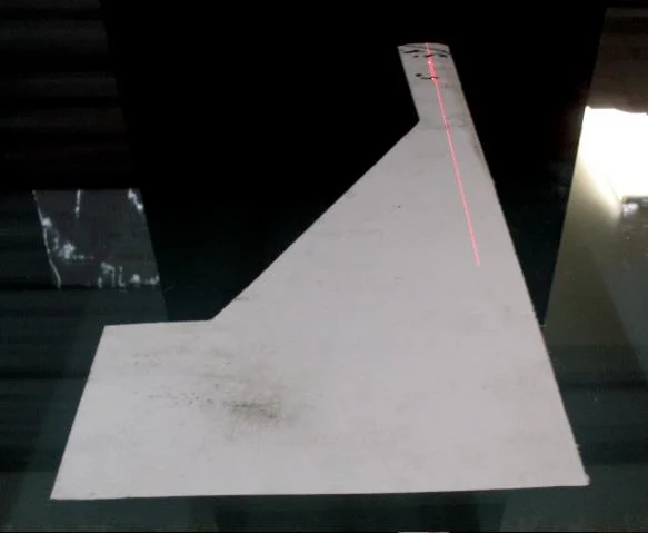

In the next (posting) series of picture you will see a machine (Virtech) that scans a paper template we created. The machine then turns the cut-out into a digital pattern that the laser uses to cut the aluminum. We then used another machine to bend the aluminum to fit the Nulla.
The last (next posting) two pictures is the fuel tank floor with the cross bar mounted to the chassis. This will help hold the tank up and strengthen the chassis. The last picture is Nulla in the “operating room”.
