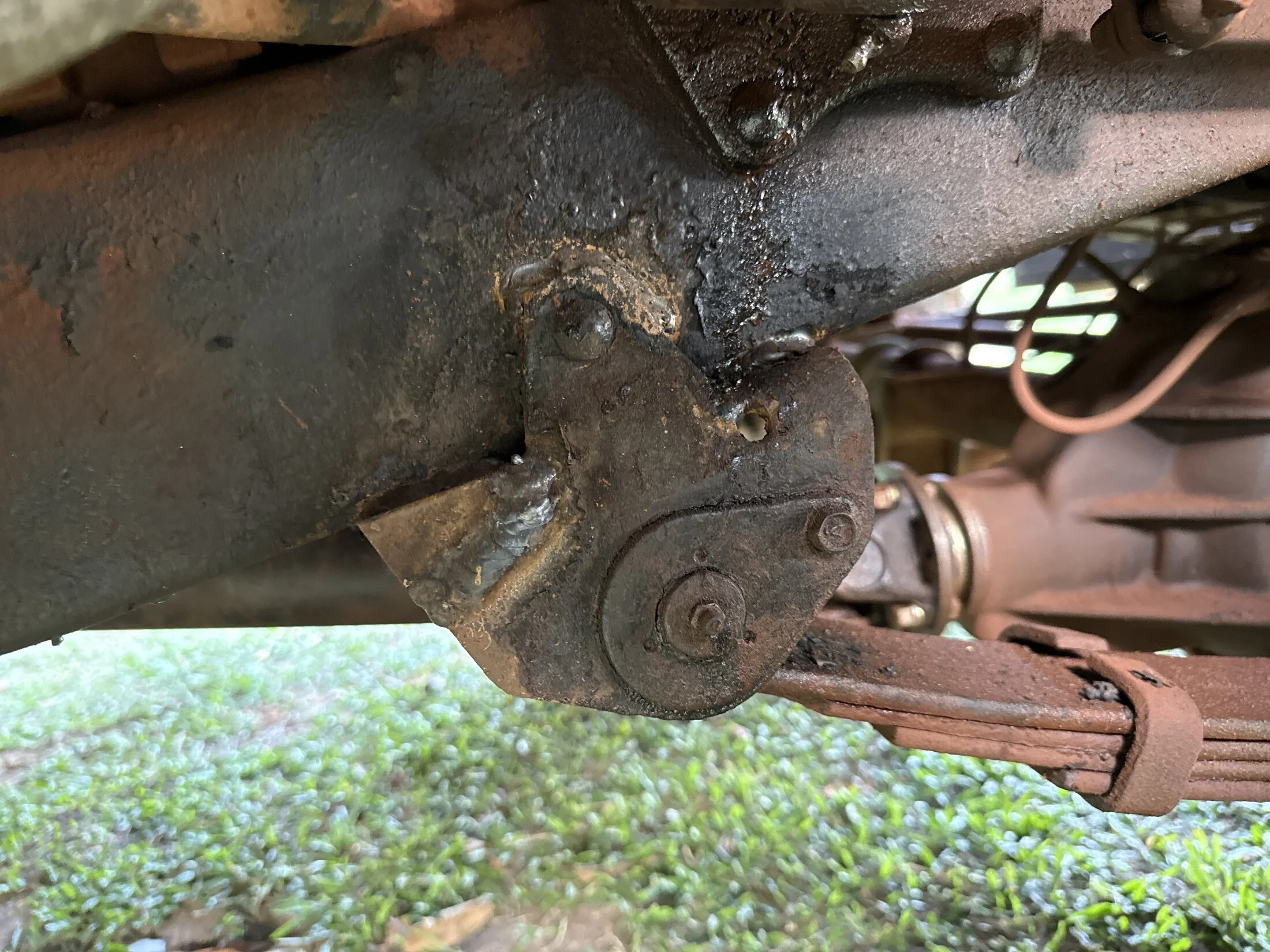

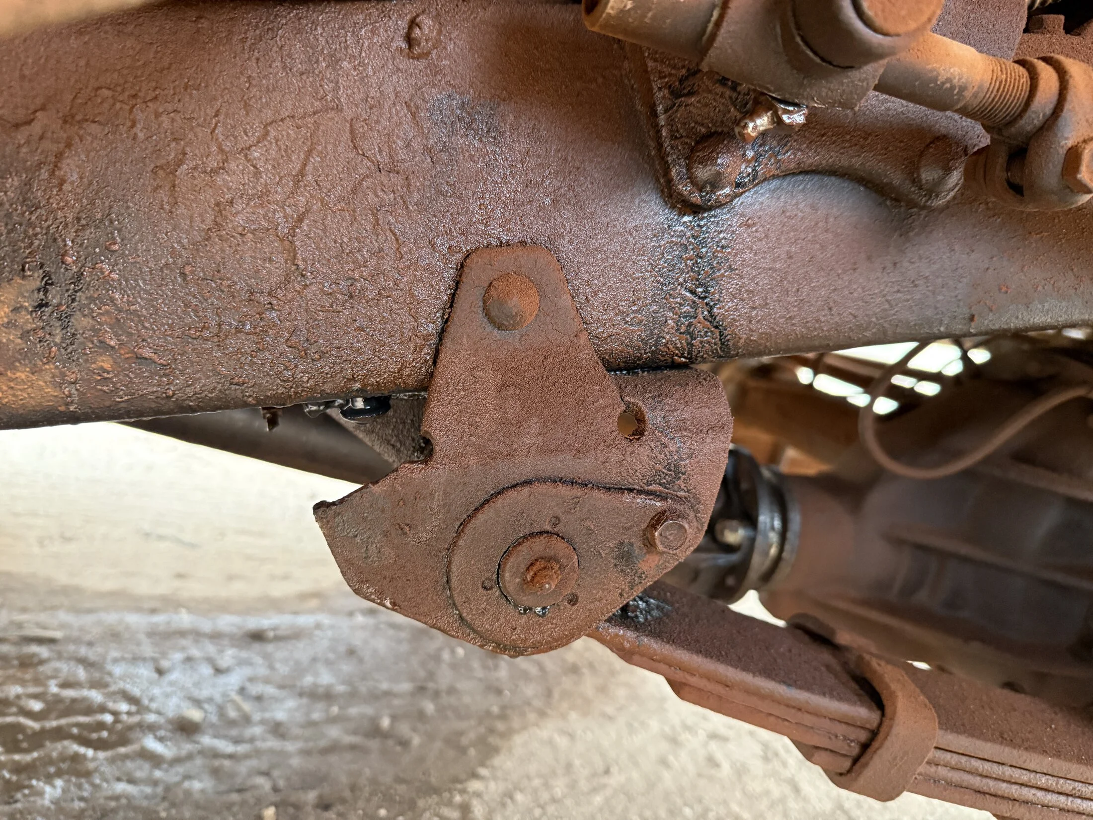

After several days traveling off road and some 4x4 track in Guinea. A piece of my front rear shackle broke see picture below. My plan is to weld the shackle on to the chassis. Is this a good idea. For some reason Toyota mounted these shackles with rivets. If you look at the rear part of the shackle you will see that a piece of it fell of. I really don’t have much other options at the moment. We are now in Man, Côte d’Ivoire heading towards the coast San Pedro, if someone knows of a shop in our direction please let us know. Thank you

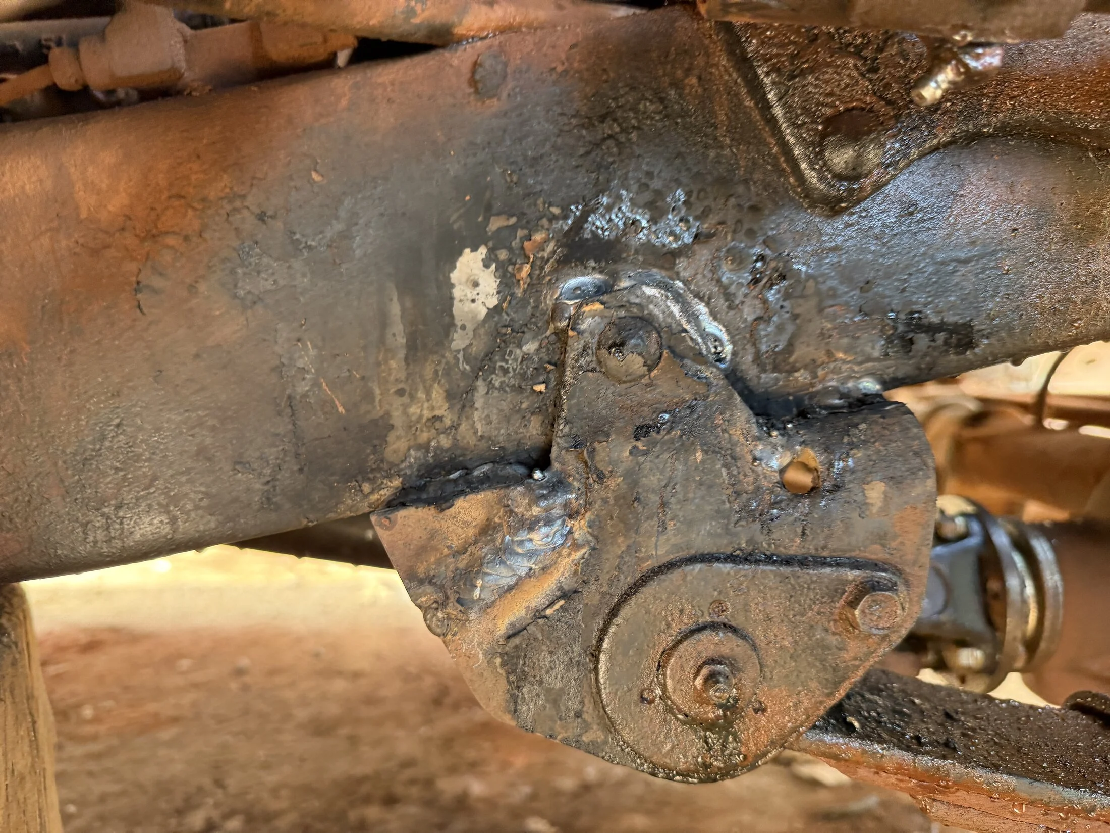

Some fabrication and African welding it is stronger than original 🙏🏽
Fabricated and welded
Generally this happens when the vehicle is overloaded .
How much does your Toyota weight ?
Yes I am heavy. But I think it is the road.
