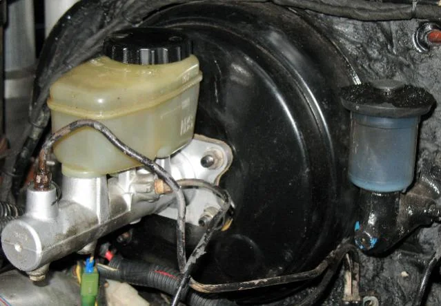

we changed the brake booster with a booster that came out of a 1 ton toyota dullies, we also found out that the Nulla has a vacuum tank connected to the brake, we will see how this all works together.

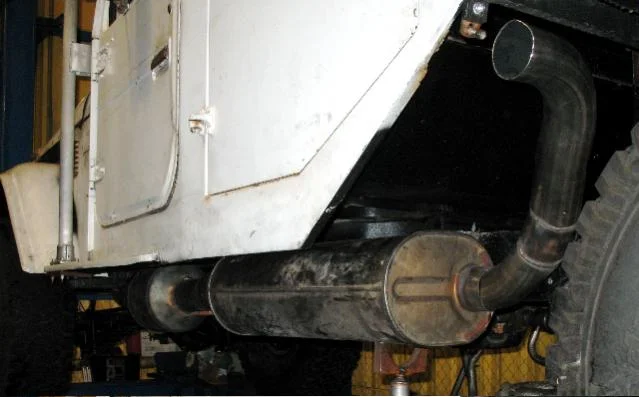

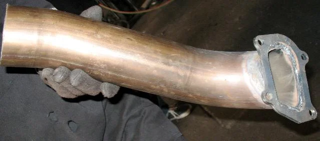

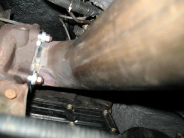

pictures 1 & 2 the fabrication of the dump pipe, it is 3 1/2" inches in diameter, the whole tail pipe is 3 1/2" we did not install the catalytic converter at this time. i would say it is a little loud. our plan is to install a catalytic converter in the future.

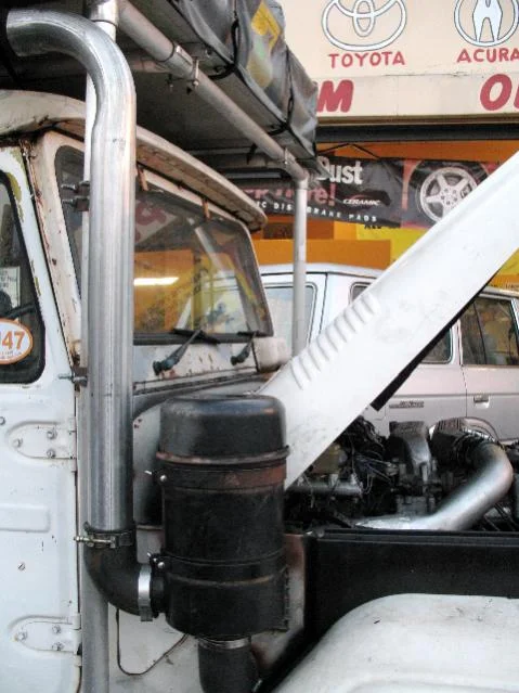

picture # 3 the snorkel

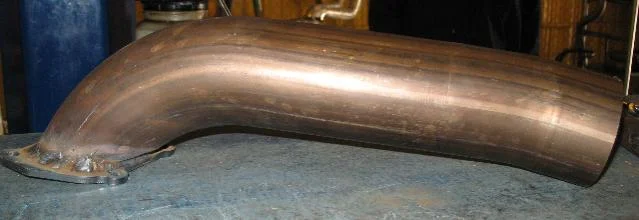

picture # 1 the dump pipe connected

what kind of air filter housing is that? a donaldson? are you sure it will do it's job when mounted like that? some models spin the dust and particles to the "bottom" of the unit which would be the opposite side of the intake inlet. because yours is mounted vertical like that, i'd make sure nothing slips past the filter seal and shoots down your outlet tube going to the engine.
Now, that's what a dumppipe is supposed to look like!
Driving just like this would get annoying very quick. I used a magnaflow muffler, i suppose those are pretty easy to come by in the US. Or look around and find an old muffler from a Dodge CTD. I believe those are 3.5" factory. Others will chime in i'm sure.

it is a donaldson
i am checking on it. i can always lay it on it's side. we are happy to get it outside the engine bay, it seems to work fine. here are some pictures...:bounce::bounce2:

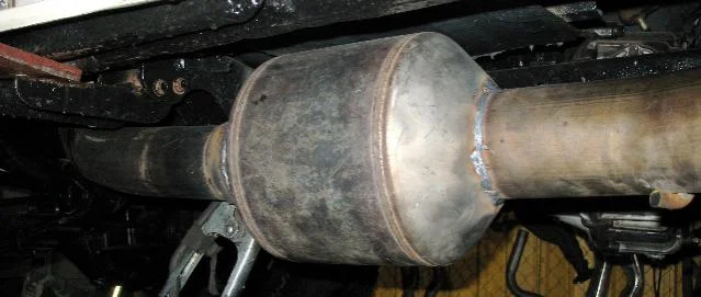

thanks crusher, here are some more picture of the build, we re did the exhaust today to include a catalyctic converter (we got a great deal from Edy's Auto repair) and a muffler, a big difference. that straight pipe was too loud. the muffler and the catalytic converter came out of a ford diesel truck. took it for a short drive it seems to work fine.
also here is the picture of the 1 ton toyota dully brake booster, it made a big difference in the breaking.

Mileage will suffer with that catalytic converter.
No reason to run it in my opinion.

a bit more flezable hose from the intake tube to the crossover, you need to allow for vibration of the big 6, it is smooth but with such a tight coupling you will get cracking down the road of the aluminum...
