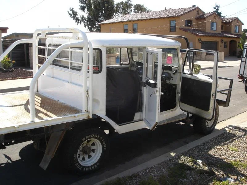

Here is a great tech link about the subject. Its a common swap and doesn't involve too much work. The wheel bolt pattern is the same. BTW, I recently picked up a rig similiar to yours, but yours has a longer wheelbase. Mine's a 79 with H diesel.

1tontoy, that is a nice rig. i have the rear bed that i took out of my rig if you are interested... :bounce::bounce2:
Yes, if the rear is wider by 7 inches, this will greatly decrease your handling. If anything, the front should be wider than the rear. This is standard on most cars/trucks because otherwise the truck will want to roll over when you steer because you will have to over-steer, because you will 'push' into turns.
About you ute bed, where is it? In Washington still?

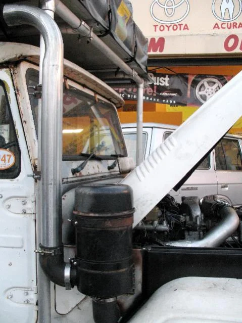

Donaldson - do i have the correct air filter?
what kind of air filter housing is that? a donaldson? are you sure it will do it's job when mounted like that? some models spin the dust and particles to the "bottom" of the unit which would be the opposite side of the intake inlet. because yours is mounted vertical like that, i'd make sure nothing slips past the filter seal and shoots down your outlet tube going to the engine.
i have since laid down on it's side, but i still don't know what is the CFM on this filter, in another thread it said that the CFM on a 12ht is 450. would like to know if this Donaldson filter is sufficient? i have thought about making the intake hole bigger like 4 or 5 inches. i really like this filter it was the same filter that my 2h was using. i also looked up the filter used on a 12th and a 2h. the part book says that the 2h and 12ht are the same.... thank :bounce::bounce2:
looks big enough, that's for sure.
