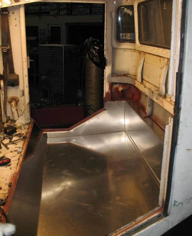

picture below is the new aluminum floor where the 60 gallon tank will be located.

Great build, just started reading it yesterday. This may be late but a couple thoughts for you. 1. Thirty years ago we sprayed alumium with zinc chromate primer where it was in contact with steel, this would retard the corrosion between them. 2. If you have a squell when turning with the PS your belt on the PS pump maybe slipping. I had to set up a turn buckle arangment on the pump to keep more tension on the belt .
Kevin
Kevin
thanks, we primed both the aluminum and the steel where they are touching, also we isolated the two metal by placing rubber in between. i am also thinking of putting zinc, similar to the one use on boat attached to the aluminum. on the ps we rebuild the pump.:bounce::bounce2:
