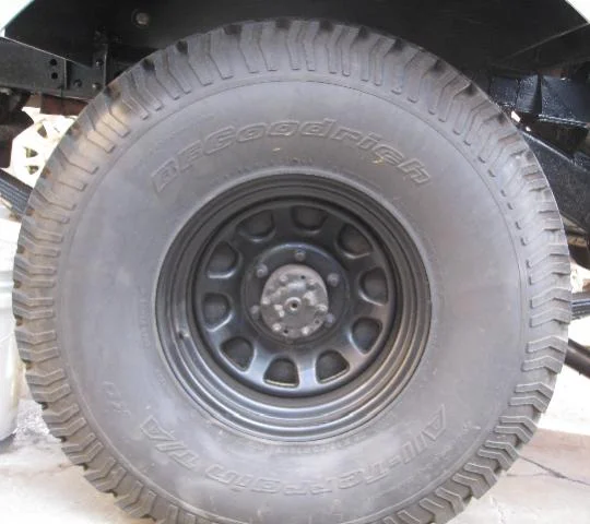

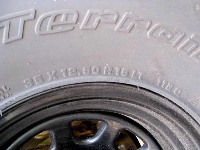

your ideas about the tire are very useful, i currently have a 35" diameter tire on 15" wheels. however they are about 1.5" too wide, this limits my turn ratios. i want to stay with 35" but narrower about 10" wide. the 315x75R16 is available in the US, the 255/100R16 may not be available in the US. the other possibility is a 285/75R16 they are 33" in diameter.
my last option (not preffered) will be 1.25' spacers on the front wheels,
what about different rims, getting the track wider and the wheels futher out? It´s the same for the bearings but one part less to fail and cause breakdowns.
what Diffs are inside FJ or BJ ?
(With the shorter BJ ratio the 255/100 would be perfect...and you should be able to get them in the US too. They are quite expensive, though longlasting)
Everthing has advantages :hhmm:...I think I would go with 35" R16 or the Michelins with different rims or if you dont get any with steal spacers

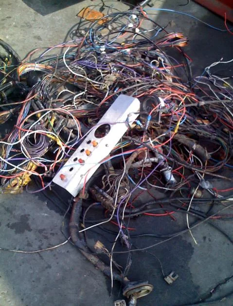

1. we decided to change all the wiring of the Nulla. thanks to Specter Off Road SOR.COM they had the wiring harness. the irony is this, one of the reasons we bought the Nulla is because it came with about 4 radios, wired for lights and many low voltage plugs. in short many wires. well it turns out that making all the wires work is much too complicated, so we decided to take it all out and start over again. tomorrow we install the factory harness we got from SOR.

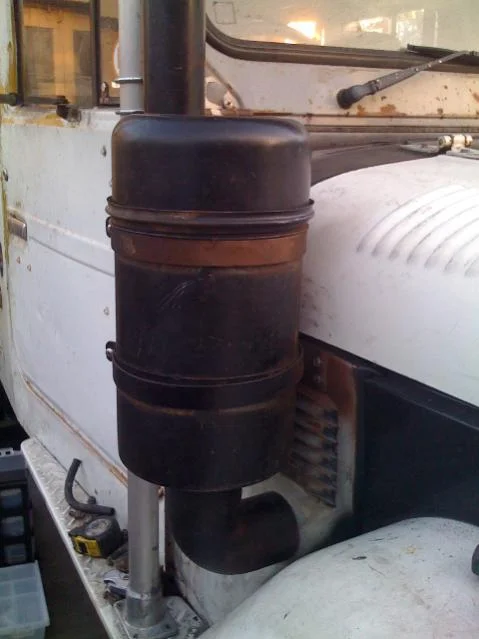

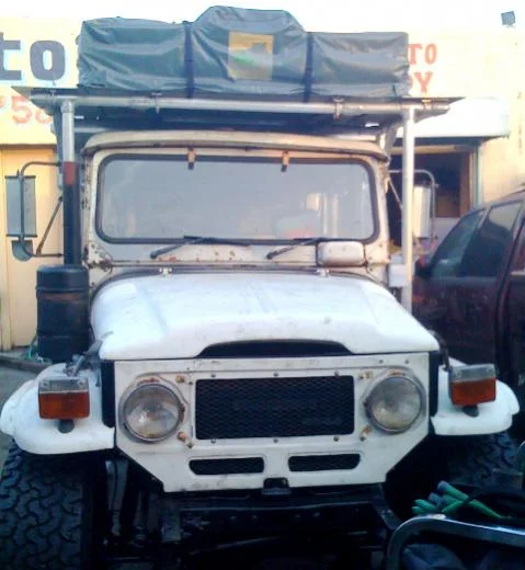

2. we decided to install the air cleaner outside to create more room in the engine bay. see picture below.:bounce::bounce2:

more tire thoughts: what about 8.25r16 ?
Larger trucks use them around here. Firestone makes one. I haven't measured, but they look like they are about a 35" tire that is around 10" wide
Sandcruiser, the 8.25 R16 are quite difficult to get in Afrika and EU (here Michelin XZL), they are tall but very narrow.
Advantage ist that they cost a little less and might work without changing the Diffs.
I have been looking for them for the HZJ 71 of my wife, but did´t get any at that time. I have heard Michelin is more or less selling them to military only ?
Rideglobally,
again, what rims you use, with ET 0 ? I wouldn´t mind the wider track (ok you have to change the bearings more often but driving performence benefits too), but why use spacers that might cause a problem if you can solve all the problem with the rims?
35" (= 315/75) I would use 8" rims, with the 255/100 (= 9.00R16) 6,5" and with the 8.25 6" rims.
But when I look at your car and how wide it is I would try to increase the track width and go wit 315/75 R16 on 8" rims, ET -25 might fit to clear the front tires :hillbilly:

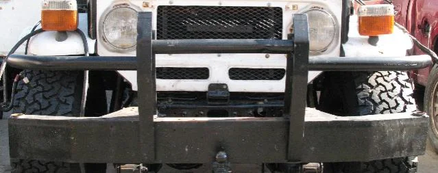

tire and roo bar
Rideglobally,
thanks sancruiser and soenke, been busy trying to get it together for the 3000 mile (round trip) trip to Auburn, Washington. made progress today connecting the "new harness" radiator had to be taken to the shop for modification, etc. i am sure you all can relate. tomorrow our goal is to fire up the 12ht. we will see when the key turns. so many loose ends still. the other thing i did was to cut down the roo bar. see the picture and know this is first draft. i am trying to lose some weight and my plan is to cut the bumper about 6" from the frame.
input on the tires and wheels has been very helpful. i am considering the 315/75 R16 with a negative off set of 1.25 to 1.50 inches. i like the idea of widening the track with all it's positives and negatives. i made a call to a tire company and their initial response is yes on the negative off set and stay away from spacers. when i get the cruiser up and running again i will take it to a wheel and tire shop.
this will mean that my wheels and tires will be up for sale, pictured below, i will place them on the classified when i am ready to sell .... thanks:bounce::bounce2:

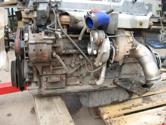

When you're at it, i would fab up a 3.5 inch turbo dumppipe followed with a 3 inch exhaust. I did this 3.5 years after i did the swap and regred that i didn't take the time to do it right away. It lowers the EGT's and you get some extra power to boot.
Here is a picture of the dumppipe i fabbed up. It's mounted in this picture.
Another angle. Don't look at how dirty the engine is. Mud will do that. I did paint it after the rebuild...:crybaby:
Can't wait to see the finished project.

Hi,
I'll answer here instead of in a PM.
The dumppipe is the cast elbow on the back of the turbo on which the exhaust bolts. It only has a 2.25 inch outlet, so it restricts the outgoing flow, which results in less power and higher than necessery EGT's.
I ordered the needed flange from suprasport. And worked from there.
LIPP Turbo outlet flange
Don't be tempted to buy the complete dumppipe for the supra. It will bolt up, but puts the exhaust thru the hood.
It takes a little more time to fab up than just bolting an exhaust to the OE dumppipe, but it's worth it.
The blue silicon hose is for the intercooler. I'm not sure if it's possible to fit one on your Cruiser since you have A/C installed. You probably don't have enough space to fit one.
I think i have some more pictures of the downpipe when i was building it. I'll look for them tomorrow, the pics are not on this computer.
HTH
Mark

i ordered the flange, thanks .... a fabrication picture would be helpful if you find one .....:bounce::bounce2:
okay, the 3" will lower the EGTs and will allow the turbo to spin up quicker but you will not gain power by a larger exhaust. that is a falicy... your HP and Torque figures stay the same...
In theory you're completely right. But somehow the boost increased after mounting the dumppipe, without touching the boostcontroller and there is no smoke on a WOT acceleration. It doesn't only feel quicker, it is. I guestimate around 5 to 10 HP gain. In febuari or march the troopie will be dynoed so i finally know real numbers.
Also i'm in a constant battle with my dad, racing our Cruisers against eachother. For fun tho.I could never win until the dumppipe was fitted. The difference is to big to only be the little quicker turbo spool.
If you're ever over on this side of the pond. Let me know, i'll take you out for a spin.:flipoff2:

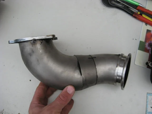

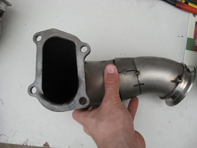

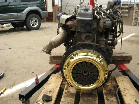

Found two pictures, i hope these make sence.
Mark
thanks very helpful, my other question is this, why reduce to 3" why not make the tail pipe 3.5" all the way down or go to 4" if the 3.5" is not available, in other words the complete system from this point on? also, what did you use for a gasket, just realize i did not order one, i am sure i can figure out how to fabricate one of those.
thank again, very helpful and timely:bounce::bounce2:
