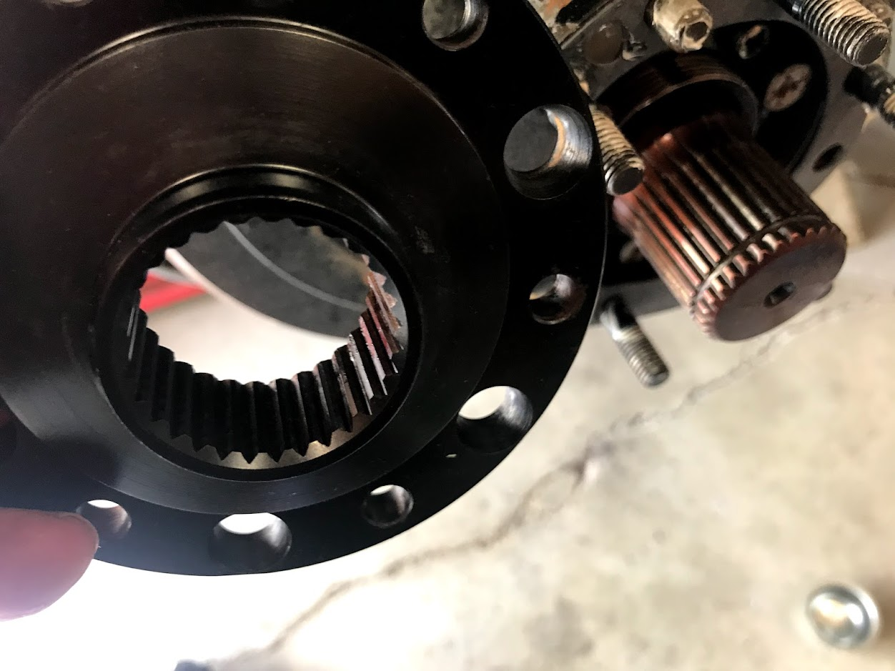

Here's a picture of one of @spyduh RCV rear flanges ( not good ) Our set ups are close to the same and we are both running 39s . Seeing that picture of his flange is what prompt me to inspect mine.
This should not have happened, and what is really baffling is that both sides totally failed like that. 🤷‍♂️ :mad:

I wonder if it’s a bad batch of heat treating? If either of you have hardness files you could check his vs yours.

That brings the suck, but better than a shaft.

The shaft was chewed up too. Lol that's 300M shaft on 4340 Chromoly flange. My 529s survived. I'll take it outside failure all day long vs inside diff going out

RCV is taking care of it and warranting my shafts. They are checking hardness before they ship them out to me.
Bad batch makes sense, mine are a year older with many trail rides on them.
Yours are new and failed first time out= bad batch ?

very first trip out. It had couple hundred street miles from home to Fordyce Meadow Lake and then it was done on WH1 and WH2. WH3 is where i blew my stock Aisin hubs, but by then I was trying to wheel up WH3 on front wheel drive and winch assistance. Has to be bad batch.
