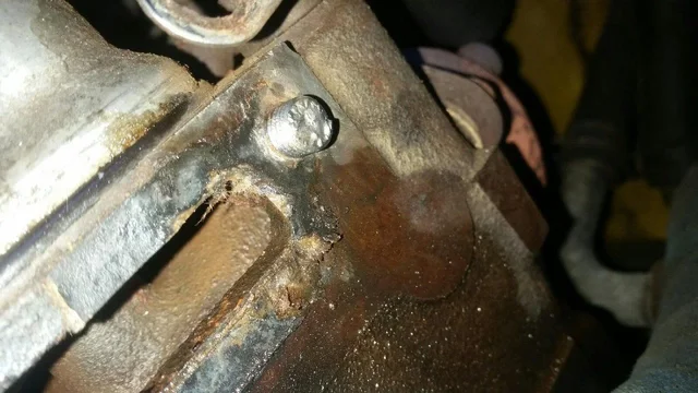

Broken Thermostat Housing Bolt. Now What?
That's one heck of a stuck bolt. I had a similar situation but my stud actually sheered in the housing. Used an "Easy-Out" to remove it. You just drill into the bolt with one of the included bits, and then use the reverse gripper bit after you have gotten sufficiently deep enough with the standard drill bit. Mine, luckily, came right out. Although in your situation I don't know if the easy out would've worked so efficiently. That bolt is really bad if you can't get it out with heat and some vice grips.
canned heat isn't really hot enough for this sorta thing. it doesn't get the piece you want to heat hot enough quickly, before the piece you don't want hot, gets hot too.

You really can't rely on a Mapp torch , it's not a fast enough heat nor concentrated enough .

It's hard to tell at which point I might melt the housing. Lesson learned. Welding a nut would've been a safer path.

Unlike Weber Sarge and others, I have had a hundred percent success rate with a handheld propane torch.
X2 on the propane ... I don't know if one would consider it wrong but I always heat the housing

Oh and the MAPP gas works for me and can get things pretty hot (full disclosure this was two torches to do this but I don't think you need to get the bolt that hot)...

Well. Turned out the old tried-and-trued "weld a nut to it" worked great. Just as always. And of course the second bolt broke off too.

First step: clean threads with wire wheel.
Third step: weld! Don't tack weld the nut on there. Burn it on! You need the heat from the welding process to transfer along the broken bolt to help break up the rust, corrosion and calcium build-up around the threads.
Step four: grab a wrench and twist the bolt back and forth to pulverize the corrosion build-up. Washing it off with something like PB Blaster doesn't hurt. Once it starts to tune freely, unscrew it. If it starts to snug up, run it back in.
Repeat process until you've got this puppy in your hand.
