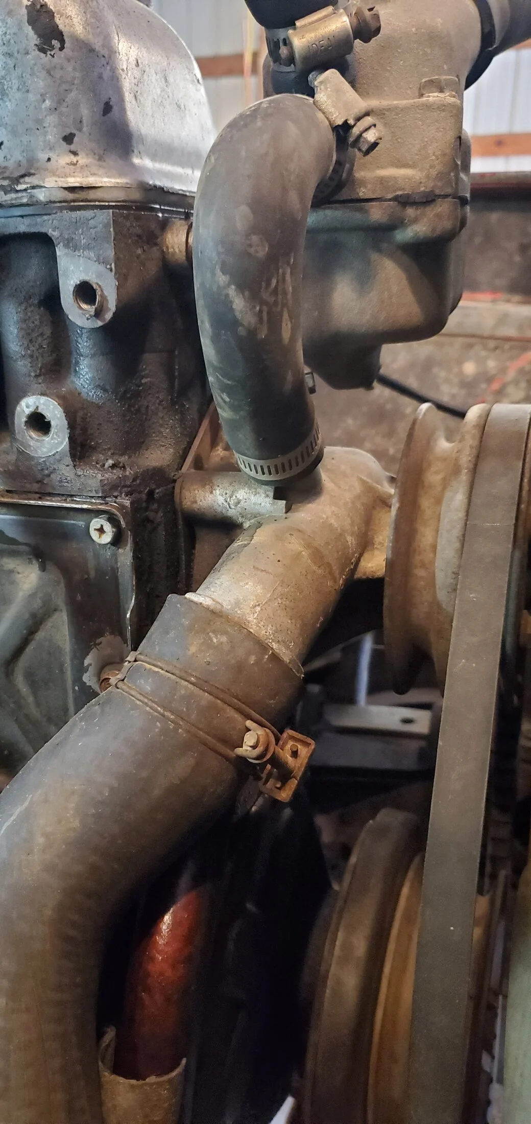

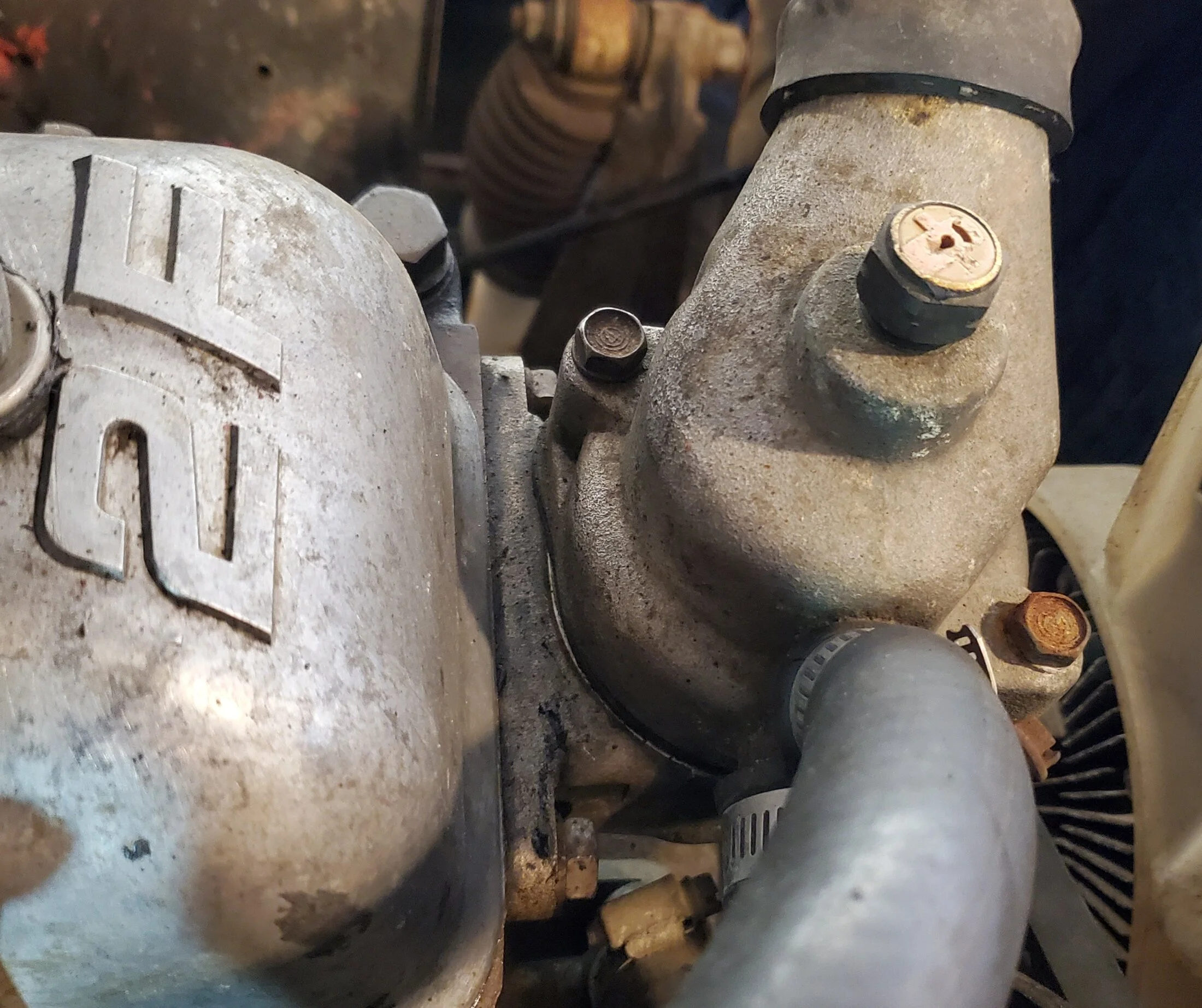

Not sure if this helps you, but here's the thermostat housing for my desmogged 79 2F with oil cooler. I was under the impression that the 1F bolt pattern was different?
About the oil cooler, I'd keep it if you can as Toyota put it there for a reason. But maybe it's not needed as much on a desmogged engine in a colder climate. Definitely cleaner without it.
One more consideration about deleting the oil cooler, the other end of the oil cooler goes to the water pump. You'd have to figure out what to do with that (see red hose in the bottom of the last pic).
The biggest advantage of the ‘79 upper housing is that it aims directly for the height of the upper radiator connection, which means you can use a simple elbow hose, readily available just about anywhere. The 67-78 upper housings all sit ‘low’ compared to the’79, so they need a double elbow to go back AND down. Not as readily available.
