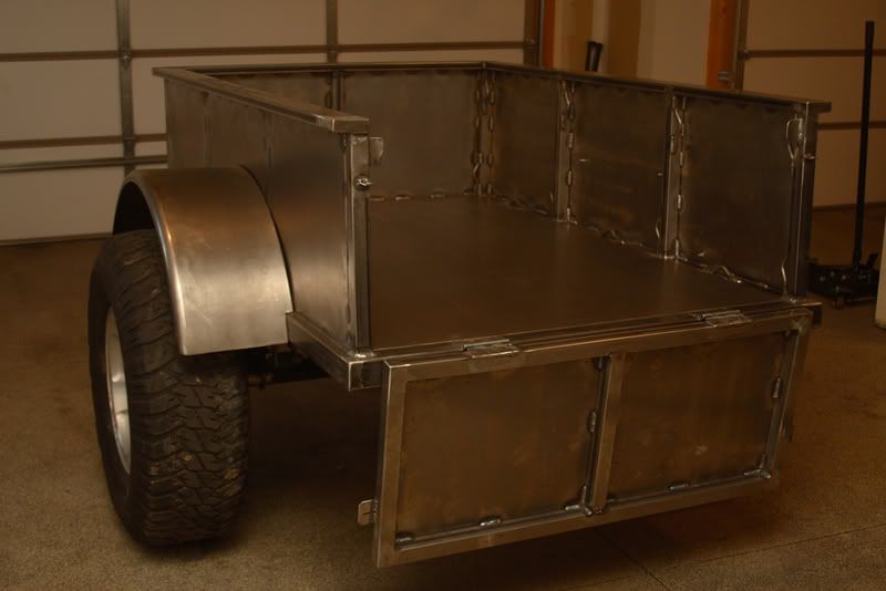

Well, maybe I'll reget it later on but what's done is done. I welded in the steel floor yesterday. I'm planning on use bed liner inside the tub as well as underneath. Hopefully it won't be too noisy but I gotta think, my flatbed minitruck had a steel deck and the floor in my reskinned 40 was the same 16ga. that was lined both sides and it wasn't noisy. I may get some dents in the steel that I wouldn't get with a wood floor but o well.

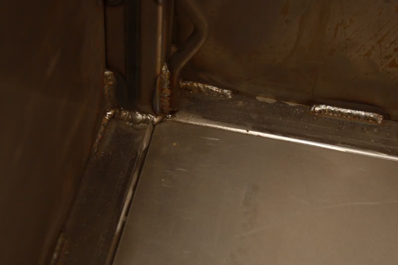

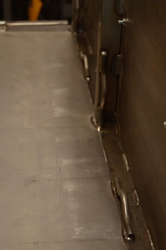

So after cutting the sheet to size I needed to "clearance" it a little around the welds for the tub frame and the tie downs.
Here's a couple pics where you can see where I did that.

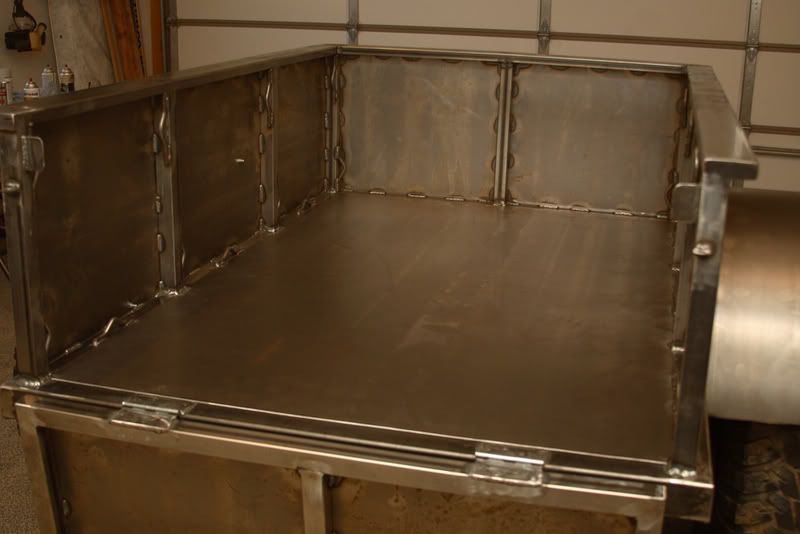

All fitted and in place.
Stitching it to the frame. Pretty much did this around all corners.

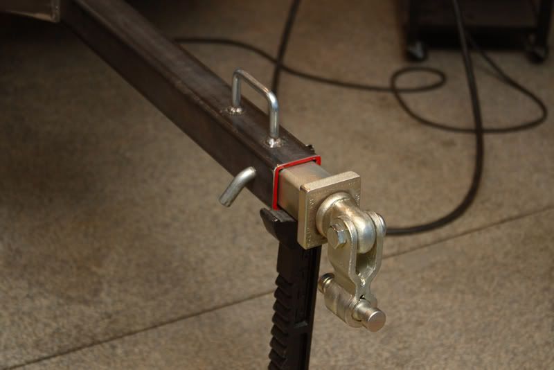

only other thing I did was cut down a ubolt to use as a tongue handle.

Very nice build. What did you use to support the floor around the edges? Is it just stitched to the frame or does it overlap a little?
There is not a significant overlap but it does overlap the edge of the frame slightly. The main support for the floor comes from the frame crossmembers. The edges are stitch welded (on the underside) with a 2-3" bead every 4-5". I am thinking of adding a couple peices of 1' flat stock welded in vertically (on edge) running front to back between the center and rear frame crossmembers to support those sections of the floor a bit more but it's probably unnecessary. I just have a tendency to overbuild. For my uses this frame etc is WAY more heavy duty than I really need. I mean seriously, worst case I'll have 500 lb of camping gear in the thing. And most of the time no where close to that much. But it's solid enough that if the need arises where I NEED to carry more, then there isn't concern about whether the trailer can handle it.

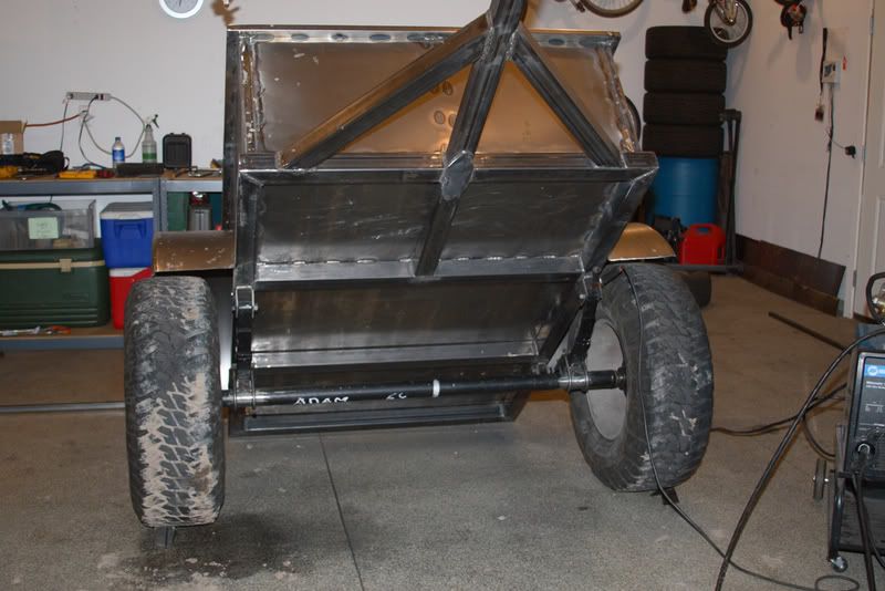

I got a few things done yesterday (sorry no pics). I was hopng to do more but my neighbor saw me in the garage and stopped to chat. That quickly ate up a couple hours. Then a friend called and needed an extra set of hands moving a TV. But I did get the captured nuts welded in on the inside of the tub for my plywood sides. I also got the reinforcement all welded up at the end of the tongue. I didn't have tube to slide over but I had some 3/16 plate that I cut and welded on. Turned out well. Then I used some of my left over 1x3 that I used for the tub rail and made some little steps at the front and back edges of the fenders. ALso welded a little tab on the steps to bolt the outside of the fenders to. Fenders are rock solid now and I can stand on them without any flexing.
