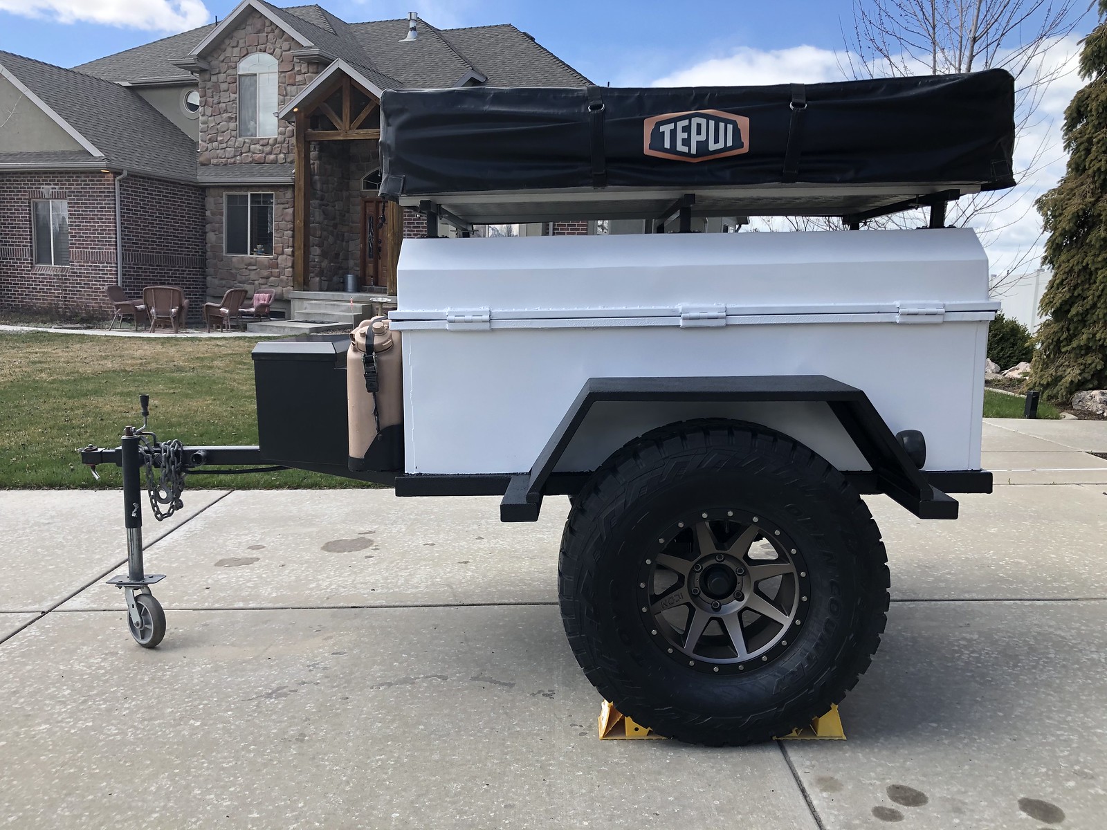

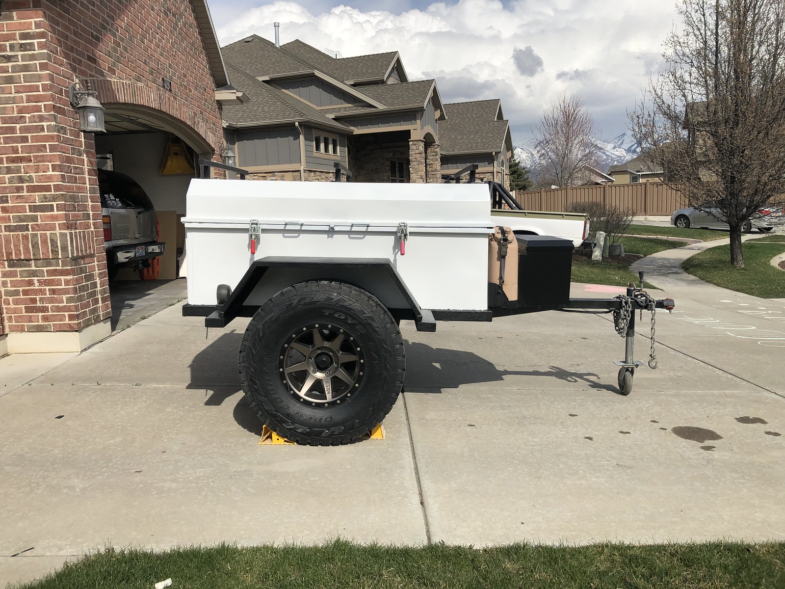

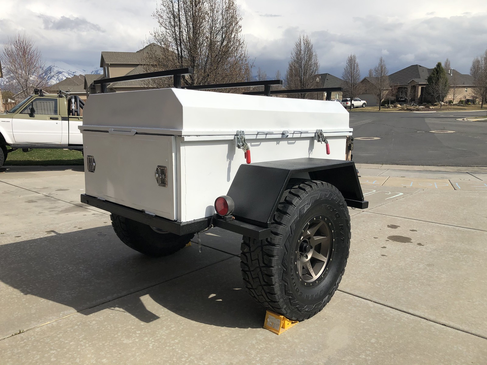

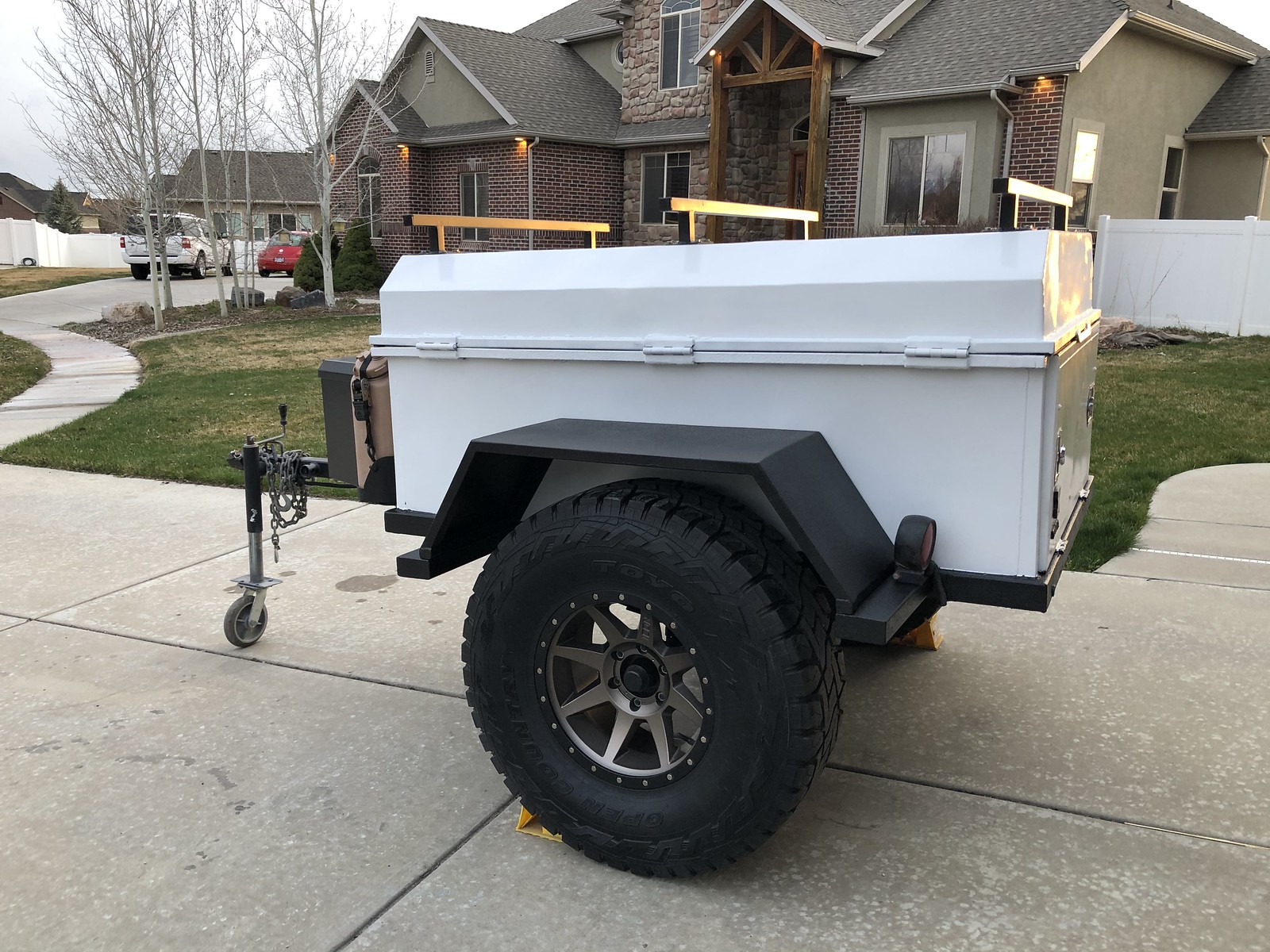

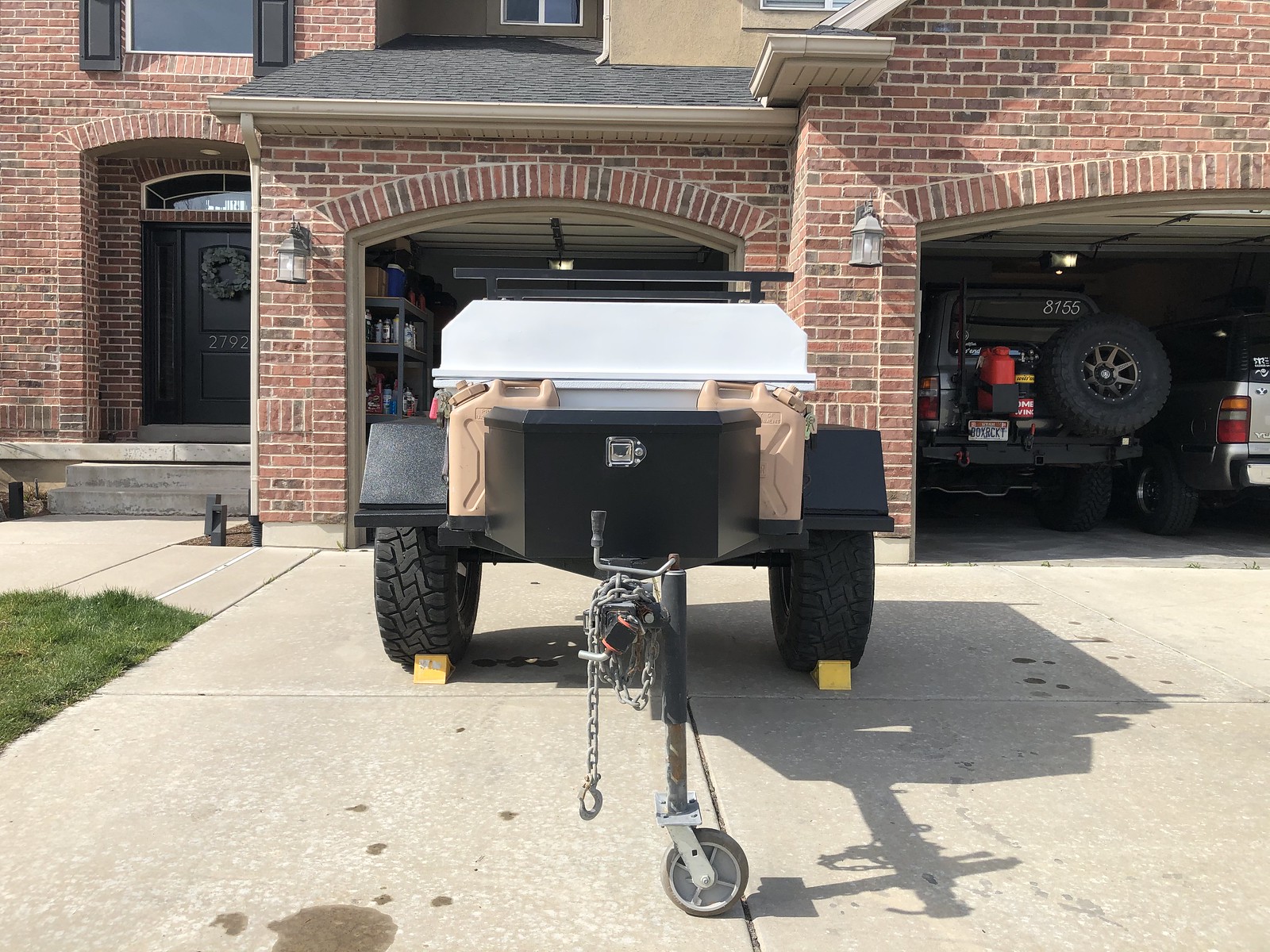

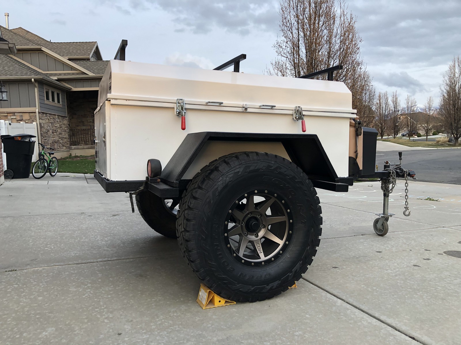

Alrighty. Here's where things ended up. After cutting a bunch of stuff off there were a bunch of places that needed to be touched up. Ended up recoating the inside of the tub with Raptor Liner as well as the new fenders. Thought about keeping the color matched grey (same as the Cruiser) but it's costs more to have color matched paint mixed up if I need to touch things up. So went with white. Makes it easy to do touchups and having it color matched doesn't really matter than much to me. Might do a little accent color of the Moonglow grey.

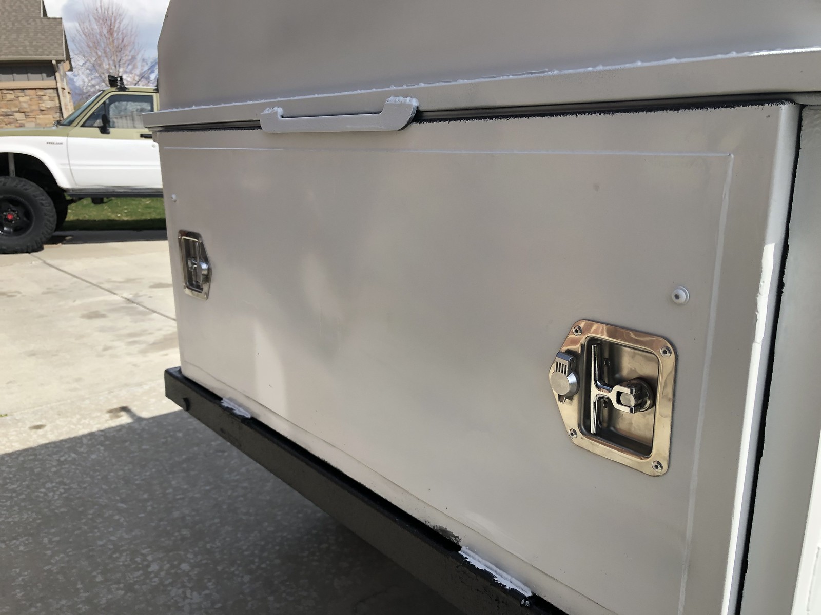

Added new latch brackets, changed the tailgate latches from pins to paddle latches, which is much nicer than the previous setup. Still on the fence about putting the spare tire carrier back on or not.

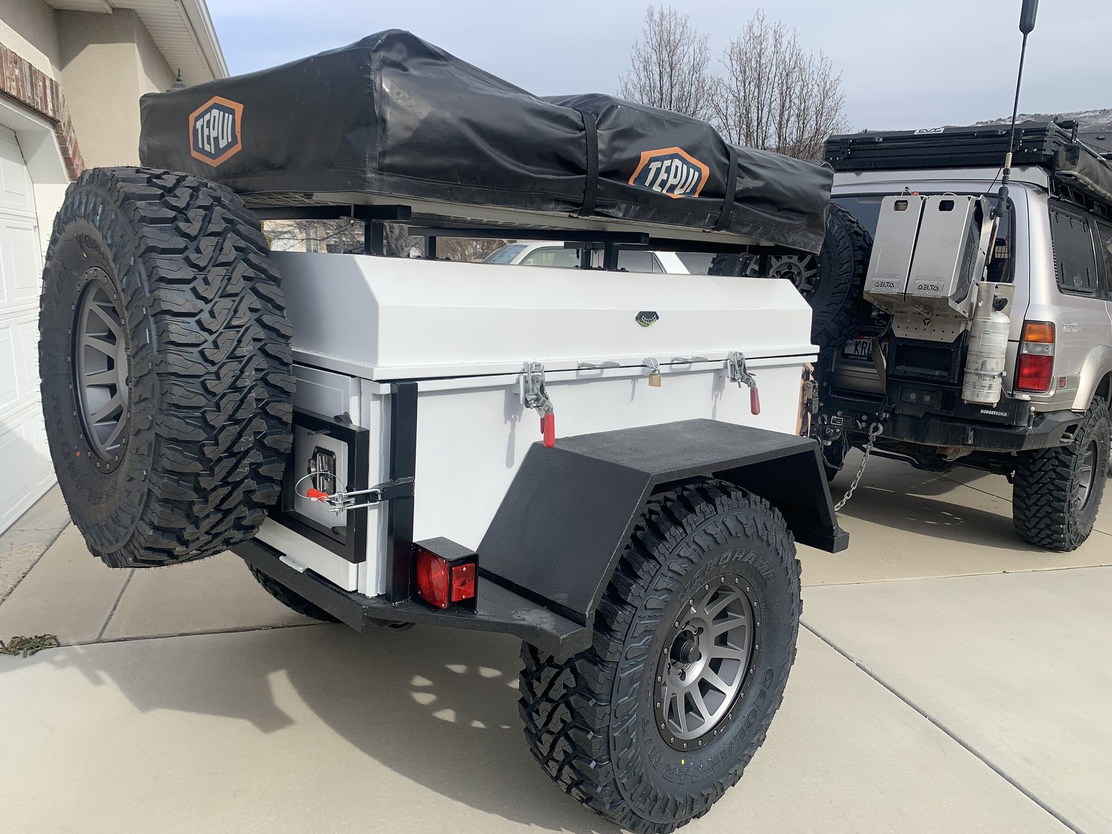

Hmmm. well a couple things...I sold the trailer this past spring to @Dirty Koala who has been able to use it a little since then. I was glad to see it go to someone I know well and that can enjoy it. I had plans for some additional suspension upgrades if I had kept it, and maybe Morgan will do some of those same upgrades down the road? I fixed up a few things prior to the sale to Morgan. It got a fresh coat of Raptor in the tub and fresh paint. New taillights and steps and got the tire carrier put back on.

First off, I think a lot depends on how you intend to use your trailer. I would answer that first for yourself. For example, if you are just planning to take it on fireroads and moderate speeds to some pretty accessible camping areas then your needs will be different than needing a trailer that can handle high speeds over rougher terrain or being pulled through the Rubicon. When I first built the trailer I planned on it getting used in difficult terrain and I wasn't going to be easy on it so that is what dictated the heavier frame and making decisions to weld the skins and weld the tub to the frame etc. I didn't want fatigue areas that would have issues over time if they were not welded. I definitely pulled this trailer much faster through rough roads than most people would do with a trailer and I'm glad I overbuilt it. So give some thought to how you want to use it.
The lock-n-roll worked pretty well while I had it, but it did bind up and bend during a jackknife situation. I've heard that the design has been updated to keep this from happening but I switched to the Max Coupler at the time and never looked back. The Max Coupler was great. If I were building another trailer I would get a Max Coupler and not give it another thought.
The raptor liner held up really well considering that I built the trailer originally in 2008 and didn't touch up the liner until this past summer. It was still in decent shape but needed a little touchup. I lined inside the tub as well as the underside of the trailer. The underside definitely took the most abuse because of gravel being kicked up and hitting the bottom of the trailer, the axle and inside the fenders. The white on my trailer is all paint, no raptor on that stuff.
