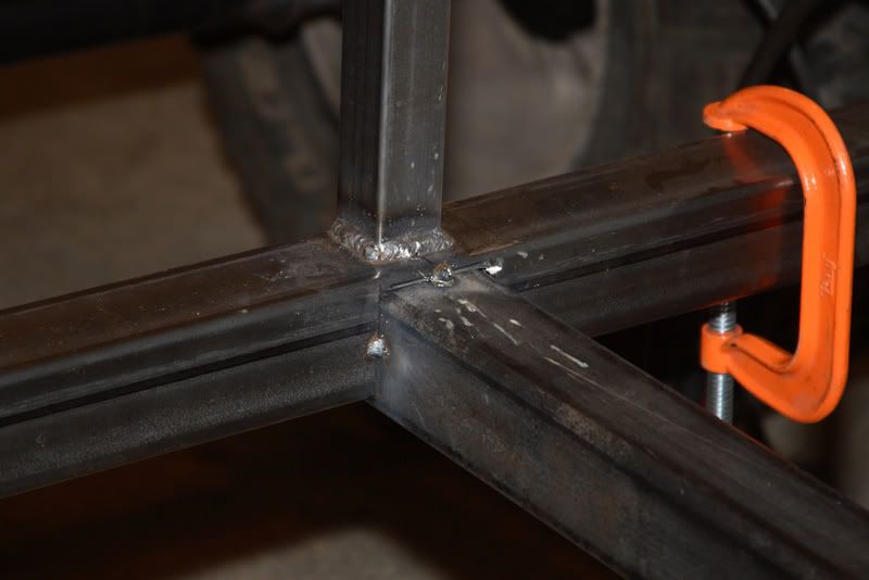

Also, you will be just fine welding up the sides. I probably should have done that too.

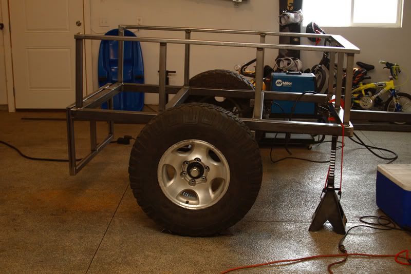

I got a bit more done today. After a good hour shovelling snow off the driveway and the walks, I headed over to Discount Tire to get the 285's mounted and balanced on the 80 wheels I got from jaysdead40. I've been getting my tires from Discount for quite a while now for all my cars and even though it wouldn't have cost me much for the mounting and balancing, they did it for free. Was a nice gesture and as small as it was, it will keep me coming back. But the 285's look much better on there.

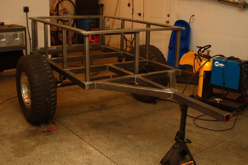

Then I got to working on the tongue. I cut out the front and bottom of the front framerail and slide the tongue into the opening so that I had three surfaces to weld to along the sides and bottom. Seemed like a better idea than just butt welding it to the frame.
Then I welded in another section between the front framerail and the first crossmember. At the seam between the tongue and this new peice (on the underside) I welded another 6" plate to span the seam and tie the tongue into the center tube in the frame.

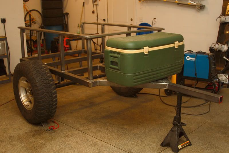

Test fitting one of my coolers.

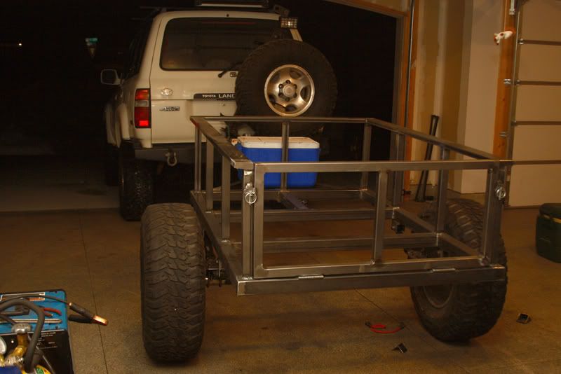

Then I got to work on the tailgate again. I went for simple with the latches. A couple of crappy welds, but probably not worth cutting and and redoing. Anyway, I welded a tab on the tub upright with a hole in it. ALso welded a small plate on the inside of the tub upright as a stop for the tailgate. Welded one more small plate with a slot cut into it to the side of the tailgate. This slot slides over the tab welded to the tub. Then its just a simple pin with a cam-ring to lock it. I could also use a padlock if I wanted. It's simple but I was excited about how solid it is. No rattles or flex at all.

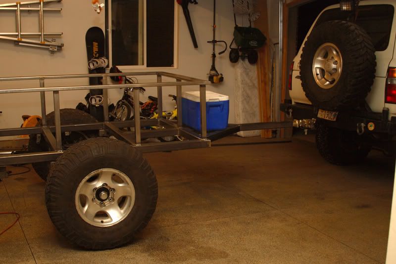

I capped those holes on the tub rails also but forgot to take any pictures of that. I still need to drill the hole in the tongue for the hitch pin but I pulled the truck in to see how everyting was lining up. Everything appears to be just about right. I have Monday off so hopefully I can maybe get the skins on it.
