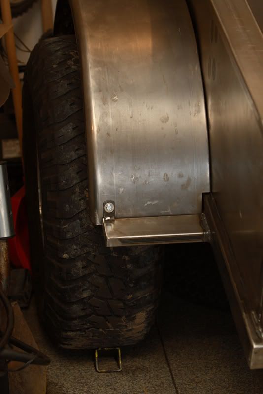

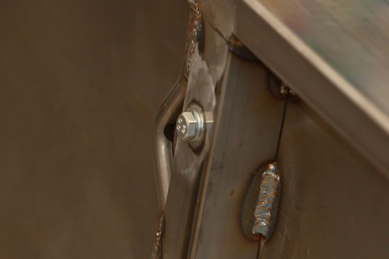

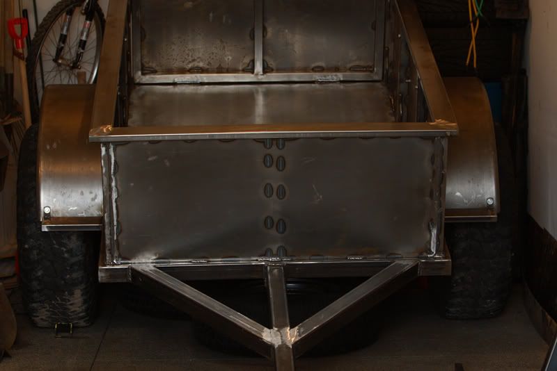

Gosh, Henry sending me on a guilt trip.:flipoff2: I had to go snap a couple pics.
reinforced tongue...
captured nuts, there's one in each of the tub uprights so I can bolt in my plywood sides.
Steps and fender tabs. Nothing fancy but enough for an adequate step and really holds the fender solid.

Those steps look great! They're not too big but are definitely functional.

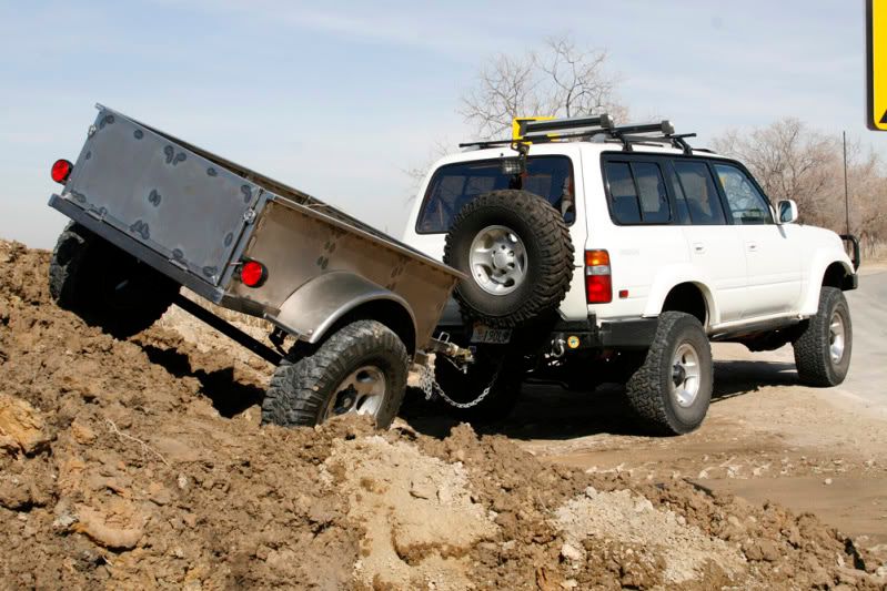

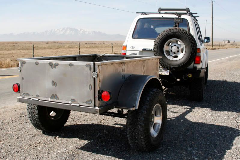

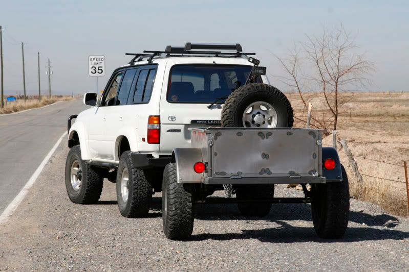

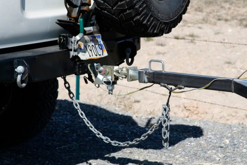

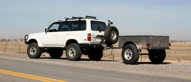

I got the last bit of welding done (except for the lid) today. That included a couple more floor braces and loops for the safety chains on the tongue and the truck. After that was done I pulled out my magnetic towing lights and hooked it all up and took it for a spin. Ran it down a gravel road near my house at about 40mph. Bounces a bit, but I'm sure most of that is because it's empty, and there were some good potholes. Got it up to about 60mph on pavement. Tracks straight and obviously can't even tell it's back there since its empty. Found a big dirt pile and tried my best to check the lock-n-roll. So far I'm really liking the hitch. Doesn't make any noise that I can hear and I'm sure will work well on the trail.

Here's a few pics from the test drive.
My temporary magnetic towing lights and I need to get new hooks for my safety chains. The chains have those threaded chain links on the ends and they don't open far enough to go onto the chain loops on the tongue so there is an old ratchet strap hook on it for now. And yes, I'll run two chains not just one.

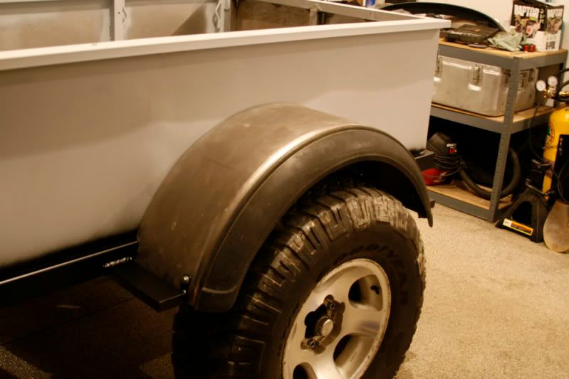

Only had a few minutes tonight so I got the CJ flares mounted up. Hoping to finish up primer and paint on Saturday. Then spray the bedliner next week.
You can see that these fenders and flares are very close to covering the tires. I think its good enough for me.
Great fit on those flares. Looks nice!
