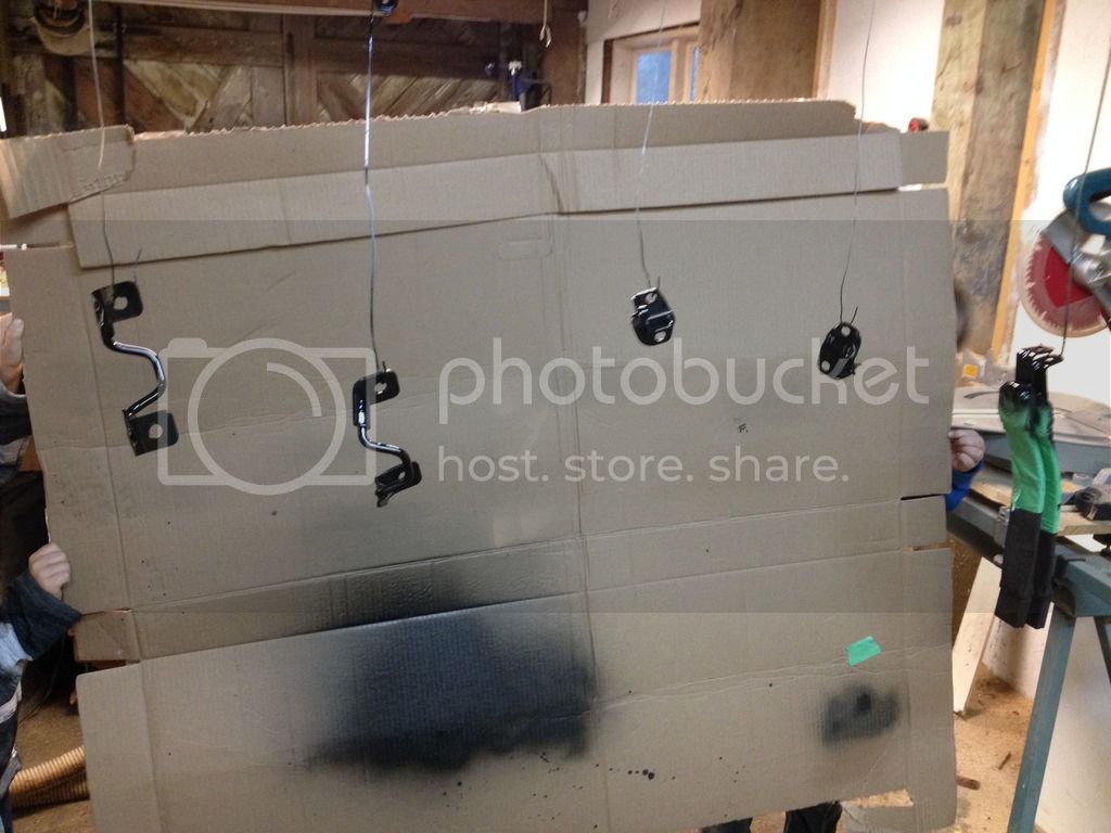

After media blasting these brackets, I threw on a coat of rust preventer and then gave a few coats of gloss black today.

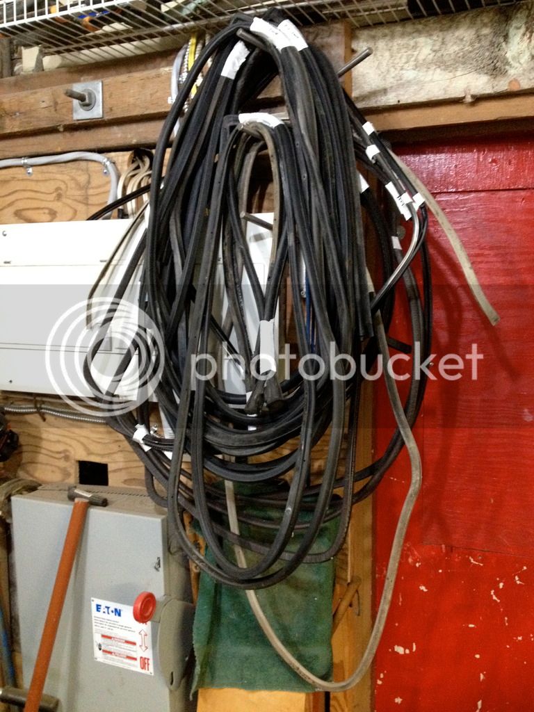

Also, all the weather stripping and rubber is off the doors and rear hatch so they can be prepped for paint!

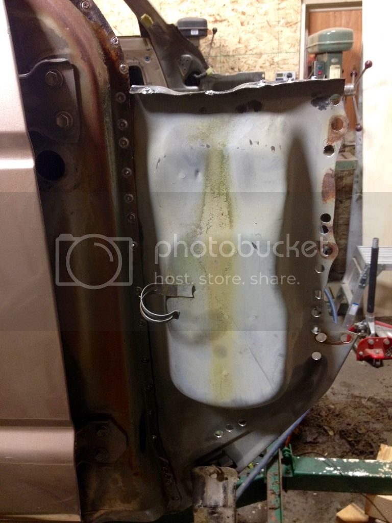

Started on the spot welds to remove the firewall tonight.
All I will say is I wish I had three apprentices. One to drill; one to apply cutting fluid; one to bring me coffee as I watch.
Seriously, here's a pic of the easiest part; No seam sealant to cover the welds and a nice height to lean into it with one hand and add cutting fluid with the other. The sides and underneath just plain sucked. And I've only done about 1/4 of this firewall and I still have a complete other one to go! Anyone want to come over and "play" for, say, 4 hours? :meh:
It will be worth it in the long run and my time is cheaper than just about anything so I will have to endure.:bang:

Be accurate with your 1/8 pilot holes. Nothing sucks worse than chiseling the welds because the drill bits missed. Try not to distort the backing metal (the piece you aren't removing) as it will make fitting the new piece soooooo much easier. Don't forget the weld through primer. Just my .02 (not that you asked or anything) :beer:

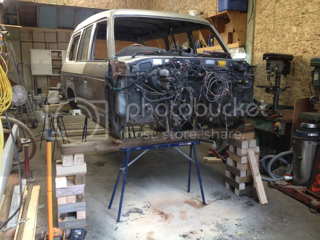

Progress Report. Should be able to get at the last few spot welds on the firewall now!
Fuel lines disconnected.

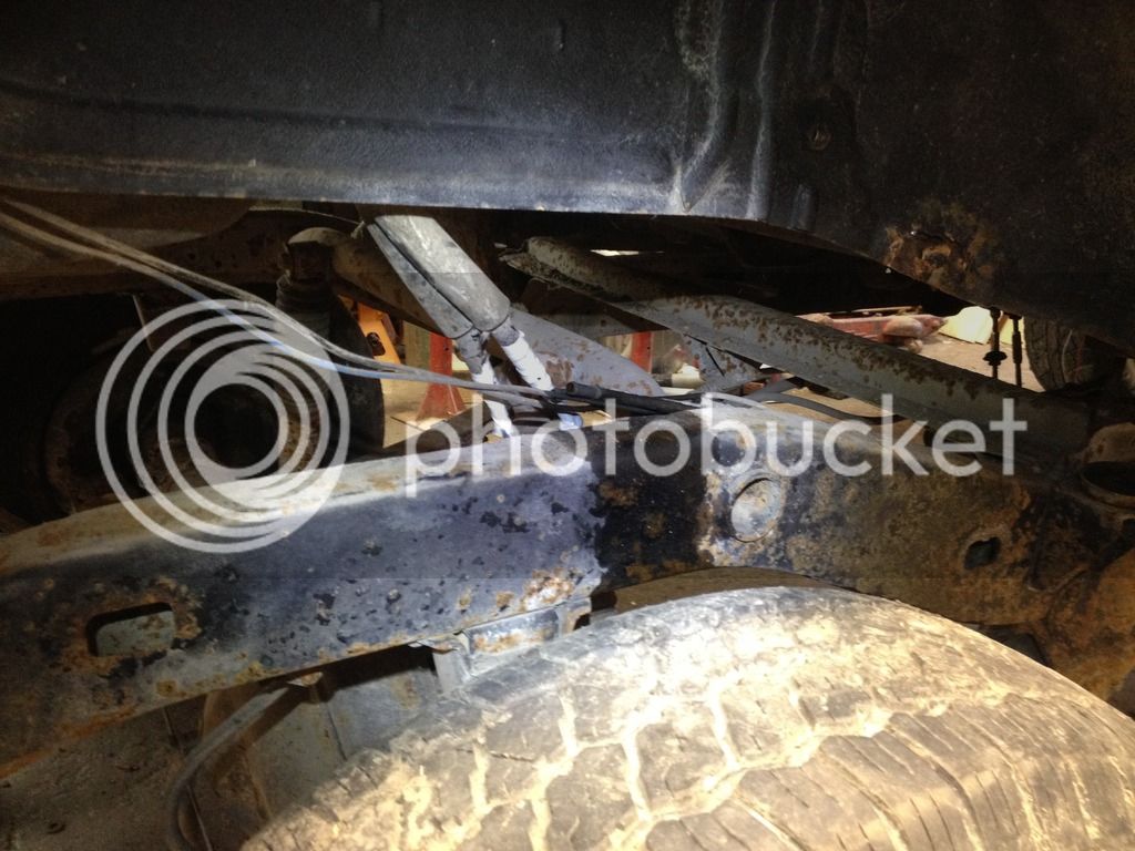

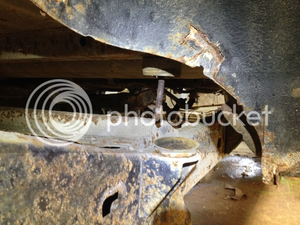

Body mounts disconnected.

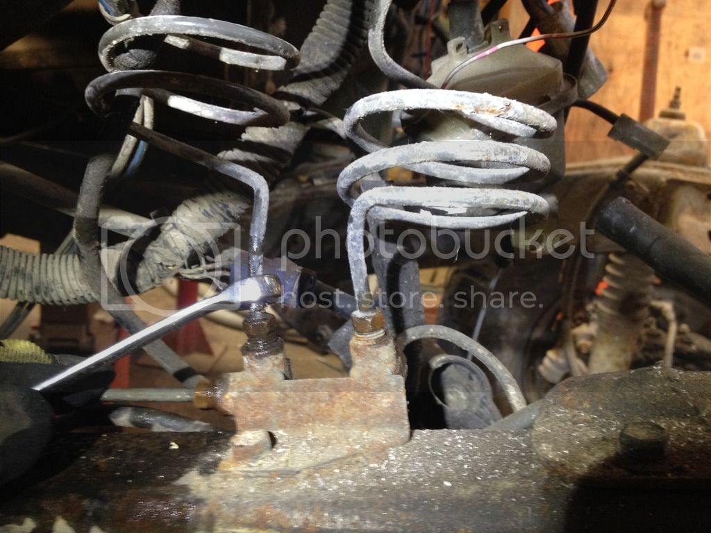

Brake lines disconnected.

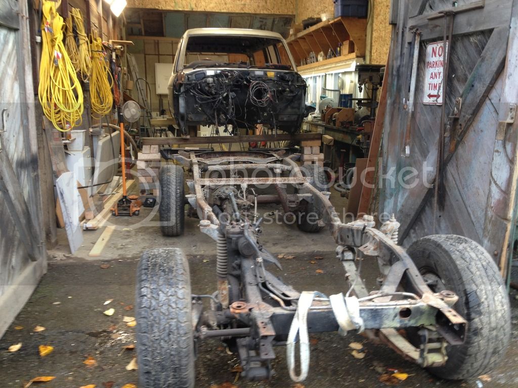

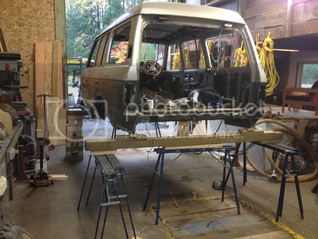

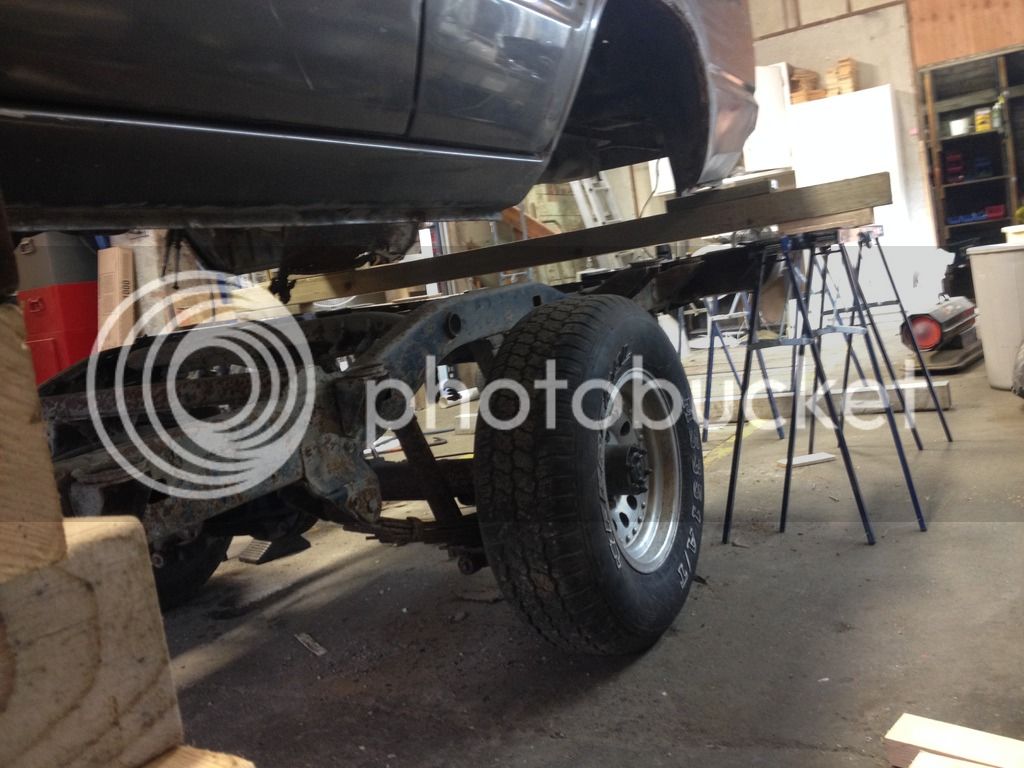

And up we go! Holy precarious Batman! Was wishing I had an I-beam with chain hoists at this point! On the wish list I suppose.
Frame safely cleared and outta there!
Body front.
Body Rear.
Not too sure how I ever thought this would take just a couple weekends...:bang:

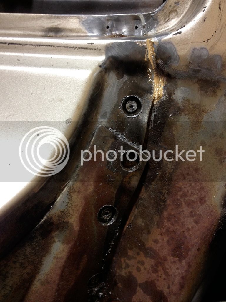

A milestone evening! The firewall is finally out. Let me tell you, if you are ever considering doing this job and you don't absolutely have to, then don't. BUT, if you do, give me a call and I'd love to offer some tips to make things go easier. For example, exactly which welds/joints to drill out...as you can see, I did an entire column down the inner seam that I shouldn't have done. I'll just Mig those up and grind them off and be done with them but it was time lost in the end. Oh, and having a JD as a 2nd set of hands is/was really helpful ;)

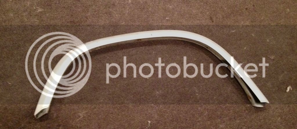

And, I found a set of used aftermarket fender flares (not OEM), so I think I'll paint those up a nice gloss black to give some contrast to the grey color I'm going to use.

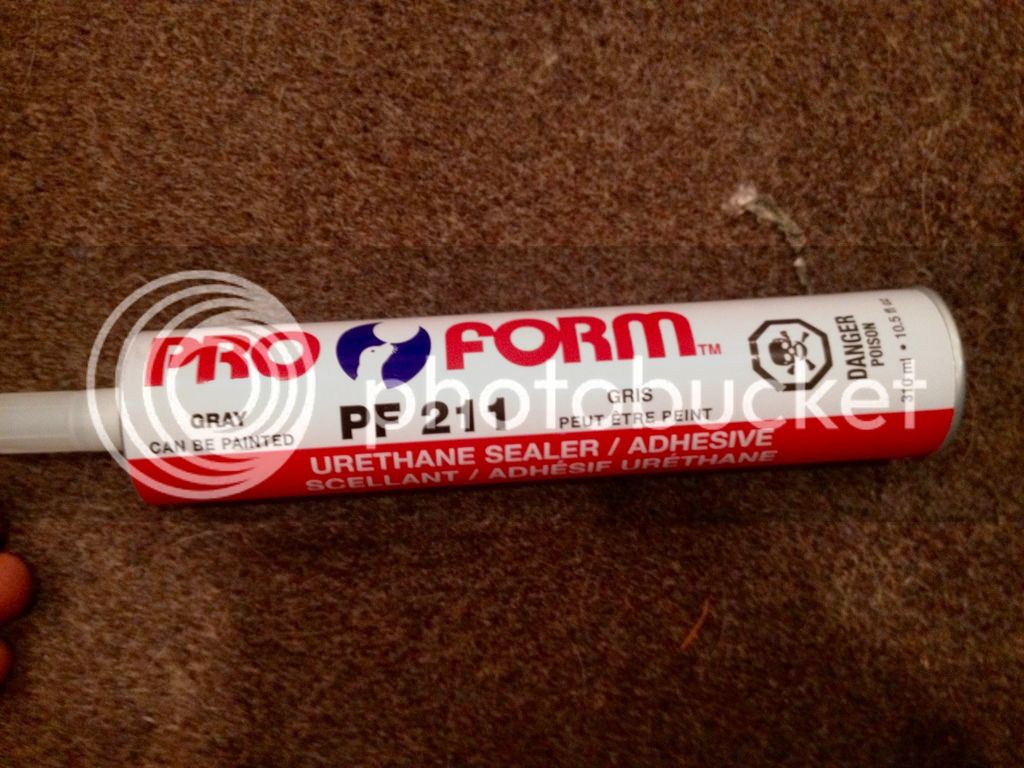

I also picked up a few tubes (6 I think) of seam sealer so getting everything back together should be a nice goopy fun job! And I'll redo the gutters at the same time. Lordco has them on for half price this month so I should be good...hopefully!
