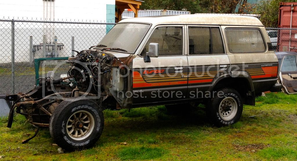

I picked up an HJ61 body from John @ RADD and will be doing a number of things to get it to work for our situation. It's on a rolling chassis, but only the body is mine. The rest goes back to John.
The plan is to cut out the firewall and dash from the RHD and replace it with my current LHD, allowing me to keep my VIN and LHD.
On the ups, I'll get a high roof body with very little rust (two spots on each inner rear fender well).

Here's the new donor rig, now sitting at my place in Mesachie Lake (Pic was at RADD). I plan to do as much as possible on my site.

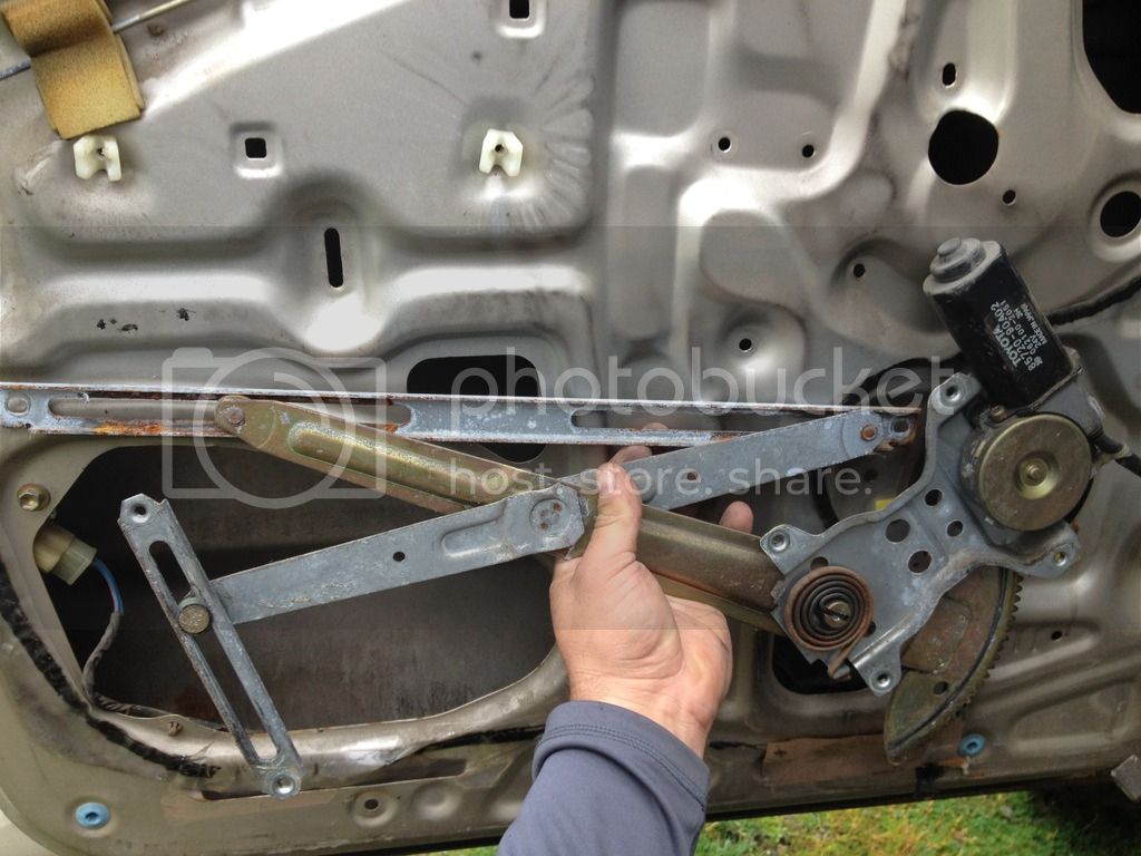

Out with the new and in with the old...right? Removed the electric windows and swapped in manuals. I like less things to go wrong.

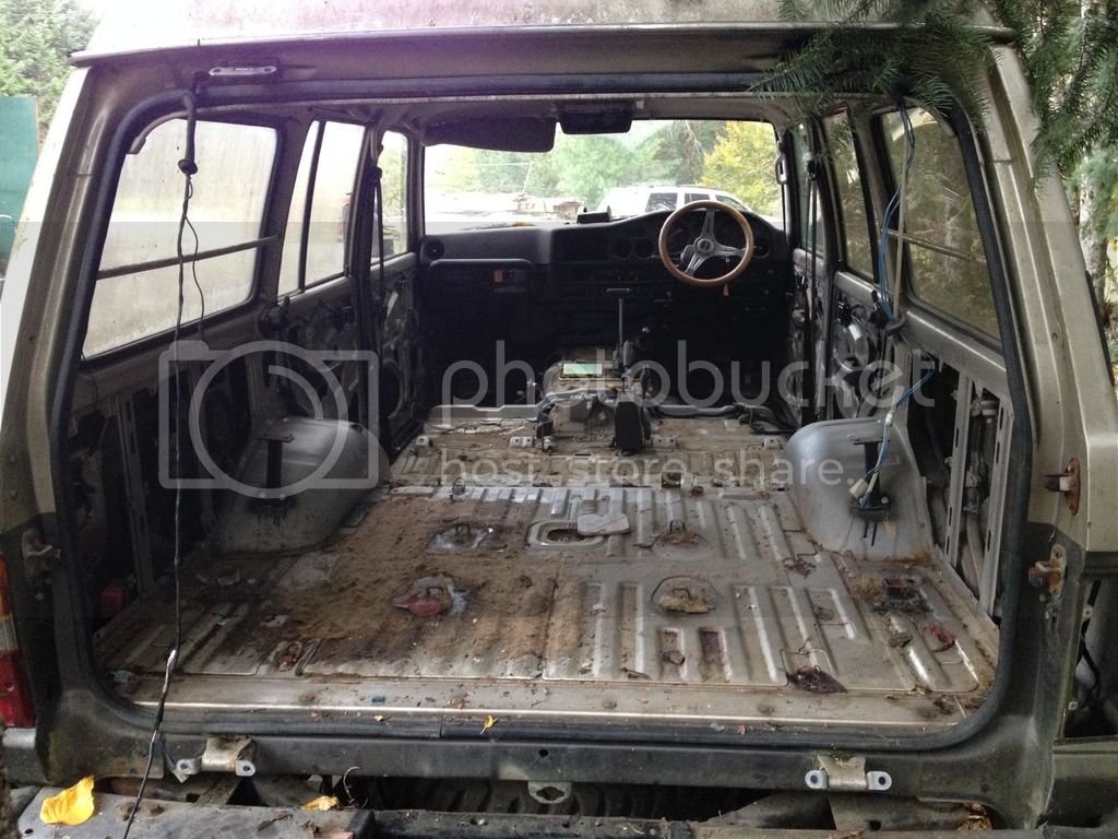

Gutted the interior today. Carpets and seats will get a power carpet steam clean and we'll see how they turn out. Idea is to get this thing ready for some paint!

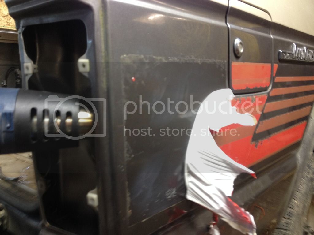

As far as the retro vinyl goes, sorry, but it's getting the heat gun treatment this week.

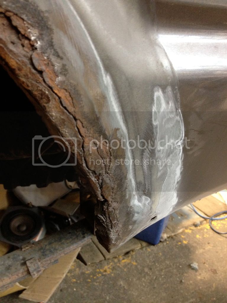

The fender flares are coming off. The body was missing the front fenders so we figured looking for flared fronts was going to be expensive so we chose to just remove the rears. After looking at some pics online with accented colors with the flares I was thinking about asking John what he'd want for them, but he did mention that they were not a cheap item. End of the day I need a good body, flares would be a sweet extra but not a necessity at this time.

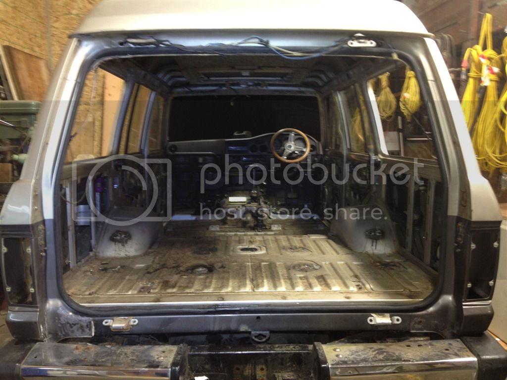

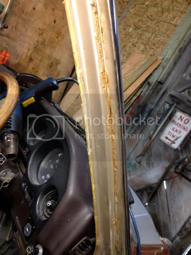

A bit of progress over the past week.
- Camping kit out.
- All windows out.
- Wiring harness back to firewall.

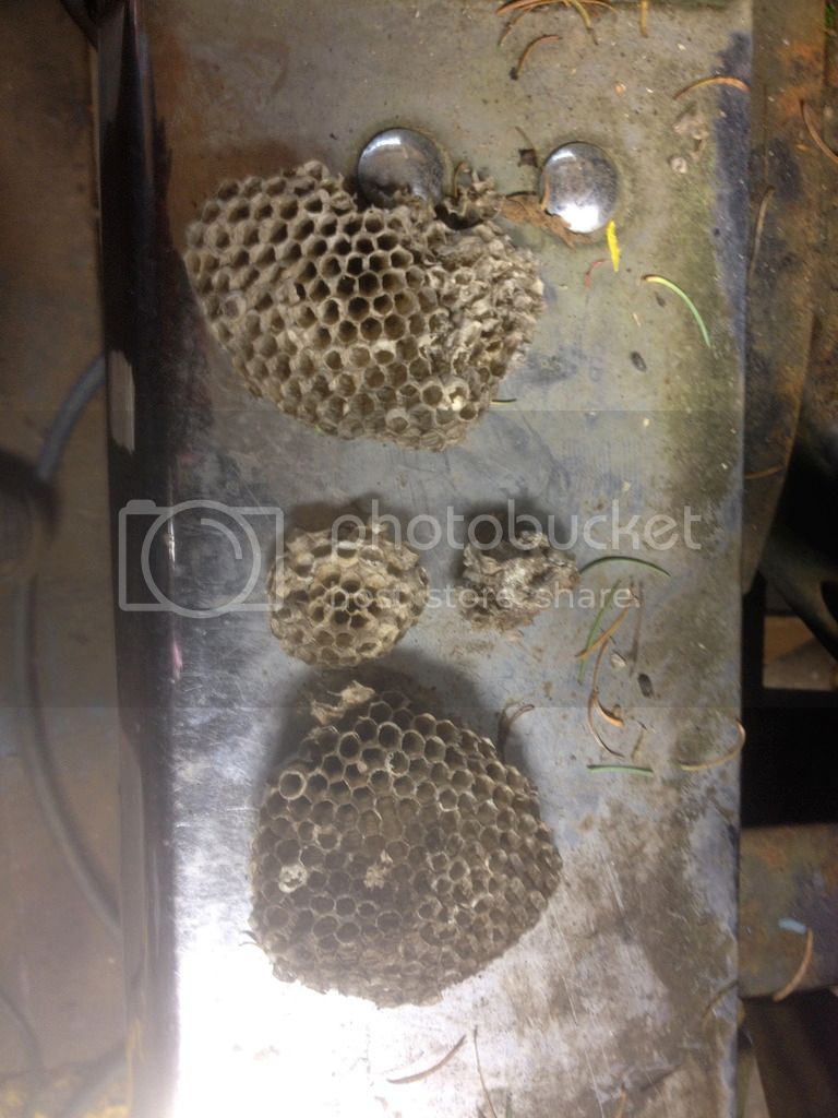

- Headliner out. Four wasp nests and rat poo so I'm glad that's gone. Wire wheeling the insulation from the ceiling sucked.

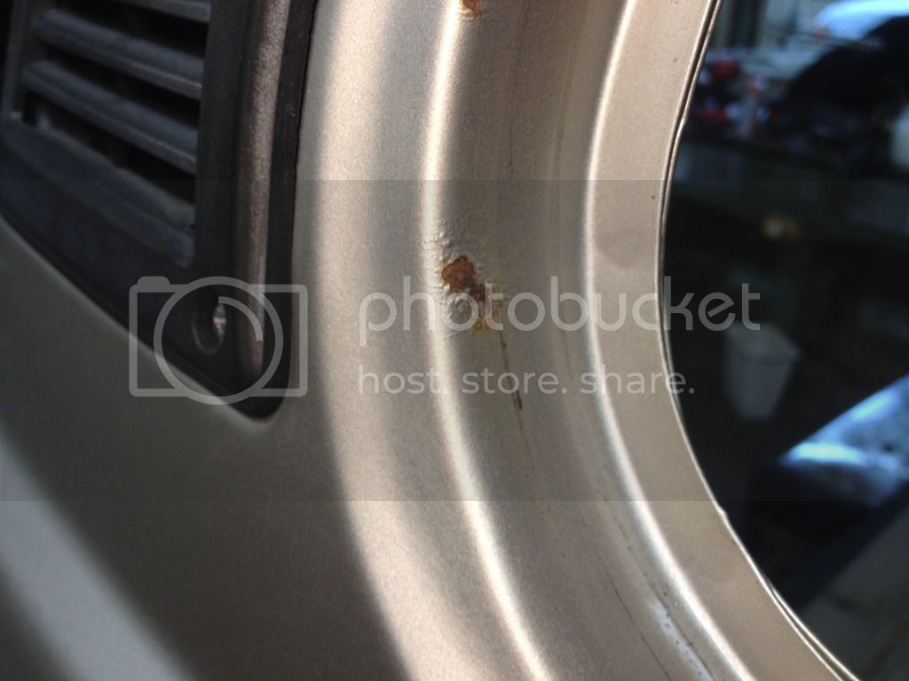

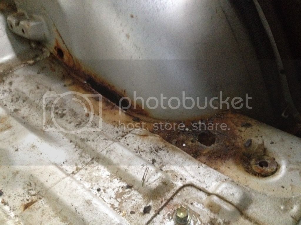

- Rust places exposed and wire wheeled.
- Gutters wire wheeled and ready for new sealant.

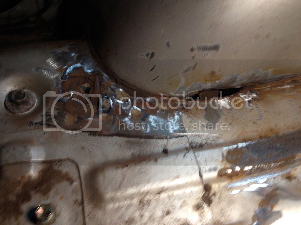

Places where rust will need "extensive" repairs:
- Rear Left outer fender flare, from top of arch to rear bottom.
- Both inner fender wells front of seat attachment.
- Both spots where rear seats touch the floor...about 1" hole.
- One hole where camping kit was welded to rear cargo floor.
- Both front window uppers in line with sides of front windshield.
It's ready to be lifted off the frame at this point.
I've also had a change in heart regarding paint choice. I'm probably going to go with the Home Hardware Primer/Base (2-in-1) as my friend recently did this and it turned out quite well.
Seapotato made a good point in that touchups are more difficult with a more "professional" job. After looking at a drying time of 7 days for some "professional" products, I figured that was simply not worth it.
Also, sorry Sweaty, but the stickers are gone. I found indirect heat worked best in case you're considering this "upgrade" for yourself some day ;)
