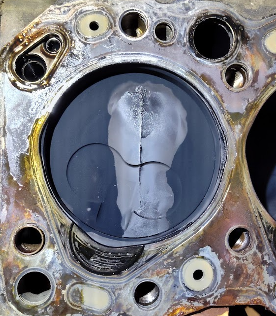

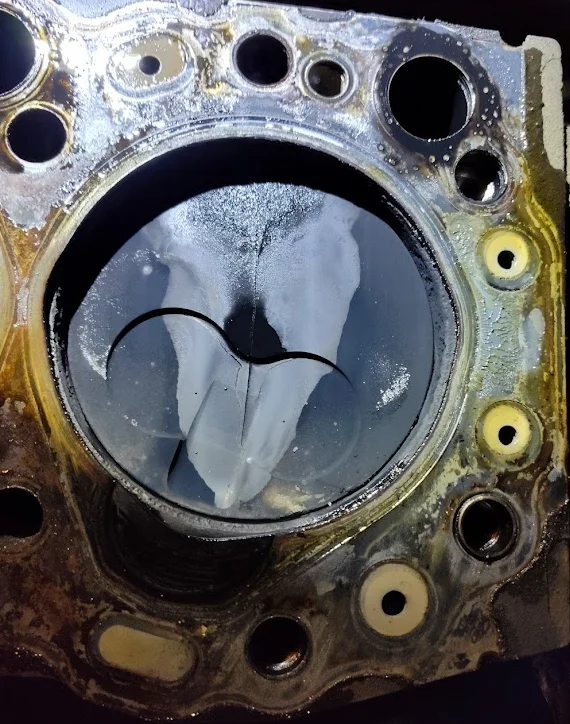

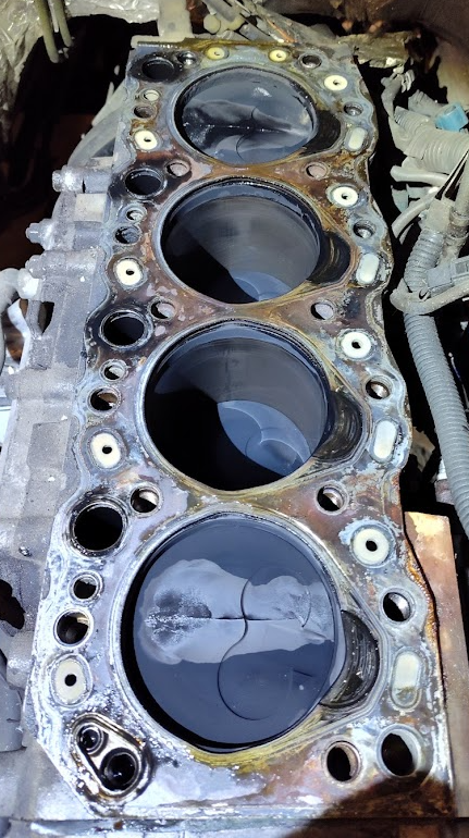

I'm pretty proud of myself. I couldn't find a single other reference where anyone has managed to do this to a 2LTE!
I've had blow-by from my engine since a long hard tow this last summer where I pushed things much harder than I should have for hours on end. Haven't had time to deal with it, and it still started, and ran fine with good power, haha.
Despite having a crappy cold (thanks kids!), I pulled the head yesterday to see whats up. Cracked two pistons! Pretty impressive, as these pistons are factory forged and have a oil cooling gallery in the piston crown. My EGTs at the time read 1000F pre turbo max. But I guess running the motor so hot (coolant and oil temps) took it's toll.
Soooo... Looking for advice. I have zero interest in a proper rebuild. I'm done putting money/time into this thing. I do happen to have extra pistons/rods. Here's what I'm thinking. Drop oil pan, disconnect rods of bad pistons from crank, and pull them out.
I'll put my spare pistons rods in, just reusing bearings. Spare parts are all the same size specs and wear as original. But I don't want to hone or buy rings. Condition of spare pistons/bores is about the same with same kms; so the wear is very similar. Bores are in great shape and pistons did not damage them.
So, question for this shade tree repair:
- Do I just use rings that are on my spare pistons, or should I try to swap rings on from the cracked pistons I remove? ie. would it make any improvement for sealing to bore to retain the original rings over different ones?
My goal here is just to get the truck moving again and semi-reliable. I'm not looking for perfect compression or lack of blow-by.
