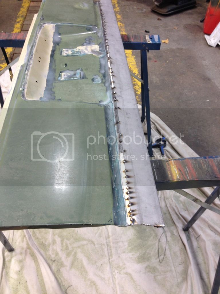

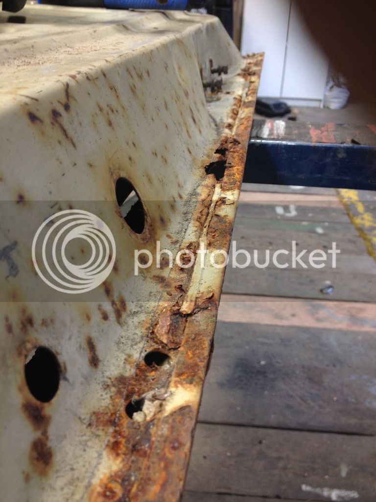

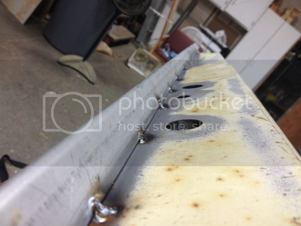

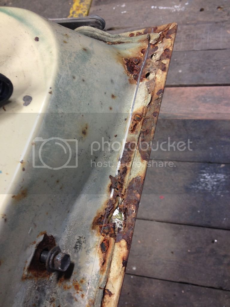

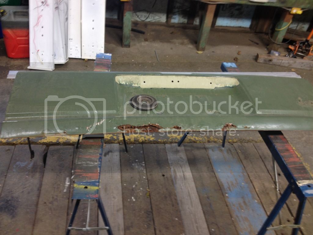

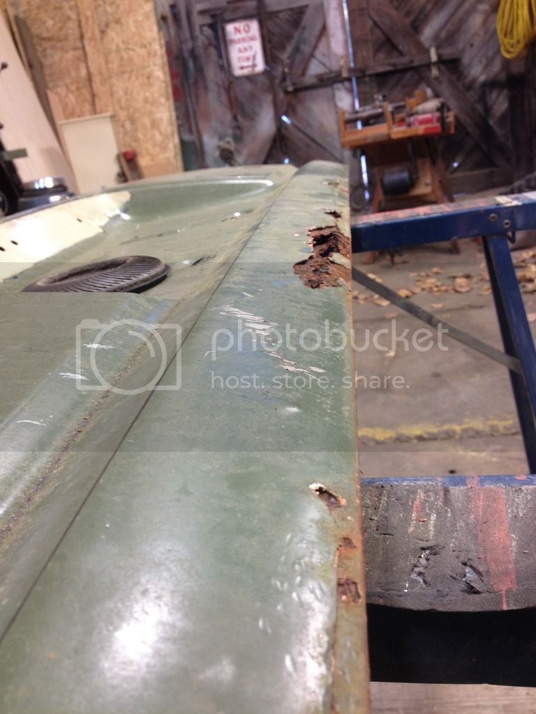

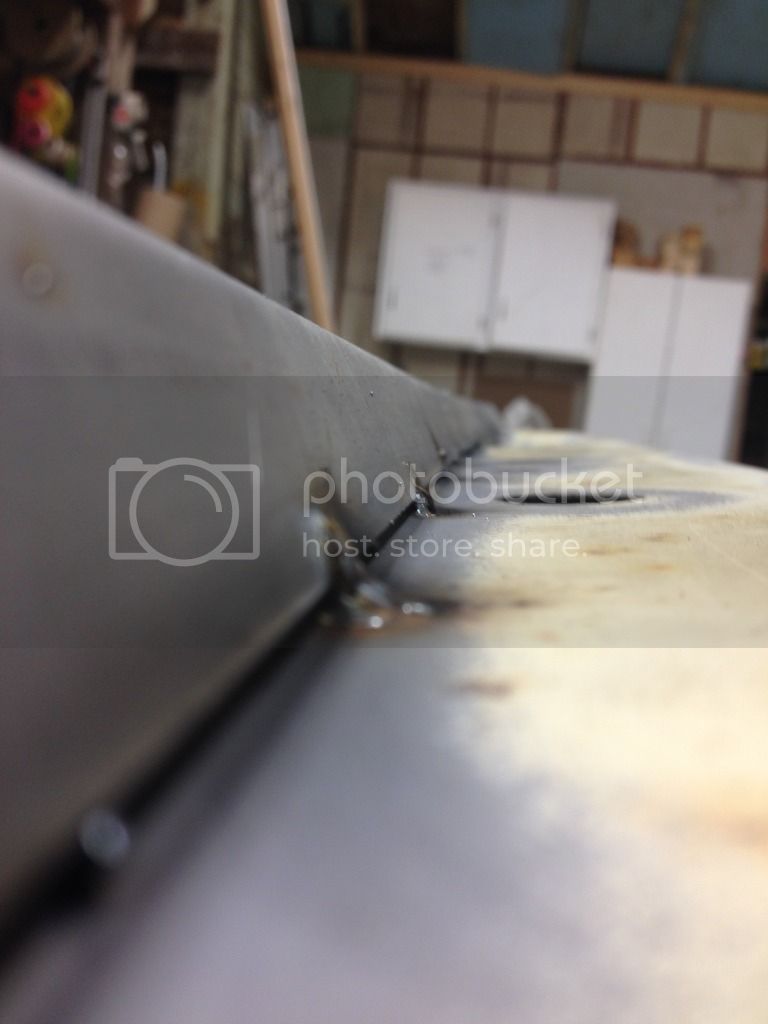

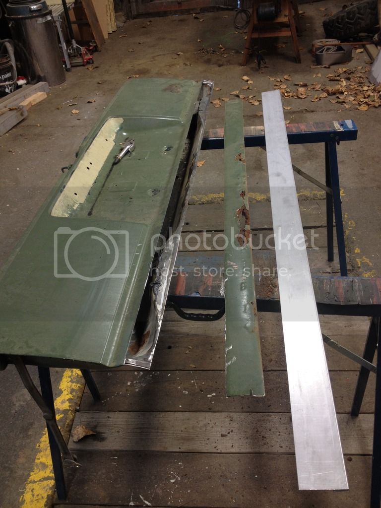

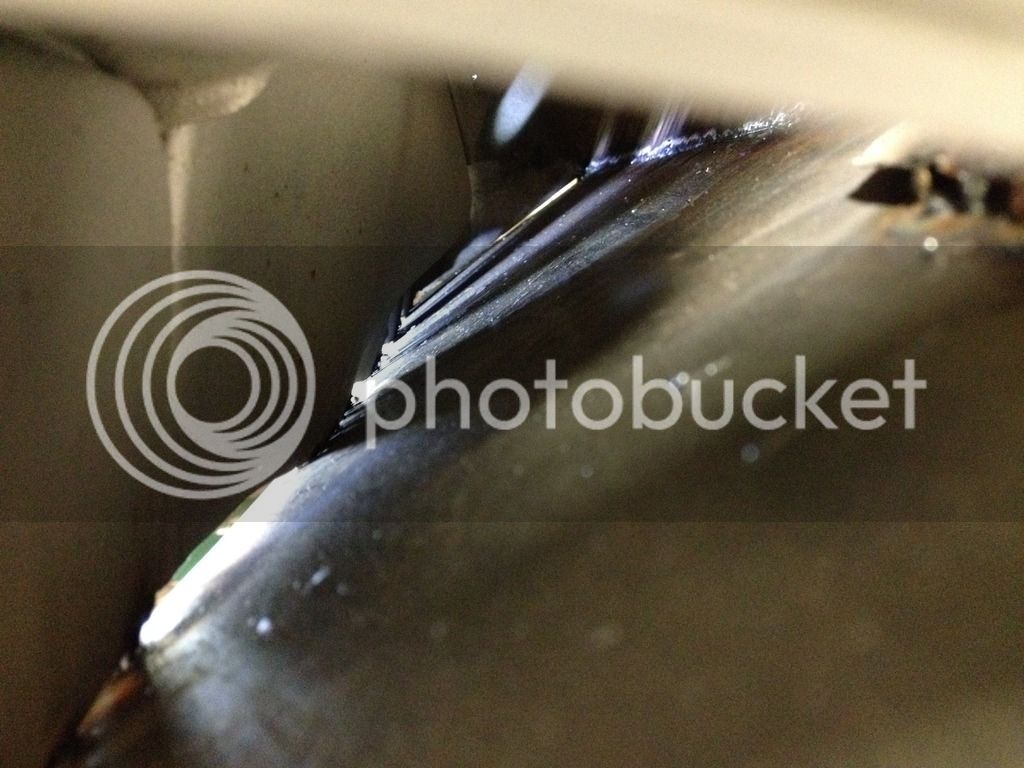

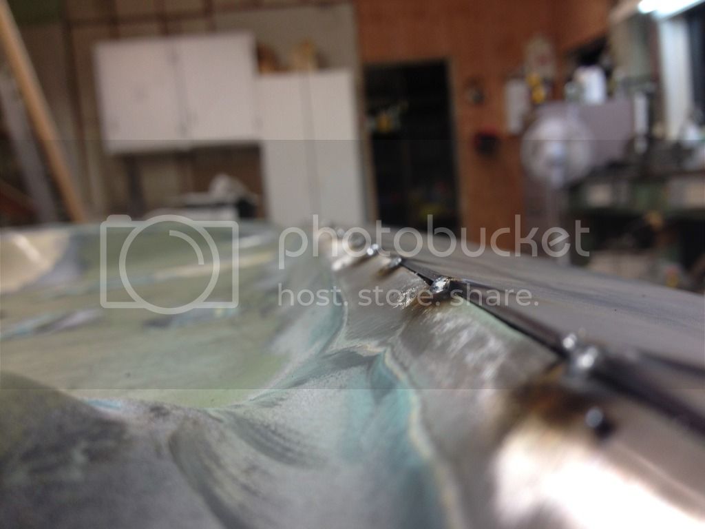

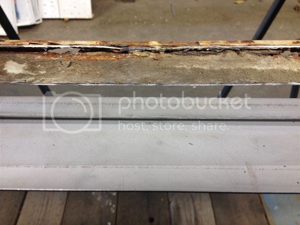

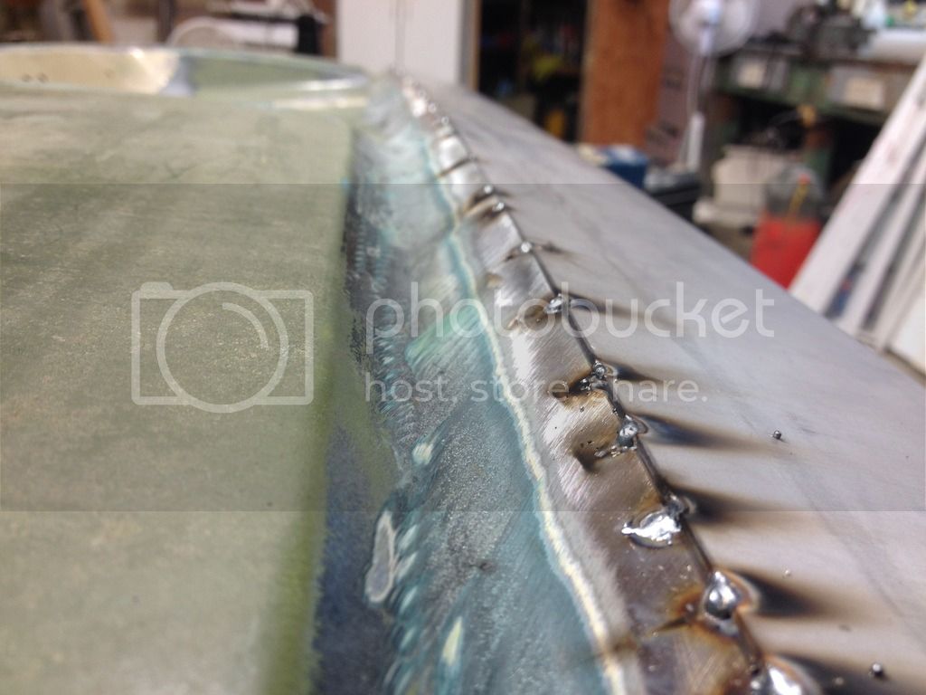

Last week I did have a chance to stop in at Millstone Sheet Metal in Duncan as they folded a piece of 18awg for my lower rear gate bottom. It was pretty rotten along the bottom. Although 18awg is a little thick, I figured it was worth a try. The one thing that's a bit of an issue is where the brackets are double thick so folding the front edge over to meet the existing edge is a bit tight. This afternoon I got to cutting out the old and spot welding in the new.
Dimensions I had them build it was 3"x1"
The new piece is slightly larger on the back side where the 1" goes. I cut it slightly smaller so that I could fold it over and I think it will work out well. Obviously I'll have to add a bunch of seam sealer to that edge, but I thing (hope?) it will bolster the strength a bit.
Also, the bottom of the gate has a natural curve to it so I think I was able to match that, but it may also have a bit of a natural rise which I'm not sure I was able to do. I guess I'll see if that matters once I reinstall it!

Here's the progress from this afternoon...

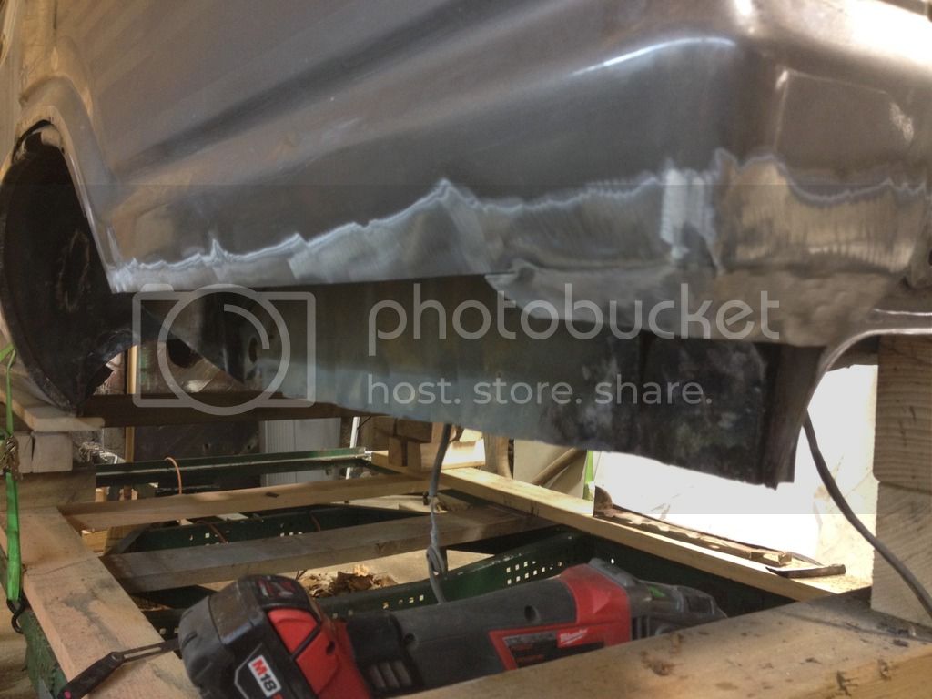

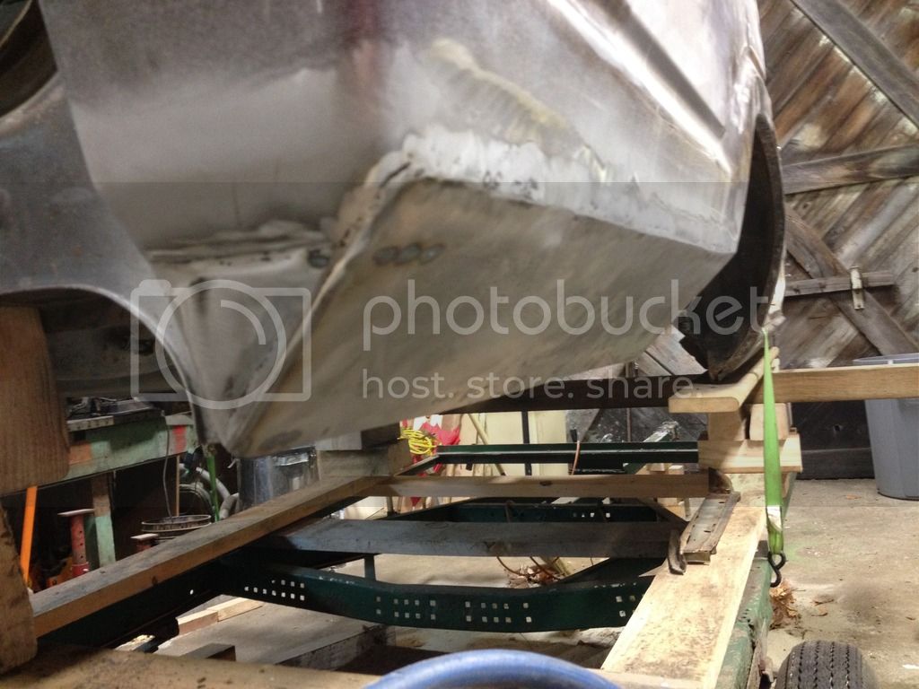

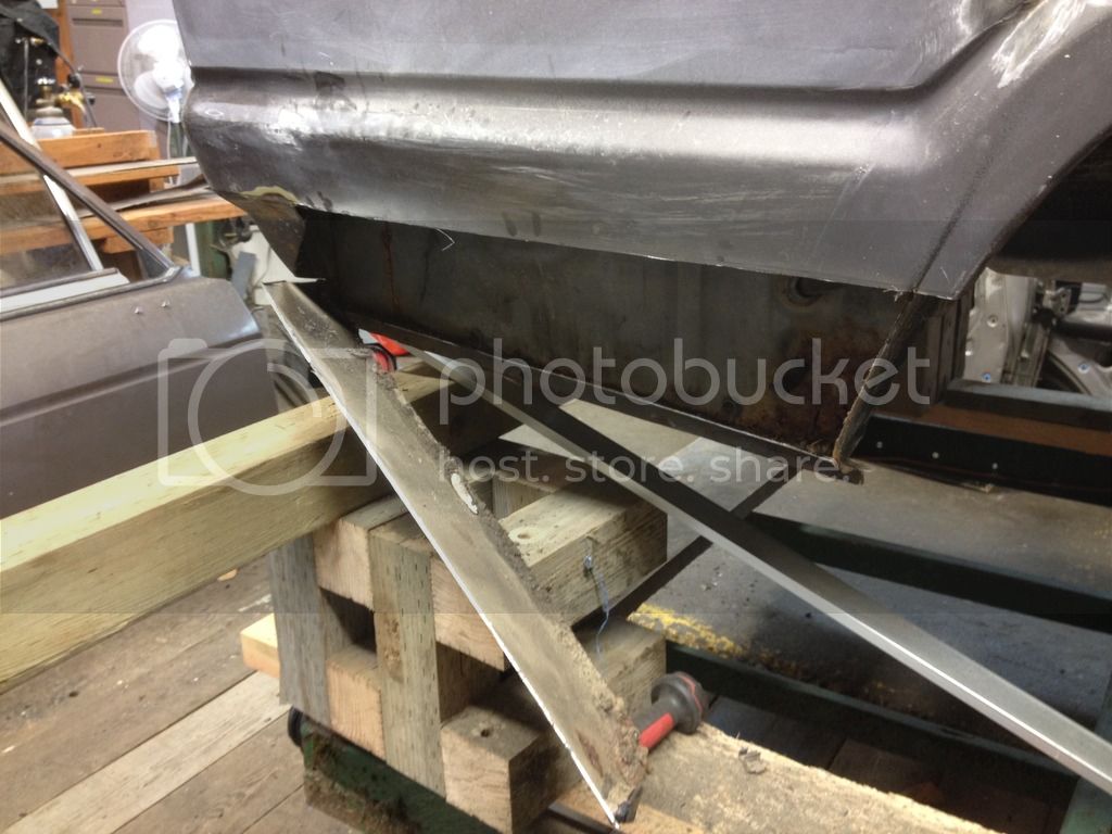

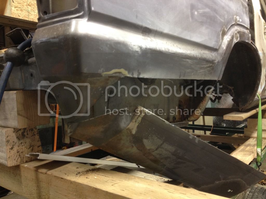

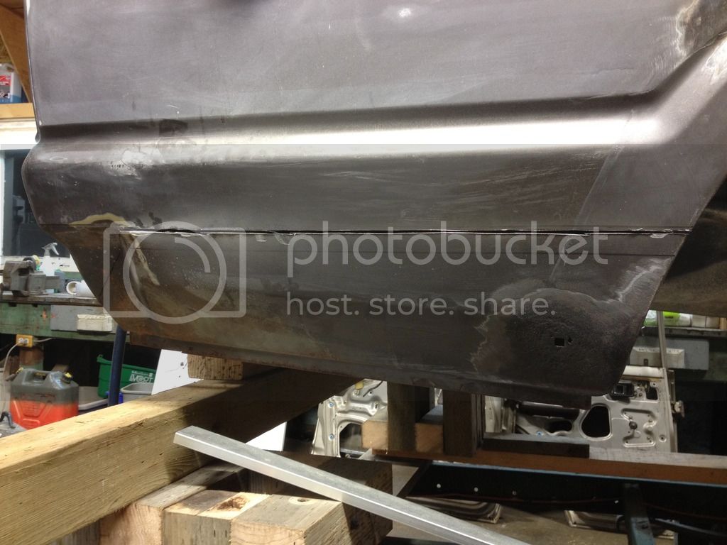

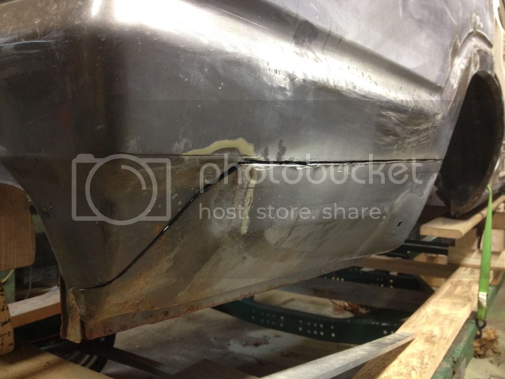

Tonight I chopped the rear quarters. No turning back now!

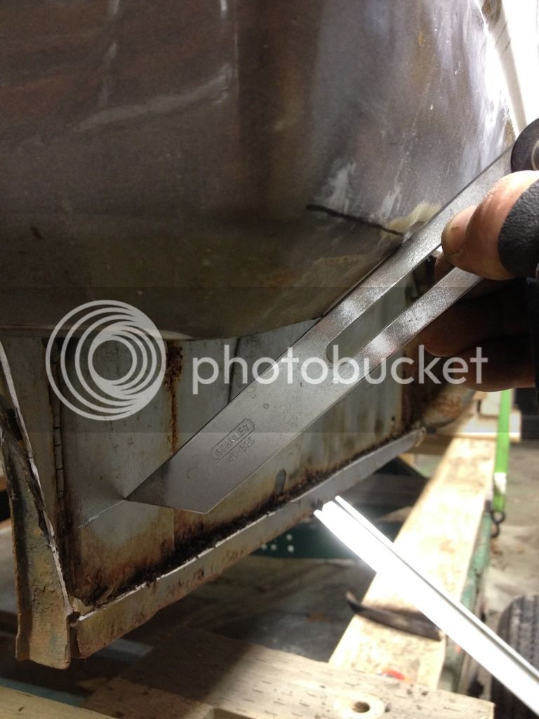

I basically drew a line parallel with the indent of the rear quarter just above it and then drew another line from the rear corner transition/indent.
I kept the two angles on because I wanted to use those as (1) an angle to follow down to my inside edge and (2), have something for my new piece of steel to follow as somewhat of a guide for tomorrow when I (hopefully) weld the new pieces in. It looks like there will be lots of clearance for the fuel filler neck too.
I'm hoping to install some sort of storage similar to Wagongear has built, but not exactly sure what, but I suppose I just lost some storage by doing this mod :poof:

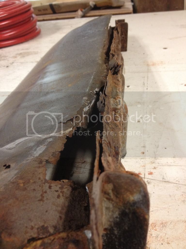

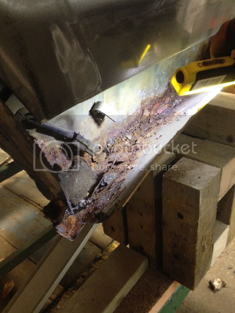

I Rust Converted the inners tonight in an attempt to stop any rust from spreading, and wire wheeled them before that. It actually wasn't too bad after cutting all the really bad stuff out. A few spots along the very rear corner where there is a seam and support beam, but essentially just surface rust and blew off pretty easily.
Tomorrow morning I'll hit it all with a weld-through primer and let that set.
Then I'll mock up the new pieces and get to welding. Then seam sealer. Then rust preventative paint/stuff.

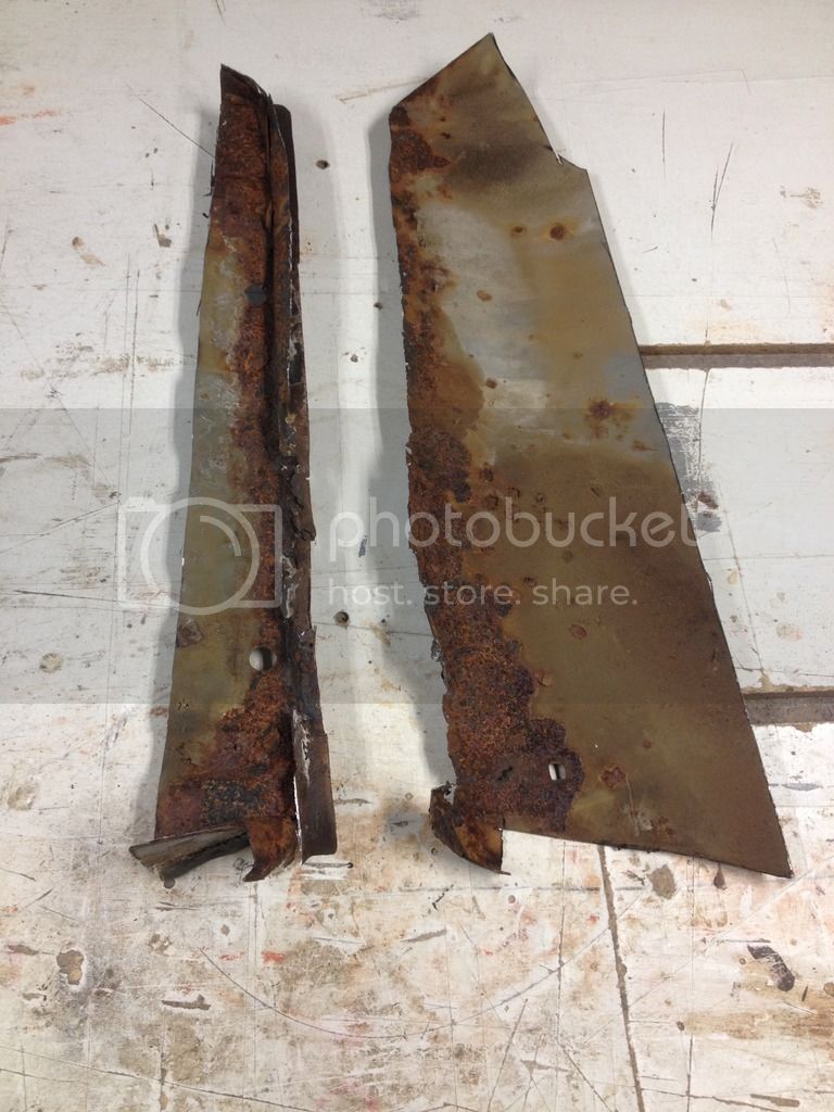

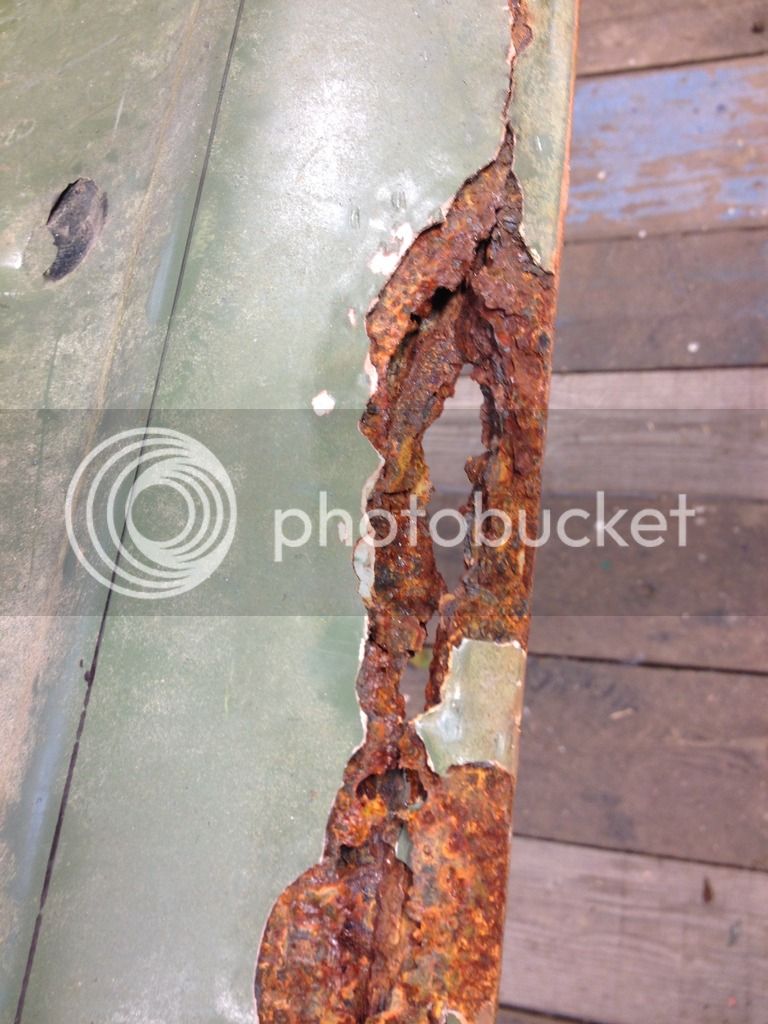

Here's a few pics of what came off and an idea of the angles. Really glad I did this...it was BAD in there!
Wow. Talk about spot welds up the ying yang! Oh, and btw, don't ever let me do body work on your truck :eek: At minimum, this is better than the riveted chunks of metal the PO riddled throughout my Camo body which all let go in "the accident."

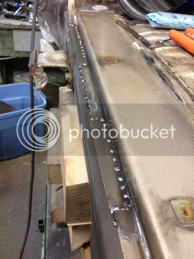

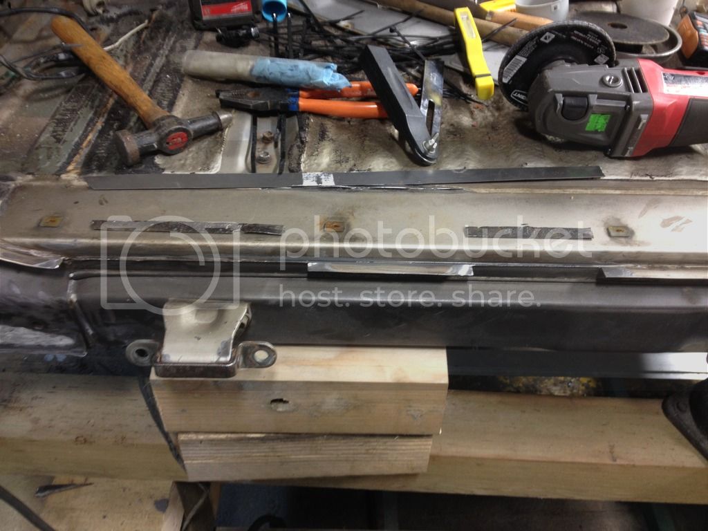

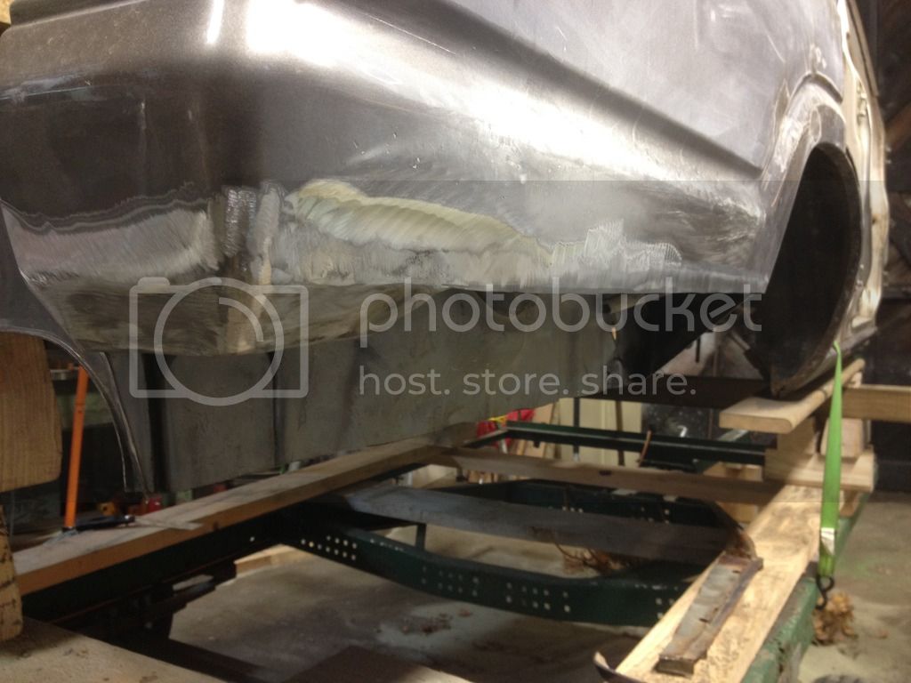

Rear Quarter chops mostly complete. Still need to figure out how to tie into whatever I'm going to do with the outer fenders, then trim the underneath overhang, seam seal it all up, bondo, cross fingers, sand, do stuff twice, then paint?

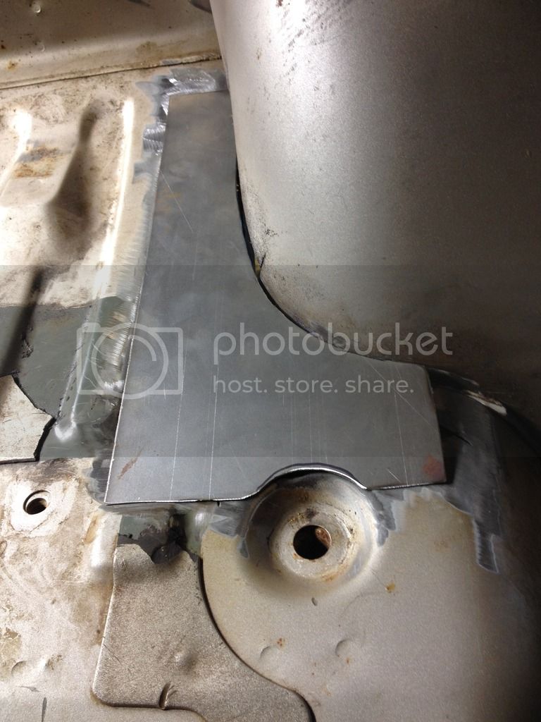

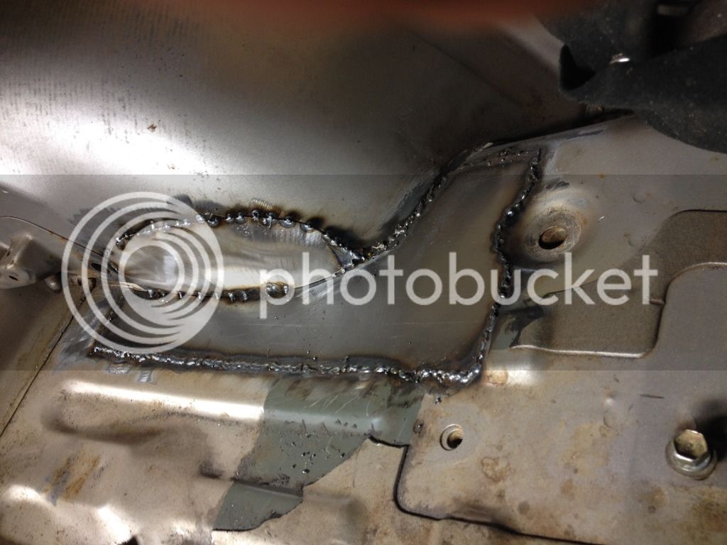

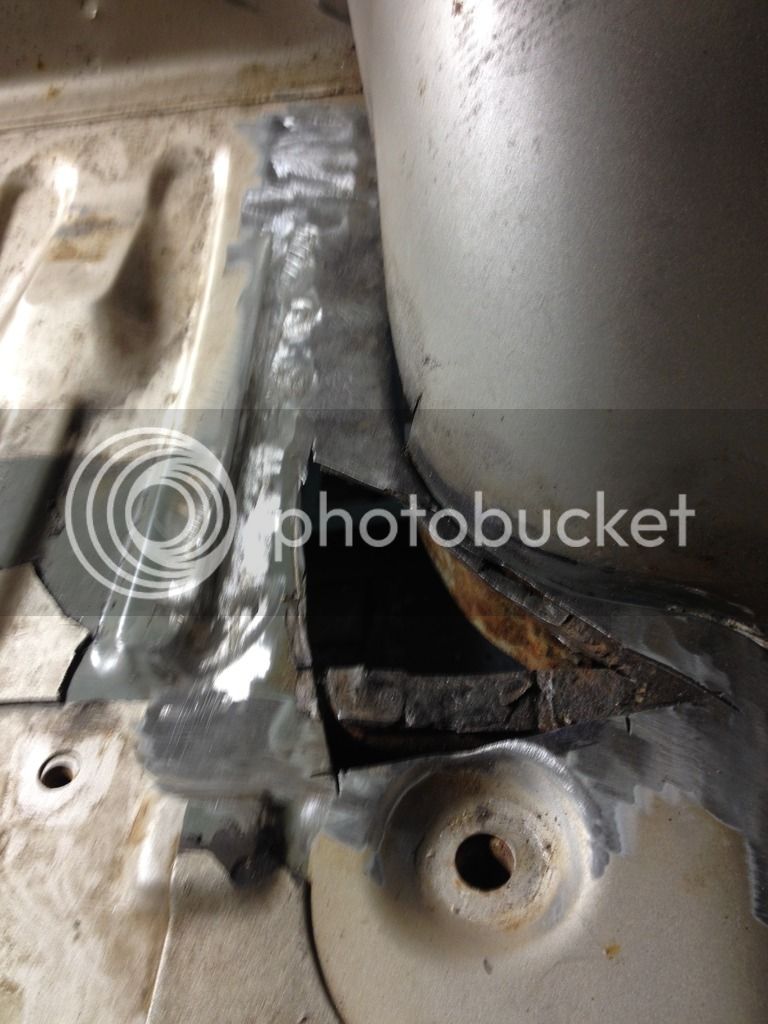

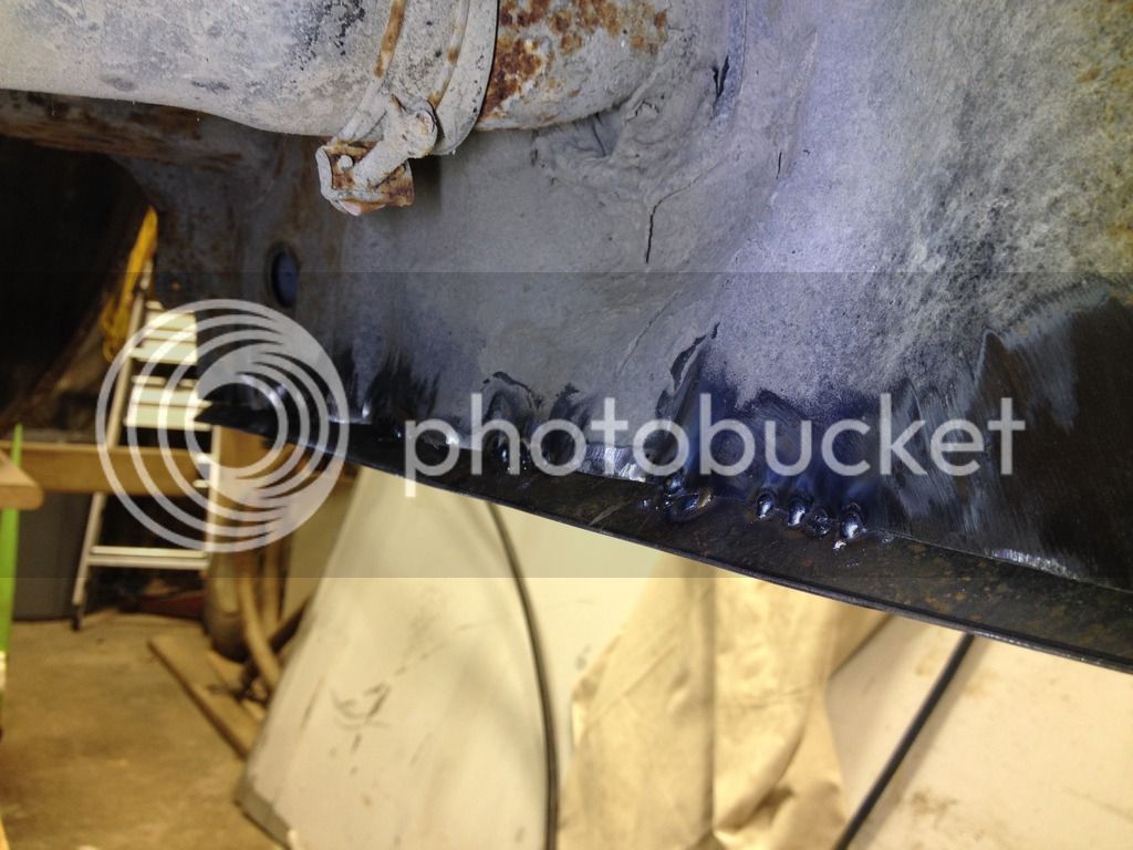

Also got around to the inner fender well patches. Mostly done but fine tuning still to do.

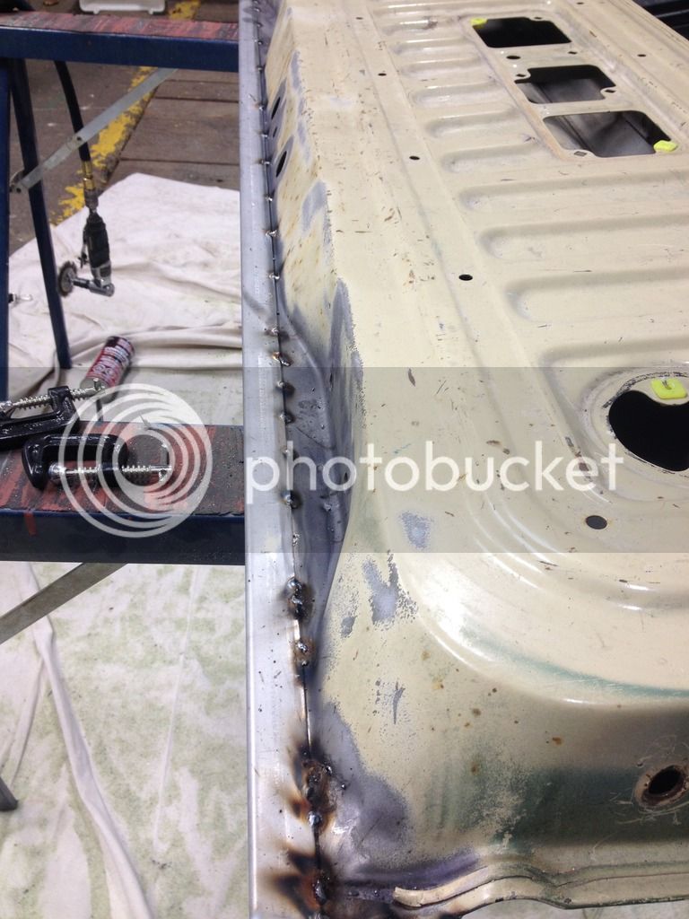

And the rear gate weatherstripping frame rail was a bit rusty so I chopped out a couple chunks and welded a new piece in.
