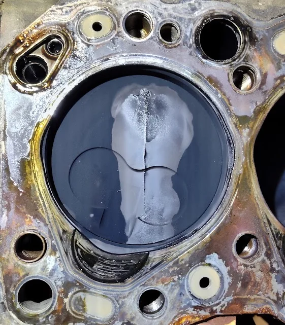

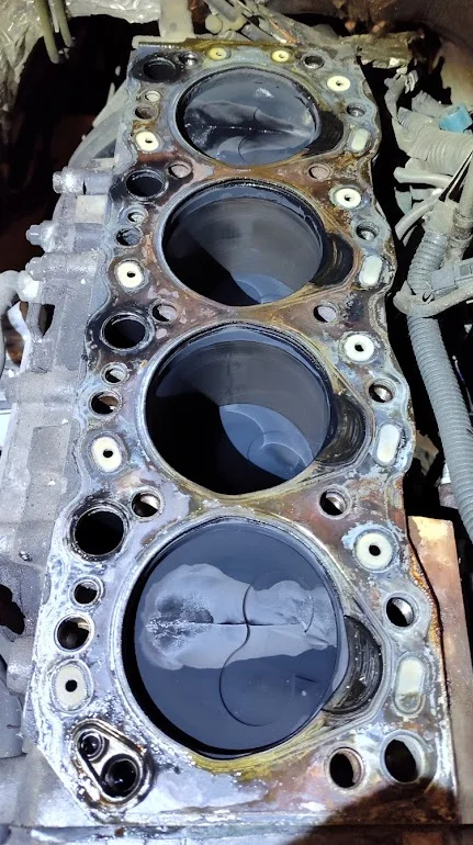

Despite having a crappy cold (thanks kids!), I pulled the head yesterday to see whats up. Cracked two pistons! Pretty impressive, as these pistons are factory forged and have a oil cooling gallery in the piston crown. My EGTs at the time read 1000F pre turbo max. But I guess running the motor so hot (coolant and oil temps) took it's toll.

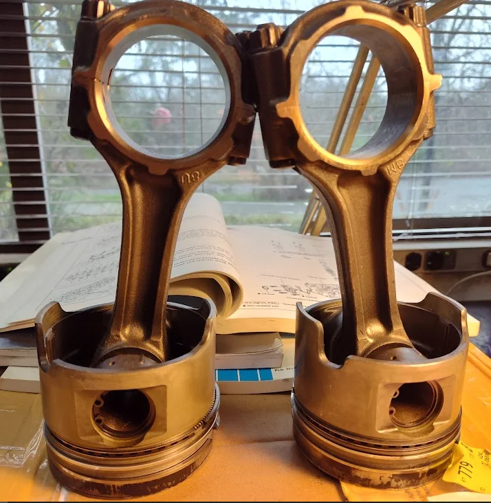

Soooo... Looking for advice. I have zero interest in a proper rebuild. I'm done putting money/time into this thing. I do happen to have extra pistons/rods. Here's what I'm thinking. Drop oil pan, disconnect rods of bad pistons from crank, and pull them out.
I'll put my spare pistons rods in, just reusing bearings. Spare parts are all the same size specs and wear as original. But I don't want to hone or buy rings. Condition of spare pistons/bores is about the same with same kms; so the wear is very similar. Bores are in great shape and pistons did not damage them.

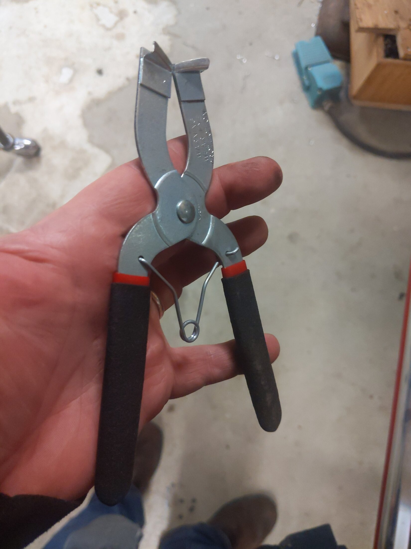

These things are cheap if you don't already have a pair.
Makes ring ****ery a lot easier if you decide to do it. I have a compressor too but bit far away for loaning haha
Gotta get me some of those! Kms is 5min away, will go look. Bought piston ring compressor already. Thanks for these ideas.
