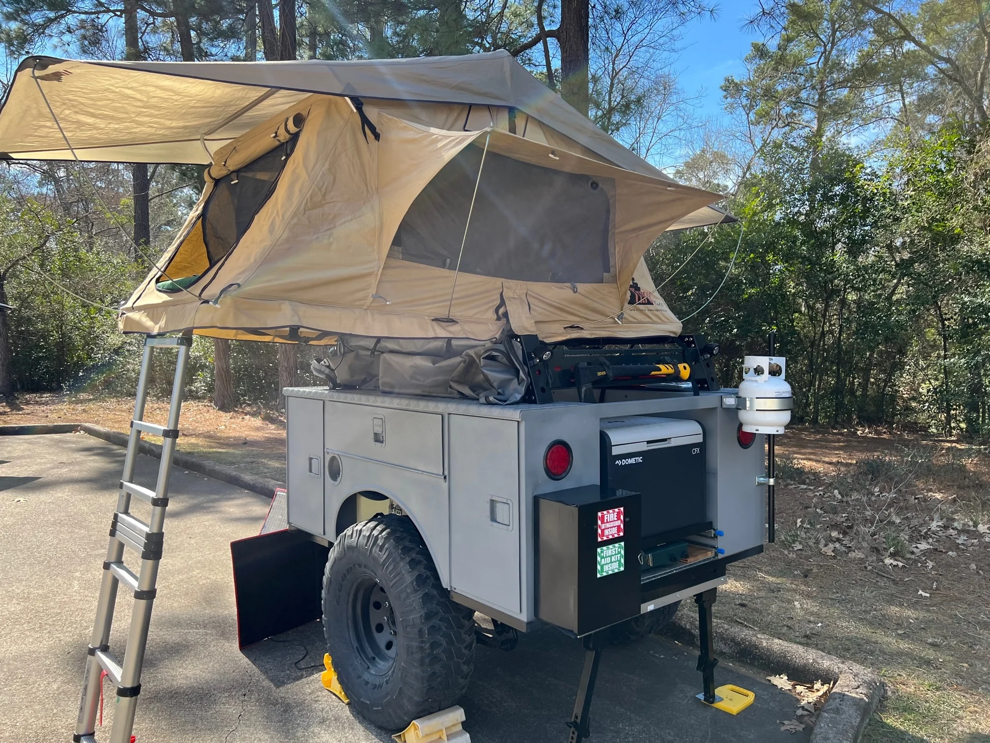

In an effort to not pop my motor and to bring all my toys, dogs and people camping across BC. I need more secure storage space but! don’t want to tow a small house around through the mountain passes. I been searching and collecting parts to build something like this.
Have a Trailer axle and papers
Need Service truck cabinets
And Roof top tent
A couple things I would do different than this one:
The tent frame would be higher at least 6,6 so I can walk under it and the bears have to stand on their tip toes.
The tent should have the second room curtains under it that go to the ground. If more room is needed for people have a second tent on the truck?
And wider tire track to match or near my track width, possibly slip a fly fishing boat in between the cabinets.

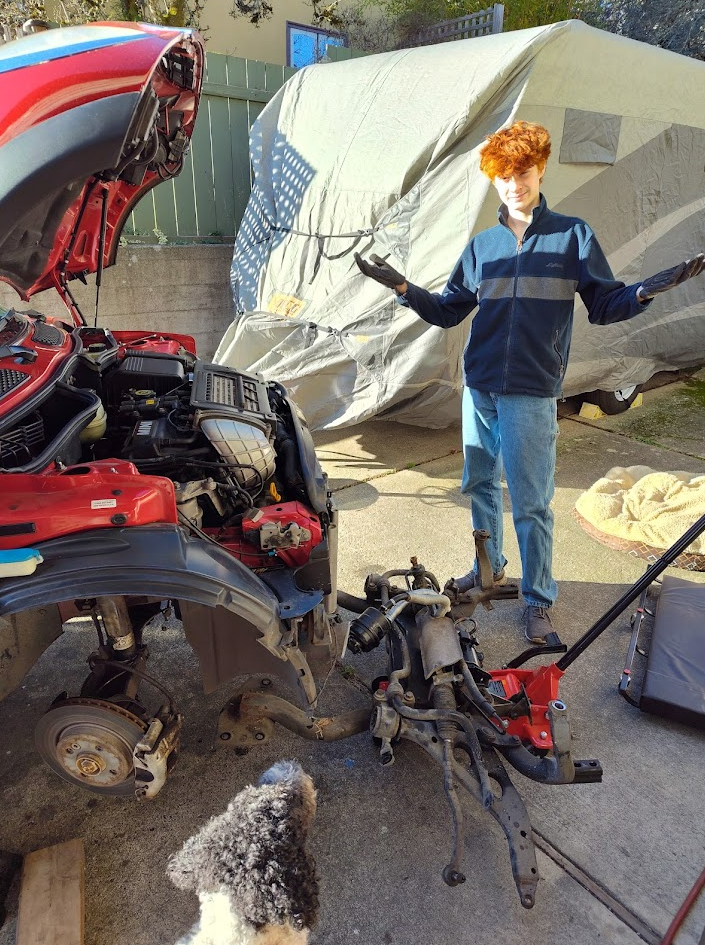

Replaced strut mounts and front control arm bushings on the sling shot this weekend. Requires removing bumper and subframe. :bang: Pinch bolt in knuckle broke off and even easy out didn't work. Had to drill out until almost nothing was there, peel out. New bolts and anti-sieze on every thing now.
This job reminds me of the front axle job on a solid axle cruiser. Sort of an "initiation right", haha. I feel like I know the car well now.
Got the kid to help with this job. Took most of the weekend which he wasn't thrilled about. I gave him the alternate option of taking to BMW and spending a few grand, lol!

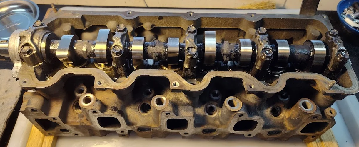

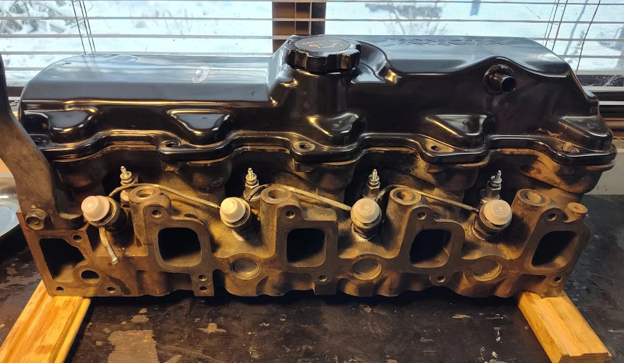

New (used) head is ready to go on. Confirmed it's the late model 2LTE one which is improved over original. Valve clearances shimmed within 1thou of middle of Toyota spec! I put in all new seals and bearings. Head seems to have had little use, as the valves/seats were mint and looked to have been recently ground. But whoever removed glow plugs broke one off. That was a real PITA to deal with.
Was trying to do pistons yesterday, but couldn't get the damn oil pan off yet. Sealant I last used appears to have been nearly permanent. Good thing I have a spare oil pan, as this one might not survive removal. Ugh.

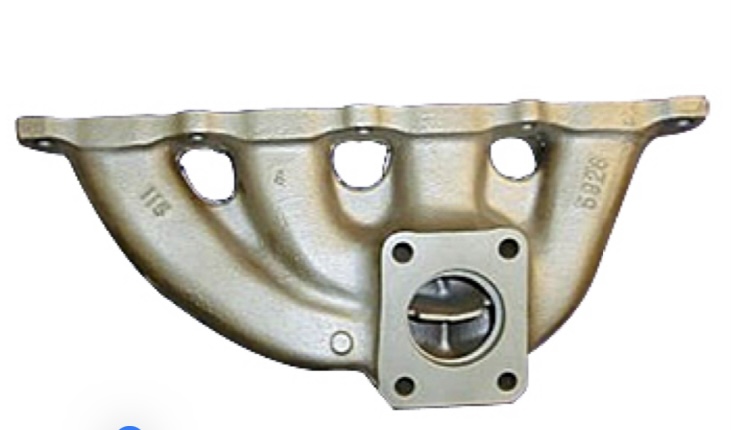

I was doing some research the other day thinking of building a square tube style log manifold when I read something about four-cylinder engines with firing order 1-3-4-2:
Will have cylinder 1 ending its expansion stroke and opening its exhaust valve while cylinder 2 still has its exhaust valve open and vice versa.
In an undivided exhaust manifold, this pressure pulse from cylinder exhaust blowdown event is much more likely to contaminate the paired cylinder with high pressure exhaust gas. this hurts the other cylinders ability to breathe properly and obviously efficiency.
I wonder if in a cast factory log style manifold the long runners of cylinder 1 and 4 don’t breathe as well? Say if during a push but the egt probe being right in front of cylinder 2 and 3 doesn’t show the true temperature of cylinders 1 and 4 being much further away. Like say a post turbo egt probe reads 200 degrees less just a couple inches further away.
And a divided manifold
Just some rambling thoughts..

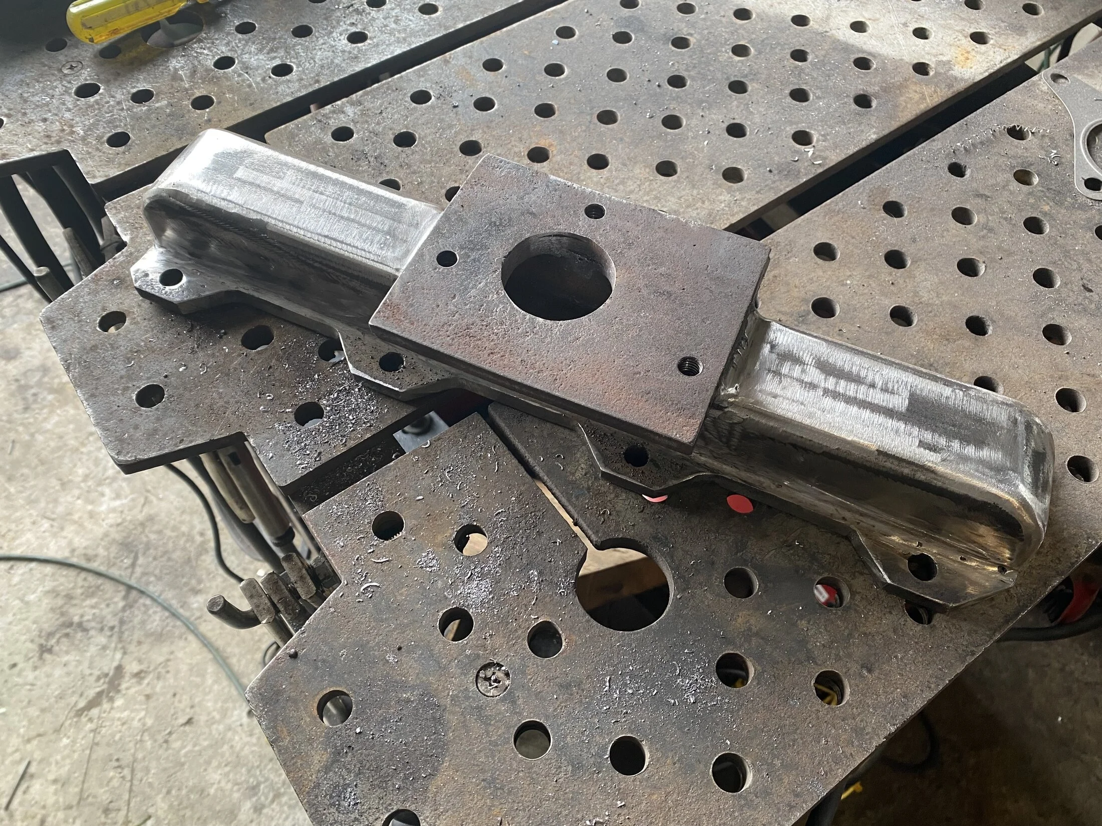

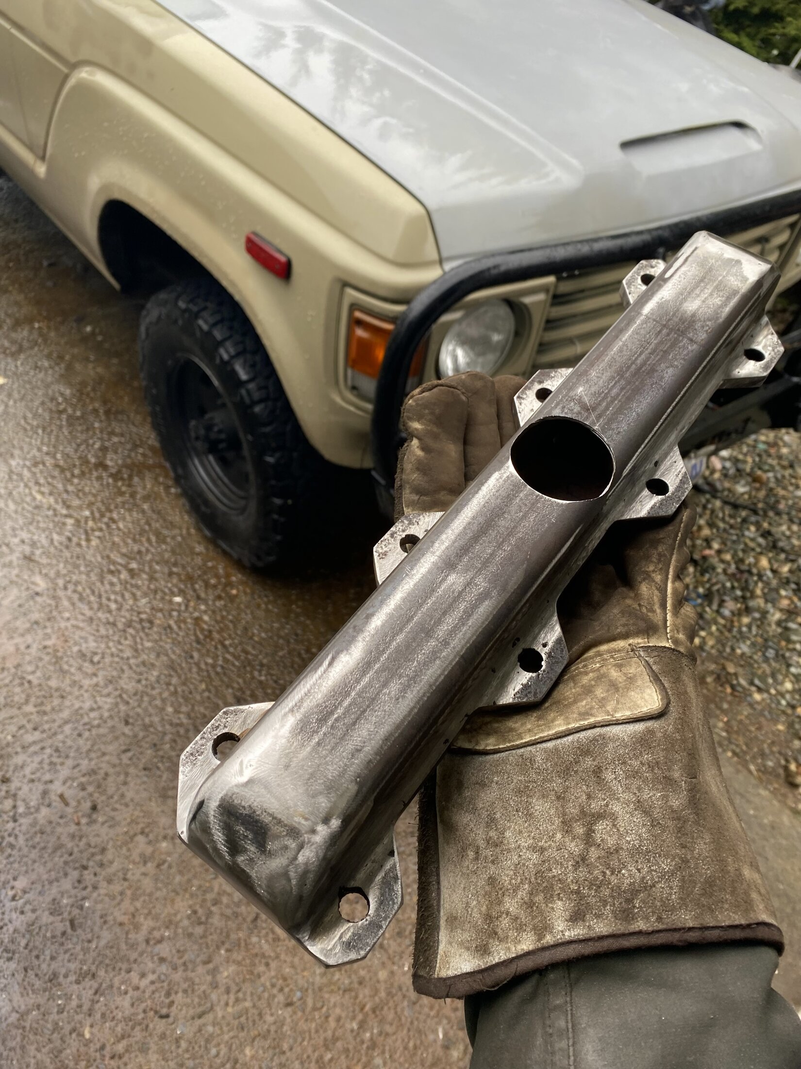

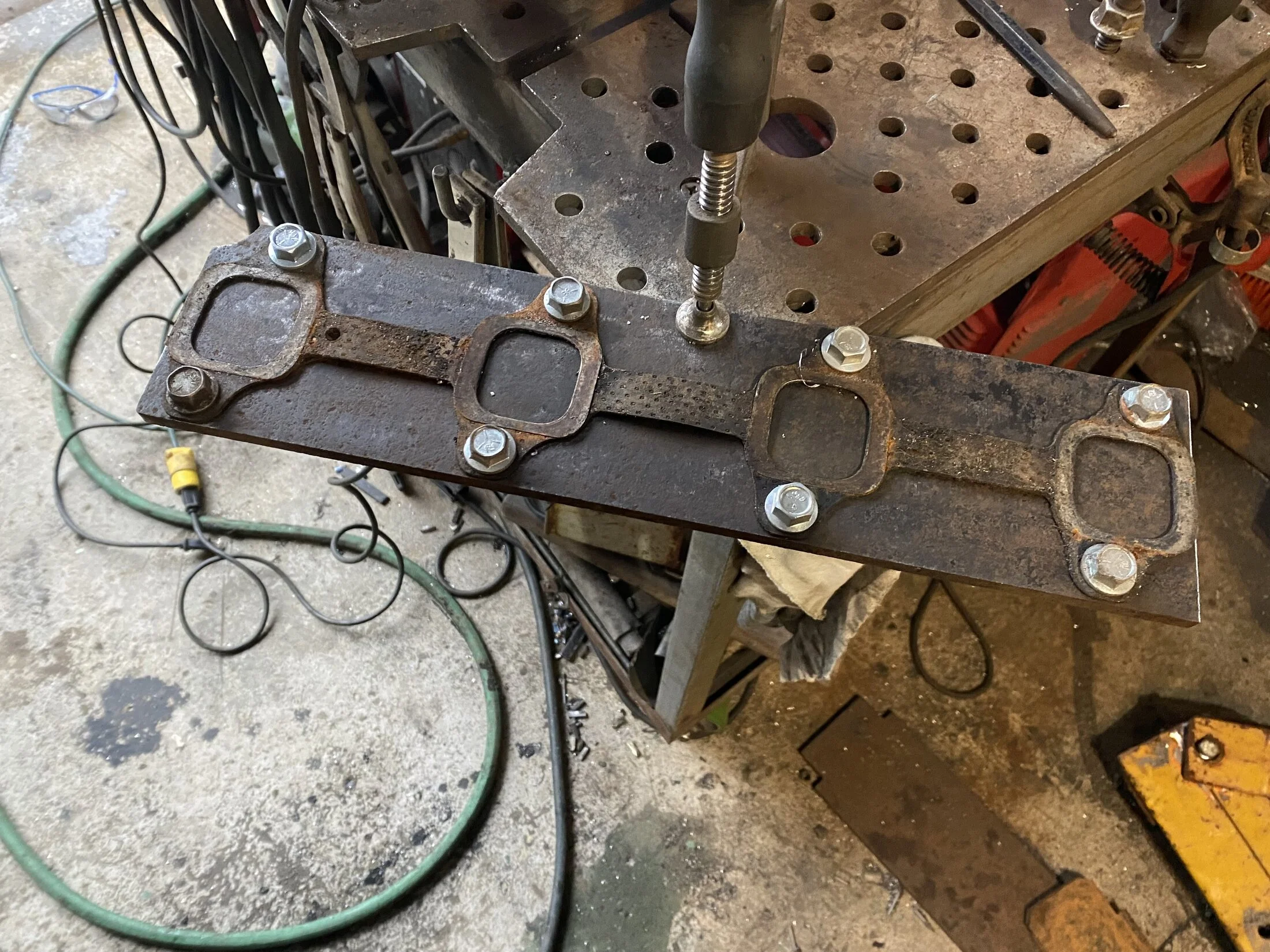

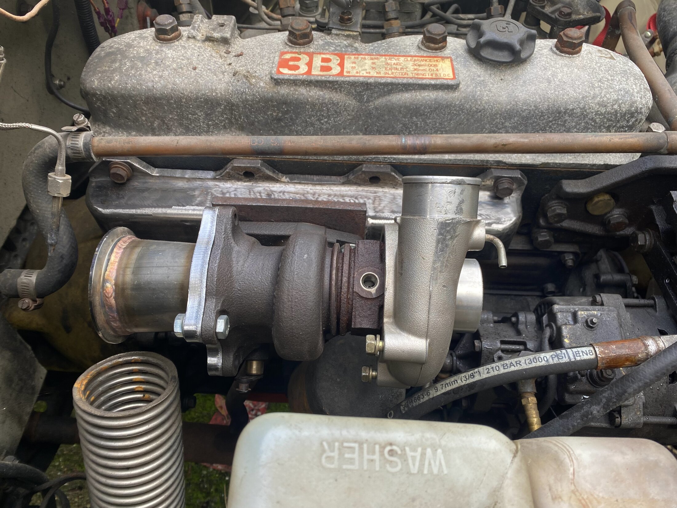

While working on a project and clearing metal shavings with my air chuck i incidentally discovered the stock undivided 3b manifold is not as inefficient as I might have guessed.
Built a simple undivided log turbo manifold and not surprisingly it doesn’t vent as well as the stock NA manifold. I will still run it because I love how it hugs the engine keeps things tight and clean.
Built a simple undivided log turbo manifold and not surprisingly it doesn’t vent as well as the stock NA manifold. I will still run it because I love how it hugs the engine keeps things tight and clean. View attachment 3840861View attachment 3840864View attachment 3840865View attachment 3840867View attachment 3840866

Sounds like a great plan. I was definitively pulling a negative pressure in my air box with the turbo 3b and stock setup at 2 7/8 inch, I imagine I was always pulling some negative pressure. Upsizing to 3 1/2 intake pipe pre turbo was definitely worth doing. More free air, less heat and happier motor.

No not yet. There’s no shop on the island that rebuilds turbos is there? I damaged the compressor wheel trying to clock it. The centre was oxidized to the compressor housing and I used a little too much persuasion to free it!
Just buy an aftermarket compressor. I *believe* they're balanced independent of the shaft and turbine. But there is a place in lower mainland that can check balance for you. Nut is reverse thread.
