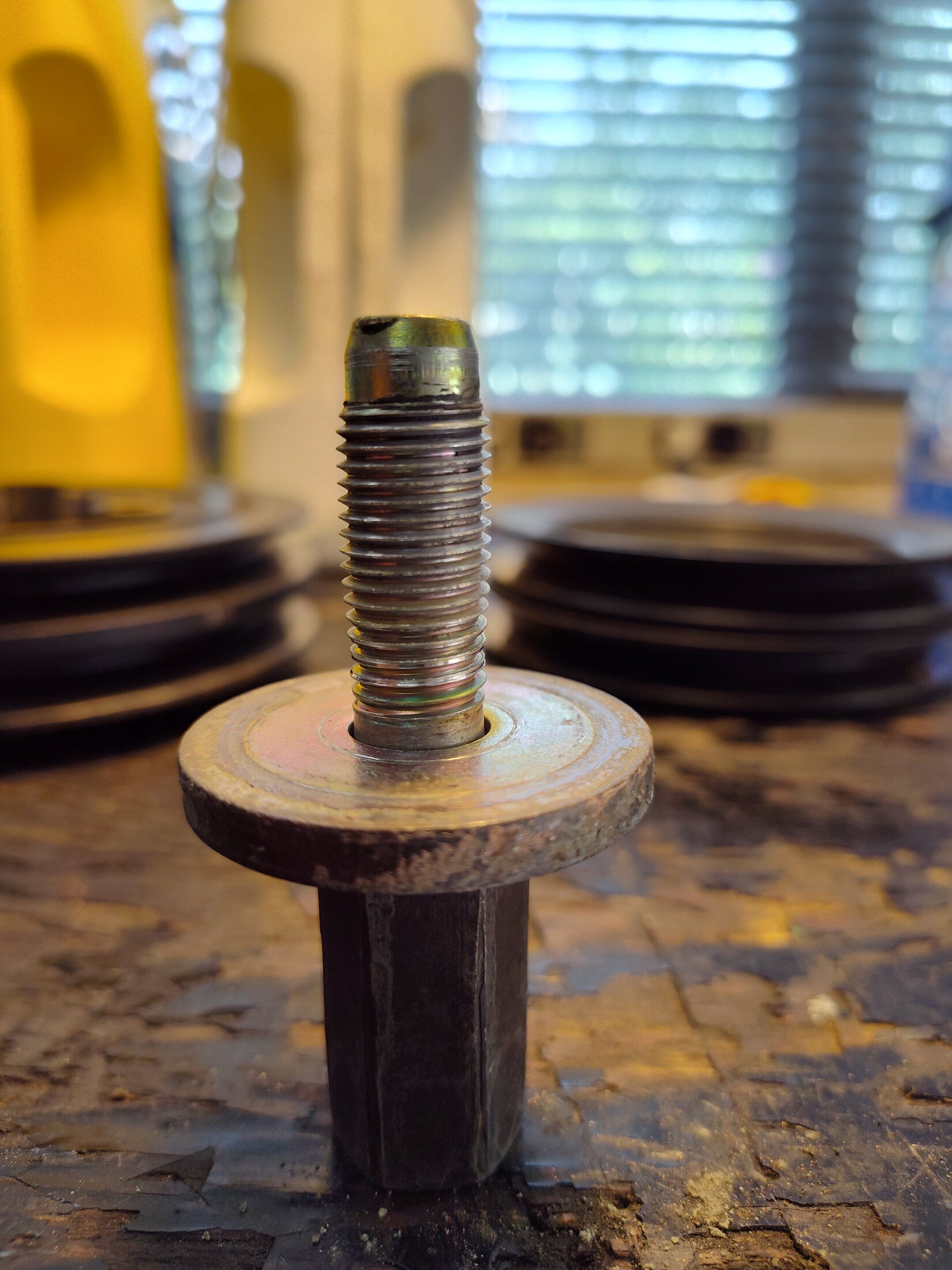

Thought I could get it going this weekend. But need new crank pulley bolt. Old one is stretched....I don't have a torque wrench that goes to 175ft/lb, so have probably over torqued it a few times too many in past. Has pretty odd shape now from stretching. Figure better safe than sorry. So another week...but everything else will be ready to go. Actually missing the old beasty. Looking forward to having it on the road again.
I have 3 that go that high and I'd be happy to loan you one.
Thanks man. Hopefully this is the last time, so I'm not to worried. It's just the bolt I really need! Ordered, but a week out.
Found I had a spare crank pulley bolt.

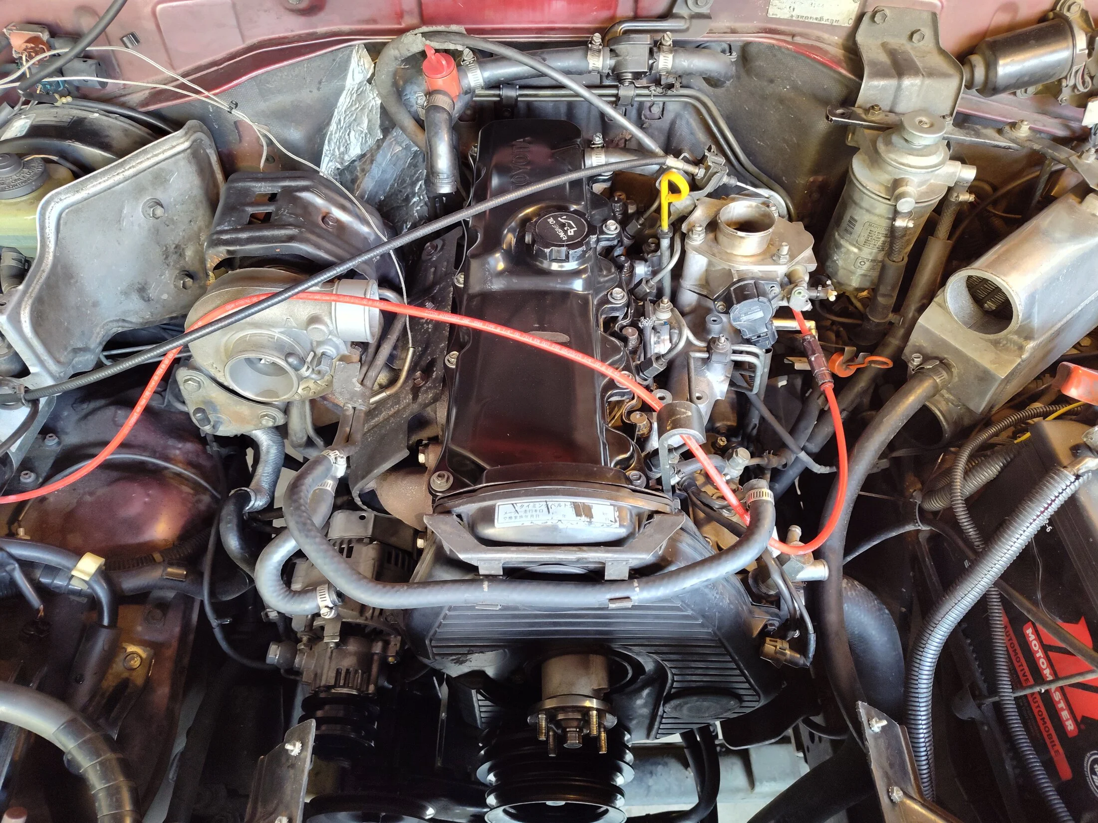

Started the bitch up this morning before I commit to finishing belts/coolant/intake/etc. Fired right up and built good oil pressure quickly. So, I'll finish putting everything together and run a bit longer. Then will change oil again and look for bearing debris....; the moment of truth.
Amazing, you must have been pretty happy to hear it running again!
Thanks man. Yup, definitely happy. Still lacking some faith on how long it'll run well, haha. If it goes a week I think I'll be fairly confident it'll be okay a few years though.
