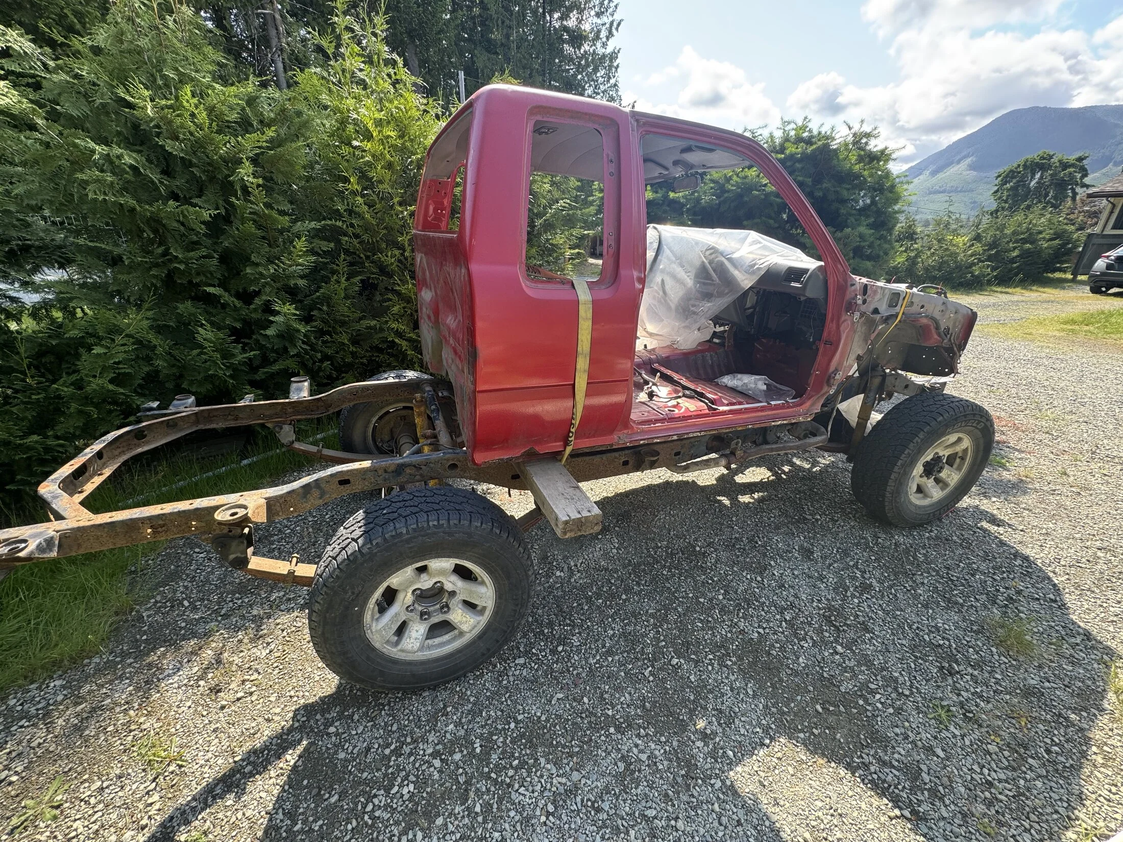

Well folks, after a few years away from this pit of keyboard warrioring, picture posting, opinion giving and receiving, I’ve come full circle and have somehow convinced my 16yr old son to try and take a 1991 Yota Ext Cab body and slap it onto a 60 Series chassis (frame, engine, tranny…you know, everything but the body).
This will be become the place where the project progress can be seen and remembered, and we can look back and laugh at ourselves one day. But for now, we’re too smrt for our own good and we’re committed to this Frankenstein project to work, one way or another.

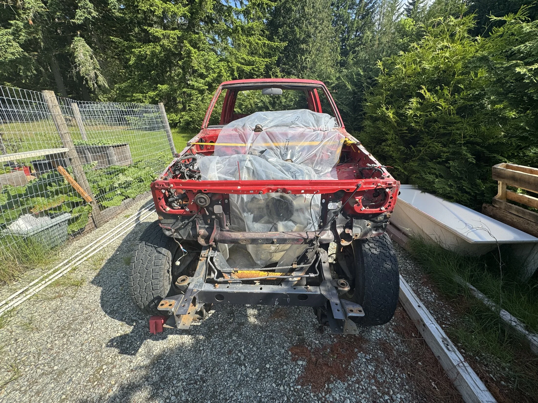

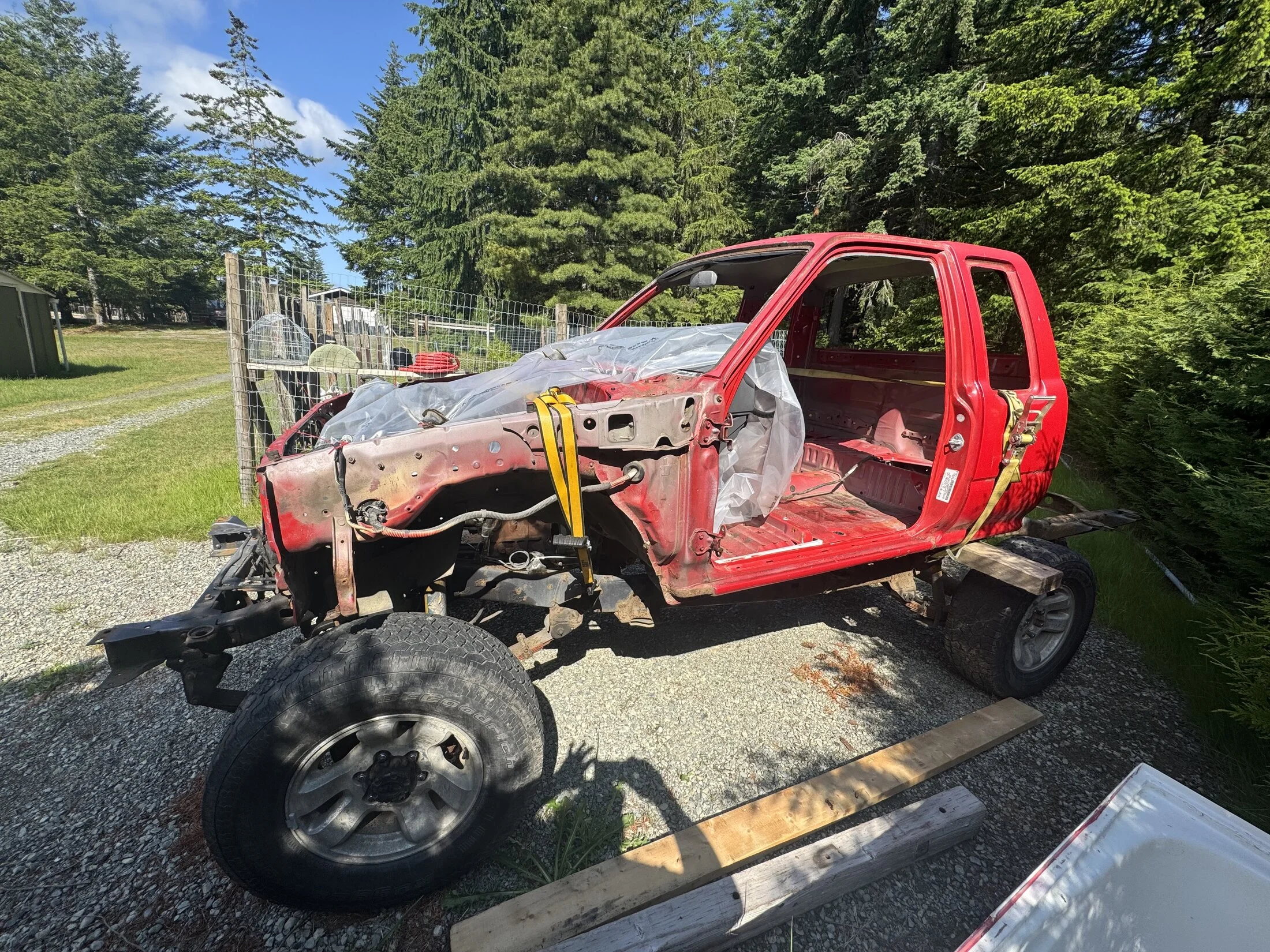

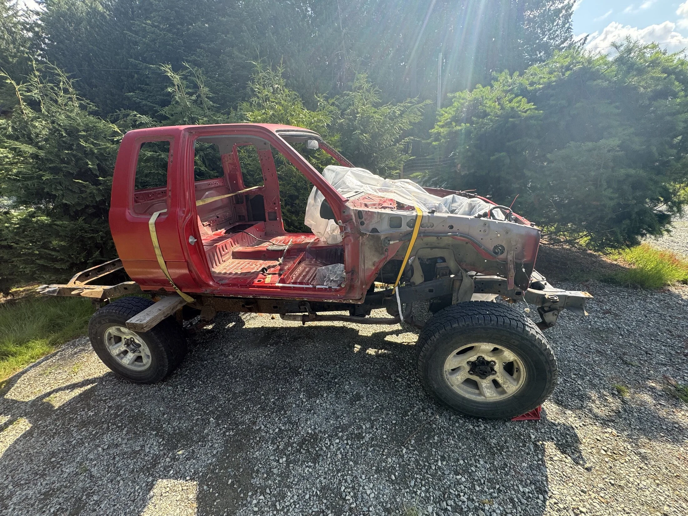

To date we have placed the body onto the frame to see just how bad things line up. Honestly, it’s pretty bad.
To start we’ll need to build a sub-structure under the body so we can land the body mounts somewhere…then we will cut and add about 12” of front fender and hood to make the 3B and essentials fit in the (soon to be larger) engine bay.
Are we crazy? Maybe don’t answer that…
Are we committed? Seems so.

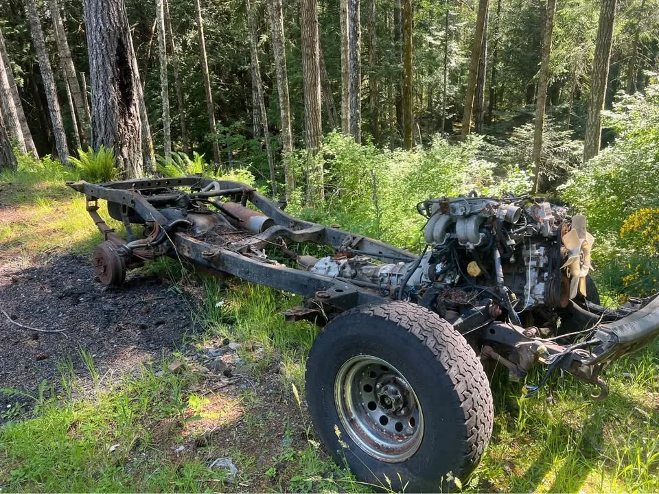

Oh, the BJ60 is a 1985 that had the frame replaced with an FJ62 US frame around 14yrs ago. Once our schedules line up again, the PO is going to get me the folder of receipts for which the PPO had kept over a few decades of ownership.
The only slightly questionable part of the frame is some delamination at that rear inner c-channel where the rear spring perch is riveted to. I’ve replaced one of those before so if we feel it’s actually worth it then we’ll do that. Other than that we’ll clean up the frame and make it as rust resistant as our Western rainforest climate will allow.
There is potential for the 3B to get a rebuild and a turbo, but we’ll see how the kids savings account grows over the next few months.

Is that the final positing of the Toyota cab? It looks very far back. Does the engine position dictate it be there? Could it be moved 8" os so forward?

To answer a few questions…
1. Body positioning.
Yes, would like at least an inch behind the valve cover before the firewall and am not interested in my engine being inside my dash, so the cab positioning is as far forward as it can be to satisfy those limits.
2. Different body on frame…
The only really bad rust on the body are the very bottom rockers, so we’re cutting this off. The plan, because we also need to land some body mounted, is to cut the rockers off as well as that nice little pinch point connection behind the rockers where they stop on the original body (often the place people jack from and they squish. We will be adding 2x8 rectangle from the outer rocker (fixes that problem right quick) and back beyond where that pinch connection “was.” This will allow us to land body mounts anywhere we want and can design the mounts to come off the frame and onto those 2x8’s easily (I hope…beyond hope do I ever hope!).
3. Keeping the ext cab instead of a single cab.
Having that little extra space, whether for taller people or for throwing a backpack and a few groceries when there’s two passengers. Keeping the ext cab will require us to do some surgery at the rear of the cab to make built in fenders essentially. That will be fun. But that’s the plan.
4. Front fenders and hood.
We’ve acquired used front fenders and a 2nd hood which we plan to chop and add into the existing fenders and hood to make thing longer. Doing so will create the space for wheels to line up, the radiator to have a home, and extra room for intercooler, batteries, and maybe onboard air under there.
