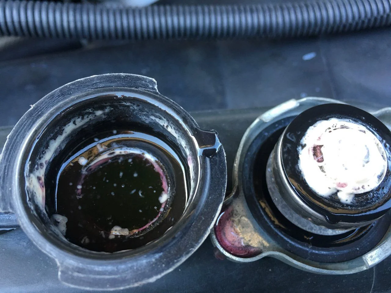

My original went to 220k miles. Replacement I think quit after 65k miles OEM Toyota. Took it to toyota tech today and says the radiator internal transmission cooler is leaking.
My original went to 220k miles. Replacement I think quit after 65k miles OEM Toyota. Took it to toyota tech today and says the radiator internal transmission cooler is leaking. View attachment 1349616
Interesting, I've not seen this before. Would you share your maintenance (flushing) procedure with us: How often miles & time between and with what?
Sure 2001LC, Since my original radiator I flush every 30k to keep things clean, always at the toyota dealer which always uses Toyota red coolant.
As Hoser mentioned the tranny line does pass through the lower portion of the radiator. Toyota tech and independent toyota shop both confirmed the white sticky substance was due to a leak from the line. It may have been the weak link in this particular radiator, exterior still looks new! I had the second radiator about 4yrs approx. 60k miles, so I'm disappointed this OEM failed. It didn't go the distance and crack at the plastic top at 200k plus like the first. Guess we have high expectations from Toyota parts, once in a while all manufactures produce a bad ...
You might send a sample of that contaminated radiator fluid to Blackstone Labs to confirm what's in there.
As for durability or service life of Toyota OEM replacement parts; OEM vs OES parts are often made to different standards- I think this gets overlooked. OES is what comes on the vehicle from the factory, often designed to a higher standard to get the vehicle through the end of the manufacturers warranty period to minimize claims. OEM parts that we buy from the Toyota dealer are not always designed to the same standard as OES, in fact most manufacturers spec their OEM replacement parts for narrowed duty cycle to increase service and parts dept revenue. OES Toyota suppliers like Aisin or Denso will produce 1 grade for production and another for OEM replacement parts. This might be one factor why the original radiator might last in excess of 200k miles, and the OEM replacement less than 100k.

What I was thinking is right. This leak is the pink milkshake that destroyed many 3rd gen 4runner trans. The radiator is so good it lasts for 15+ years so no one will replace it. But no one will think the trans cooler will leak before anything else. Many 4Runner owners now bypass the radiator and install an external cooler in front of the AC condenser. It seems to work perfect. I feel like doing it to my cruiser.
