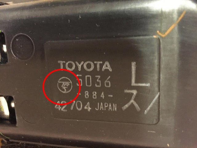

Denso does indeed manufacture OE radiators for Toyota but not for Land Cruisers. Toyo Rad/T.Rad has supplied radiators for Japan built LC's since the 40 series... at least. If your radiator is original, check the top, near the reservoir.

The OEM radiator is manufactured by T.Rad, not Denso.
This is interesting, I've emailed T. RAD and waiting on reply.

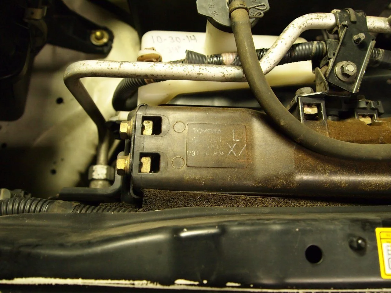

Is that factory installed? What year is that from?
Cool I've been trying to read my radiators and one just had a bit of this readable, although numbers are different: Toyota / 5021 / 694 *3**0 JAPAN/ L X/
The pic was what you'd get if you ordered new from Toyota. My radiator looks similar to yours... where you can barely make out the T.Rad symbol.
That explain why it look new. Thanks.:)
