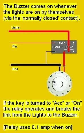

'Lights-on' buzzer - safer circuit
Here's another variation - it uses a relay to switch the lights circuit into the buzzer so there's no possibility of running power from the lights circuit to the ignition (in reverse) through the gauge circuit.
Any 12 volt relay with a normally closed pin will work (single pole, double pole, etc). You can just solder this together with some light gauge wires, it doesn't need a circuit board.
If using an automotive relay ensure it has an 87a (normally closed) pin to buzzer, wire lights fuse to pin 30, and cig & gnd to 85 & 86. Pin 87 (normally open) is not used (though there is a possibility of using it to trigger daylight running lights ...)
