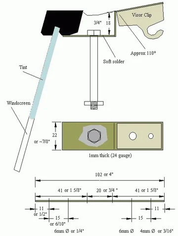

GPS mount - permanent
I bent and drilled a piece of brass to fit under the visor clip, soldered on a bolt, spayed it black and voila! a $2 permanent mount for my accident recorder camera - but could just as easily hold a GPS, etc.
Picture is of my right-hand-drive 62. I had to use a 60mm bolt to get the camera lower than the blue tint, but a GPS could use a shorter bolt. Plastic bolts are Ok for the light loads if you are worried about putting a piece of steel in front of your (passenger's) face.
I used brass because I had some to hand, but you could use steel. Power lead hidden under liner edge beside windscreen. Easy, simple, and (now that you have the dimensions) a very fast mod/addition.
Does stop the visor folding all the way down, but doesn't stop the visor from performing its designed purpose.
Mine had to use a 60mm bolt to get the camera lower than the tint, but a GPS could use a shorter bolt. I used brass because I had some to hand, but you could use steel. Power lead hidden under liner edge beside windscreen. Easy, simple, and (now that you have the dimensions) a very fast mod/addition.
Thats a nice diagram but now we want to see pics !!!

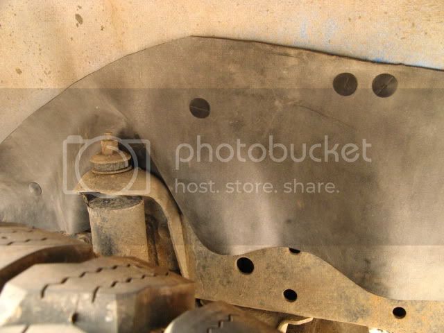

Replaced the front wheel well engine bay cover doo-dads.
Stout rubber stuff I've had for years...free.
12 GM style push fasteners from Lowes, $5.20.
