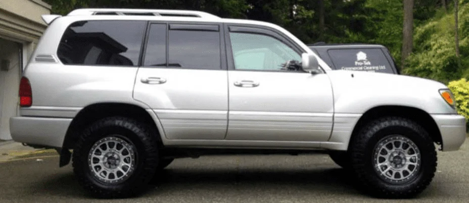

Any luck? As you said, this is the real issue. The stock method caps are fine for the rears.
I think I've seen someone on here with Method 315s with the standard method cap on the front. I see some without also. The standard cap is very thin metal.
Anything is possible, but I doubt it. They dont fit on my truck, and I've never seen them fit anyone else's that didnt drill them.
Mine are plastic inserted into an aluminum shroud.
Member @re_guderian is running Method Race Wheels with caps front and rear. These look like regular 305 NV. I see some members running caps on the front and some who don't

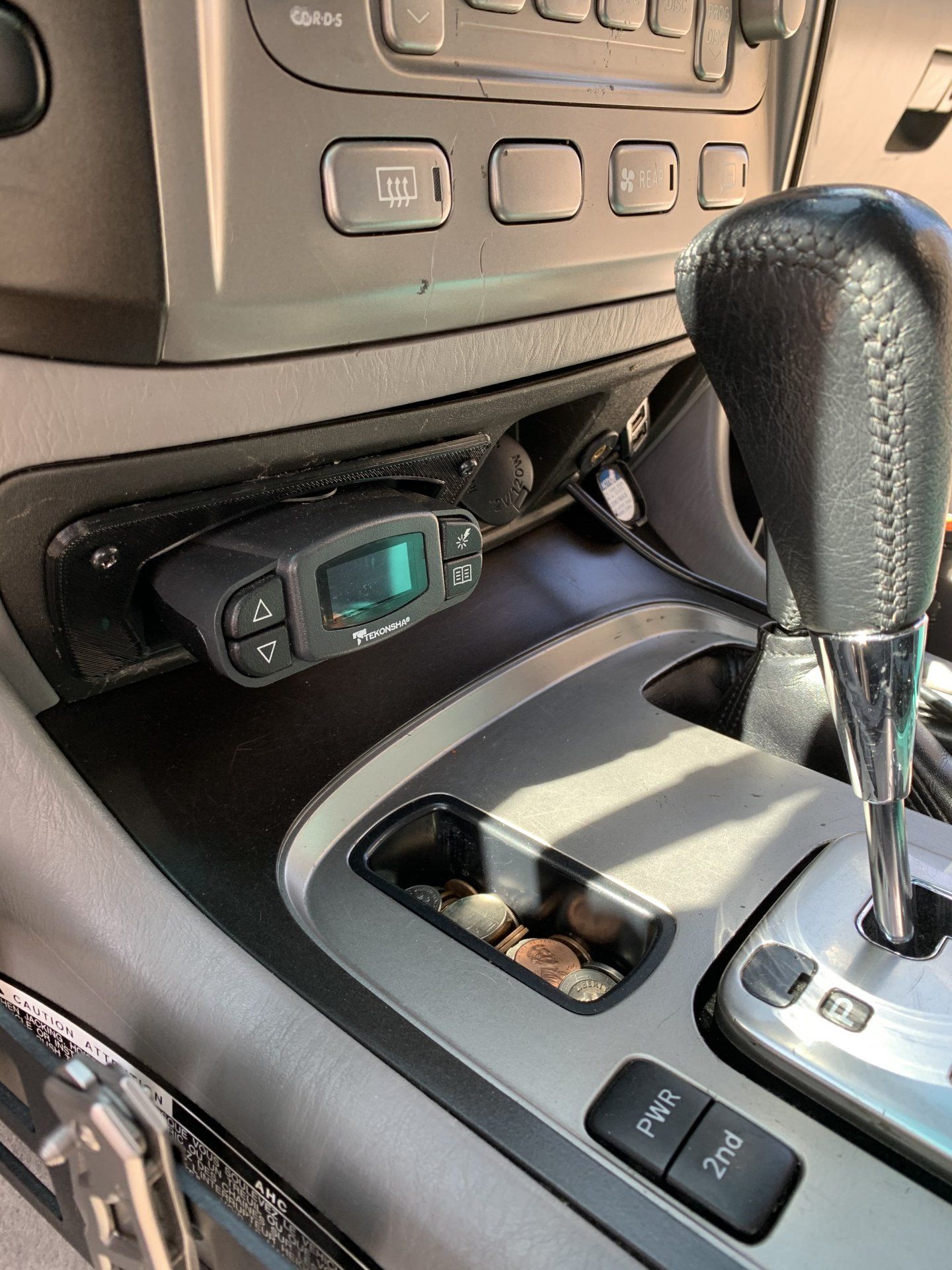

Hey,
I found a trailer brake ashtray mode for a LX on another site but I had to break out my dremel to make it work for a 100. Any chance on making an ashtray trailer brake holder for a 100? I got this one to work but would rather have one that is more stable.
Hey,
I know this product. It is a fine design. But not my style. I want to keep all my designs have somewhat factory feeling. Something similar but larger than that is coming.

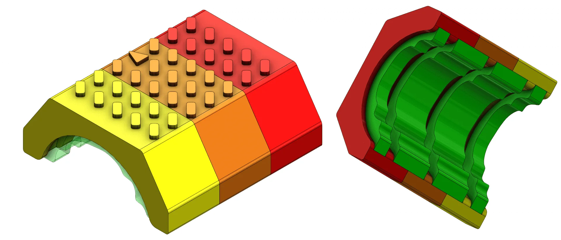

Make 25 Door Step (Developing)
Requirement from @jlm43
"Maybe 6 inches long. It would act as a step to get onto the roof rack. The bottom should be some what soft and not slippery. The top can be hard but also no slippery. It’s something to protect the door trim and window seals when I don’t want to set up a ladder. And it would be a lot smaller and easy to store in the truck."
Tested the prototype. The liner(yellow) is printed with the same material used to make the facemask tensioners. The soft material is used to protect the door trim and paint. But it is not too soft so the white hard plastic part will not be in contact with door panel under load. The mainbody(white) of the prototype is printed with PLA. On the final product, the material would be ABS (stiffer, tougher but hard to print) or PETG (stiffer, tougher, and better impact resistant).
I am planning to print the final product in the TRD three-color scheme.
The mainbody is glued from three parts. This makes the assembly much tougher than a single print. The liner is also glued to the inside of the mainbody.
