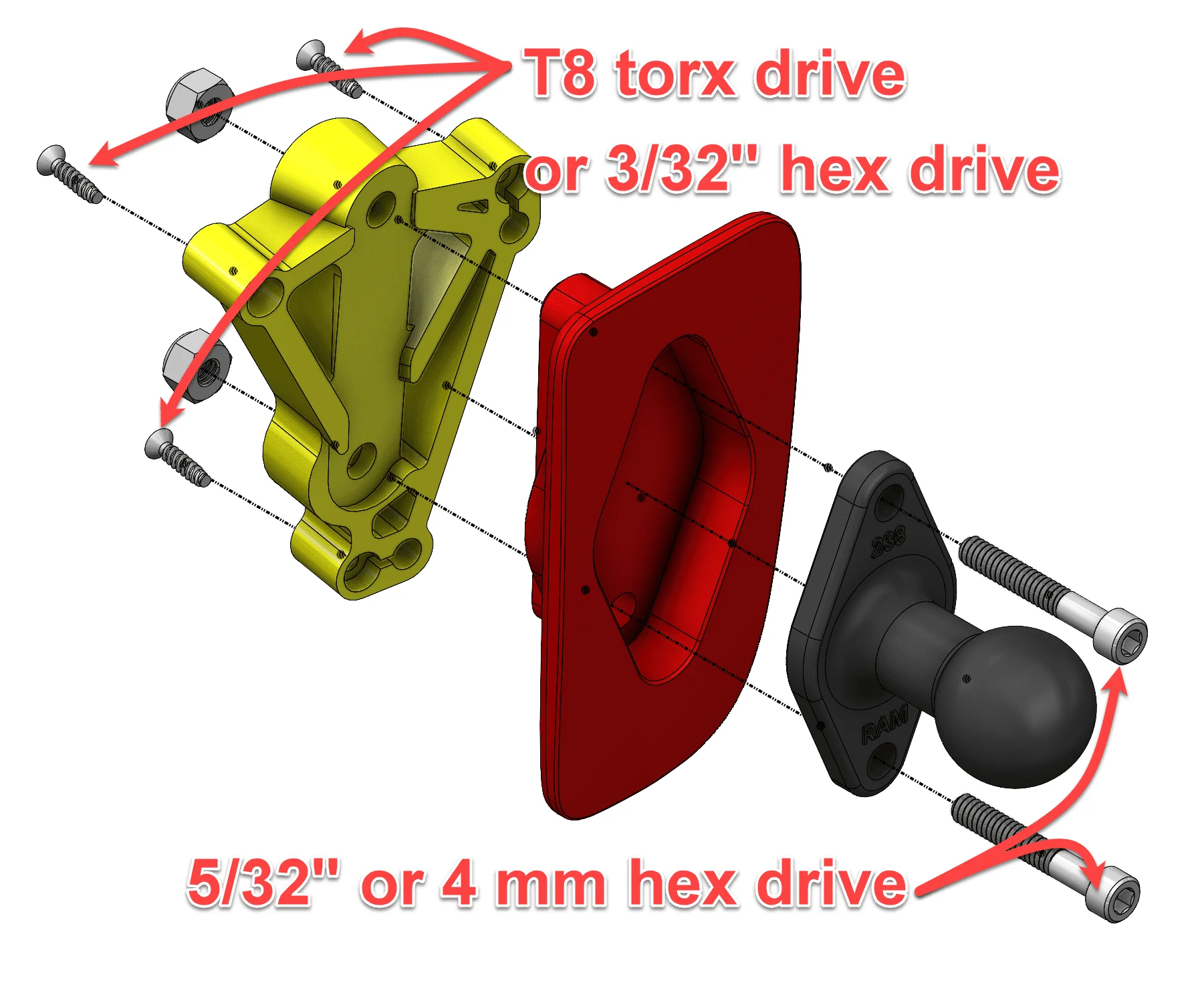

Thanks to @gregnash. I am putting this on for your installation.

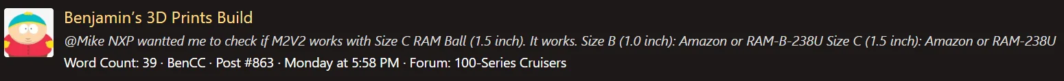

Is there any reason why one couldn't use a 1.5'' ram ball on this and the change pocket adapter? Looks like the bases are the same...the 1.5'' is rated to hold a little more (thinking tablet over the change pocket).
Also, Ben - sent you a PM on a microphone idea sir!
If the base is the same then shouldn't pose an issue I would think.

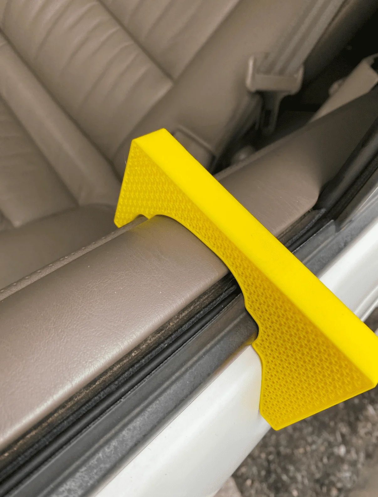

Make 25 Door Step (Developing)
Requirement from @jlm43
"Maybe 6 inches long. It would act as a step to get onto the roof rack. The bottom should be some what soft and not slippery. The top can be hard but also no slippery. It’s something to protect the door trim and window seals when I don’t want to set up a ladder. And it would be a lot smaller and easy to store in the truck."

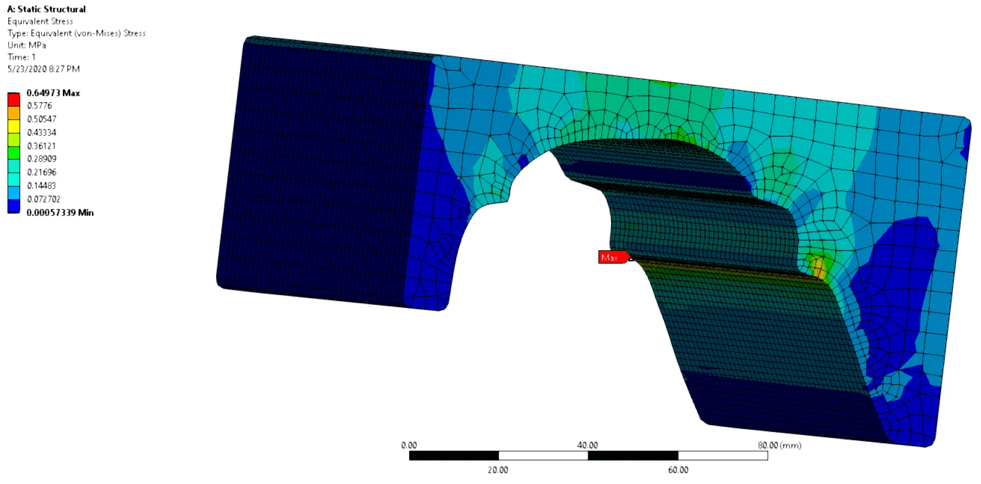

Rear door profile was captured and built in CAD.

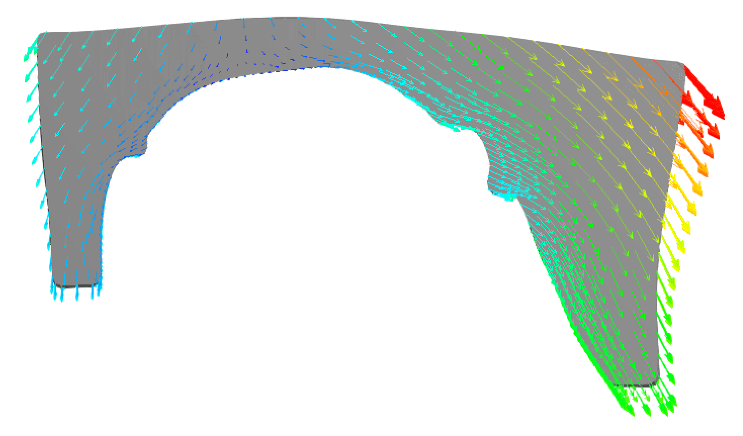

A preliminary FEA was done, showing the maximum equivalent (von Mises) stress is only 0.65 MPa which is far lower than material's tensile yield strength (44 MPa). The assumptions made include (1) uniform contact between support and the part (2) uniformly distributed load (3) load is 2400N (240 kg or 500 lbs weight). This is only to estimate the scale of maximum equivalent stress. The actual stress would be larger due to non-uniform contact (stress concentration).
The material's deformation vectors are shown in the following figure. Material "flows" in the arrow direction under the load.
A soft bottom layer will be added to protect the door paint.

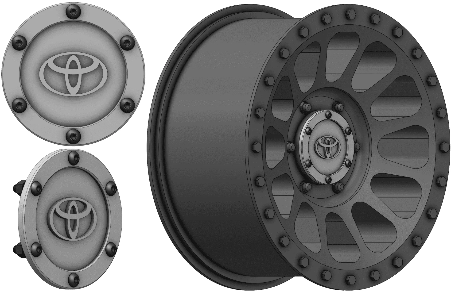

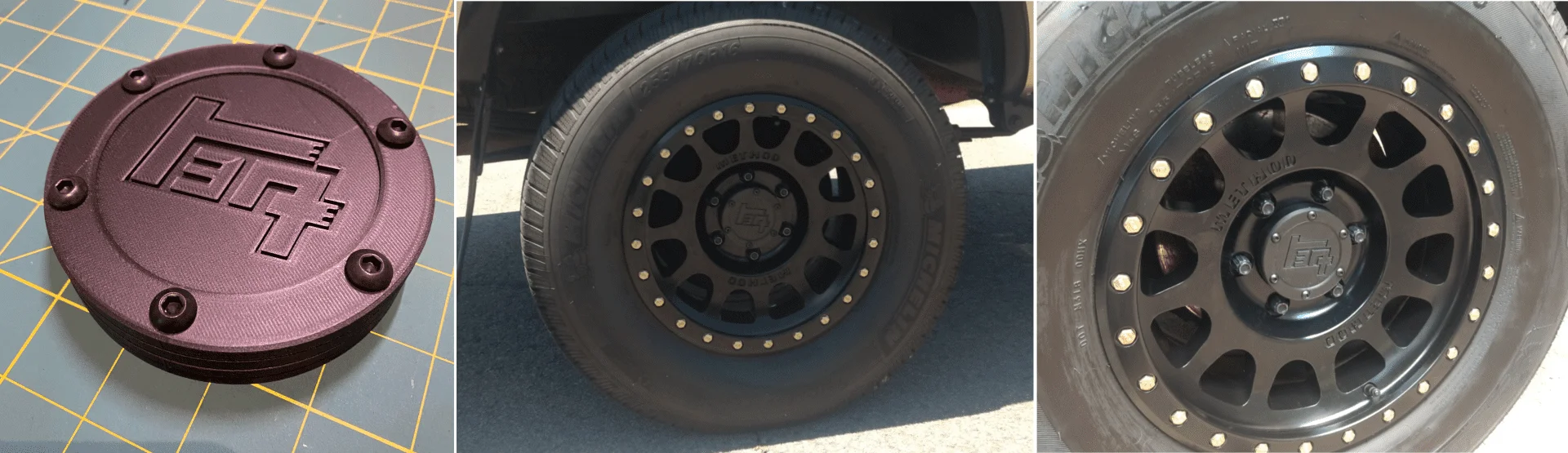

Make 26: Wheel cap for Method NV Wheel
1. Overview
Photo credit: @OwnerCS

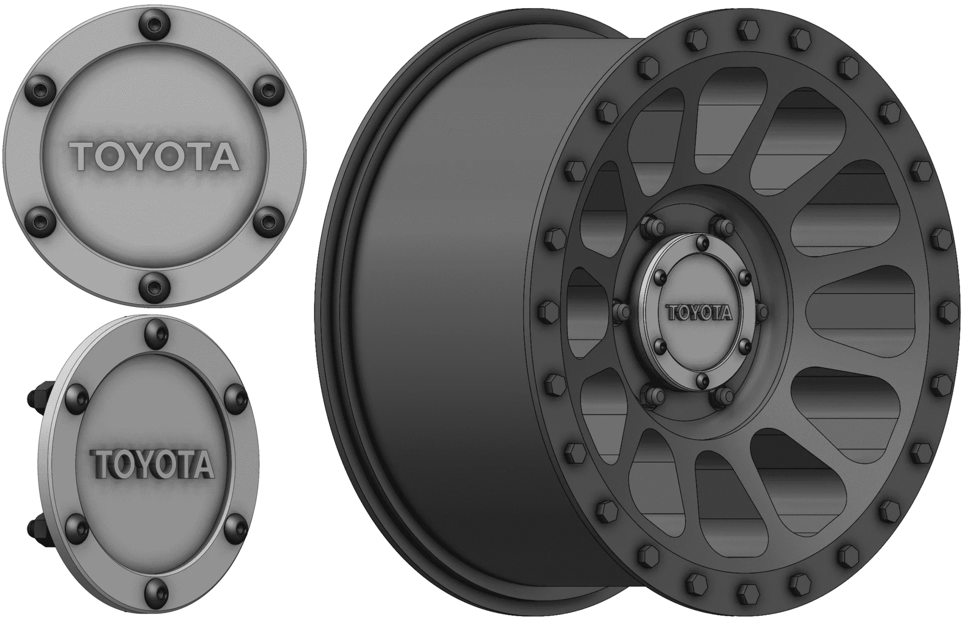

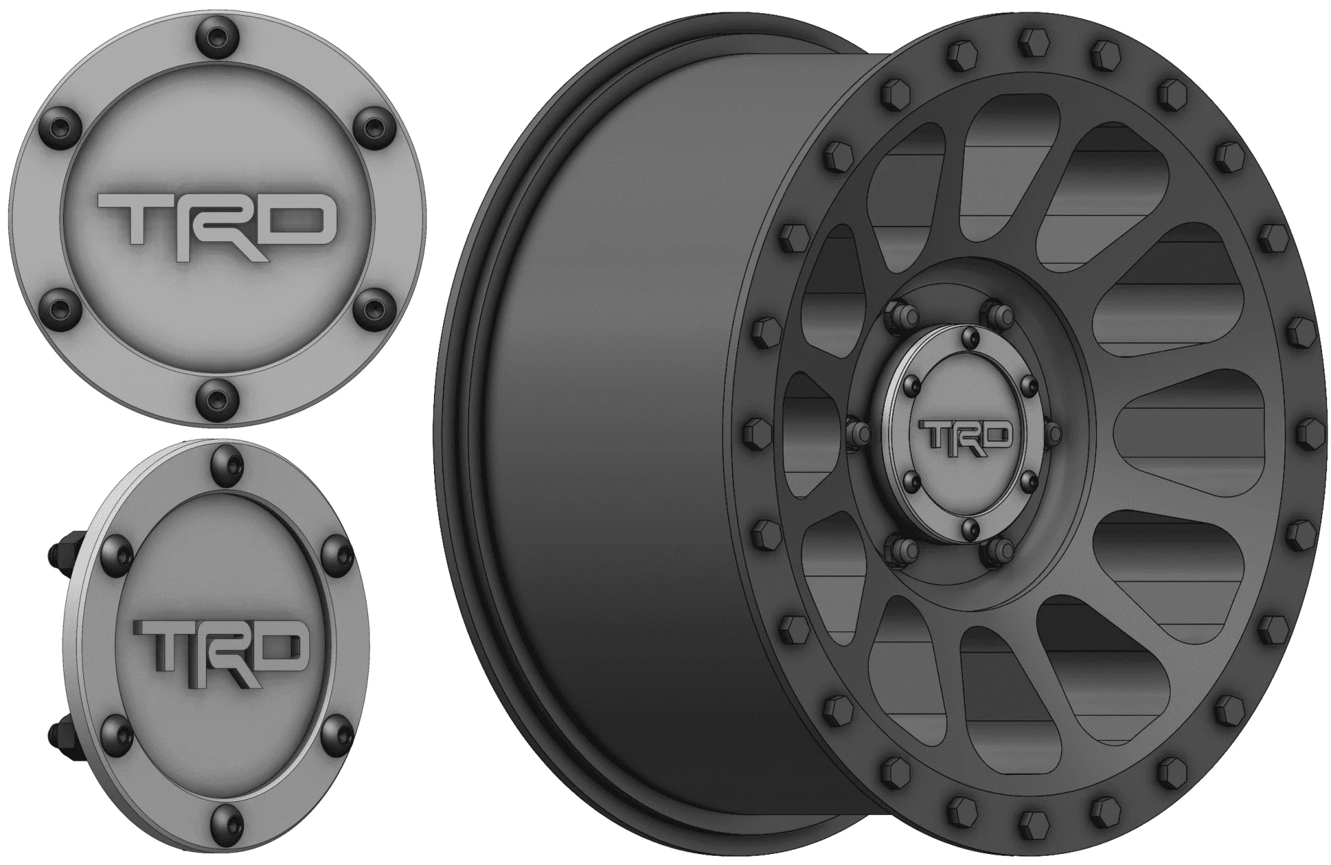

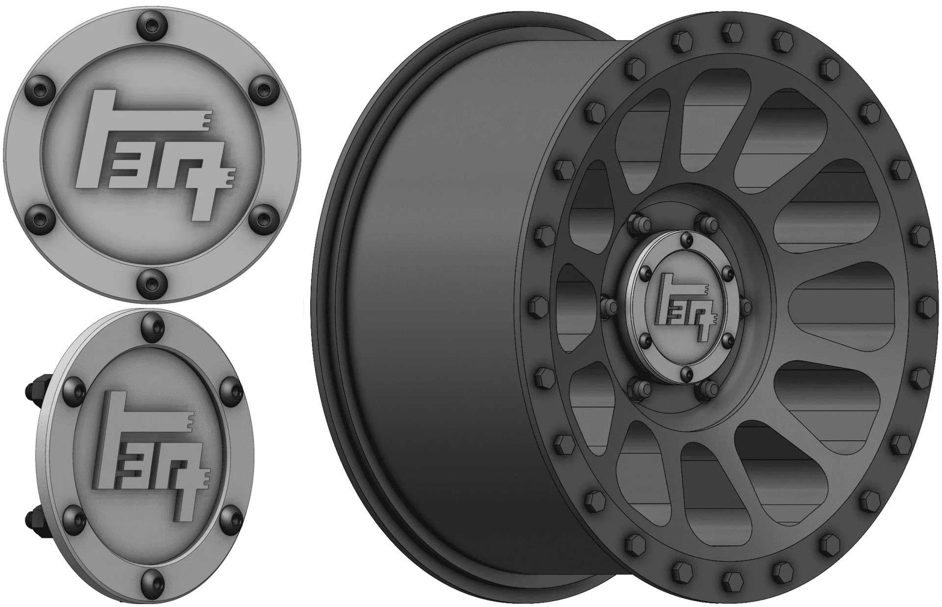

M26V1
M26V2
M26V3
M26V4
M26V5
M26V6
