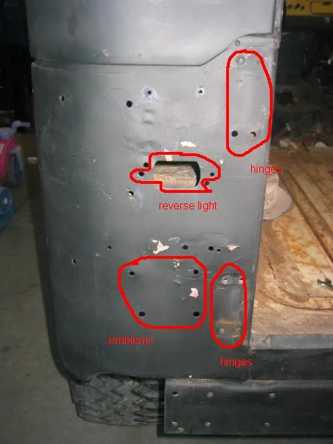

There was nothing mounted to the drivers rear corner, but there must be 15 holes drilled in. Does anything besides the tail light mount there? Looks like I have a bunch of holes to plug, if someone can help me determine which ones I need.

Rear drivers-side qtr panel held a couple of emblems, a Toyota Emblem and a 4WD emblem. That's the source of a few of your body holes. Also there are the holes for the hinges for the rear doors and the large opening is for the reverse light.
You do, however, appear to have several extra holes in the qtr panel.
