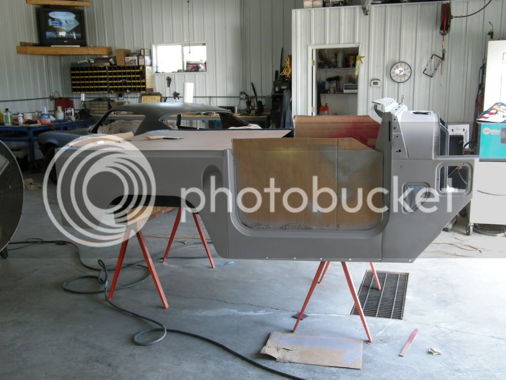

Just to show progress, I got the bodywork about done. Sprayed with surfacer yesterday. Now blocking begins. I know these weren't real straight from the factory, so I will do the best I can.
Might get it in paint before the end of the month!

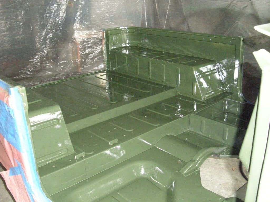

PROGRESS!!!

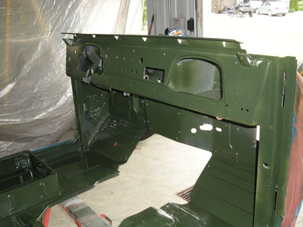

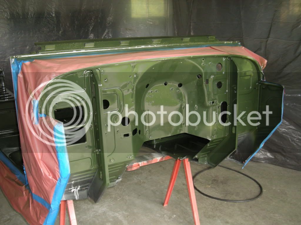

Well, only a month later, and I am finally showing some progress. Got the inside of the tub, dash and firewall in color. WHOHOO!!!
OK--bad news--had some spitting with the gun, so I have to repaint the dash and firewall. When I say this, I decided not to put all the coats on, so I have some light spots and misses to hit. Will redo this week. Not a big deal--getting color in the tub was a big deal

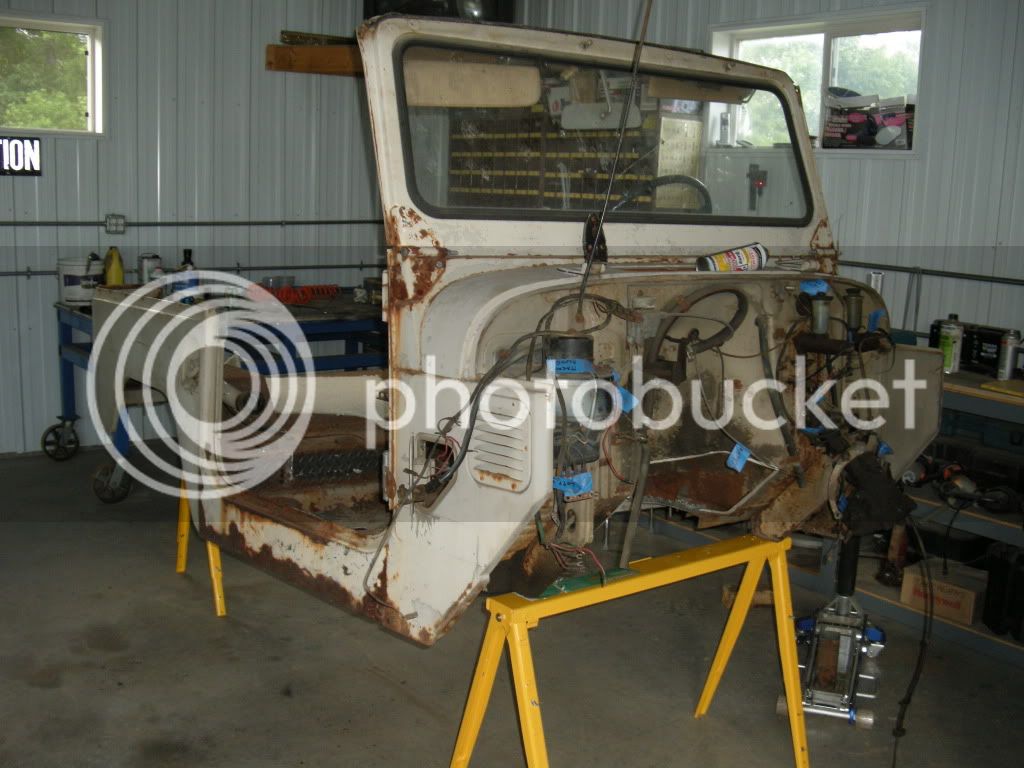

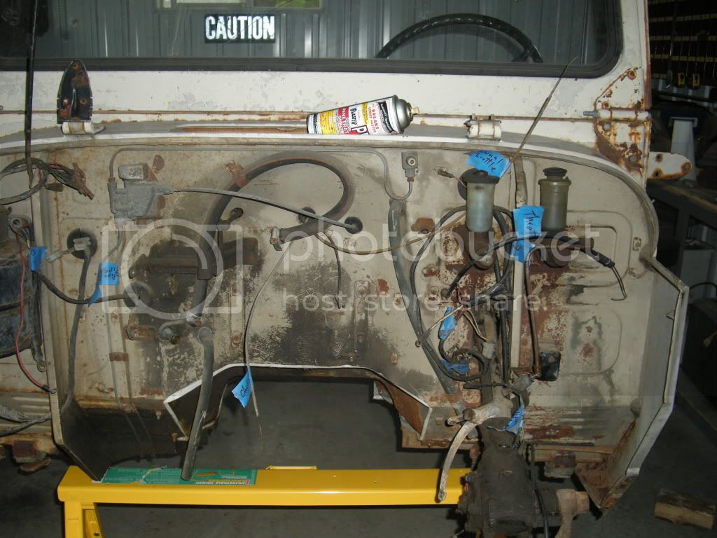

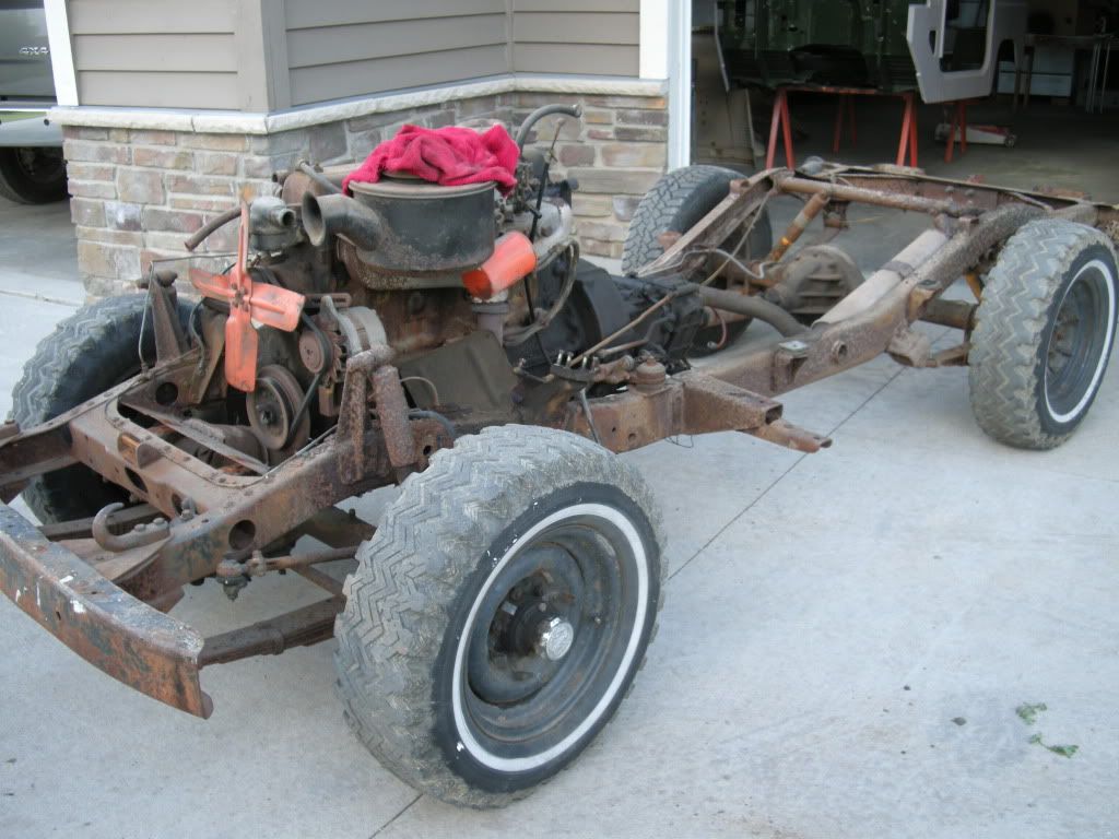

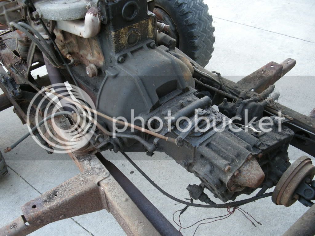

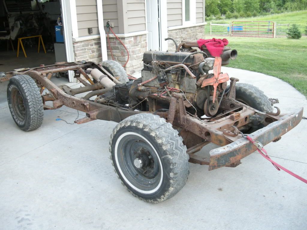

Got the rusty cruiser in the shop to begin teardown. WOW, I don't think I ever used a hot wrench so much in one day! I actually think it will go together easier than it came apart!

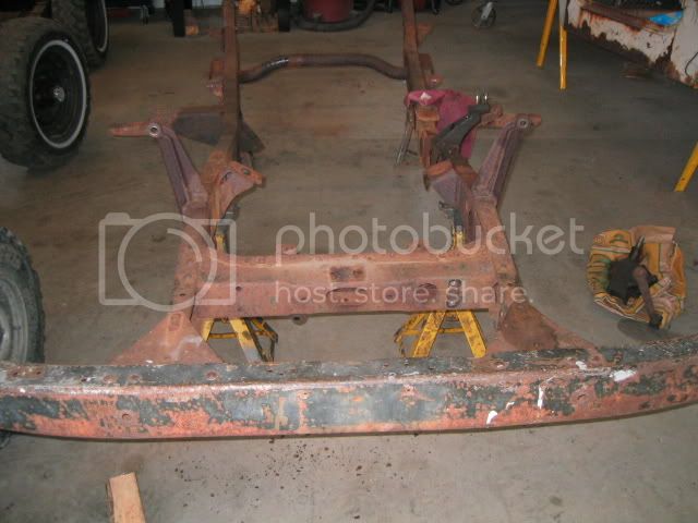

Got the tub and the frame separated, tub on stands, and getting ready to power wash the frame and drivetrain tomorrow. The frame is pretty tough, so I may end up using the 66 frame, but I won't know until I get the crap off of the 70. Then the plan is for sandblasting the frame, disc brakes, power steering, change out the thirds for 3:73's, trips to Poser for parts.
Then I will put the redone tub on the redone frame, and begin transfering and cleaning parts from the rusty cruiser to the redone tub.
Fun Fun Fun!!!

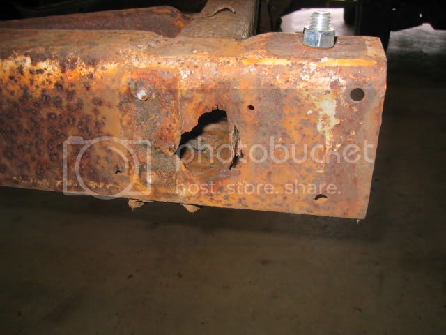

Got the frame stripped down, and the axles out. Broke a dozen bolts, so I am going to have to buy a metric tap and die set.
Also took a lot of measurements, as I am going to cut the rear of the frame off, and weld on the rear part from a donor frame. Note pic of the hole in the rear pass side of the frame.

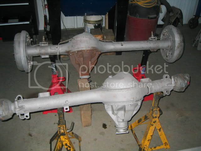

Got a lot of parts done--diffs, engine mounts, trans hump, part of 2 frames (blasted the back of one I was cutting off). I am putting different thirds in I got from poser, so I swapped them on the front axle twice, since it was apart, so I got them both done.

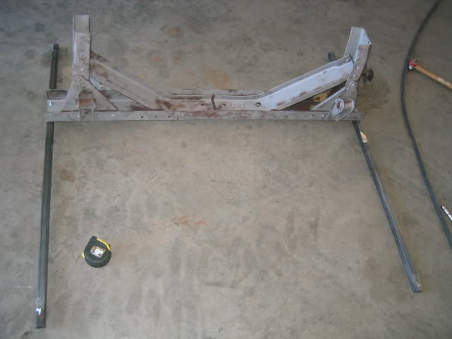

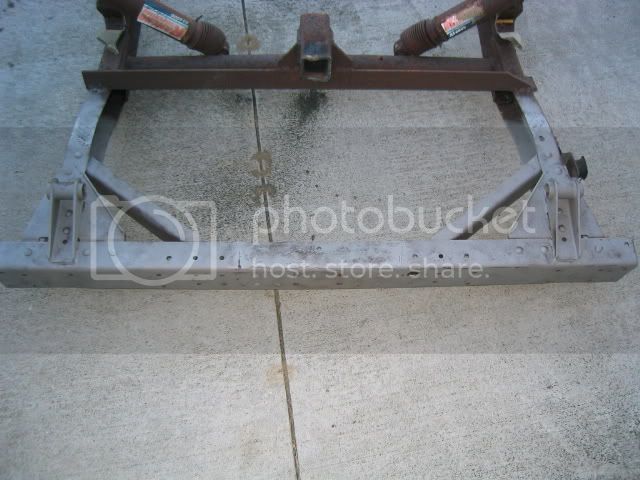

So today, I decided to tackle replacing the back of the frame. The right rear side and rear rail were rusted out.
First I took all kinda of measurements and diagonals to make sure I did it right. I also did a hieght measurement, then made some legs to hold up the new piece to weld in. A lot of cutting and grinding, and jockying around. I welded the outside and top of the rails, then put a diamond on the inside for added strength. Ground down the top and outside welds. Haven't welded the bottom yet. Not good at up side down, so when I get the frame out to sandblast again, I'll weld them.
The legs were really a labor saver. When it is all together, my measurements were all right on.

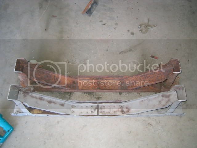

Donor Frame sandblasted
Cut off the bad frame--here are the 2 parts
Welded new one on

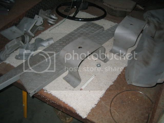

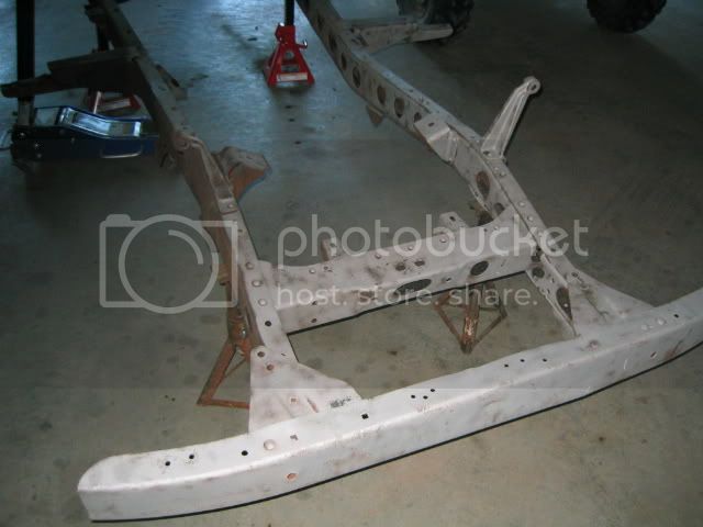

Sandblasting done!!!
Finished up the sandblasting yesterday--Frame looks pretty goot. Also cleaned up the trans and transfer case.

Trans/Transfer will get Eastwood Alumiblast
