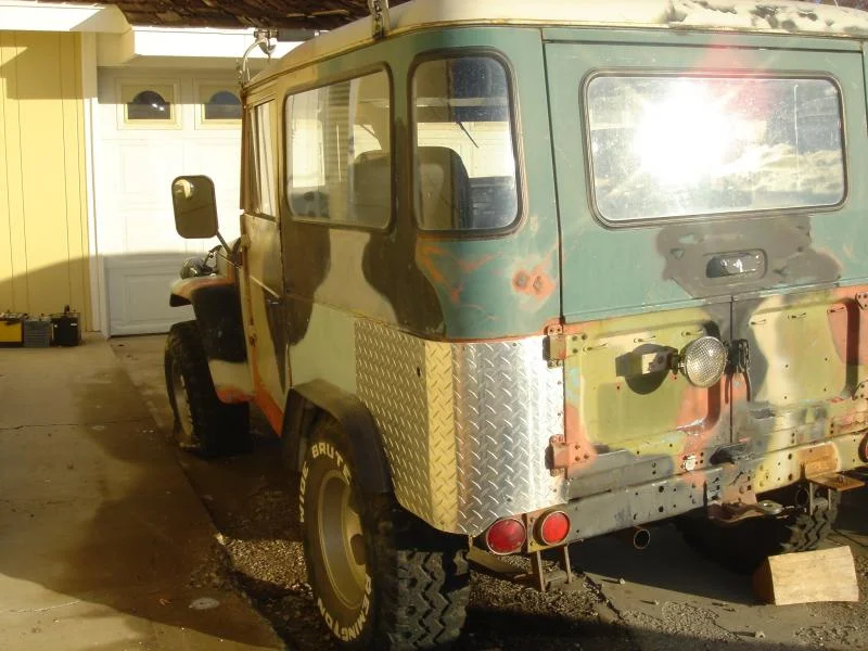

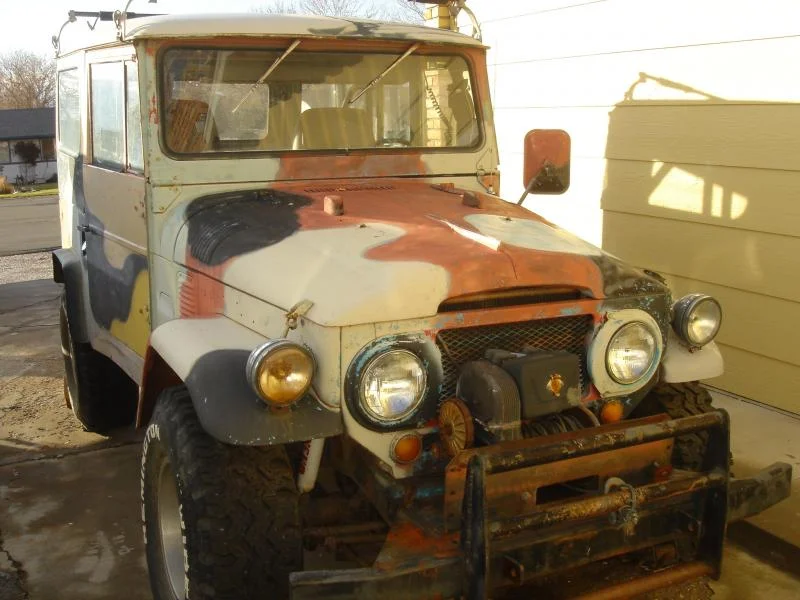

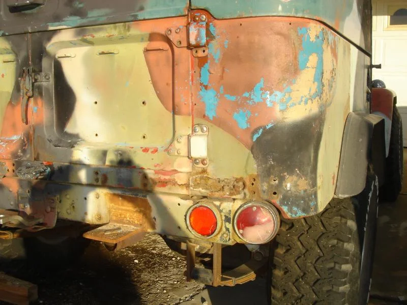

My "Rattle-can Resto," or How I Spent My Summer
First let me say, this is not a frame-off, alas! Purists and perfectionist please turn away now.
I have spent many, many long hours up to now researching and planning my ultimate dream build for my 1968 FJ40. This is the first project vehicle I’ve ever wanted to tackle and I can say that I’ve been inspired by the many incredible and painstaking projects that have been shared here. The IH8MUD knowledge base is vast and I have studied intensely. A complete frame-off seemed like the only appropriate thing to do for my FJ40 that I love. In the process of planning I created spread sheets of the required parts, part numbers, prices, suppliers, time-lines etc. Words like ARB, NV4500, POR-15, MAF, SOR swirled in my mind. As the scope of the project multiplied and the tally continued to rise I eventually came to this sobering and painful conclusion: There’s no f**king way I can afford to do all this!
As this reality sank in that I had neither the money, nor time, to take on my dream build I formulated Plan B. My cruiser runs pretty good. It’s got a low mileage SBC 350 mated to the original 3 speed tranny/transfer (rebuilt recently says the PO). It just doesn’t look good. The new plan: make it look good, minimize down-time, then drive the hell out of it and have a blast. It doesn't have to be perfect -the frame-off resto can wait. Suddenly the pressure was off and I was ready to have fun.
Here's what it looked like before:

Pulling off the diamond plate reveals......
Not too bad .

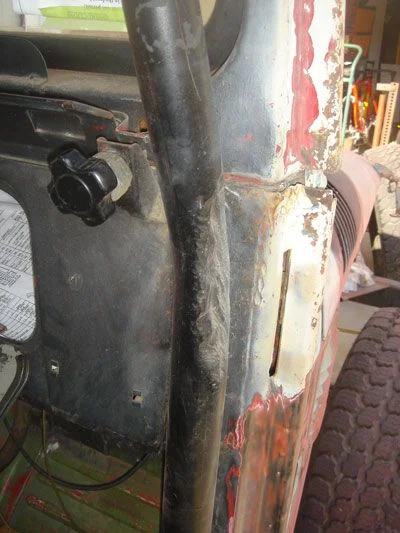

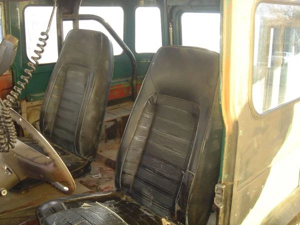

Here's a couple of the interior. Hard top is not original to the vehicle. Check out the custom roll-cage. What do you do if you just fabbed up your cage and realize, "uh-oh, it doesn't fit." Grab your BFH and go to town, right?
Pisses me off every time I see it. Still don't know how I'm gonna fix the body damage to the dash...oh, well.

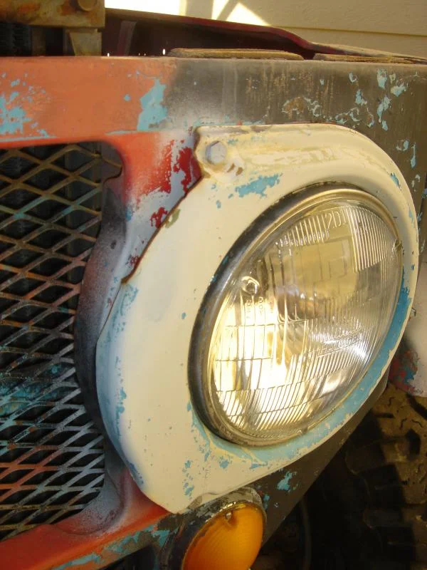

Yeah, bezel got hacked by PO, presumably to fit the Warn winch. Please note, however, that it is oriented correctly as demonstrated in the following pic. There is a wider hack hole at the top than at the bottom .

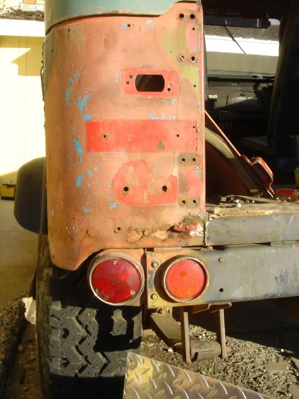

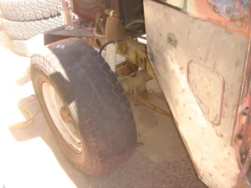

Plan was to do some body work - get the worst of the rust cut-out, fix very large dent in the passenger rocker. Fill lots of holes from PO. That guy drilled a lot of holes in the old girl. Anyway, I was going to try and justify this being in tech by showing how I repaired them. I had issues with my camera though and lost nearly all pics detailing repairs.
Probably for the best. You guys would have surely mocked some of my methods. For example, to fill the many small holes left behind by the diamond plate screws I simply taped a penny (copper, after all) behind them, welded them full and ground smooth. I did pick up some 16 guage sheet metal and pathced up the rear sill. It came out pretty decent and I used only a small amount of filler to smooth it out.
Only pic I have of the penny repair, sorry.

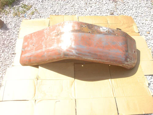

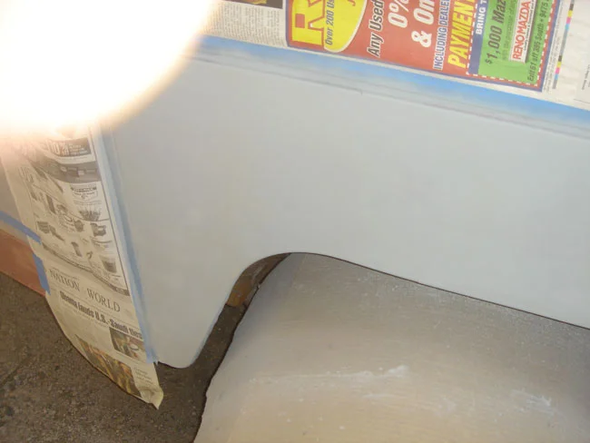

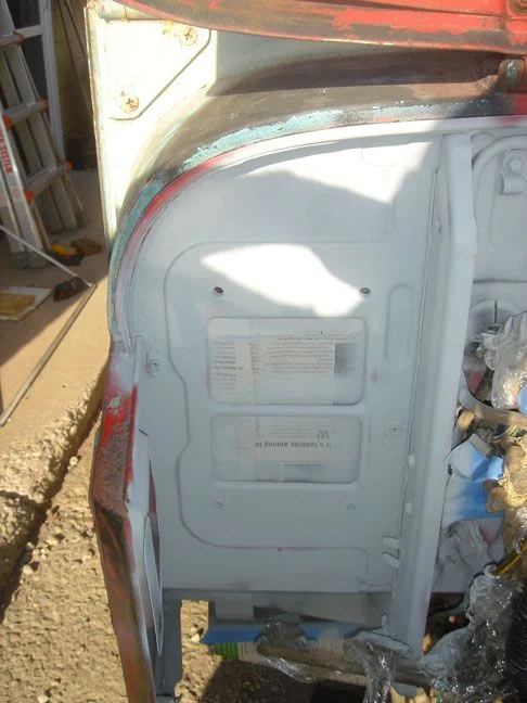

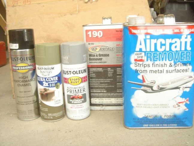

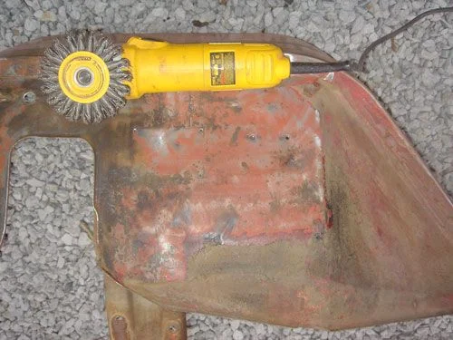

The existing paint was really bad. It was peeling all over. I hadn't intended to strip all the paint but when I took a sander to one of the rear quarters I inadvertantly cut a swath of beautiful smoothness right through that crap. "Uh-oh," I thought, "now I've done it."
So, I set about stripping all the paint. I used aircraft stripper, wire-wheel, DA sander, those paint and rust removal wheels and anything else I could get my hands on to take the old stuff off. Very laborious, but also very gratifying.
Here's a few pics for documentation sake:

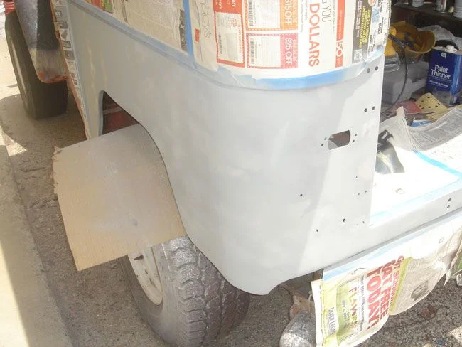

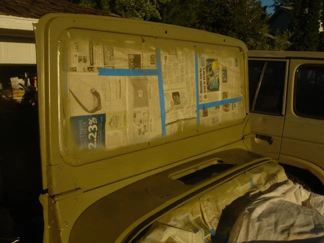

I used Rustoleum rattle-can primer. Everything got at least two coats. Sanded with 220 before painting. Firewall was tricky. Removed as much as I could and used saran wrap extensively. I hate overspray.

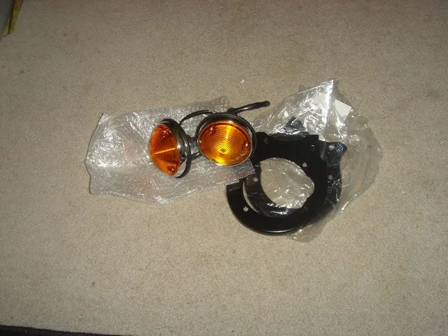

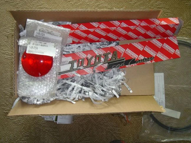

I ordered a few things: new parking lights, tail lights and brackets, new apron emblems. Wow! They are beautiful. Also ordered some gaskets for the barn doors, fenders, kick vents, etc.

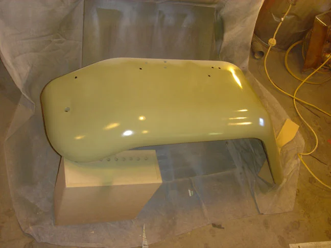

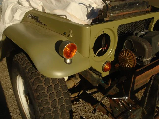

Finally, a few of the paint. It's on olive green type color. We call it "orc-hide" 'cause it's a dead ringer for my son's paint for one of his models. I know some are thinking I should have got an HVLP gun and done this "right." My goal was to keep it simple, and affordable. Spray paint doesn't have to look crappy. I've developed a decent hand for it. I used a wax and grease remover and carefully removed dust with a tack cloth. It's critical to work that wet edge while painting and have decent lighting. Everything got at least three coats, sometimes more. When neccesary I wet-sanded with some 400 grit between coats. I think you'd be surprised.
I still have a ways to go on this before its roadworthy but it is looking soooo much better. I welcome your comments and suggestions.
Anyway, last pics for tonight.

Quote:
Originally Posted by FR3533 View Post
what brand rattle can are you using, looks great im a big fan of the rattle can
Quote:
Originally Posted by Copenhagen1 View Post
The truck is looking great. You and I are taking our trucks in the same direction. Keep up the good work.
Quote:
Originally Posted by Combat Chuck View Post
I'd just like to say that rattle-can restos are totally worthwhile. Honestly, a professional job is nice, but you end up kicking yourself every time a rock chips some paint off, or trees scrape it up. If you take your rig out to the trail, and throw some gravel around, and need cosmetic repairs later, just about any hardware store in the 'States carries Rust-oleum. I call it a win.
Great job so far, Cruiser Enthuiser, I folowed your TBI swap, and am looking forward to seeing just how awesome your 40 shapes up to be.
Thanks everyone for the positive feedback...obviously a lot of like minds around here. Seriously, the kind words are very motivational!
Copenhagen...I've really enjoyed following your build - it definately inspired me to go this direction.
Chuck...thanks!
I have some work to finish up on the interior but I promise to share more pics soon. I'm gonna take a lot of poser shots for sure.
For reference, here's a pic of some of the products I have been using. The rustoleum color is officially called "oregano" but I prefer "orc-hide." The gloss black is for the bumpers/roll bar, hood hooks, etc. I also used a flat back (not in pic) in the engine bay and underside of the front fenders.
