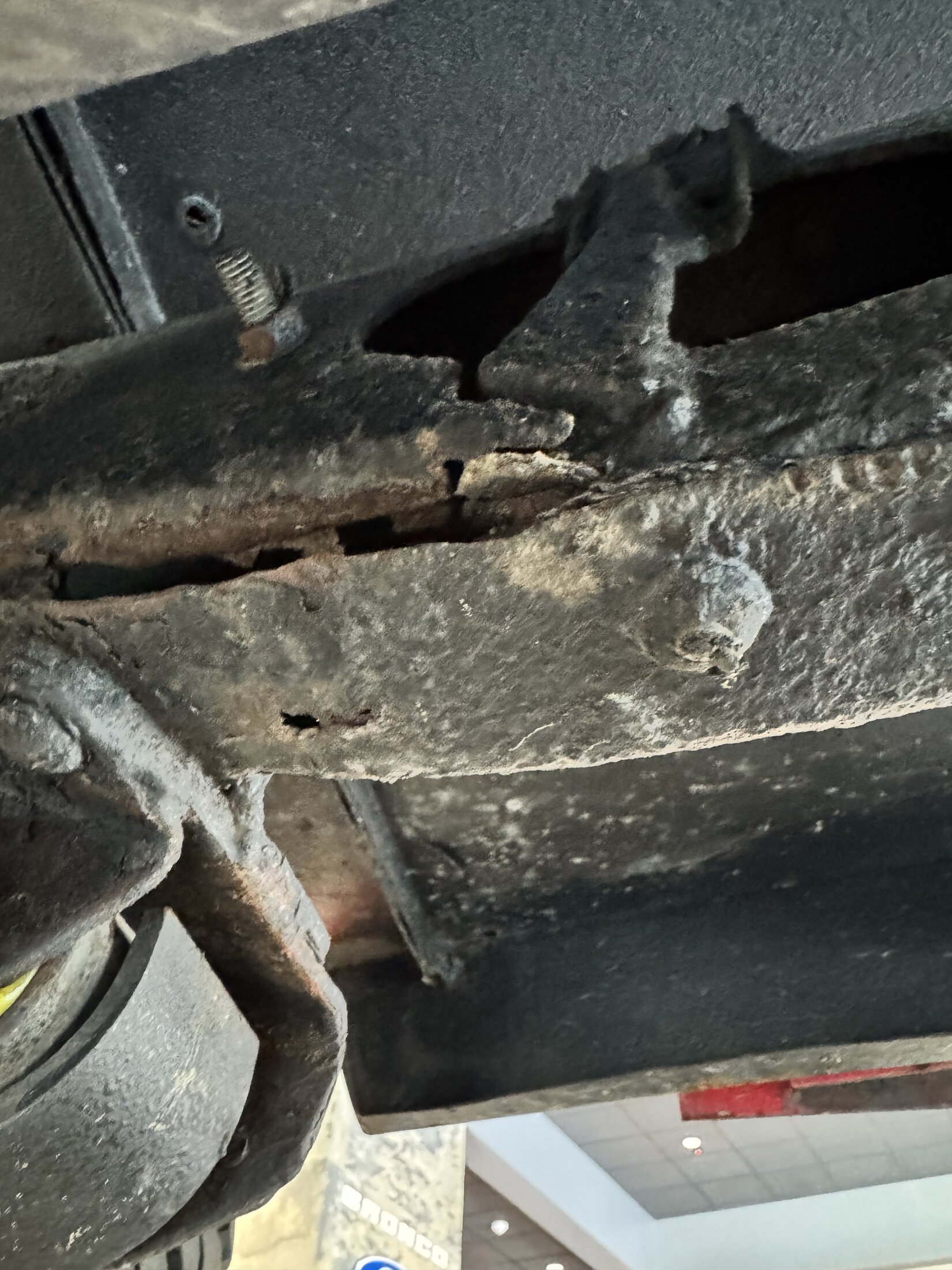

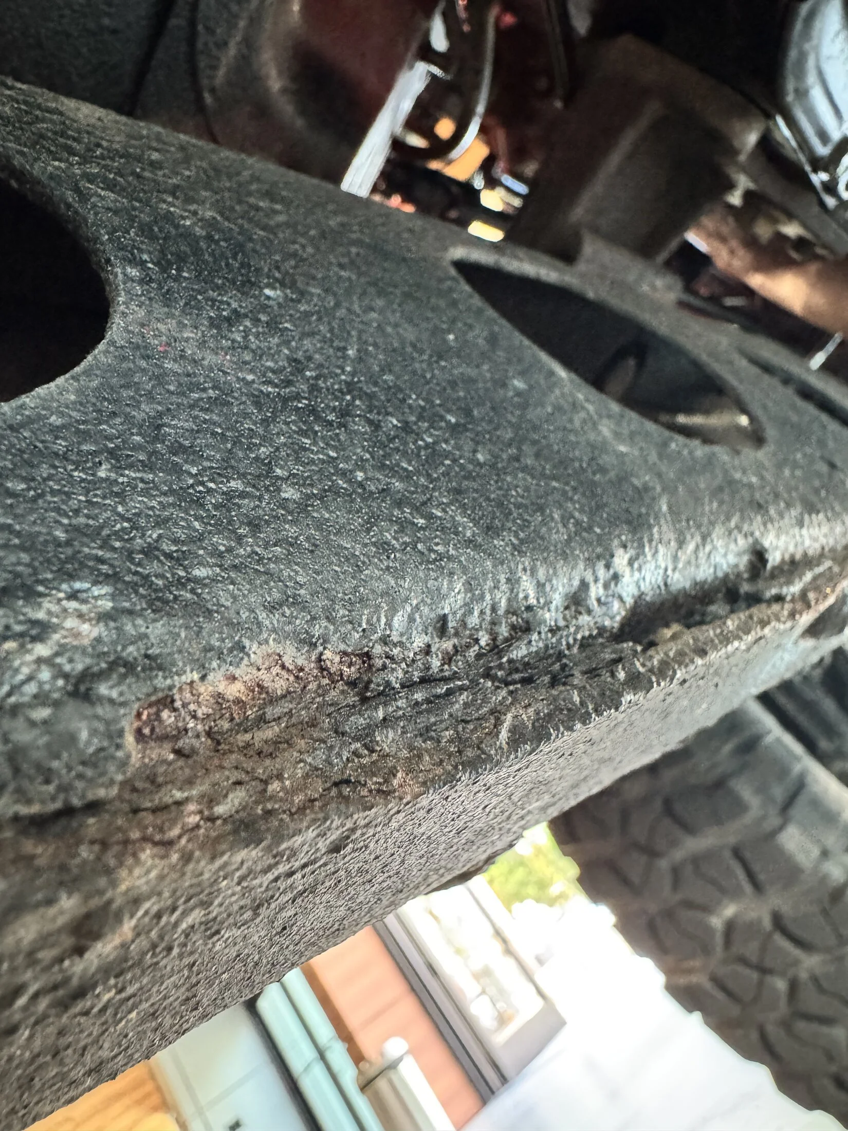

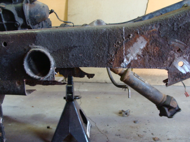

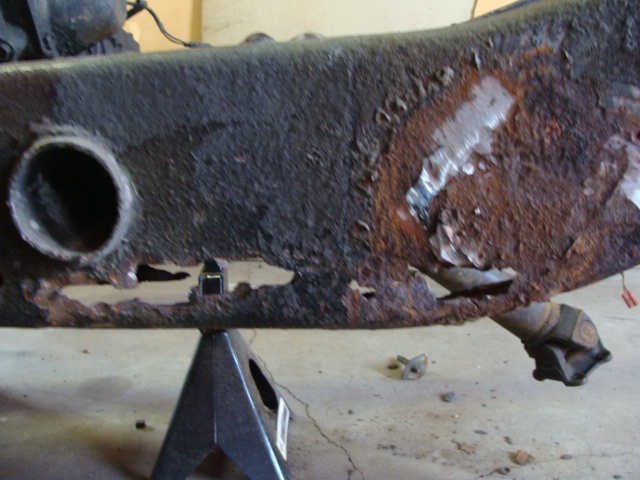

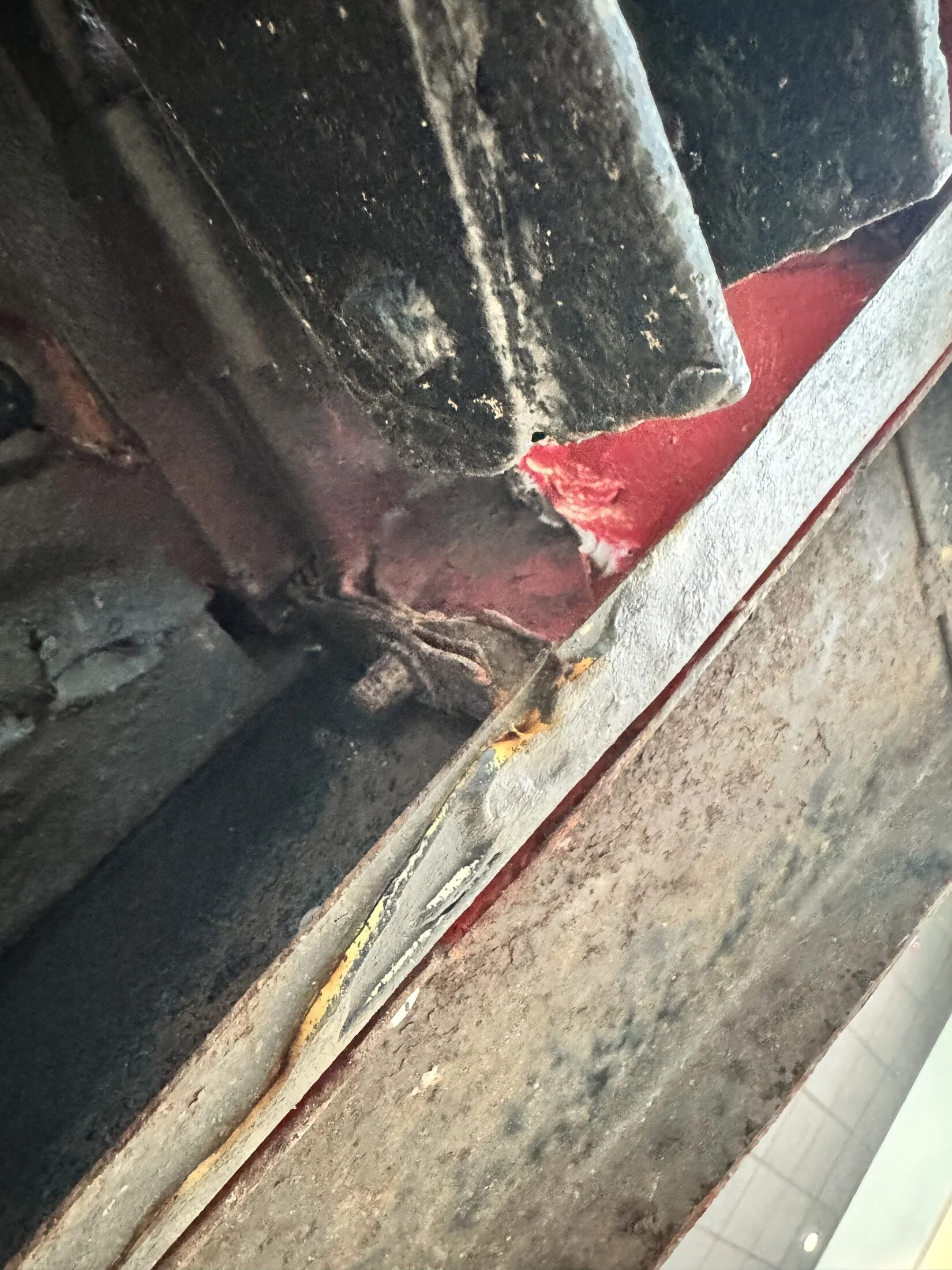

Hey guys, been reading a lot of y’all’s builds and just want to start off thanking yall for the entertainment and knowledge. I started looking a few months ago seriously and a couple of 40s are close enough to go touch and feel. The most recent one seems like a decent truck and has been relatively taken care of. I’ll attach a couple of pictures of the areas of concern. Big thing was, she cranked and ran extremely easily after sitting for a couple of weeks.
What do y’all think. Would y’all touch it or no? There was only one concerning portion of the frame on the rear driver side before the leaf spring. The paint looks pretty fresh so I’m thinking stick on a pig but overall it doesn’t look terrible.
Thanks for y’all’s input. Looking forward to getting started on a 40.

It does look terrible.

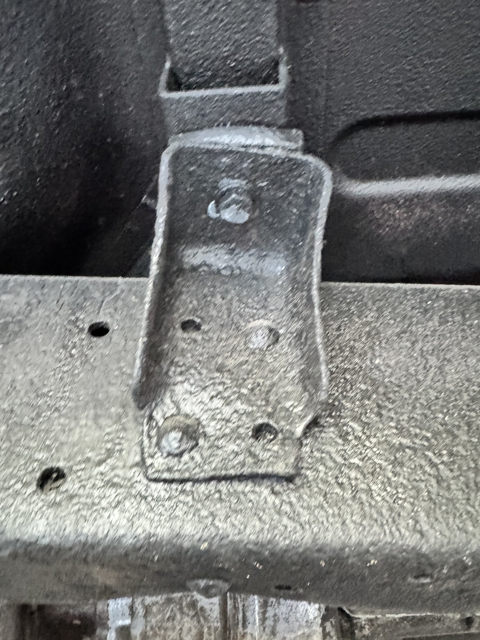

That frame is toast. Also that body mount bracket looks bent. Keep looking.

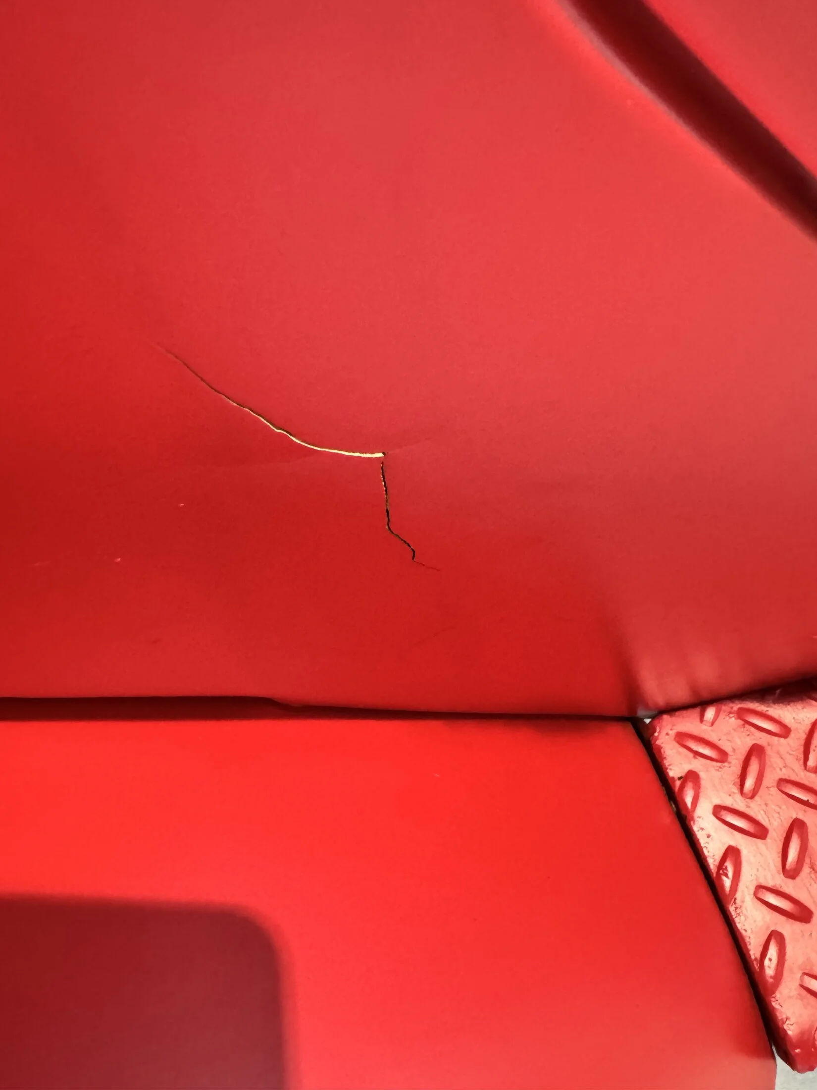

Haha It looks like all the other matte paint jobs I’ve seen minus the cracks around the bondo. I agree that does look like s***. I thought the same about the body mount which is why I got a picture of it. There’s no repairing that section of frame? Really that little stretch was the only noticeable section.
If the frame is that bad, I'd be worried what all that bondo and paint is hiding.
Also my concern.
I'm all about rescuing Land Cruisers that most people would pass off as parts rigs. I can't tell you how many square feet of rust I've cut out of the trucks I own. I think they're all worth saving -- but even I would not touch that frame, not with a 10-foot pole. Nothing but misery lies down that road.
anything is repairable if you want or need to....how well versed are in you in the dirty arts?
