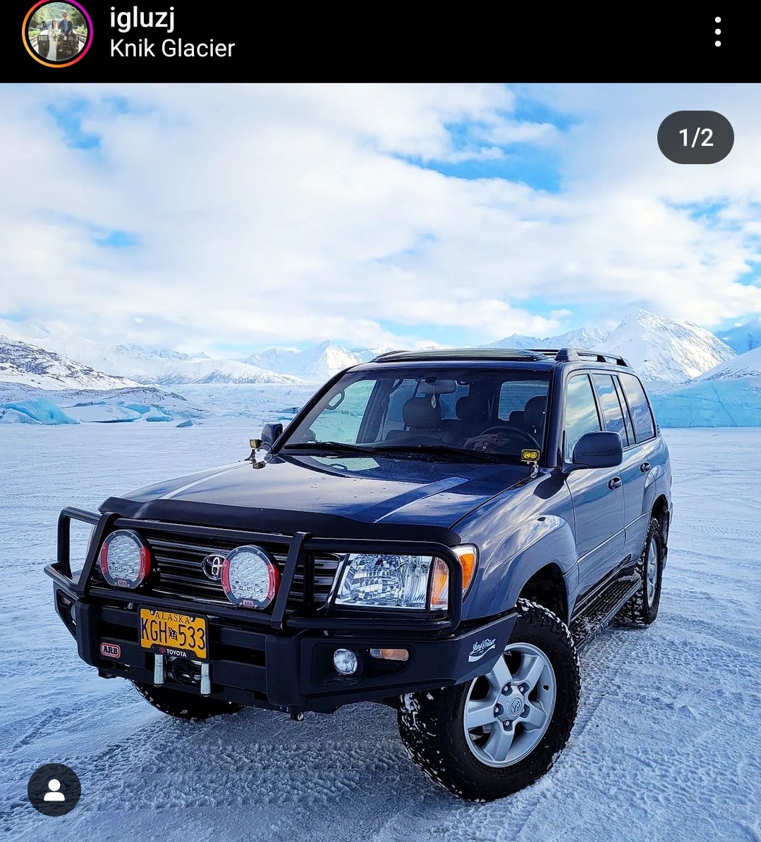

Decided I am going to go with the Ironman or ARB bumpers for my first modifications.

Well, for the front I stand corrected.....I would go with one of the 3 big aussie steel ones (Ironman, etc). The are the only ones I know of that are crash tested & meet airbag requirements (per aussie dot).
Rear, I went with a steel/alum hybrid (dissent). Warning: this is the bumper from hell w/r to assembly. Once installed correctly, works like a champ.
Reason for orig statement...weight is your enemy...very difficult to do a home build and stay under gvwr (weight rating). See post #10 by suprarx7nut. Sounds like your traveling down the offroad/overlanding road = very hard/time consuming/expensive to be < gvrwr.

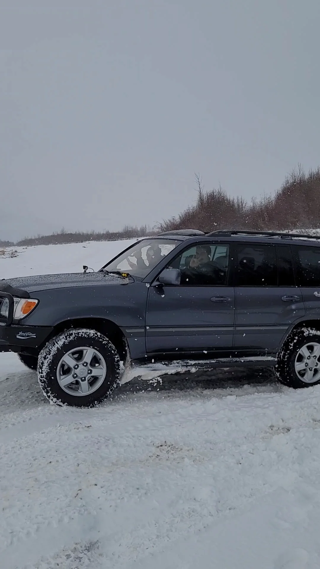

As far as tires go, agreed I'd upgrade them too. For reference, before I got 295/70R18 (34.3"), on the same 2.25" lift the PO had 275/65R18 (32") that I kept for a little bit. That size is slightly bigger than stock. Here's a few pictures / screenshots of what those looked like. Not really the best angles, but I don't have a ton of videos / pics from then.
