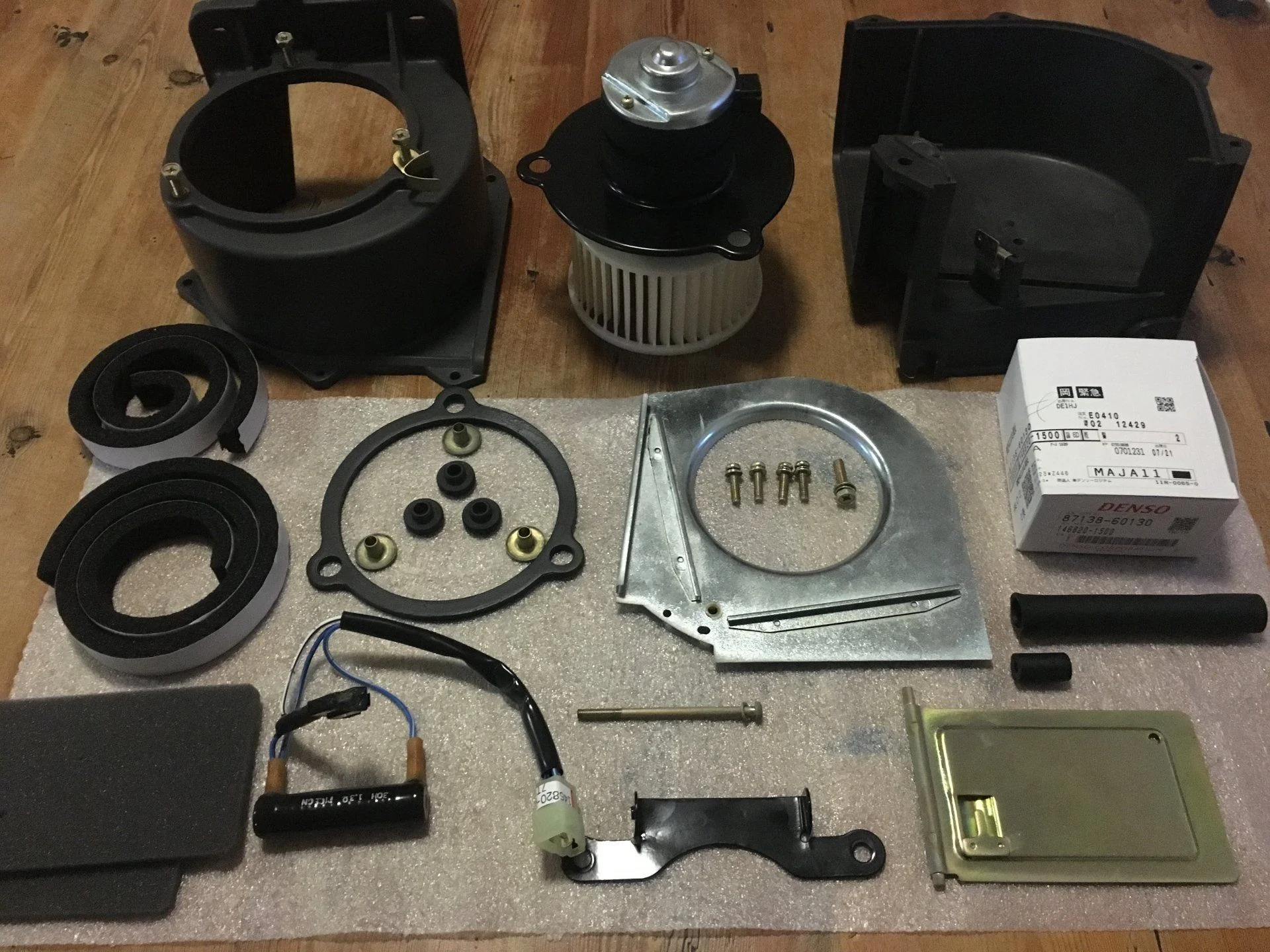

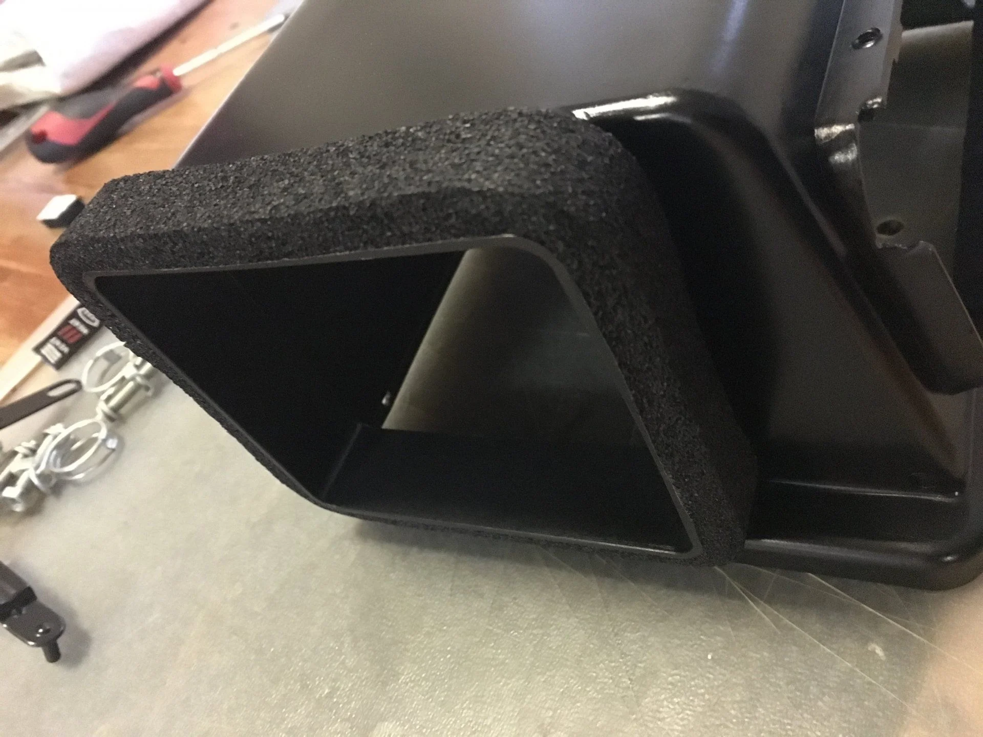

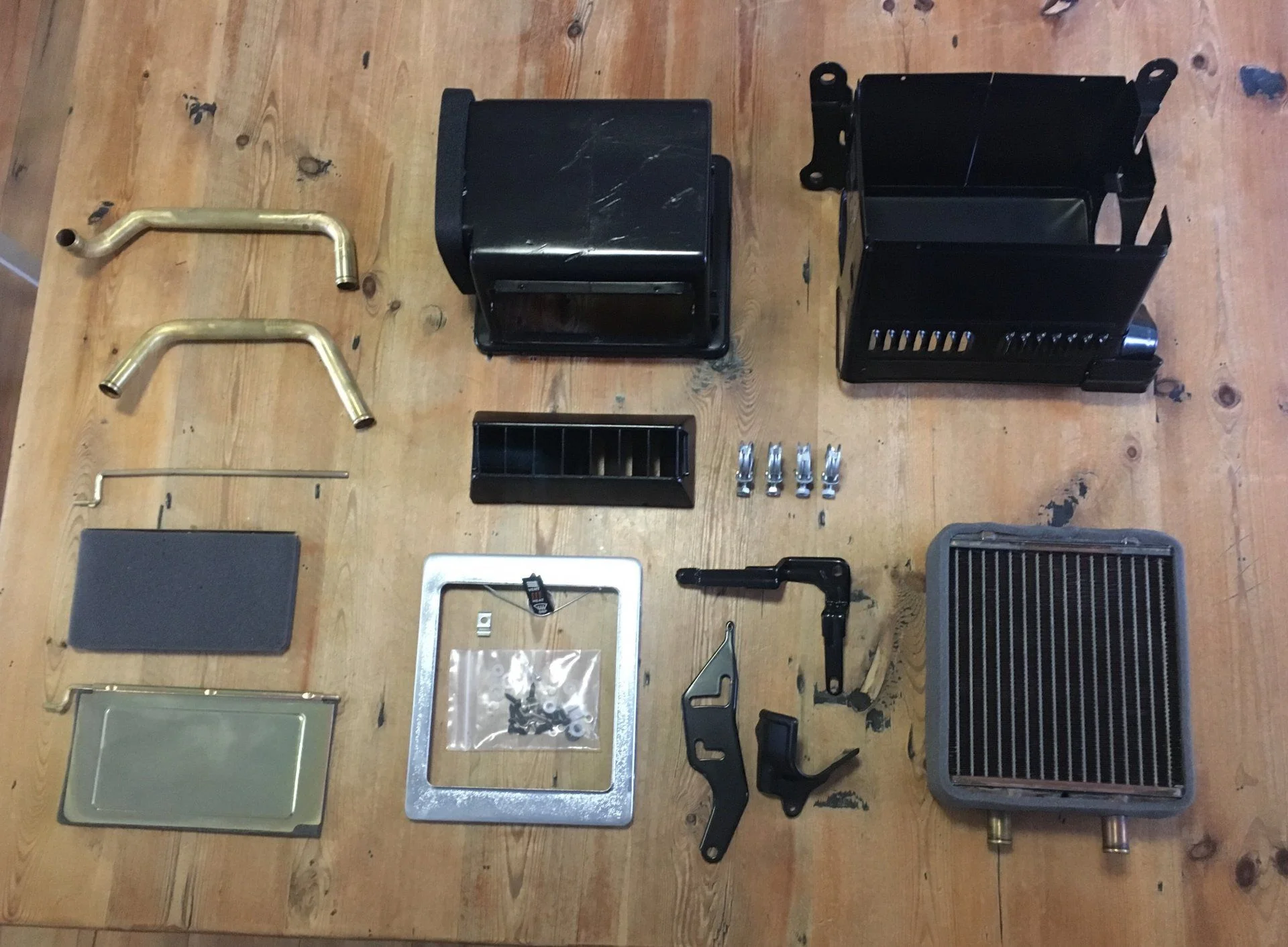

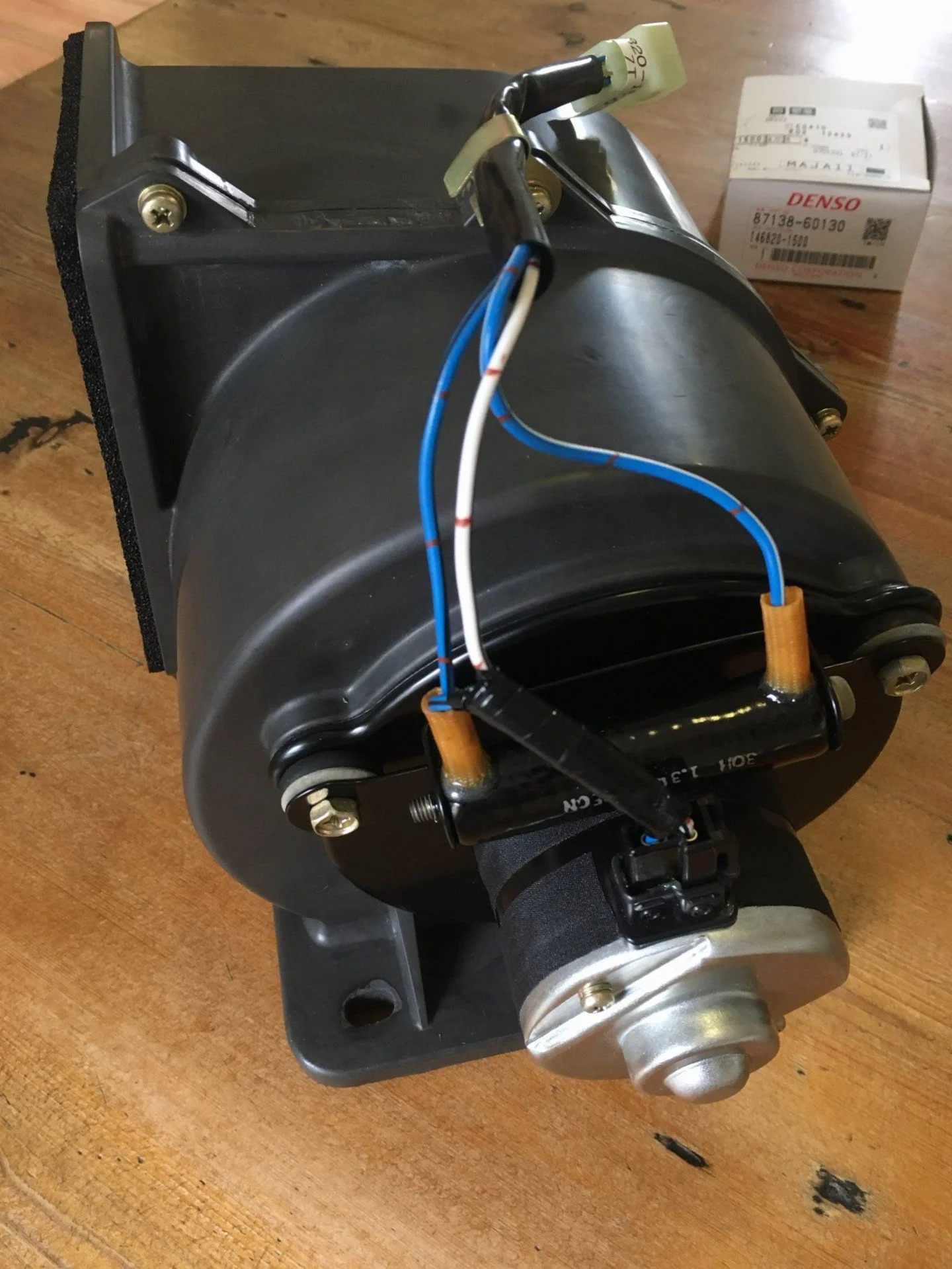

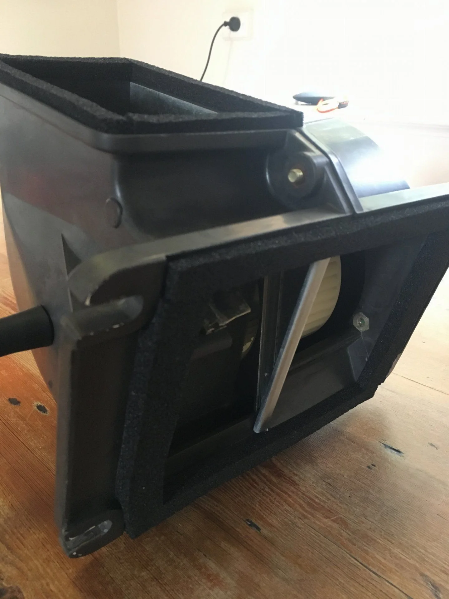

Finally ready with the heater.. I used MetricTLC foam/screws kit but ended up cleaning and using the original screws and bushes.

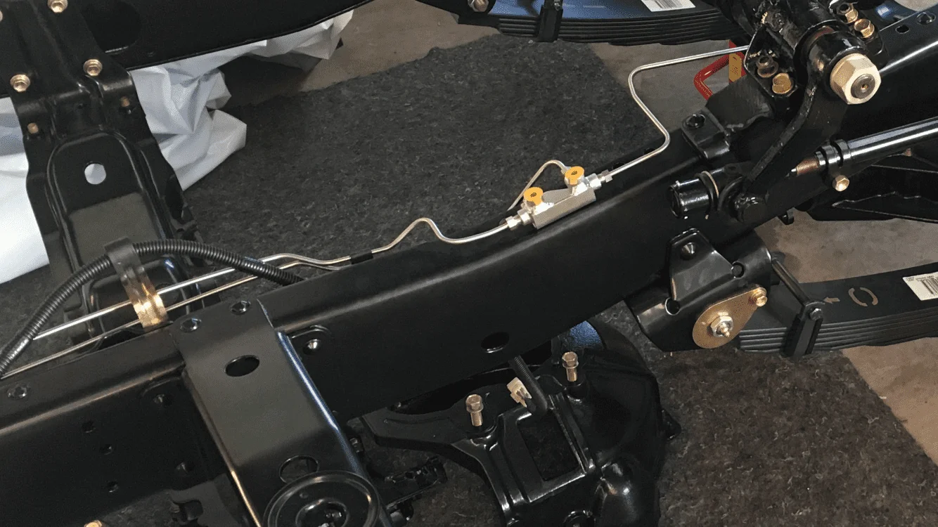

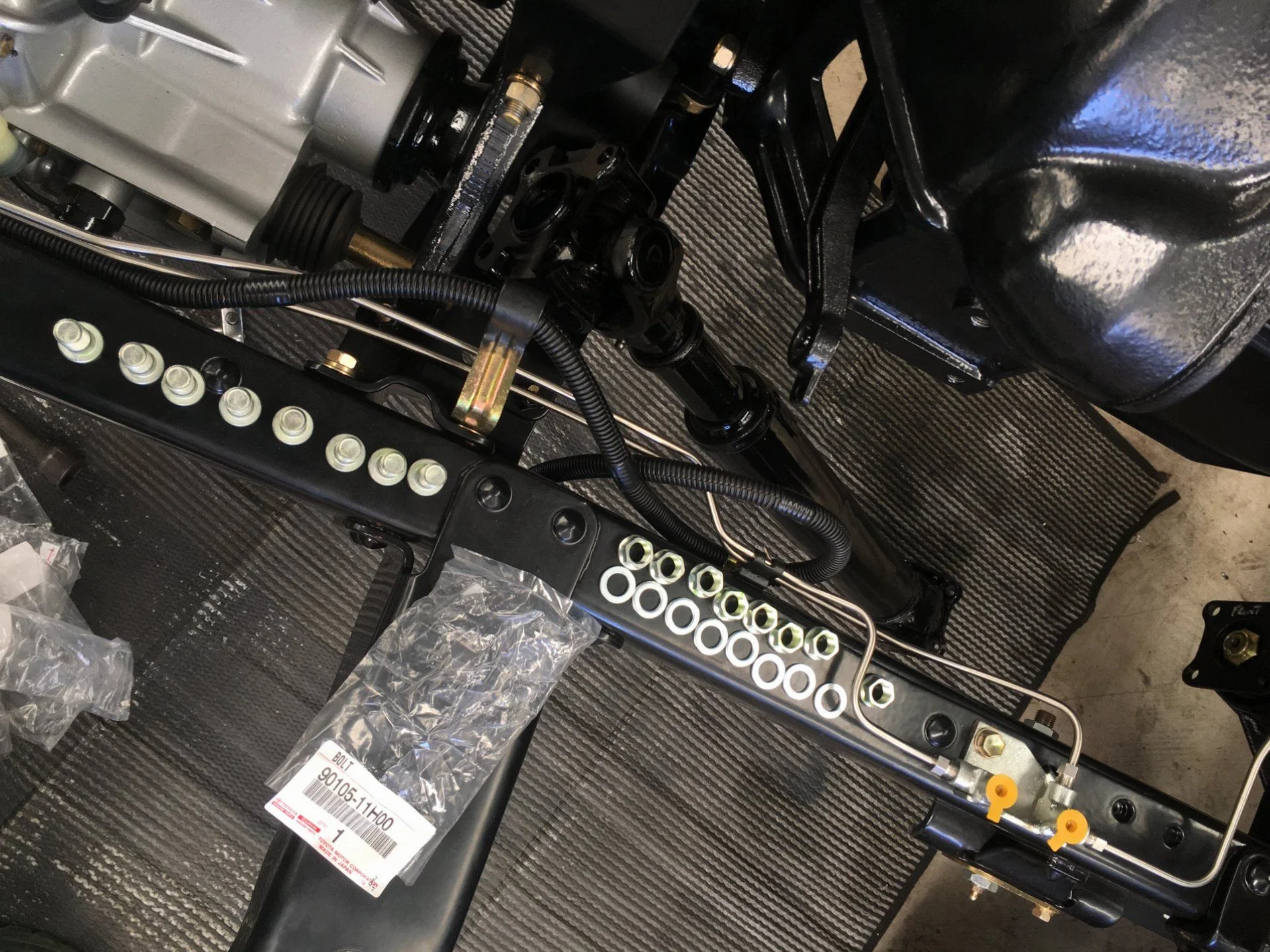

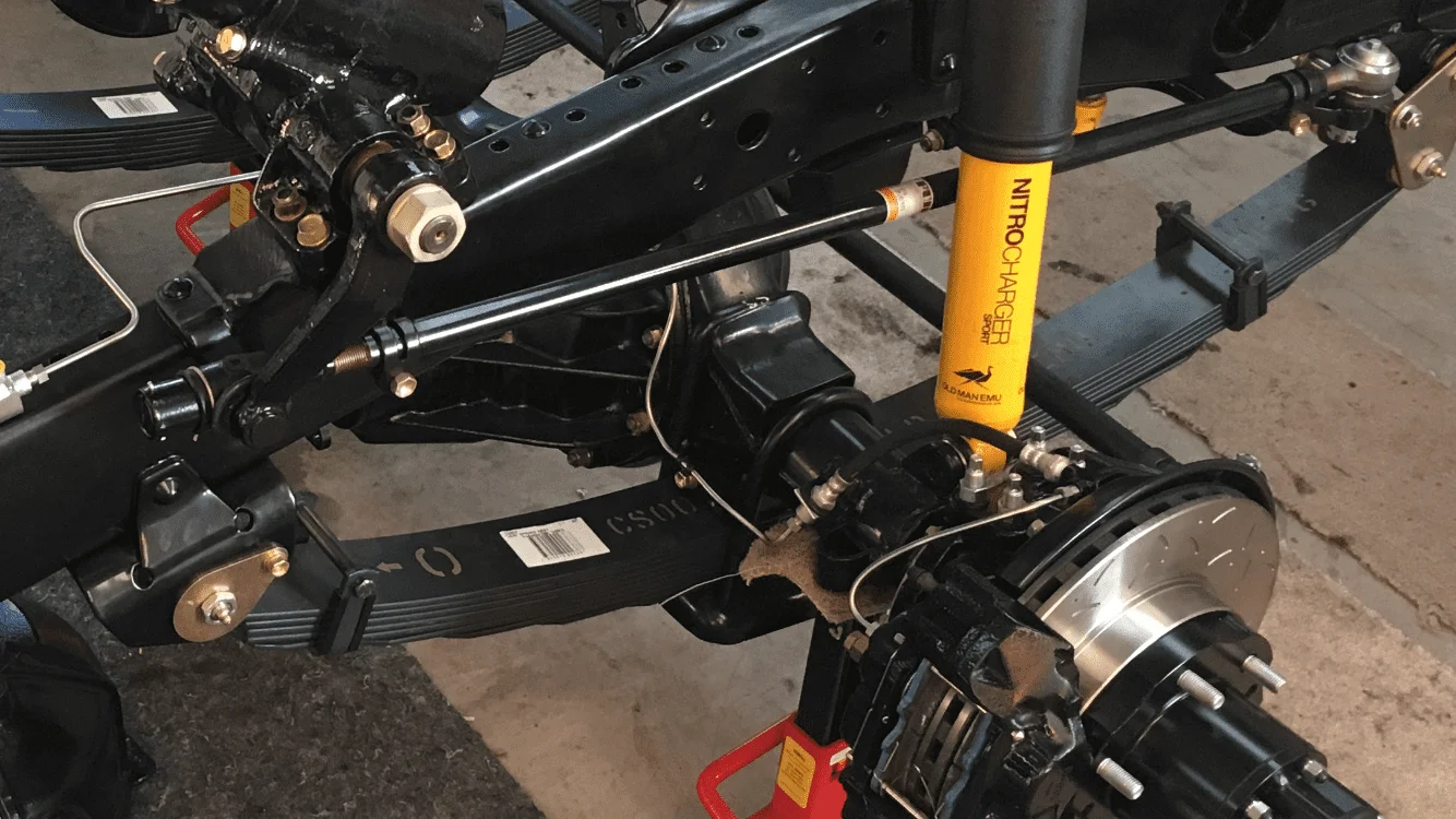

Except for the ones at rare axle all other brake lines installed. All the tubes/flare nuts got replaced to stainless. The clips rebuild were shown in one if my earlier posts. They got plastidipped etc.
The frame is now ready to receive the engine, which I'm hoping to receive next week sometimes. I'm not sure if I should install the fuel pipes now, located on the inside of the frame at RH, or when
the engine is already dropped in.
Those are not so fitling as the brake pipes and less stuff in the way is better.. what do you think?
