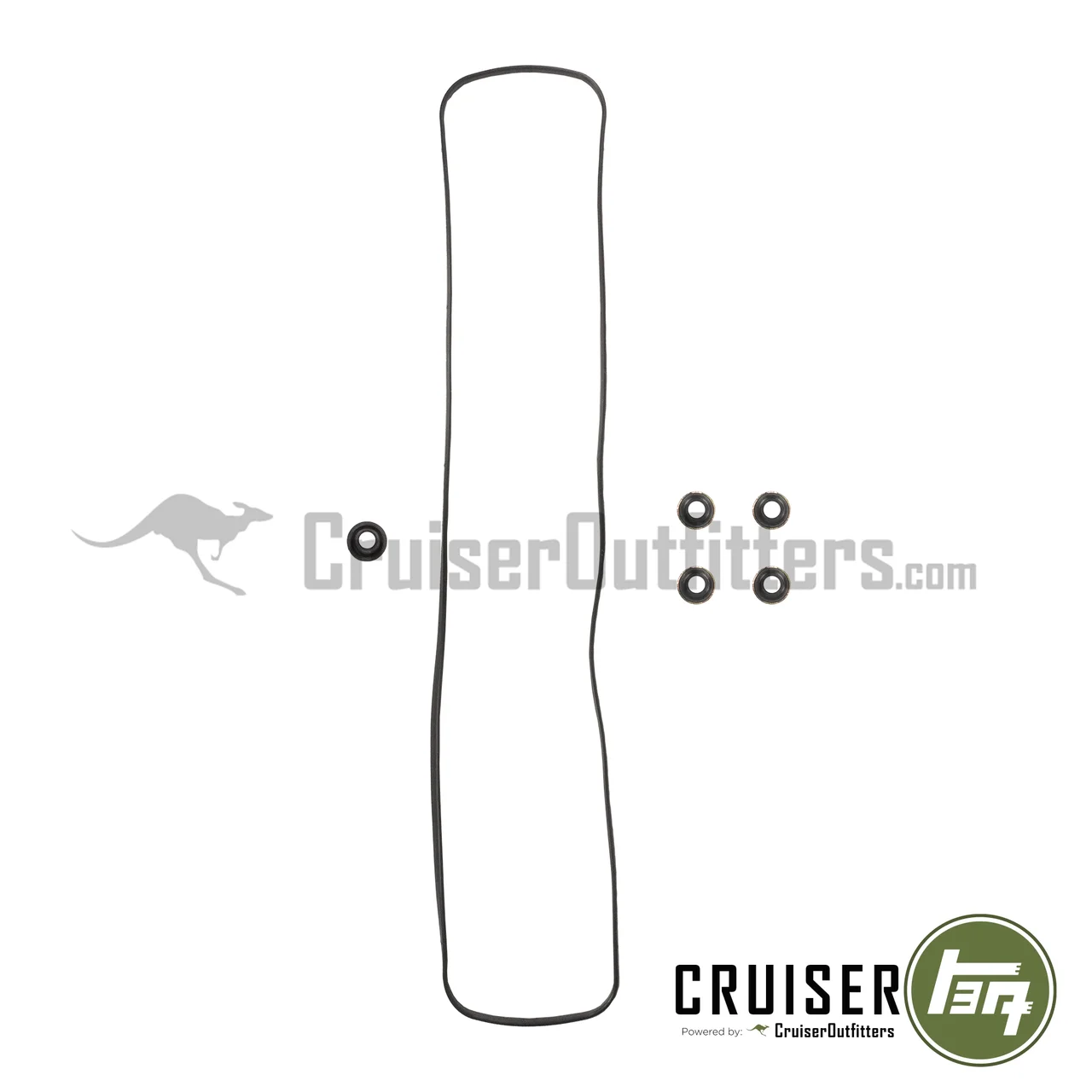

Hey yall, I have a 1982 fj45 troopy imported from Australia and the valve cover gasket is leaking, I’m gonna dive into it but wanna see if there’s any recommendations or tips before it do it!
Less than 1 🍌 job. Buy OEM gasket
Make sure the cover is flat on the bottom and the nuts surface isn't crushed. Don't overtighten it down
also get the 4 gaskets/grommets for the nuts
might as well check/adjust valves while there
Do a kit, you'll want to replace the grommets while you're in there imo
