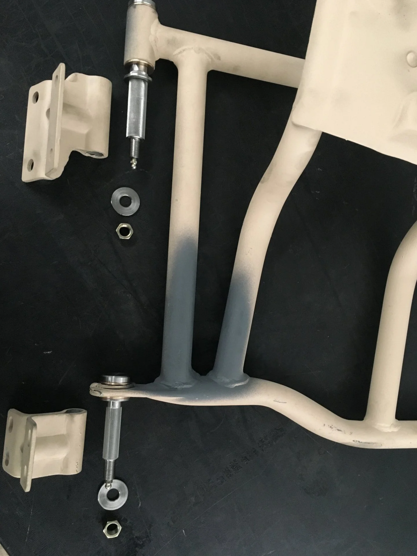

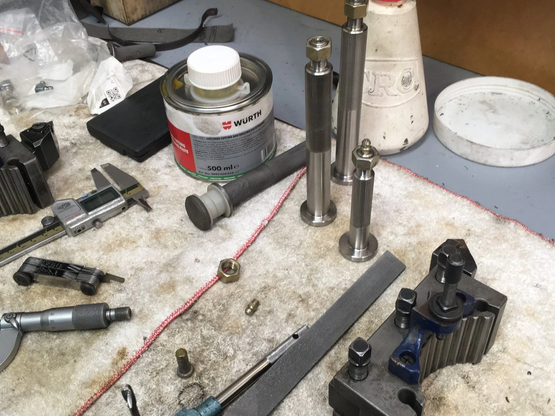

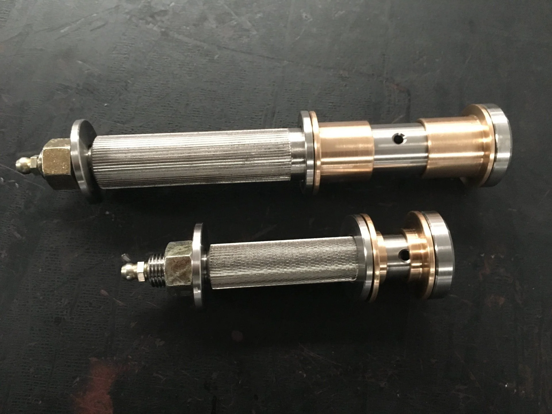

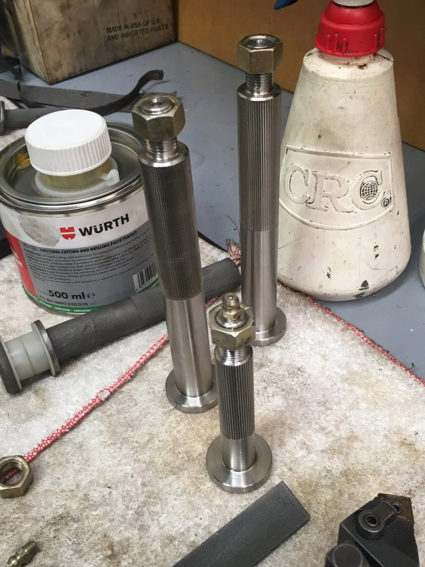

Spare wheel carrier stainless pins are getting made. The only difference between original plan is the bottom fixture. I will use a nut instead of bolt.
The gun drilled greasing and the bronze bushes are remain the same.

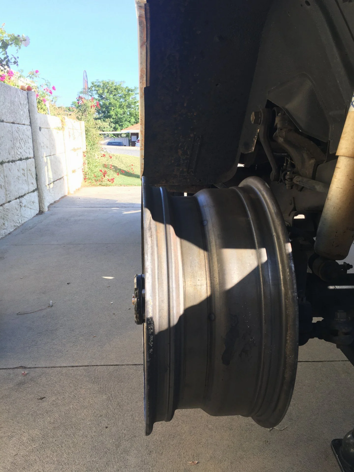

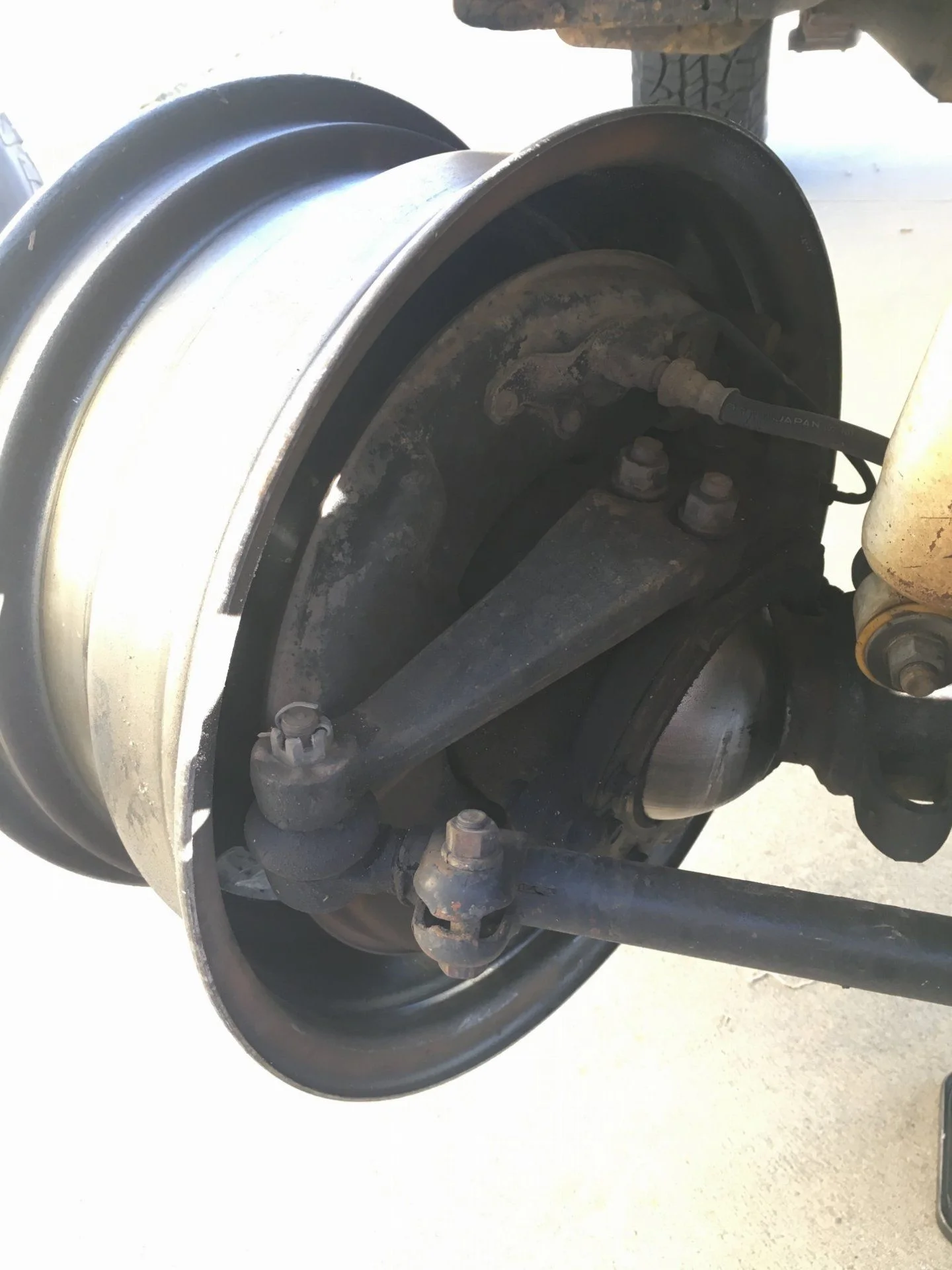

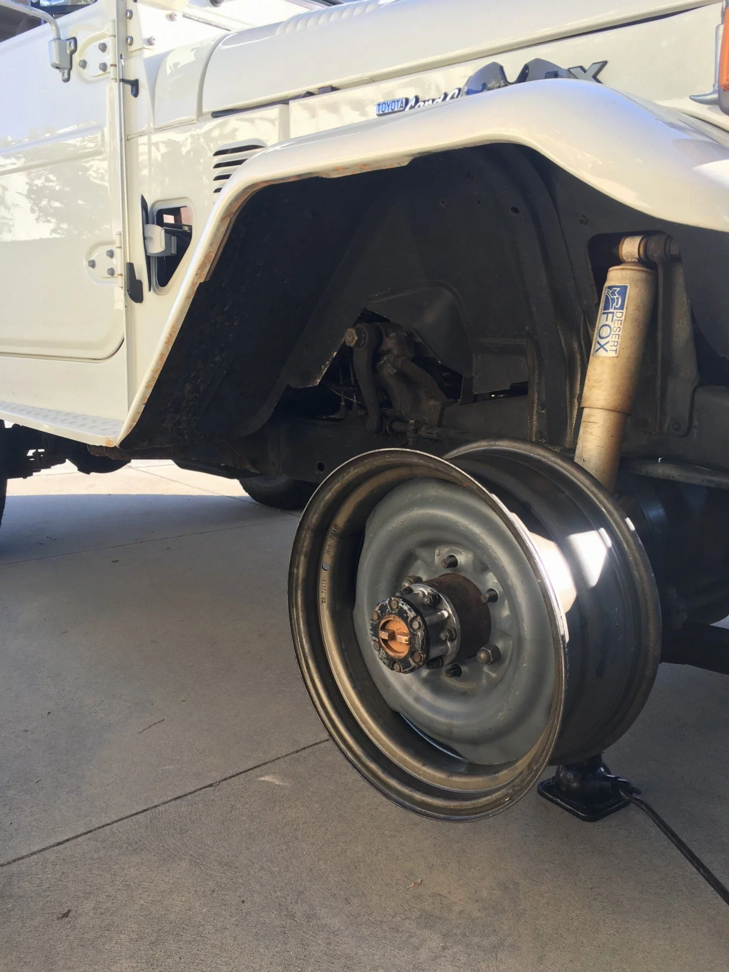

Probably I should've started a new thread for this but..This is my new project here.. I will soon produce 16x7 and 16x8 rims with correct clips and powdercoated black or grey and most of all with a SINGLE WELD!!! The 16x7 outer edge is aligned to body for street legal compliance al least in Australia. 100% factory look and hopefully within the $265 region ea. Photo shows the 16x7 prototype.
Will they have the clips for the hub caps ?
I think I wrote it that it will have correct riveted clips and choice of black or grey in sizes 16x7 or 16x8.
The 16x7 is totally street legal you could roll in the pits with them as it's edge is just within the body line and the single line weld looks 100% stock factory.
