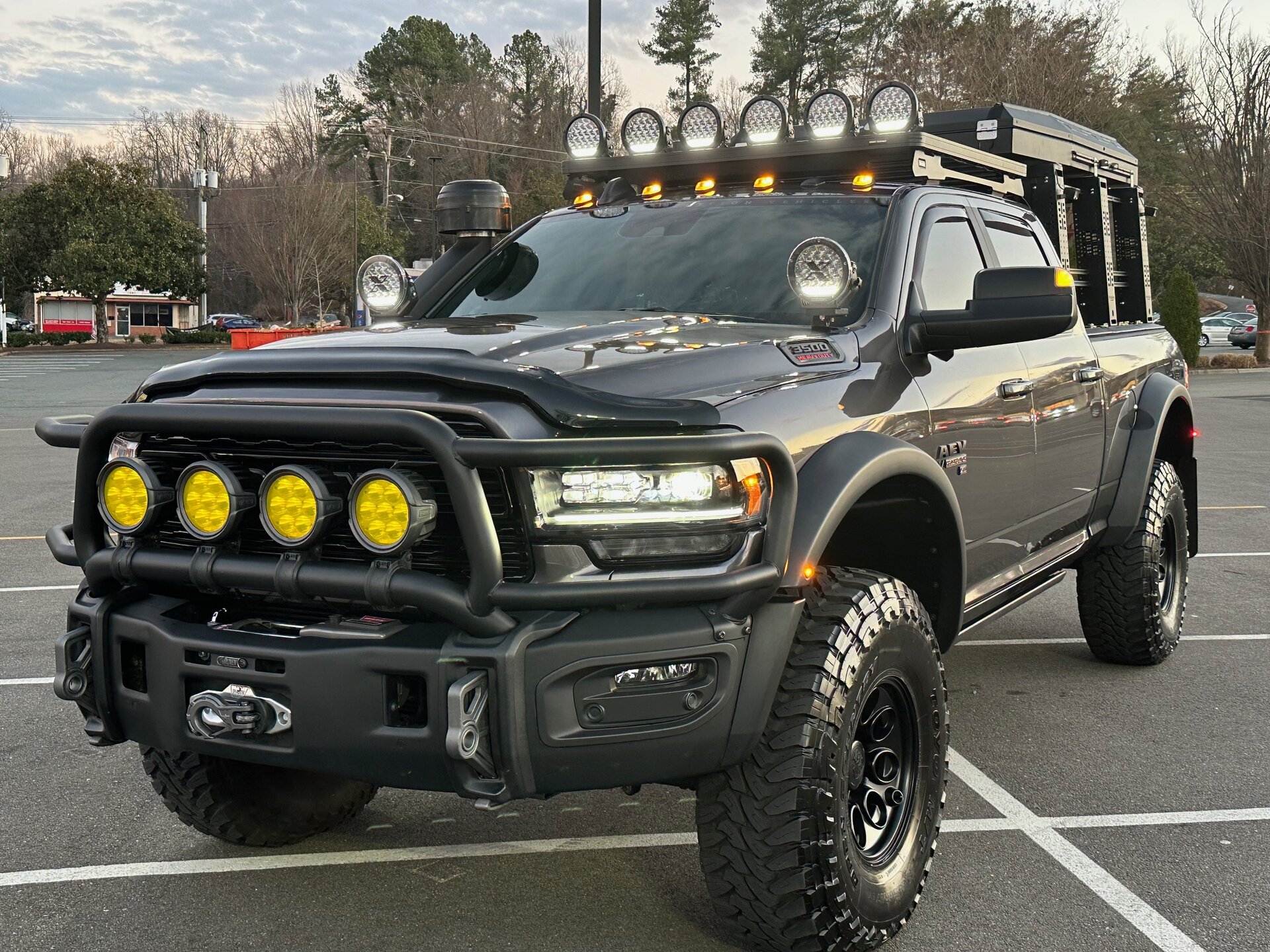

See this pic. I drive this thing from Key West to Dead Horse, AK. It's a dream machine, but without Comma Ai, it would have been very difficult. This monster drives itself on interstate and perform better than Toyota's LTA system. And I am so eager to get this to work on the GX. The creator of the 'Sunny Pilot' has recently moved to the DC area. He initially worked with me very closely to make the Comma Ai work on a Heavy Duty Truck. I believe I was the first to get this to work on the 3500 Cummins in the world. He has agreed to work on the GX, once the GX receives the EPS, and he can successfully'talk' to it via the can bus. Anyhoo, here is the truck. Imagine this monstrosity driving itself better the Tesla on a freeway across the country:smokin: For a frequent cross-country (continent) drivers like myself, AutoPilot is a god-send.

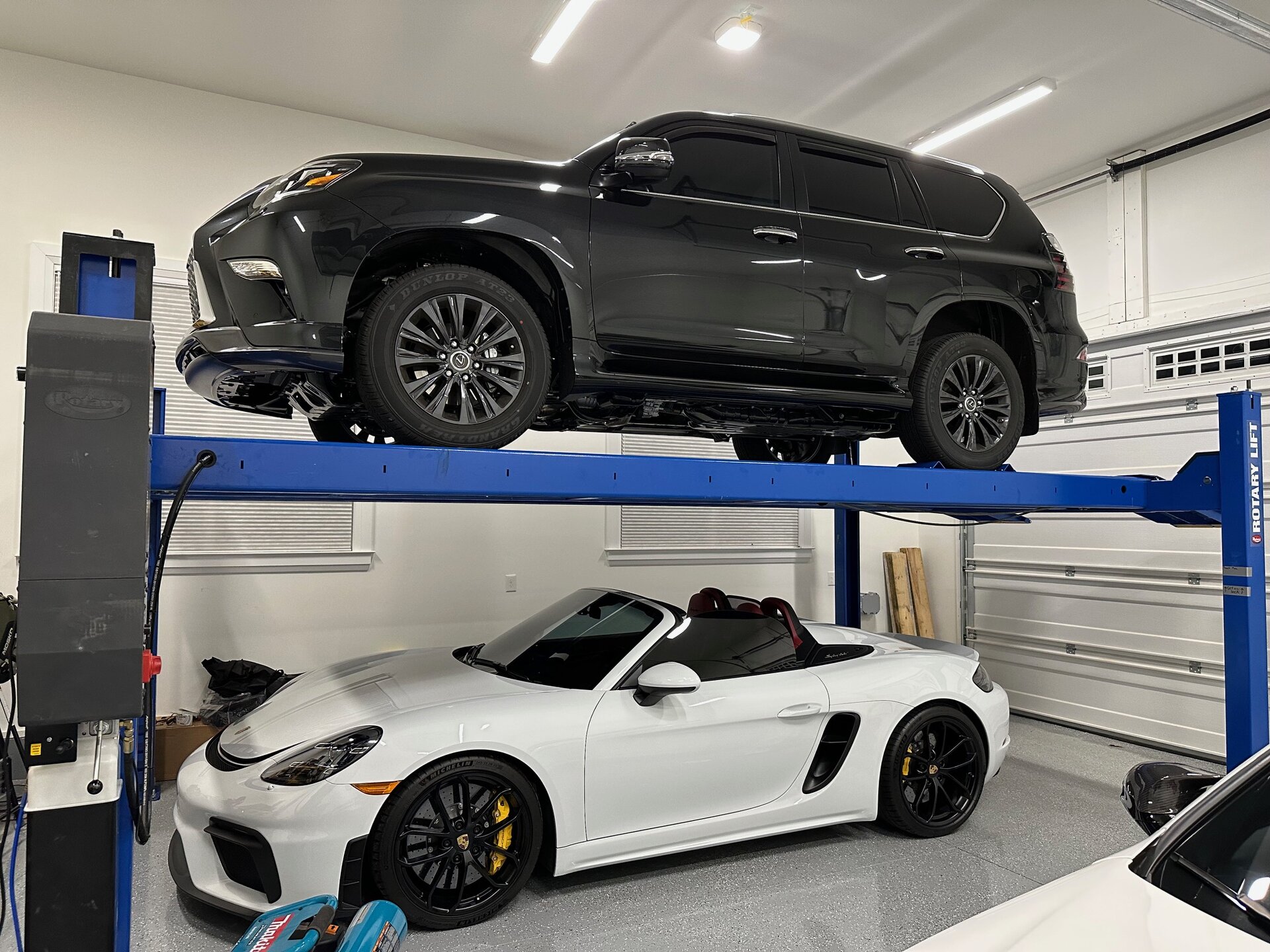

Here are couple of shots of my fully loaded GX (now fully PPFd and ceramic coated). Sitting at home looking pretty :p
Gave the dealers 'do not wash' do not touch anything order when I took delivery. Took it straight to the wrapper and had it fully protected. This will be my forever mid-sized off-roader forever. I have a Type S MDX as a grocery - getter, but this GX is very very special to me.
I have too many cars & motocyles. Just ordered my second parking lift for the detachd garage. It's a disease....
