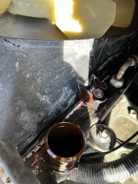

Some people have reported that though the leak seemed to be at the upper rad hose connection, it was actually a leak coming from the endcap to core interface. The rads seem to fail here a significant amount of the time.
Sorry, but just so I'm understanding, do you mean the top of the radiator? Like, the upper top/cap half? I know only the most technical terms and have to constantly ask folks to stoop to my level :D
But, I did thoroughly check the area(s) from which I presumed the leak to be dripping. The radiator coolant filler cap was checked, also the molded connection from where the coolant filler cap is manufactured onto the top of the radiator was checked for pinholes/cracks. No pinholes nor cracks but when the engine is up to temp, I see a consistent drip line coming from where the upper rad hose connects to the radiator.

Yes, coolant is red. The rad core has end caps (plastic) which run vertically the entire height of the core. at each end (left and right sides) They are attached to the core and can leak there.
Okay I'll check those end caps in-between rain storms this week/weekend.
Snapped some photos of the leak! And replaced the rad hose and circle clamps with new. Still seeing a very minimal drip/leak coming from the same area but it's lessened up quite a bit verses before.

Personally, if at all possible, I'd avoid putting anything in your cooling system to stop a leak. If it's from the radiator, replace the radiator. It's not too expensive and you're probably due at 145k miles anyways.
If you have any plans to keep your 460 please do not use stop leak.
Do you have unexplained coolant loss?
I would be replacing that radiator.
My recent Motive brake bleed after full brake job tightened things up.
No signs of it leaking anywhere except where previously mentioned in this thread.
Okay, now I'm looking at either Koyorad or Spectra Premium on RockAuto.
No "Stop Leak!" That's just a temp fix at best which causes additional problems down the road. Is Denso the OEM radiator? I can't recall for sure, but if so, that brand is good
