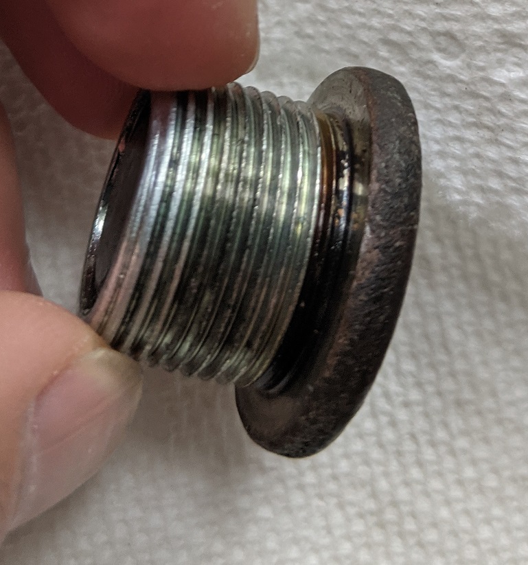

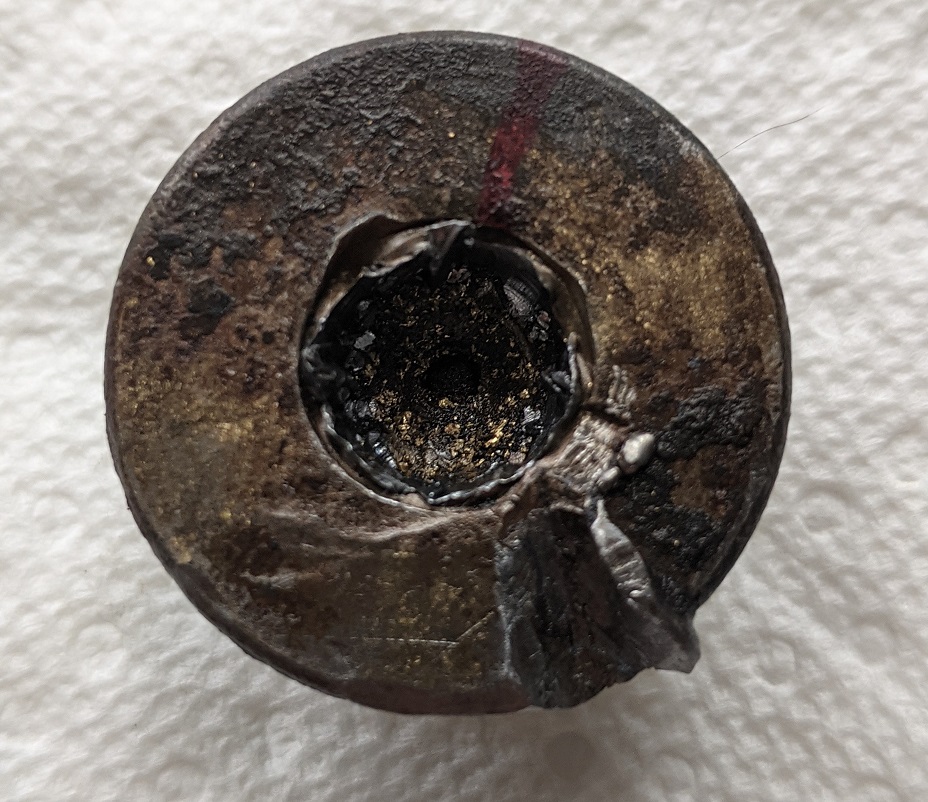

Well it's out. None of my efforts worked, including a lot of heat, chiseling, hammering, Torx bit (probably would be a good technique in general but the socket was already too big). Great mechanic down the road got it out with no welding--I asked how but he kept it a secret heh...
Looks like the last thread near the lip has some kind of corrosion so I think that may have played a role here. Replaced with a brand new plug (same style) and torqued to spec. Nice tight fit with the 10mm hex. Was just happy to see clean oil and nothing scary on the magnet. Thanks for all the help, everyone!

after reading this whole thread multiple times and watching all the videos, not sure why I was surprised that my drain plug wouldn’t budge after pb on my ‘09 LX570, and ended up getting stripped after using a 10mm allen and a dead low hammer…. Then tried even more pb blaster and a torx bit, still not budging.
I have the external nut plug Lexus PN # 90341-24016 ordered and arriving at Lexus tomorrow for pickup.
I’m nervous to attempt chiseling, so was gonna go down the “just weld a nut on” route, which I’ve never done before.
