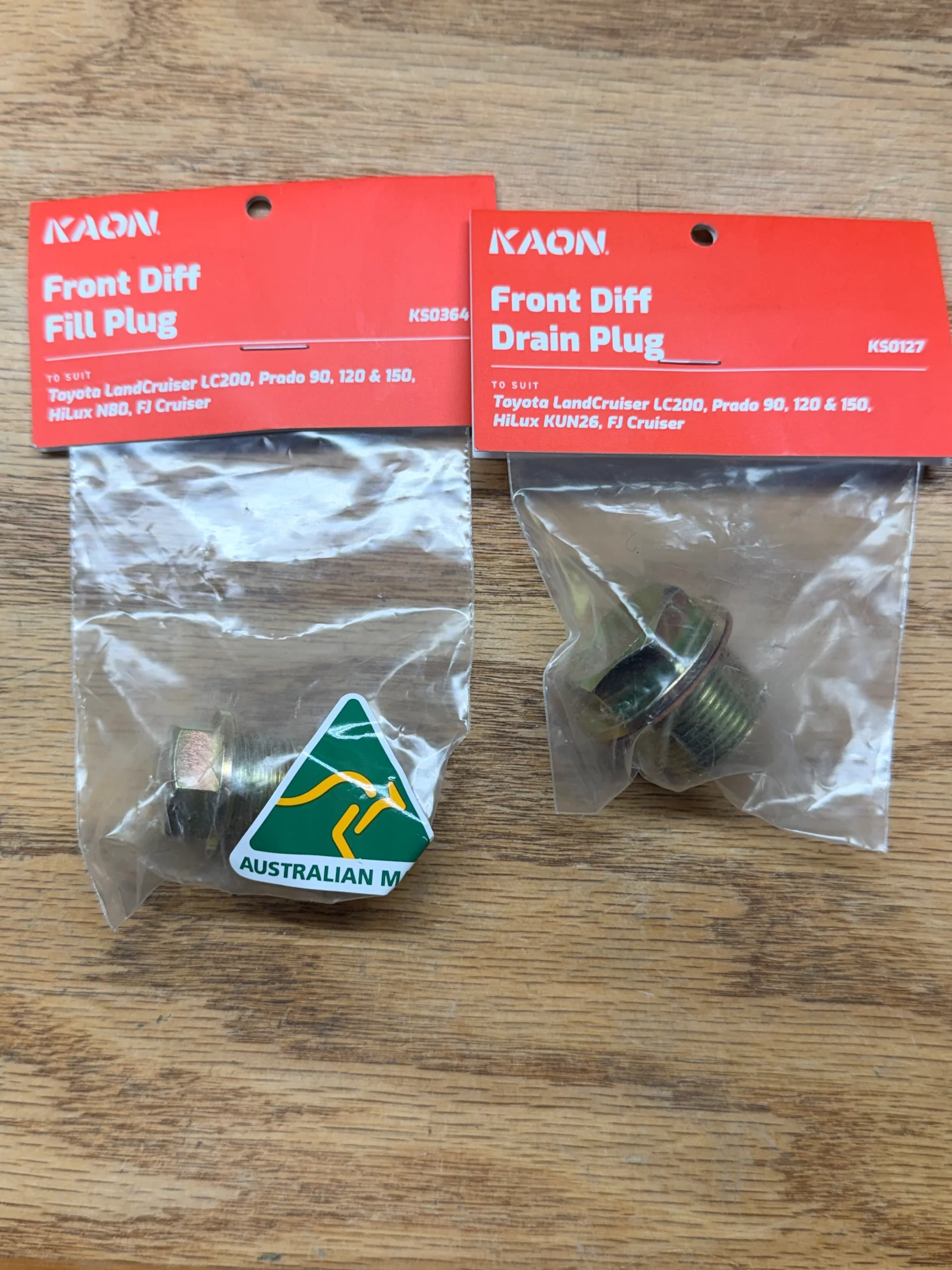

I can’t recommend these enough. I’d have a set for your next diff maintenance.
I wanted these! BUT I needed it fast since I dont want to leave the welded bolt on there and I want that fluid changed. I am hoping the amazon one is decent enough quality for 30-40k miles. Will definitely plan to get this next.
I wanted these! BUT I needed it fast since I dont want to leave the welded bolt on there and I want that fluid changed. I am hoping the amazon one is decent enough quality for 30-40k miles. Will definitely plan to get this next..
IMHO and FWIW I'd dump the Amazon sourced plug even if it meant sacrificing 1/2 a quart during change.
Yea I went and picked up a oem drain plug. its the 10mm hex but ill just repeat this process in 30-40k miles lol and make sure I order the Kaon
