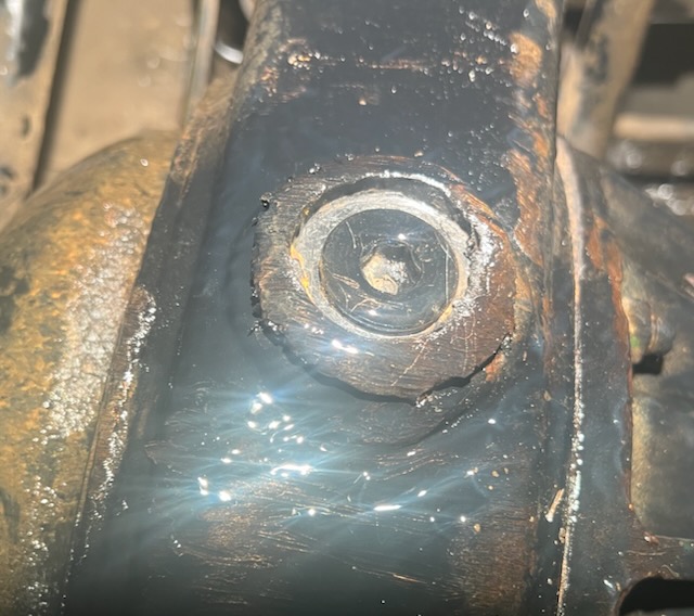

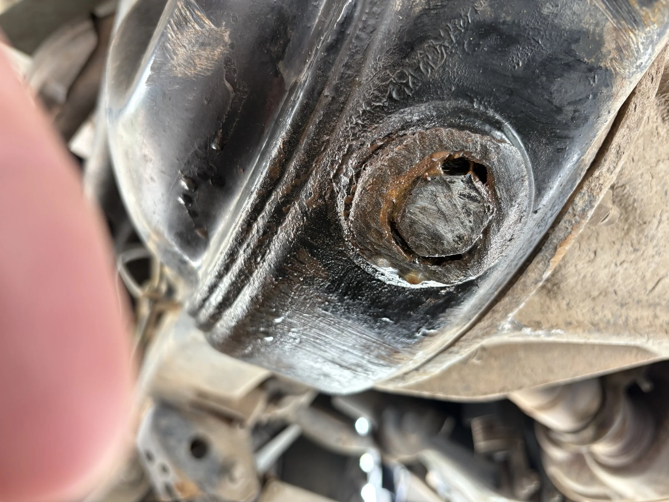

So I did this at Cruise Moab:
It’s weeping gear oil a bit but there is no way to get a socket on it. I think I’ll be able to dremel or somehow grind out material so I can get a socket on it. Is there a best practice for this? Also at some point the protective ring that is part of the diff body will need to be repaired. Is that just having some weld bead put on it then grinding to make it look pretty?
My first action would be to "die grind until a 24mm (I believe) socket fits". If that works, I'm not sure what, if anything, I would do about the protective ring. Might just paint it and live with it. You could weld a short pipe section to it, or build up weld and grind, but that's a ton of heat to put on the diff. I'd be concerned about burning the oil inside.
4” grinder with cutoff wheel to parallel all the flats. Large flat blade or small pry bar to open gaps. Proceed as normal.
Then either the weld build up (and fill your cuts) or pipe extension trick could work. Also, perhaps worth switching to Allen head plug at same time.

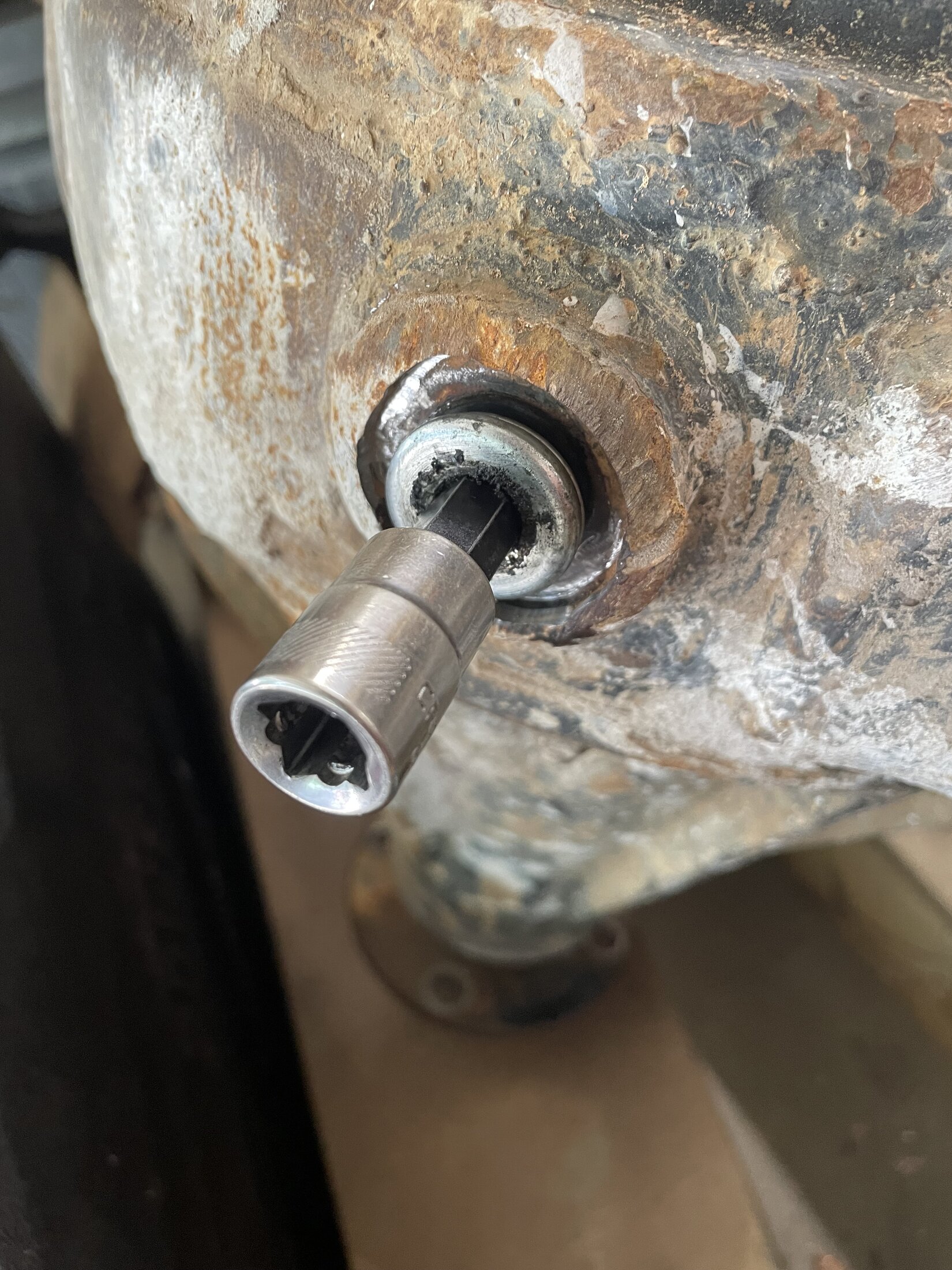

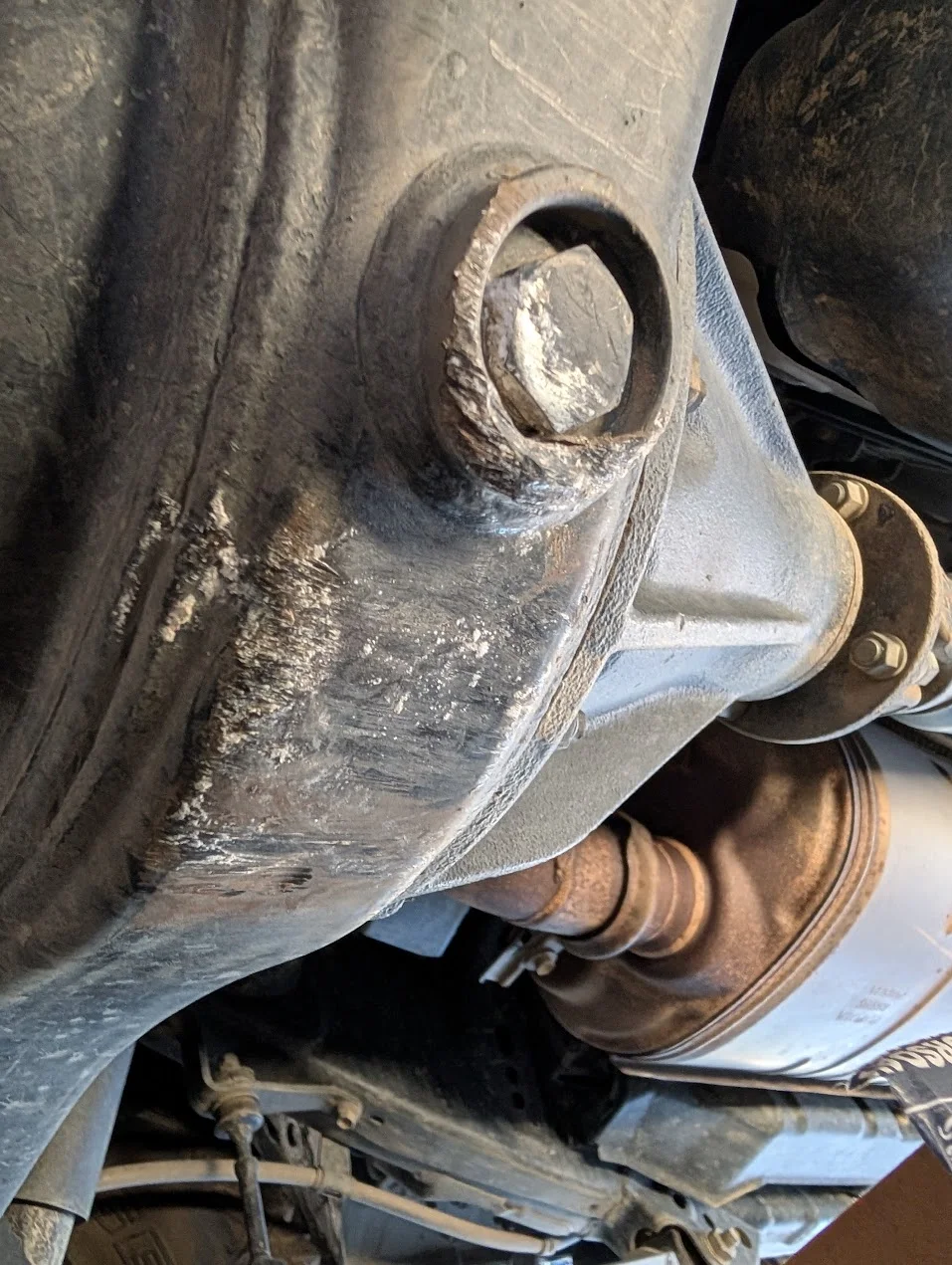

FWIW - Scuffed up mine below and had to pry around but glad I upgraded the drain plug to hex version. (Think I sourced front and rears from Kaon). Threads on here re: that and Lexus version.
The shiny fluid in pic is Corrosion Free undercoating. Maybe it lubed up the rock slide some minimizing drag. lol

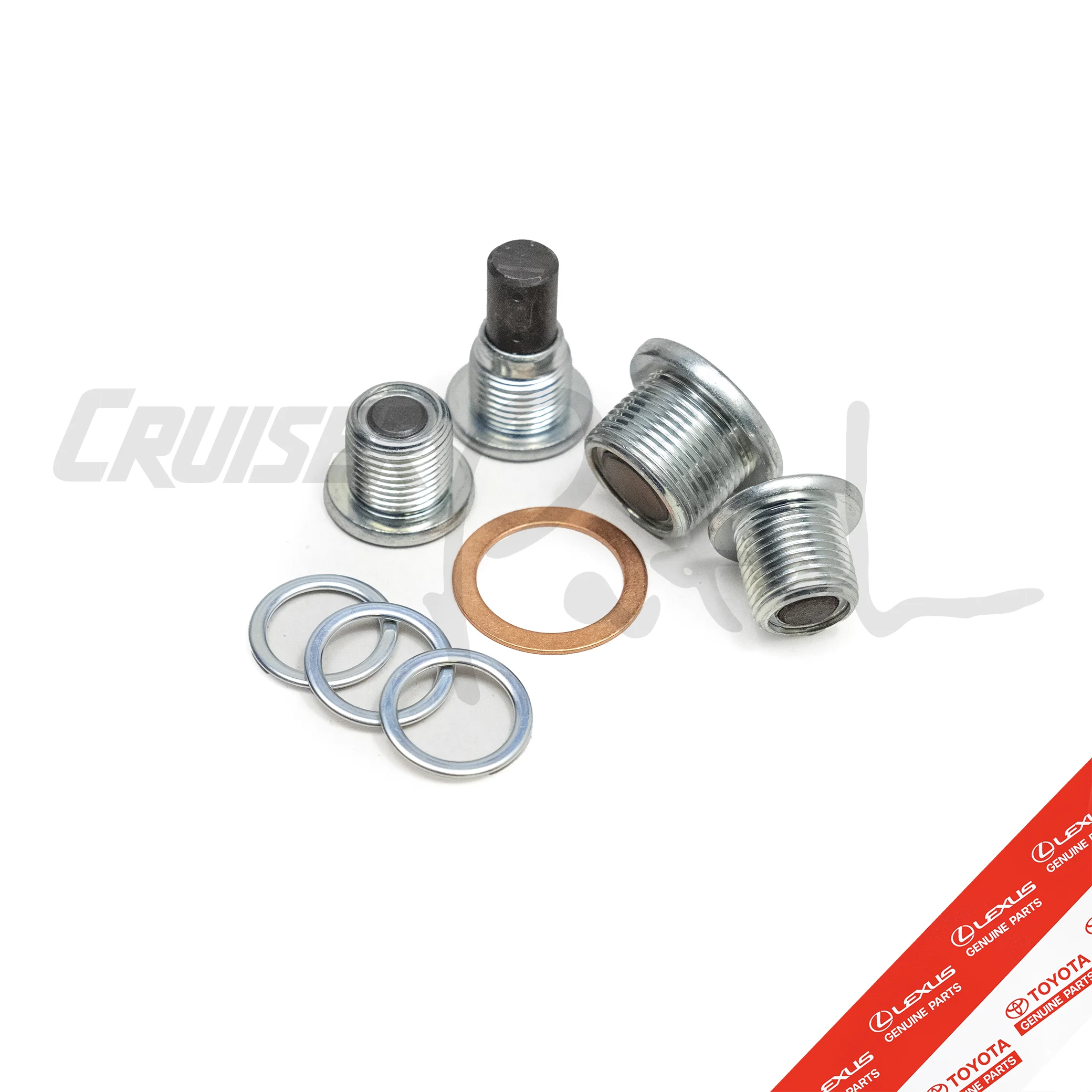

I developed these kits for these exact purposes:
OEM Toyota 10mm 'low profile' magnetic diff drain plug kits
Above: 200/300 series diff plug kit
Diff drain ring protector (replacement ring- bare mild steel)
above: diff drain protector ring (weld-on: common in Australia)

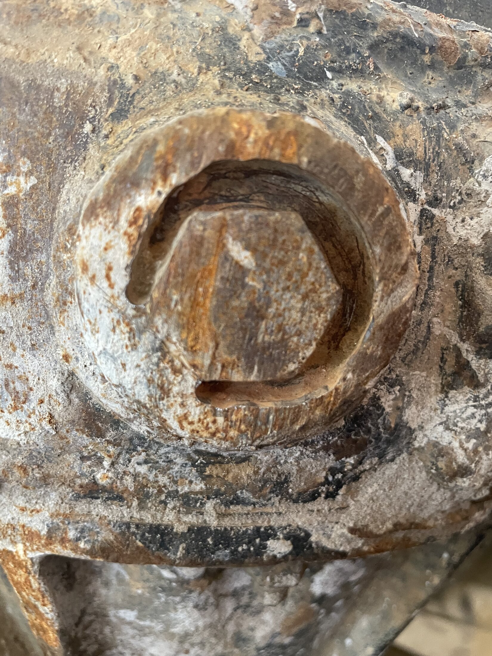

I used a dremel tool with a metal-cutting bit to shave out the mangled shards around the old plug.
I then installed the low-profile 10mm allen plug. Eventually it too began to take hits from rocks as I shaved off the protective ring again and again...

Dremel did the trick. I was able to get enough of a socket on it to retorque the plug. I’ve ordered the 10mm hex plug from Cruiser Patch. I’ll clean up the protection ring a little once when I install the new plug and can get the truck on my lift.

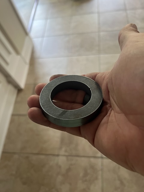

Got my ring today. The box felt heavier than expected. It's solid. Now need to figure out the who and how to best weld the ring on the diff.

I usually wind up grinding it a little bit on the lowest edge of the ring to maximize clearance…it’s cut with tight tolerances so a lot of the weld splatter might have to be ground off the housing as well (definitely requires some fab work but easier than welding one of those unnecessarily large diff butt protectors on)

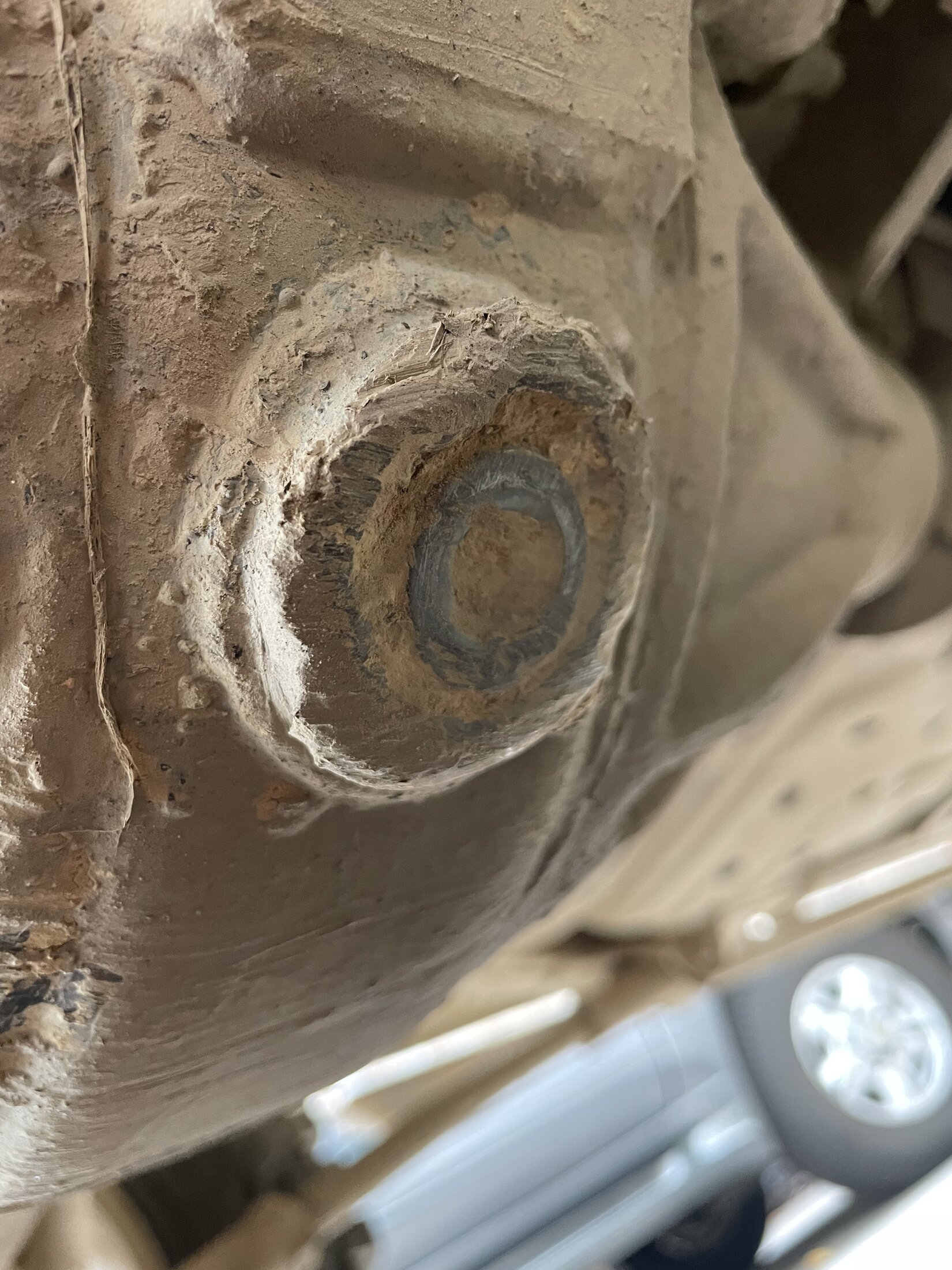

I installed my new drain plug with the 10mm hex today. I noticed that the new drain plug (90341-18035) is 35mm in length vs. the original 24mm hex (90341-18040) head plug length of 30mm. The low profile 10mm hex one has a longer magnet. @cruiserpatch I assume the longer plug is OK as far as clearances go inside the diff. I rotated the wheels while still on the lift and all seems OK but I want to make sure I really have the correct plug for my 2015 200.
Edit: The new 10mm hex key fill plug is also a bit longer that the original plug. 20mm vs. 17mm.

The longer plugs collect more shavings and have cleared every diff in which I’ve installed them so far-
If you do ever run into issues with internal clearance reach out directly and I’ll get you taken care of 🍻

What about some set screws in the protection ring and no welding?
Maybe. Or maybe JBWeld.
The ID of the new ring is just slightly smaller than the OD of ORM ring. Or at least mine won’t slip over because it’s mangled. To install I’ll just gring down the OEM ring until the new one slips over it. I’d want to fill in some of what ground down which got me thinking of JB Weld.
