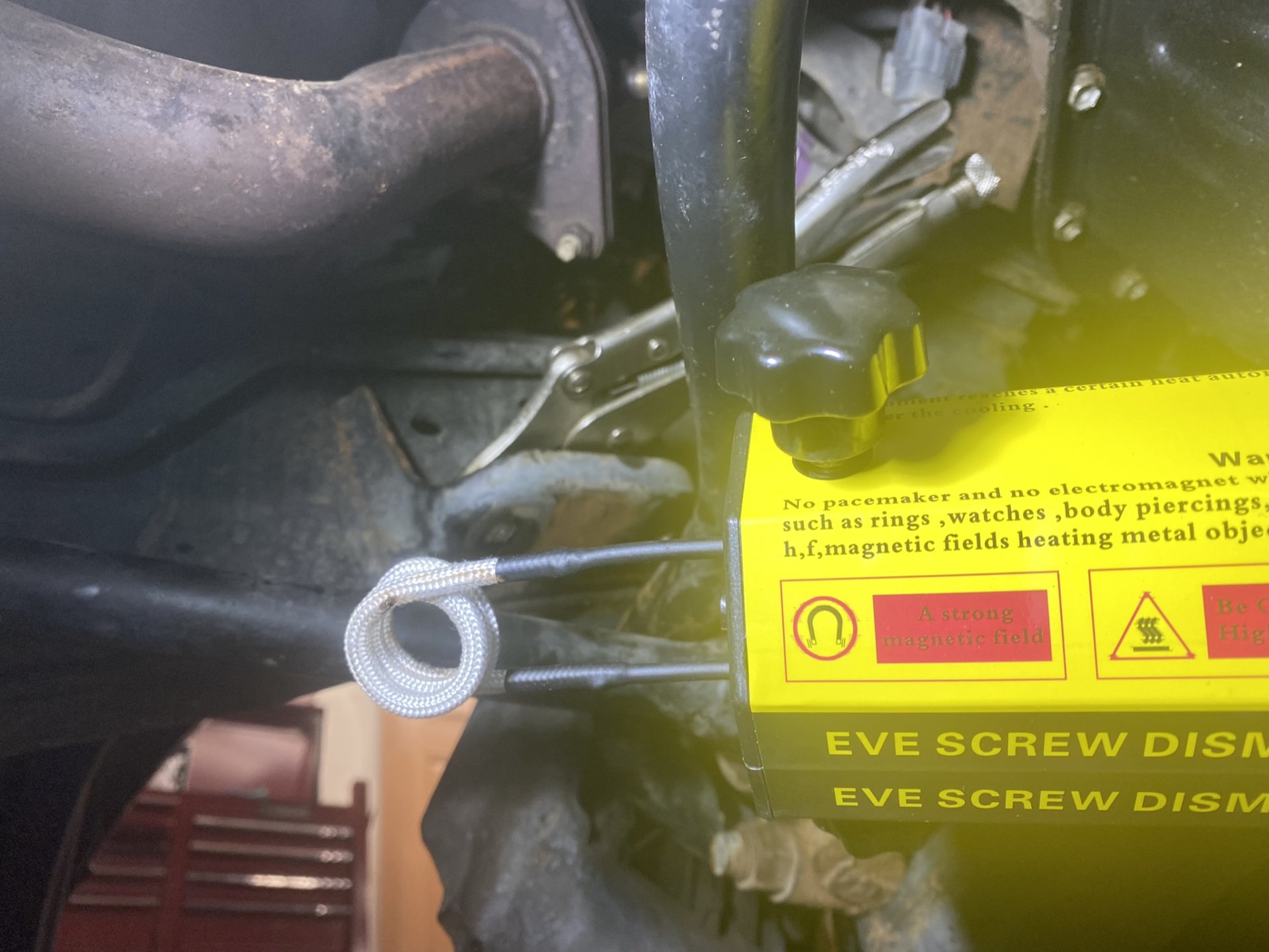

I've not used induction coil heater on this drain plug, yet!

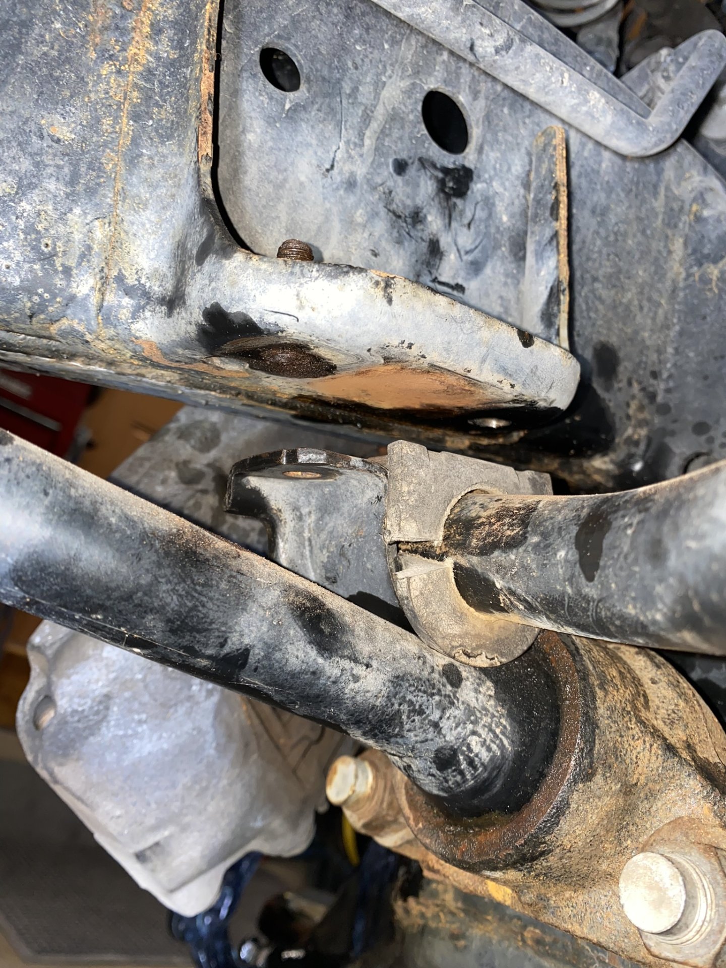

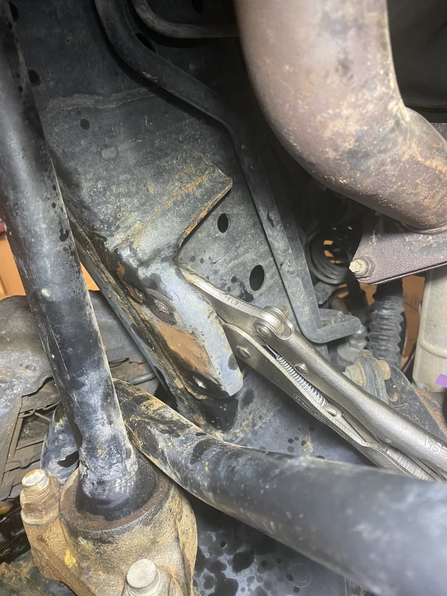

But did just have opportunity to try on a 100 series busted stabilizer bracket bolt. I first tried without use of heat, no movement. Then after just 5 seconds of heat, bolt turned easily.
I haven't used one, but have heard they are miracles when working on rusty stuff. Pricey now, but you know eventually Harbor Freight will have one for $20.
Wellll, put me on the list for a $20 model. Even if it only works once it's priceless.
I have owned the Mini Ductor Venom for the last 5 years and it is an amazing induction tool that saved my bacon many times while working on my own vehicles (including 3 rusty plow trucks) as well as my friends vehicles. A must have for rust belt area repairs, but I think it would be useful in any enthusiast's garage period.
I have this one and it's currently on sale on Flea-bay if you go to check out at $496.09
I do like the look of the "pistol" handle configuration of the Venom. Seem it would be easier to get into tight spots..
So what would you say is benefit to buying the Venom or other higher price coils vs low cost units?
My low price units, does get target hotter than recommended if I want it to. As they recommended only a few second of heating time, and to not get target red hot. But I've held on longer, and they do get target glowing red hot very fast.
