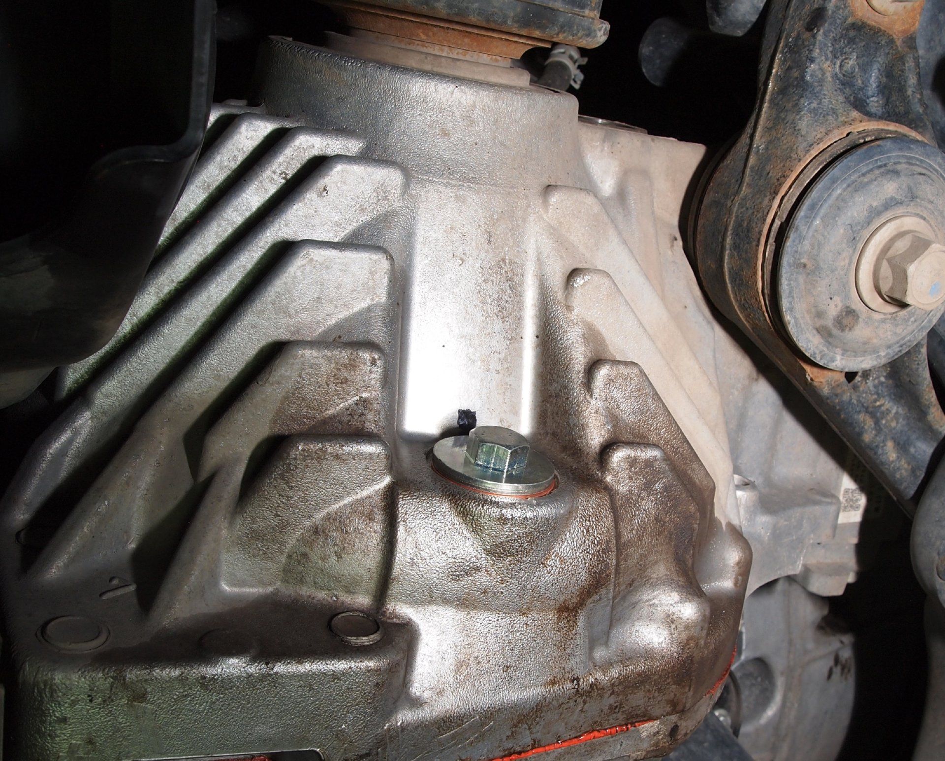

Anyone know of a source for a magnetic drain plug with nut head in the 18 to 22mm range?
This head looks smaller (reported as 14mm) on this alternate Lexus plug than I'd like. I'd really like something closer to 24mm like the rear diff & transfer.
I'm a little concerned this 14mm nut head to could round off and be no better than the low profile we have. I suppose that fact neither Toyota nor Lexus parts departments have on hand, is a good indicator they're work better. Could that be they're application is in other than an aluminum case?

Lexus parts guy mentioned the guys in the shop are removing with chesil. I asked if they replacing with this 90341-24016 with 14mm nut. He said the more experienced techs are.
The substitute drain plug is a little weight than the beefier factory plug, except where in counts. The bore of the differential depth is 18mm which neither are long enough to reach. So i've no concern the substitute is a stubby 11.38mm vs 15.90mm of factory plug. The thinner 3.24mm washer gives us less material for the chesisel to bit into than the 4.2mm, but hopefully this will not be and issue on next service.
