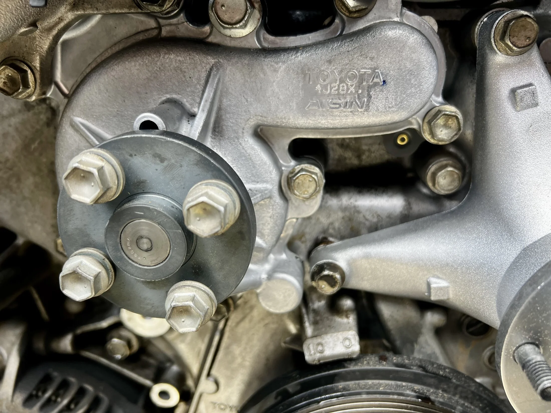

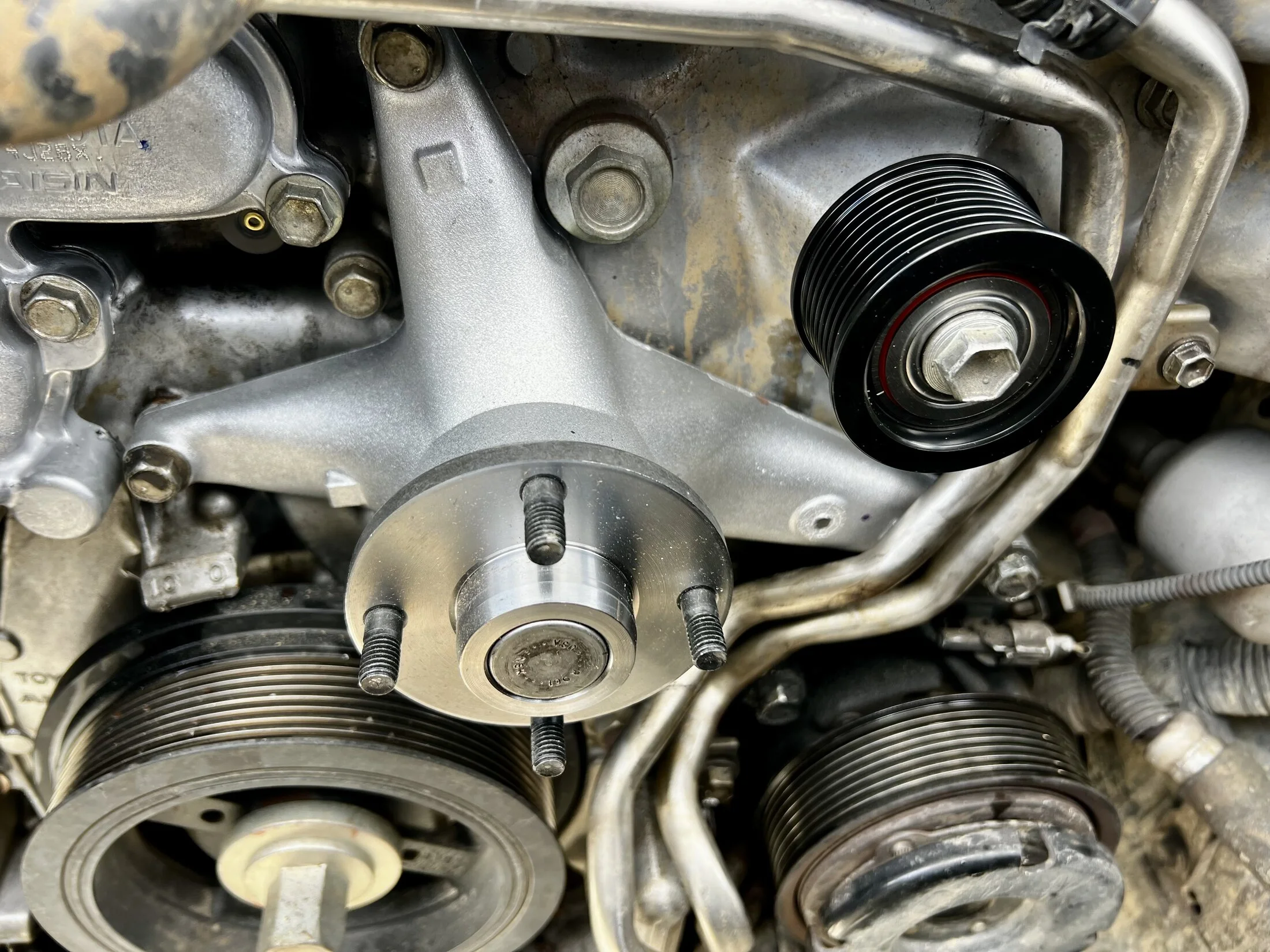

About To Replace Everythanggg On Front of Motor. Any tips or tricks?

How many miles on the old hardware? What was condition of idler, tensioner, and especially fan bearing bracket?

Calm down sir, still at it, full report coming 😜

When I was fussing with the hard line on the drivers side, right near the AC compressor. I noticed There’s a decent amount of crud build up in that area. Not wet persay, but something oily is seaping over there. Haven’t started to investigate what yet, and no leaks in driveway at all, but something is amiss there.
Most likely the timing chain cover leaning near the top drivers side where it seals against the block. Many of us have this.. pretty sure that is @linuxgod issue. Mine doesn’t hit the ground if I degrease it every oil change. It was mildly present when I got the rig 100k+ ago, and has gotten worse, but not a lot.

Did you find anything wrong with your PS pump? I replaced mine but there seemed to be nothing wrong with it. You can get rebuild kits for them too if you wanted to take the time. Since I had already bought the new one, I put it in and now have a spare that I'll likely never use.
There was some noise in the bearing when off the truck and spun freely. Minor, but it was there. Put 2 side by side, and the new one was definitely tighter and smoother, but nothing extreme.
My steering was loud before replacing the pump. Now it is silent, and smoother and firmer. The fluid likely played part of this as well, as i didnt bother flushing it since i knew i was taking it all apart, and i honestly have no idea how it old was or when it was last changed/flushed
