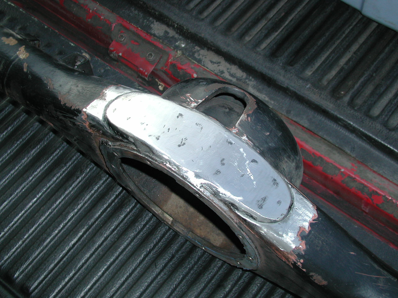

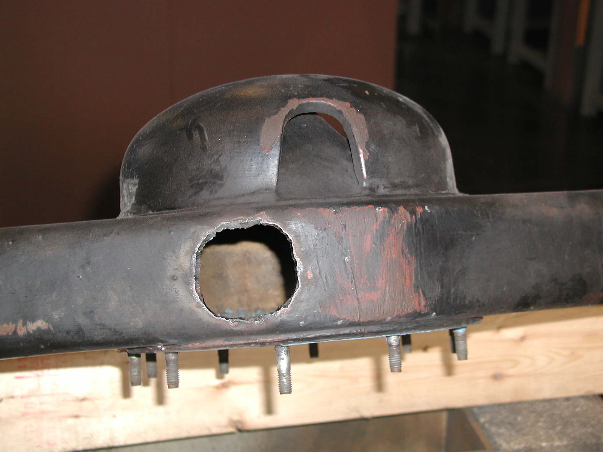

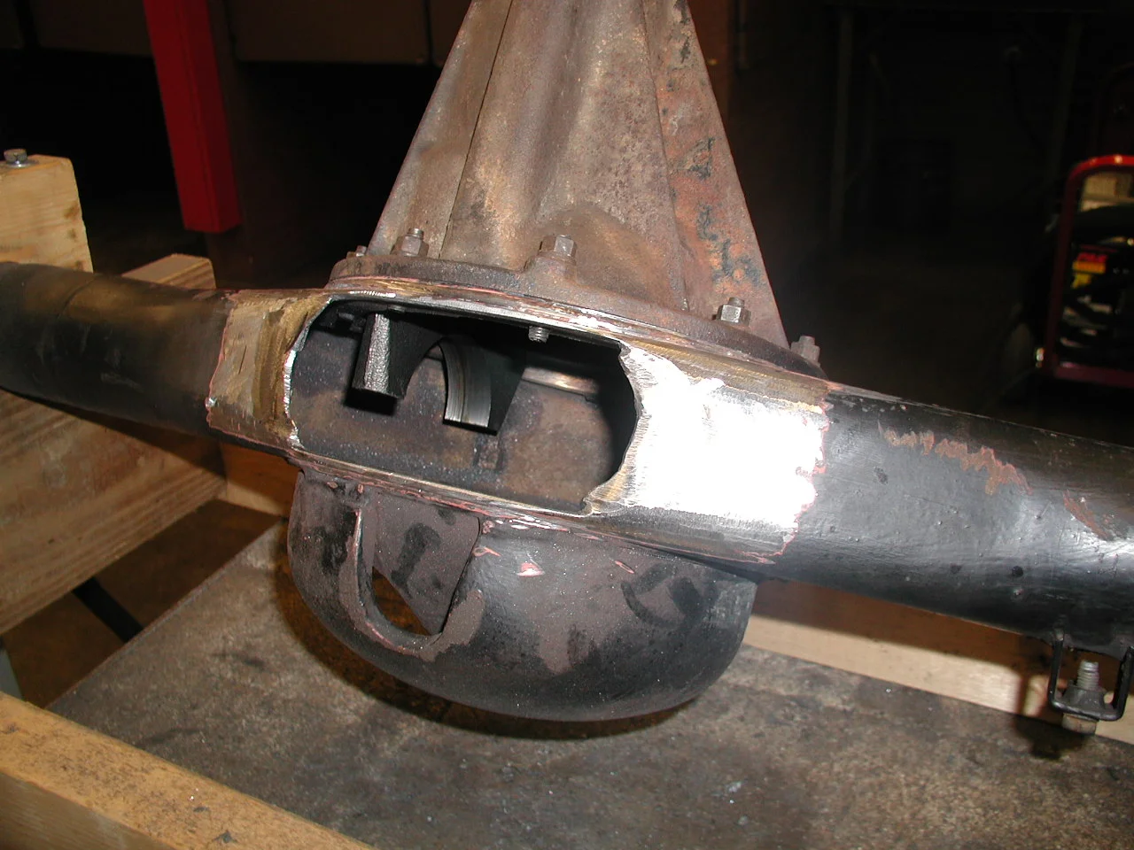

This is the best way to fix this. Radical, but you'll never have to worry about bunging up the drain plug again.
Remove the axle housing from the truck. Plasma out the drain plug entirely.
Mount an empty diff housing to the axle. Plasma out the rest of the bottom of the axle.
Weld a plate over the opening. Test for leaks with brake clean. Paint and re-install.
Use the bottom diff studs to drain the axle in the future.
(did both axles in my mini in 2003)

This was on my '87 Xtra cab pickup that I was gradually building up as a crawler in the early 2000's. I eventually did a frame-off on it, this truck lives somewhere in southern AZ now.
