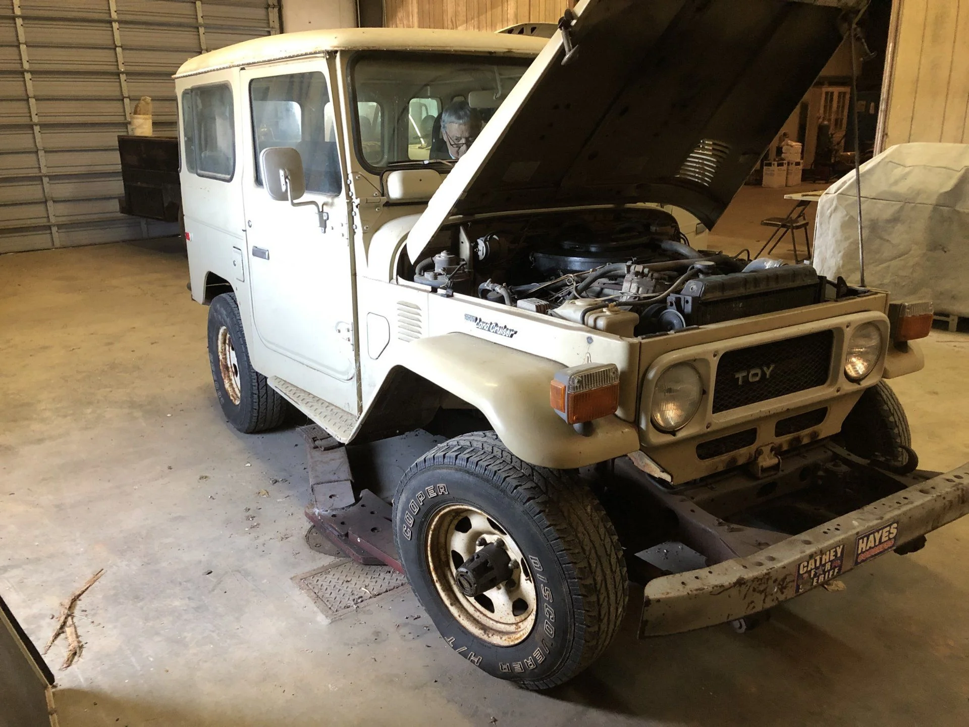

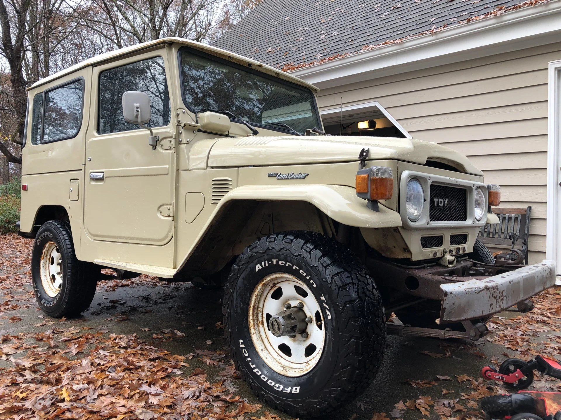

Question for those in the know: Are the late 40's pretty good on the road with the 3.70 gears and factory sized tires, or do they benefit from 33" rubber overdrive like the earlier ones? The reason I ask is this...See this picture?
Notice how the PS front tire is an almost flat 20-y/o Cooper? Notice the lift under the truck? When the PO backed the truck out of the building, the PS front tire hit the lift and popped. He was nice enough to replace it with a brand new 30x9.50 BFG KO2 (despite the white letter out fail).
I've got to replace the other dry-rotted Coopers. I'm trying to decide if I want to stay with the small 30's and just redo the worn out spring bushings or do I bump up to 33's and do a 2.5" lift? I kind-of want to keep this one stock. I have other more capable trail trucks. My other 40 is on 35's. My 80 is on 315's. This one won't see much trail use but 33's and a little lift sure do look "right" on a 40. I'm really torn, and I need to make a decision on tires before I can really start driving this thing on the road. Opinions?

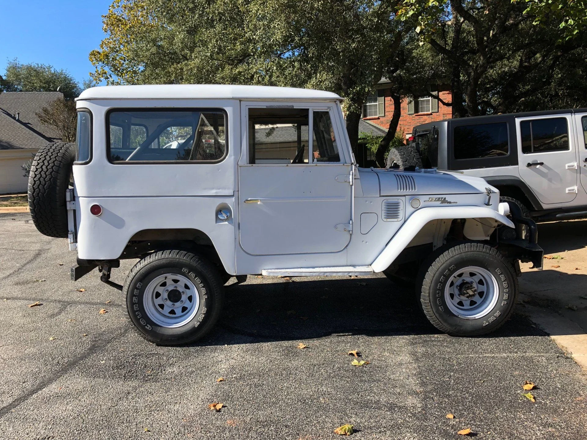

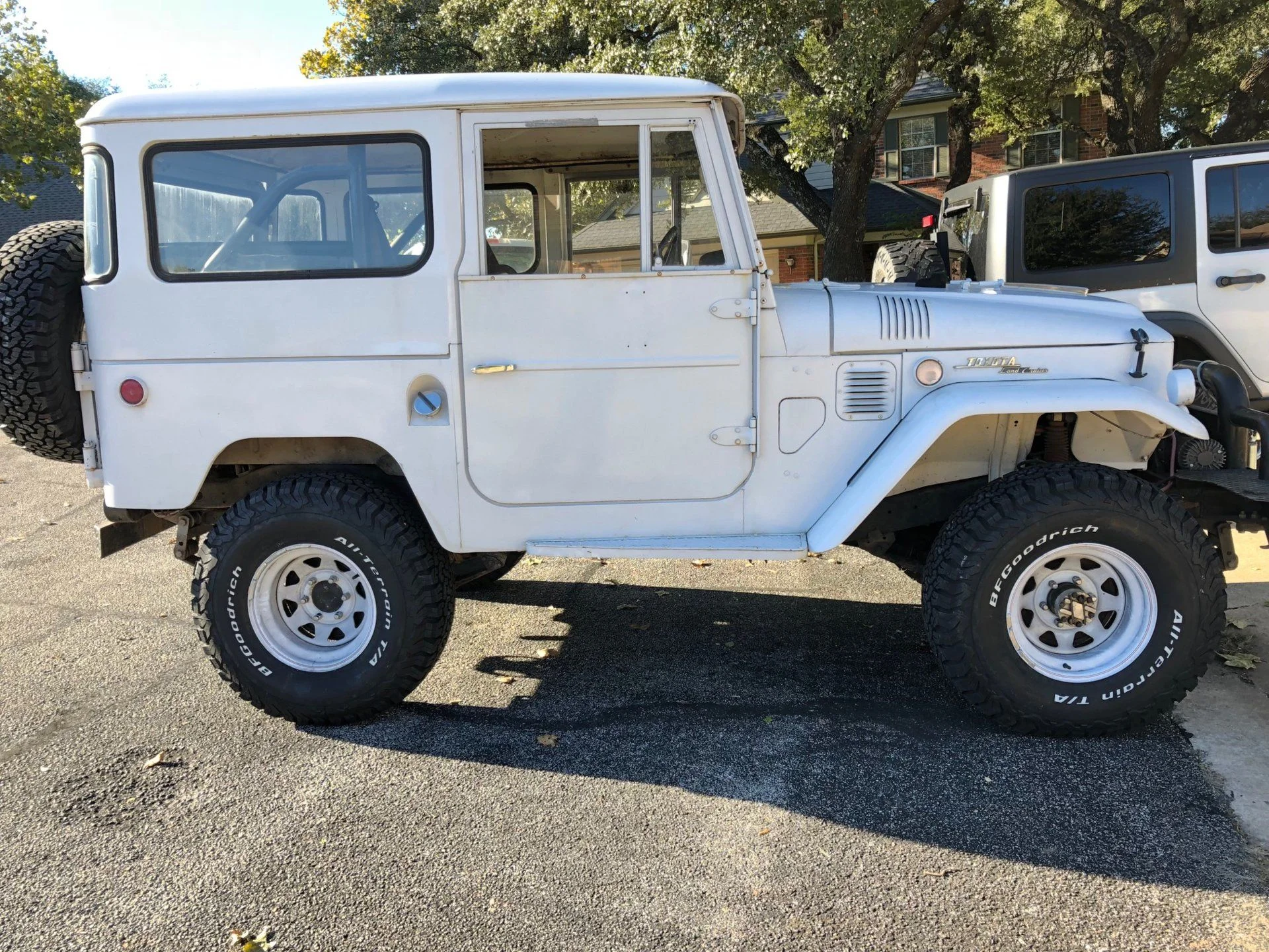

Tire sizes. I acquired a '68 earlier in November. It had worn 31" tires on it. There's definitely a lift on the truck. Here's the before and after photos showing how it sits with 33" now.
31:
33:

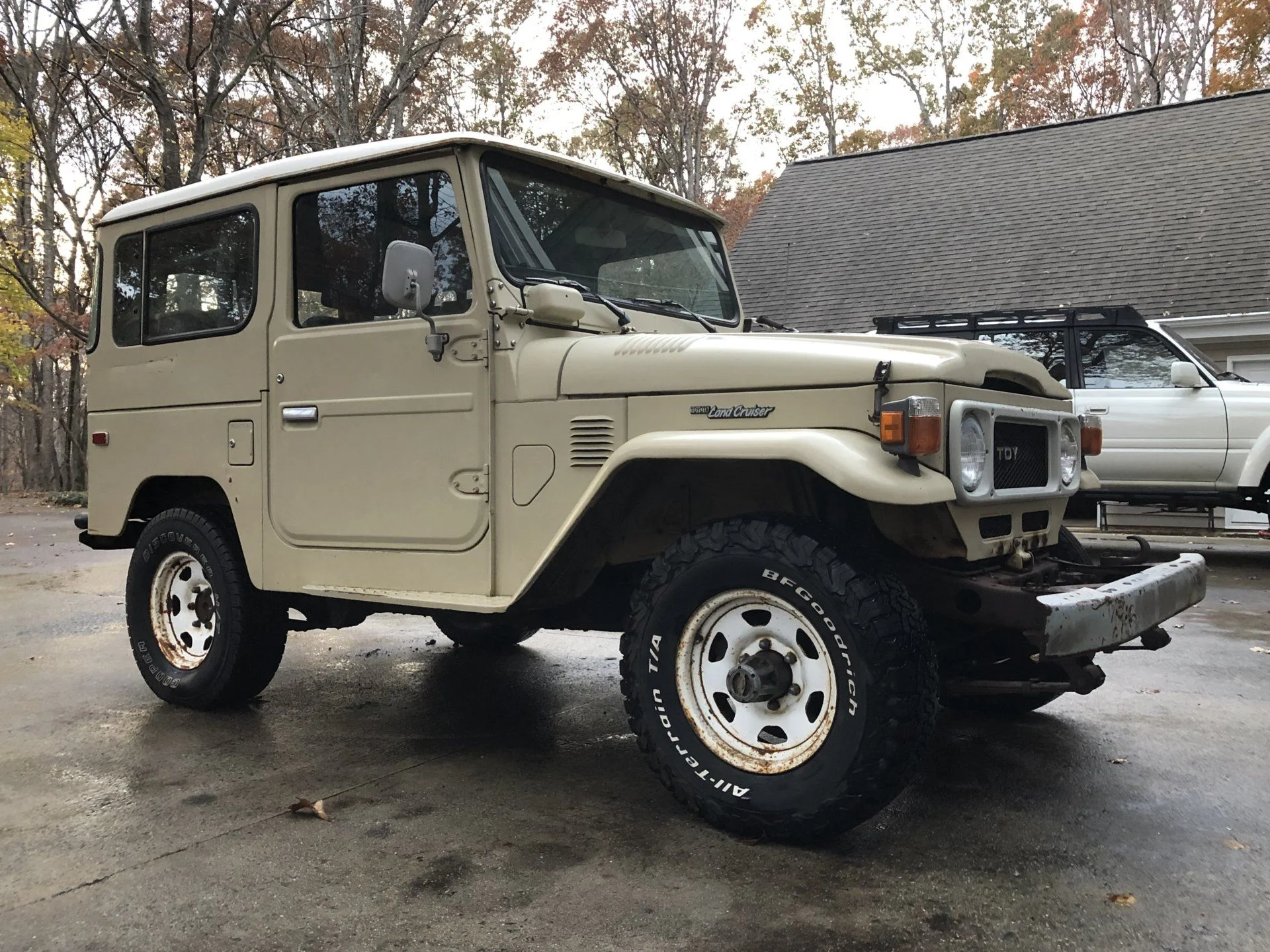

tall skinnys on the 40. 33x10.50's look pretty right on a 40. Not to mention, the BFG's I've owned all run small.

33x10.5 KO2 is the best looking tire on a 40 in my humble opinion.
Looks aside you should get by fine with 30s. I do alright with 31s and 4.10s. I figure a 3B in 5th is about as happy as a 2f in 4th :D

I’d just go with the 31’s and just redo the spring bushings. Plenty of bushing options out there.
To me, 31’s kind-of say, “I wish I could have gone bigger but this is what I settled for.” It’s going to have to be factory size (well...close enough) 30’s or straight to 33’s. Nothing in between.

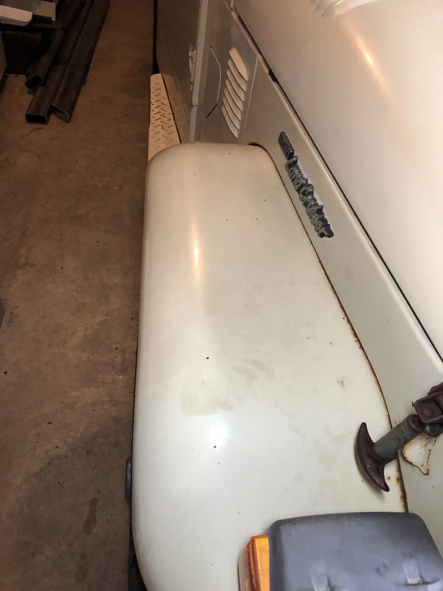

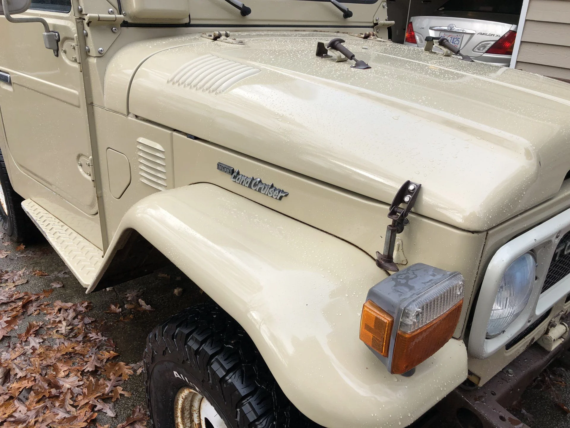

Dusty had a spa day on Sunday. Before turd polish:
After:

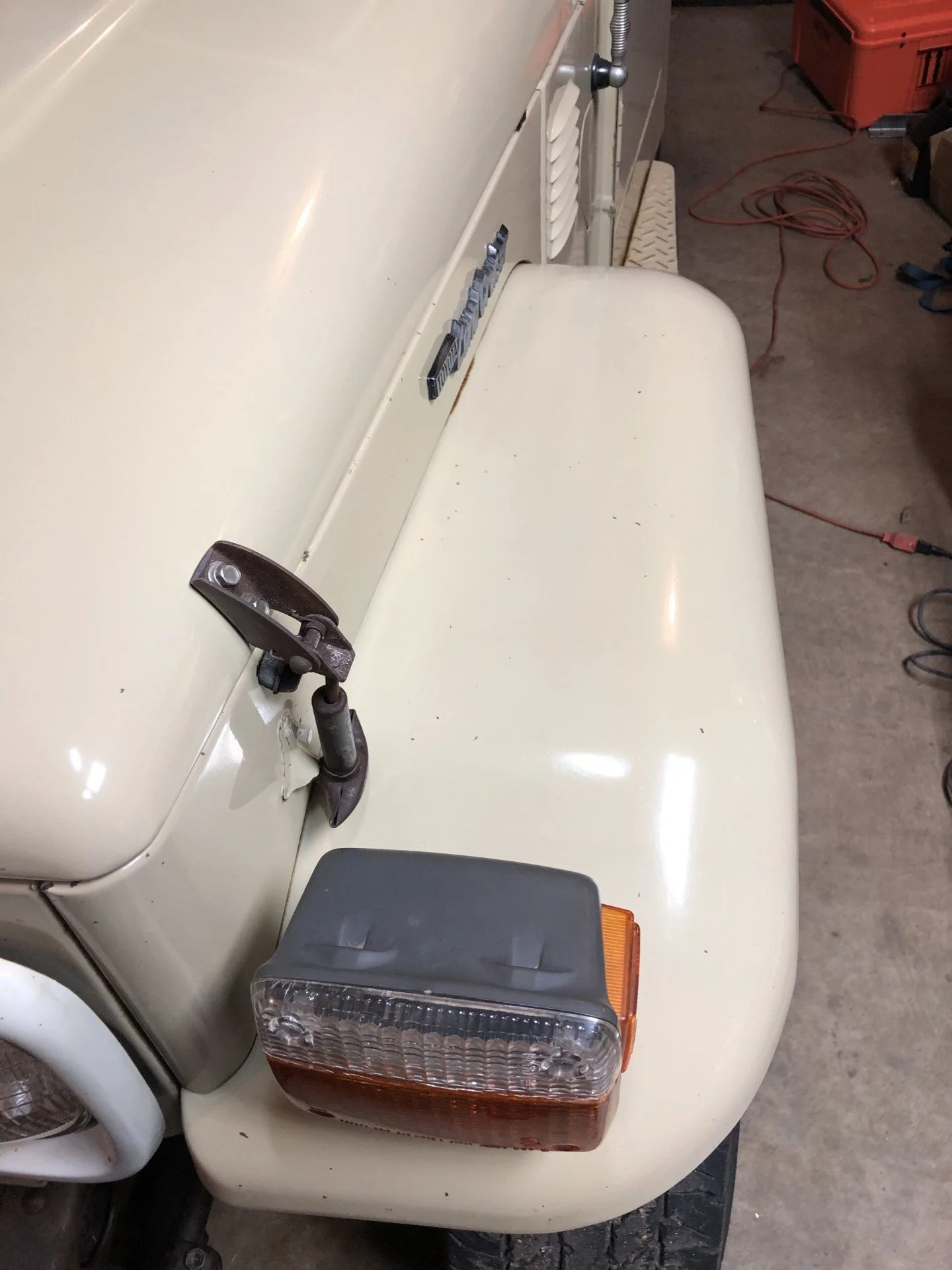

Before:
After:
