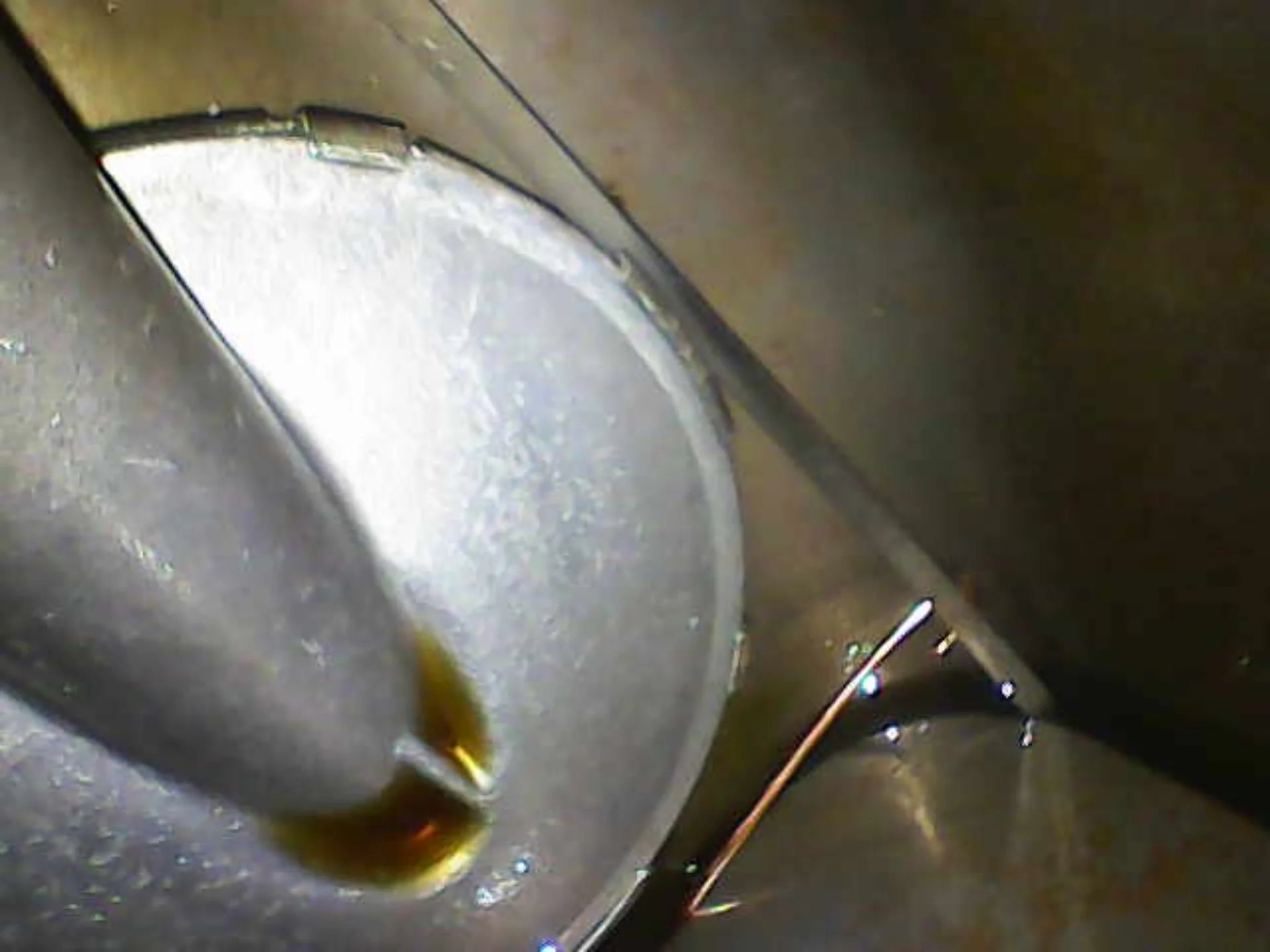

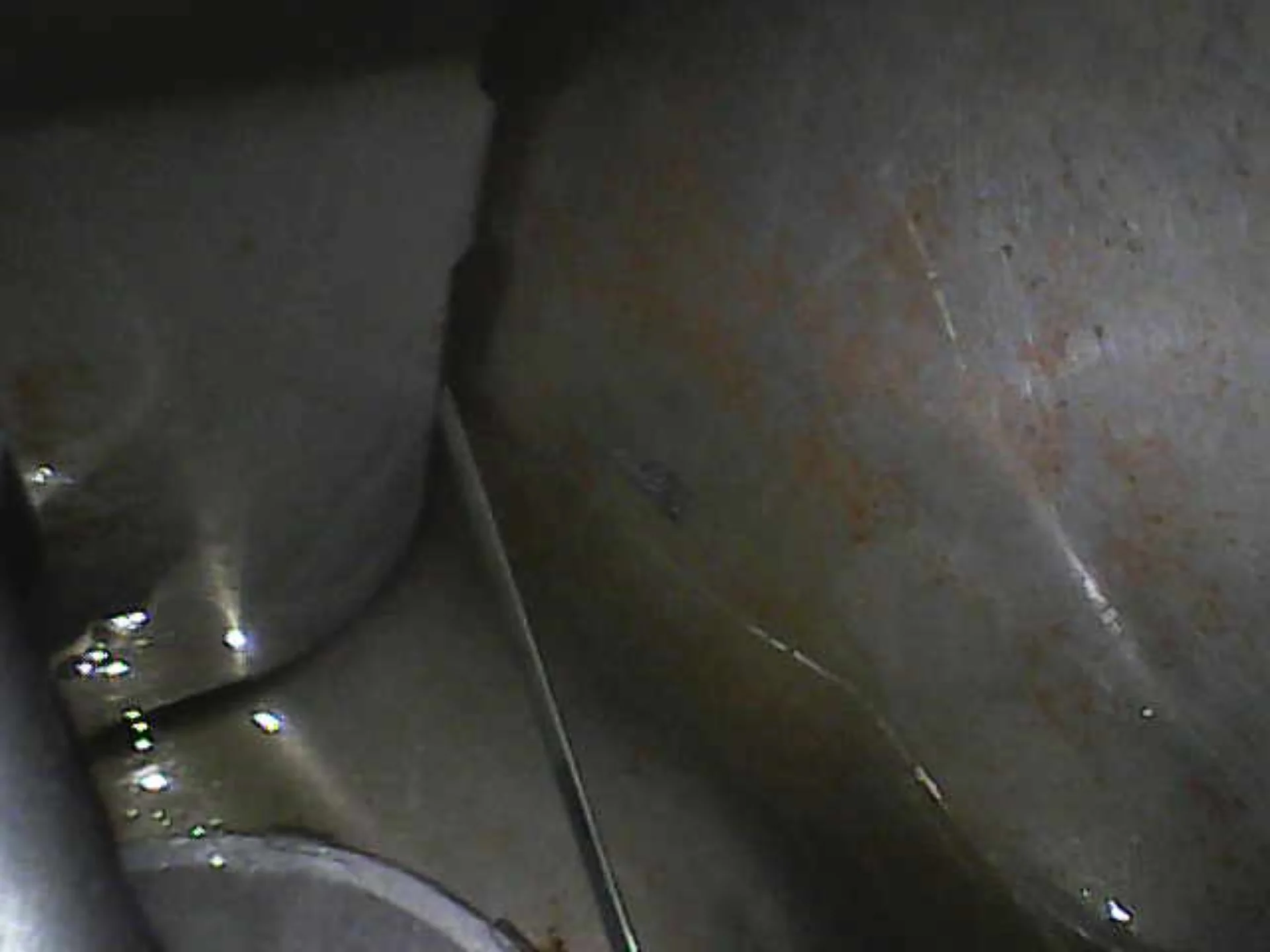

Using my Endoscope I was able to see the broken bit. It was leaning up against the front baffle and resting behind the oil pump pickup. I highly recommend this 2 camera endoscope https://www.amazon.com/dp/B0CMCSGPJC?tag=ihco-20 very easy to us and long enough to inspect an exhaust system. (Side benefit is it doubles as a bore scope on some of my rifles. It's about 7.5mm)
Using a hook I made from 12ga romex I was able to hook it while I watched on camera and get it under the rear baffle.

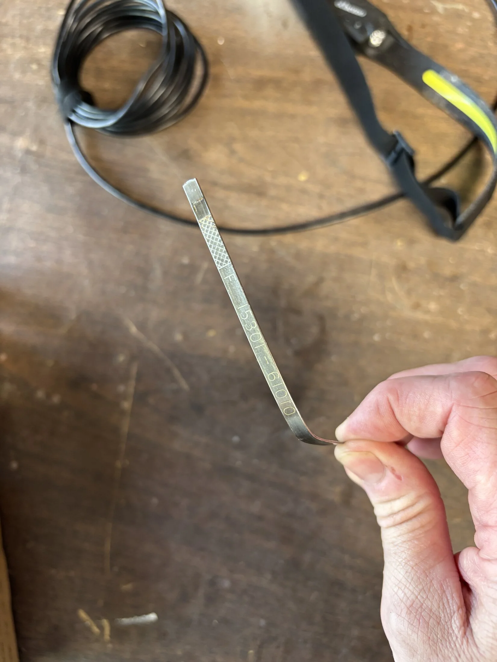

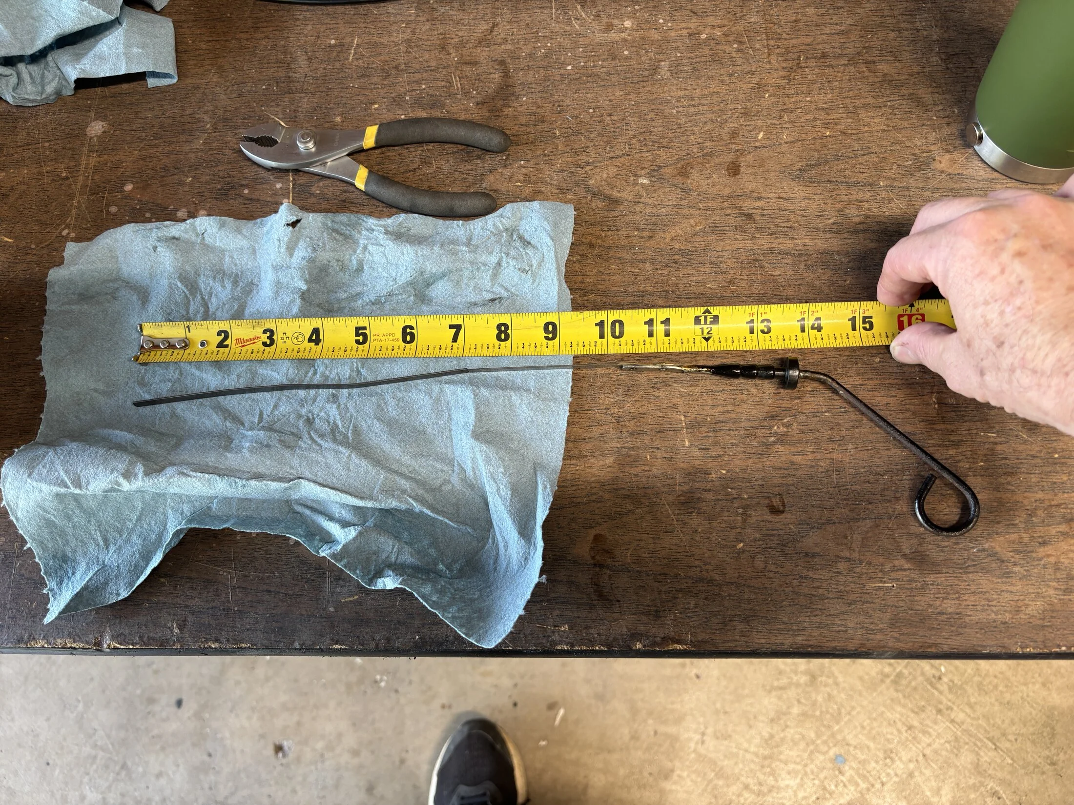

I have a new dipstick on order but I'll create a temporary replacement based on the measurements of the old one.
Once I got it to the drain hole it took a bit of fiddling to find the end and drag it out.

Thanks!! I am going to make a simple one just to get her filled up and running. I need to run it to temperature to finish the coolant refill.

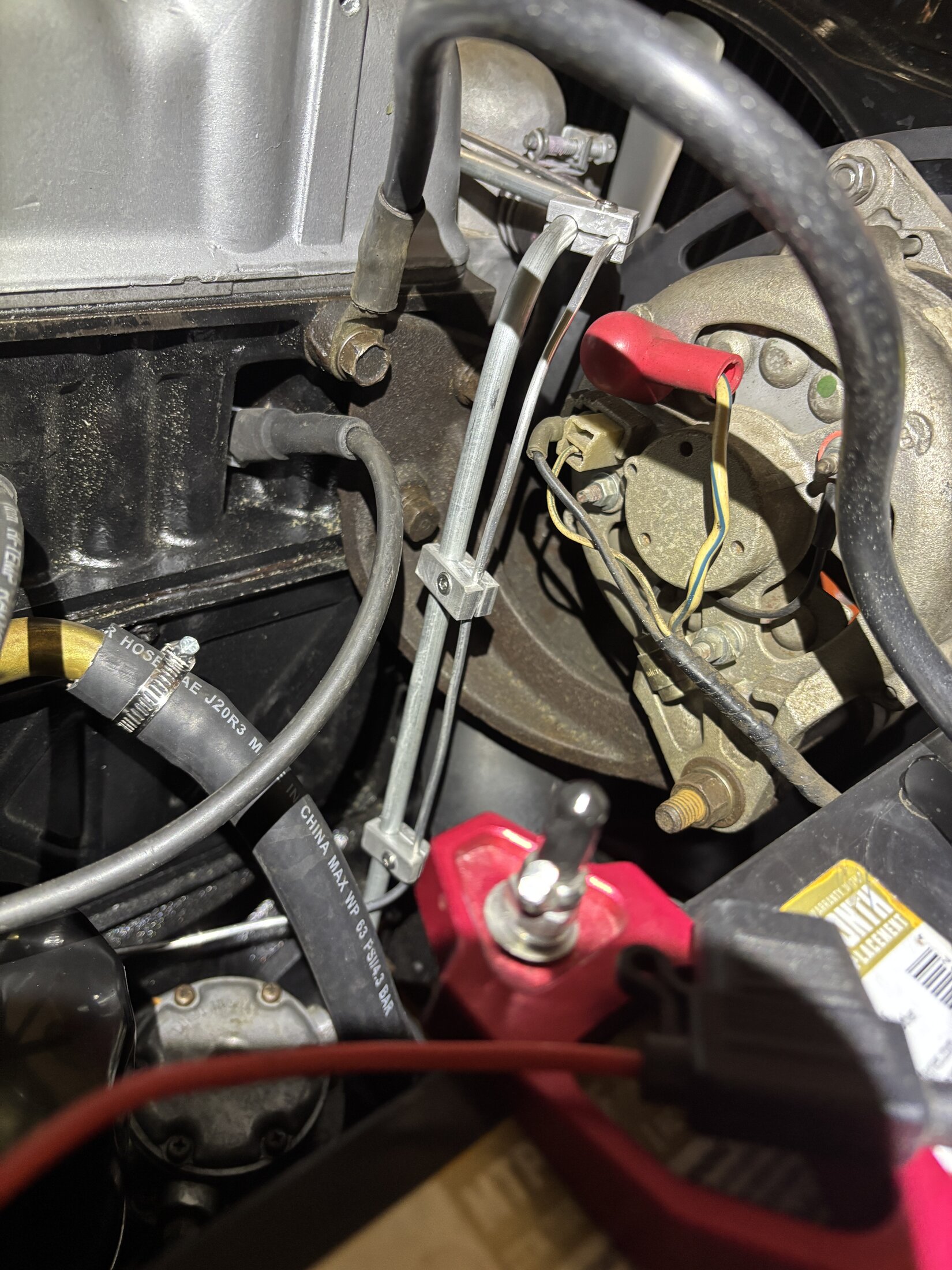

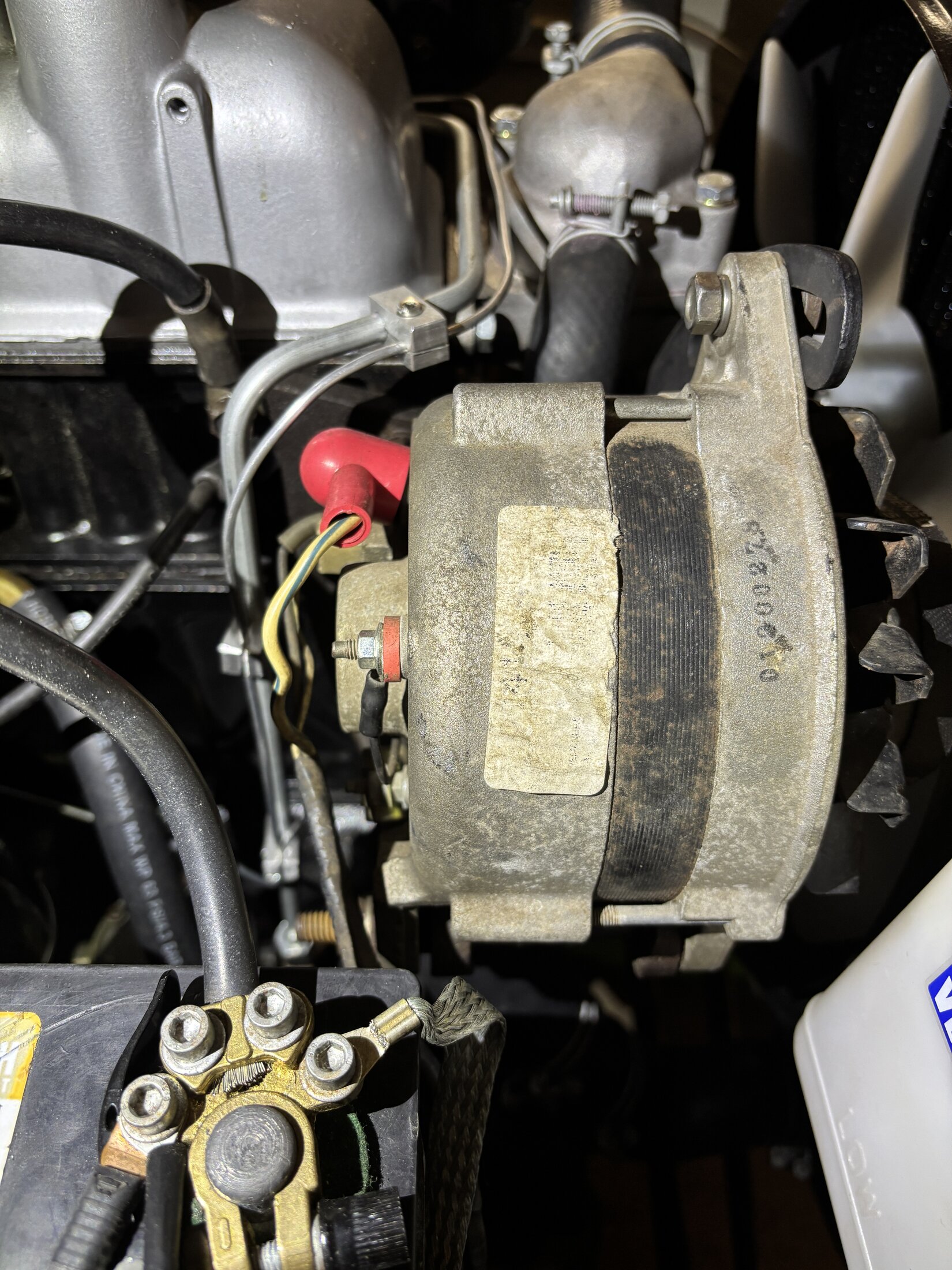

I tightened up the alternator bracket and while I was running the engine I managed to get the squeal on video.
Can anyone tell if this alternator is worth rebuilding or if I should just replace it? It's externally regulated. (And I need to ask @Coolerman if he has a replacement plastic connector.)

Great job on the dipstick.
